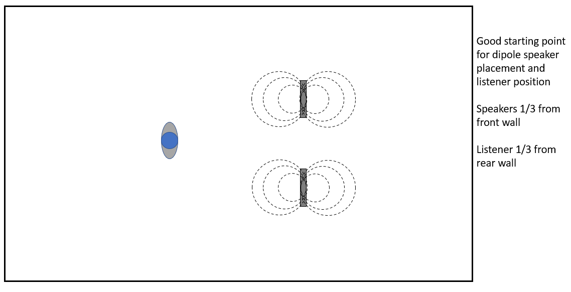

Sure they need reflection from frontwall ( theyr back) the issue is how long a delay (how far away the wall must be located).

Of course it's a matter of taste and music genre you listen to, but i'm used to low level of ER and this is definitely something i find bothersome to not have.

Issues with (room) reflection/diffraction can only be fixed through acoustic answer ( well at least past a certain freq range, LF and VLF are another story...).

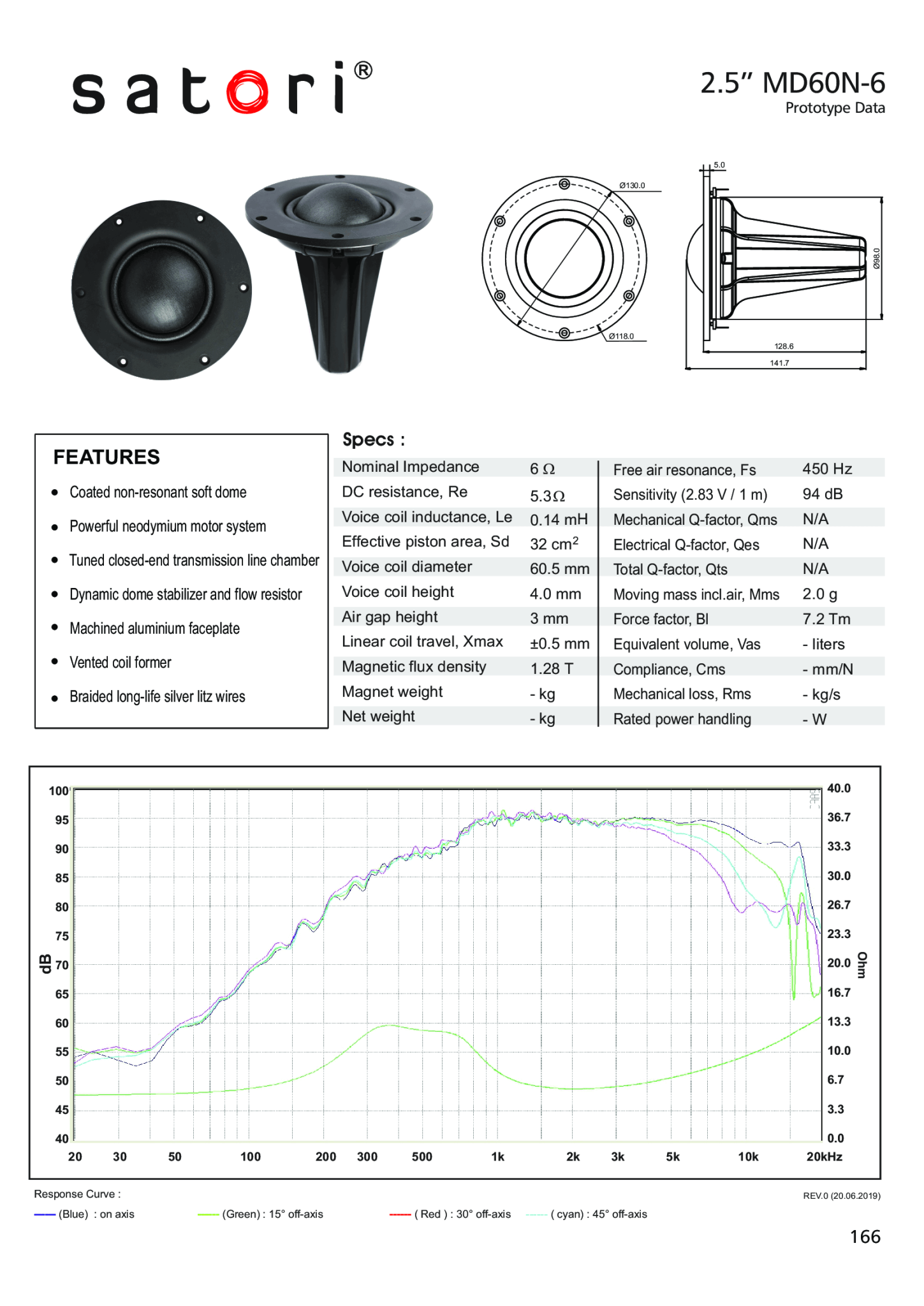

Great. I happened to talk to someone knowledgeable offline to hear that he'd crossover Satori around 4~5kHz on the top. I didn't get a clear answer about the lower crossover, though, and I am still hoping for 500Hz or around...
Which Satori model are you speaking about ? The MD60N like I plan to use (see below) ?
It shows a FS at 450Hz, so going to 500Hz is too low IMHO for linearity of FR and phase during the transition with the Woofer - If you intend like me to use passive crossover with gentle slopes (like on my 612SP 6 to 12dB asymptotic serial-parallel crossover).
I would not go under 1kHz (2xFS) with a 12dB/Oct. slope. I plan to use the MD60N between 2000-3000Hz and 7000-8000Hz, where its linearity stays very good from 0 to 15° off axis. As possible, I will try to stay far from the zones when the responses shows fast changes or linearity accidents. This is a prerequisite for a smooth, in-phase transition with gentle slopes crossovers.
Naturally, if it is about another larger dome midrange with a lower FS, or with a multi-amplification solution with active steep slopes and corrections, it's a different story !

Yes, I meant MD60N, and thank you for the relevant answer. I also thought 500Hz is too low, but graph seems to tell me 800Hz is okay for the sake of MD60N itself. Then I am reluctant to place a crossover point close to the frequency human ears are most sensitive to. I am sure good speaker engineers can even do the coherent and well-behaving passive crossovers, but I am just an amateur in that regard, and would like to avoid 800Hz if possible. I am now wondering if 600 or 700 is still acceptable to MD60N. Xmax of just 1mm is a bit concerning, too. It got only half Xmax of VM527, and about the same usable sensitivity(got to suppress the wide "peak" ranging 700 ~ 4000Hz), then somewhat bigger diaphragm area. Now VM527 looks slightly better...
I usually use very steep filtering(100+dB/oct), so my MD60N may be in a better situation than the one in your design. I'd still be careful to put some low frequency input power into dome mids, like you, but also want to maximize the use of the dome mid/mid-high. From 800 to 4000 ~ 5000 seem reasonable, but again, the concern of crossover in the most sensitive frequency range... I hope your last line is right(actually encouraging!), and 600 or 700 at low-end is okay.
