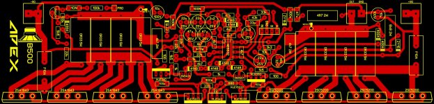

Apex B500 please is some one see any errors let me know
Hi guys!
I was doing this layout and I'm not sure if I got it correctly I spend maybe more than 5 hours or more, please is some one can see any error please let me know I have also the Sprint Layout format so you can use it too, I will share this for you guys. my brain is like this
Regards

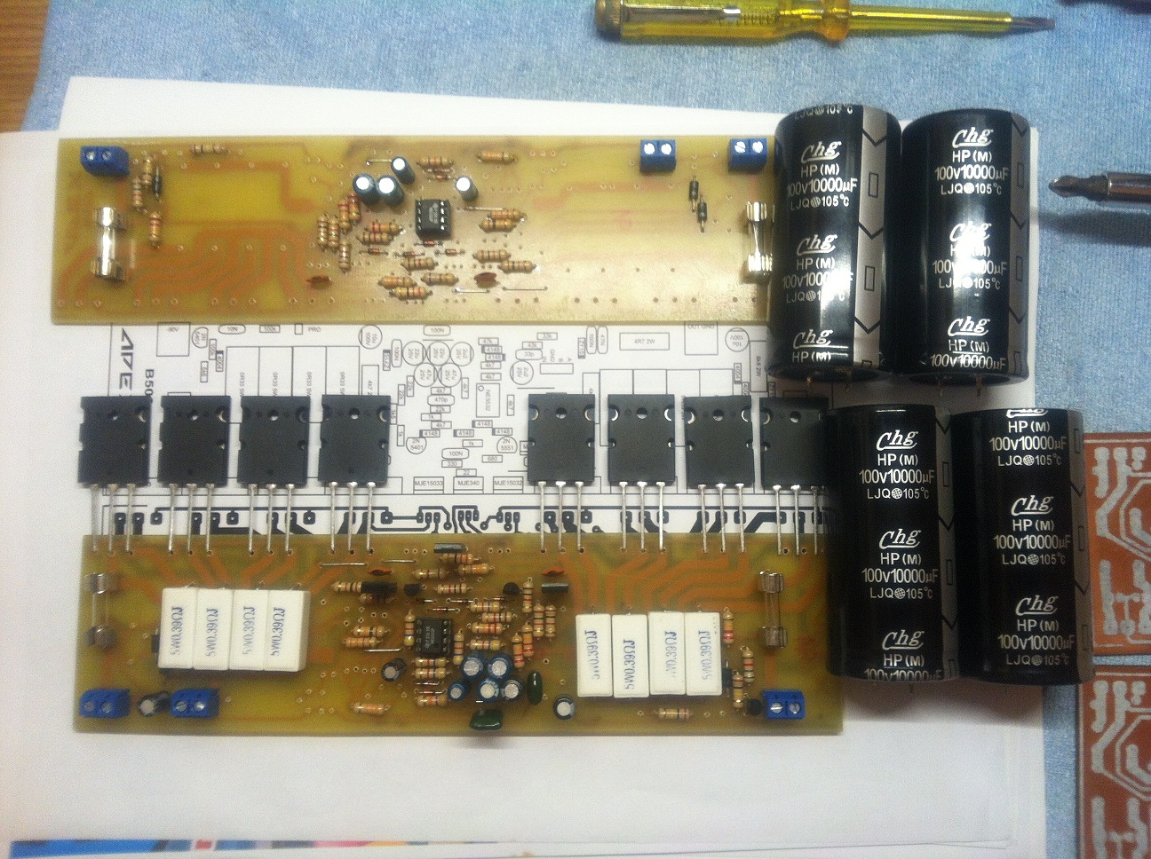

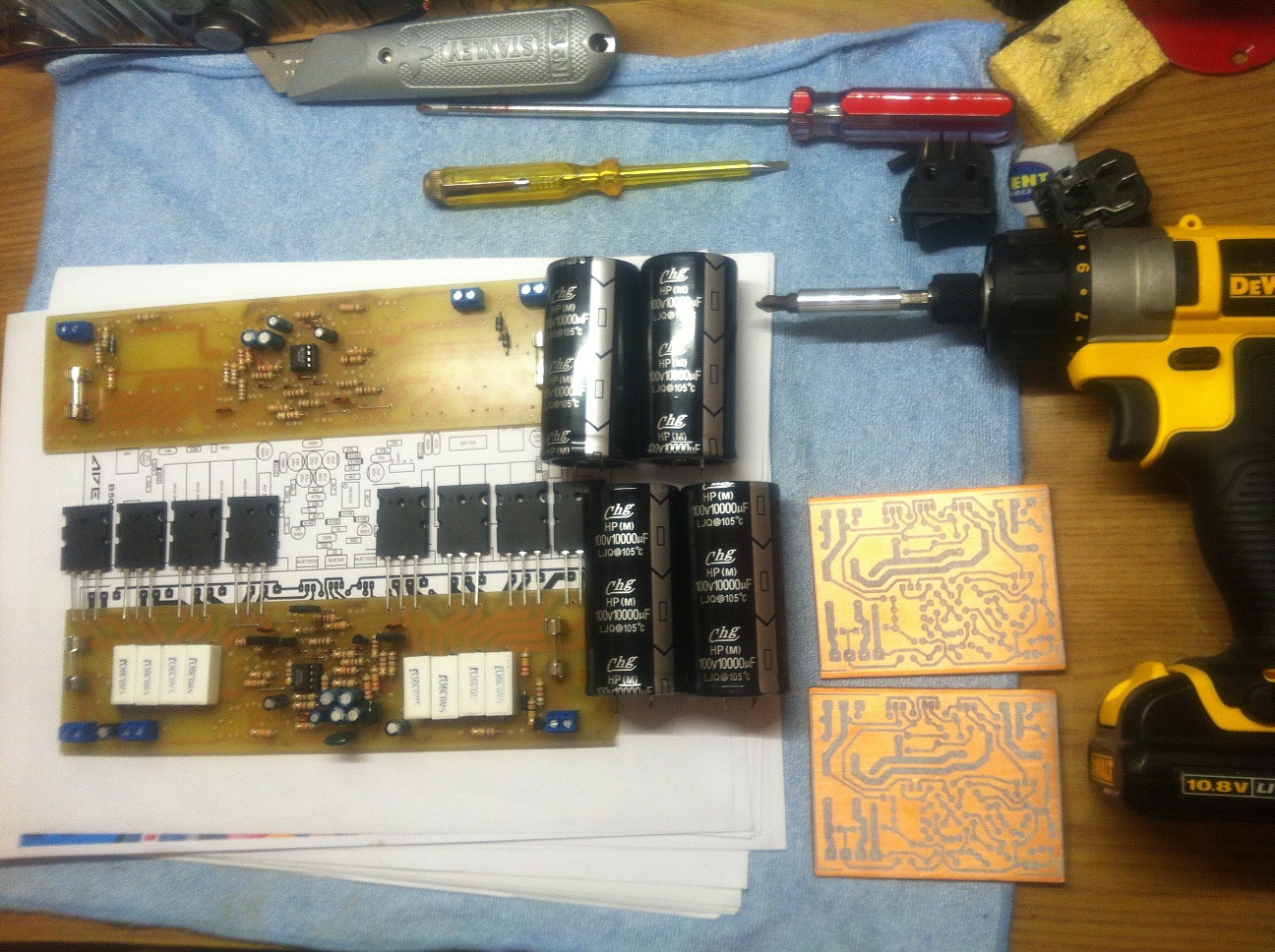

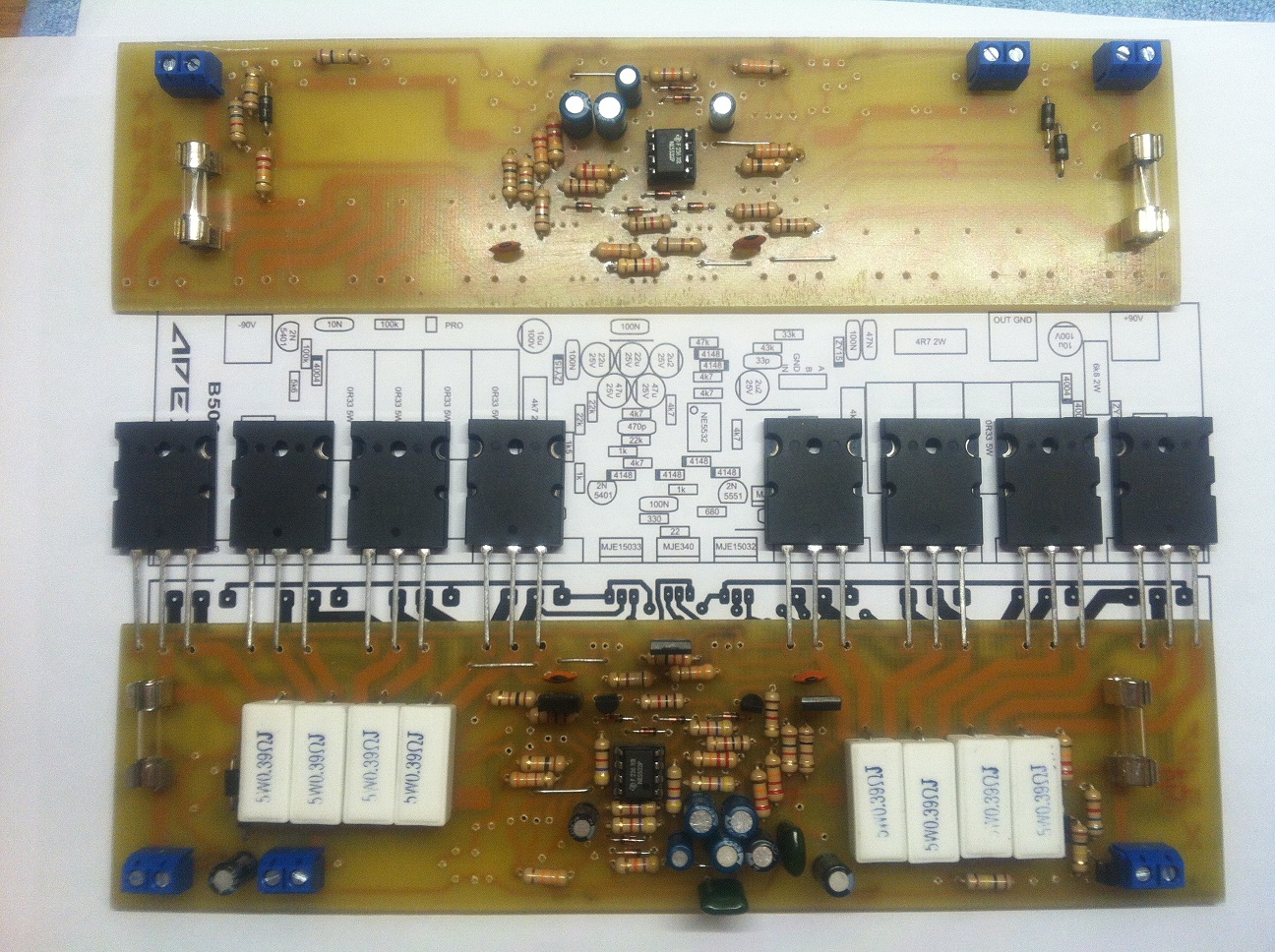

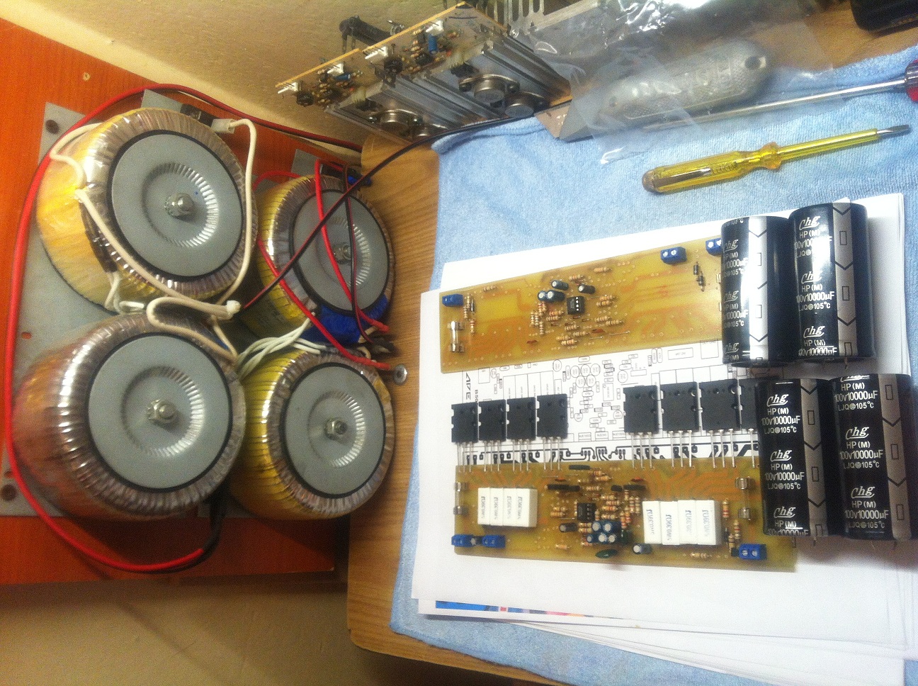

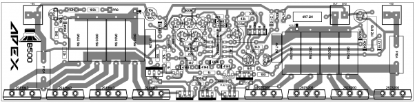

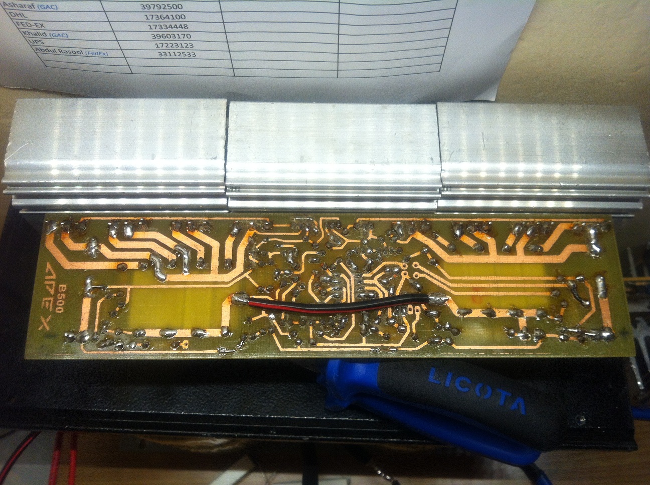

Dear Apex,
Good day and hope all is well with you and to all DIYERS.
I finally finish my B500 and my rail voltage is +/- 76VDC, but on the testing process i connected Input Ground and PSU Gnd as per your instruction but i'm still getting DC OUT (57VDC).
Please kindly check if i have mistake i attached herewith the pictures for component layout and copper side.
Looking forward your kind expertise/help and thank you in advance if anyone can help.
Wiljj78
Wiljj78
