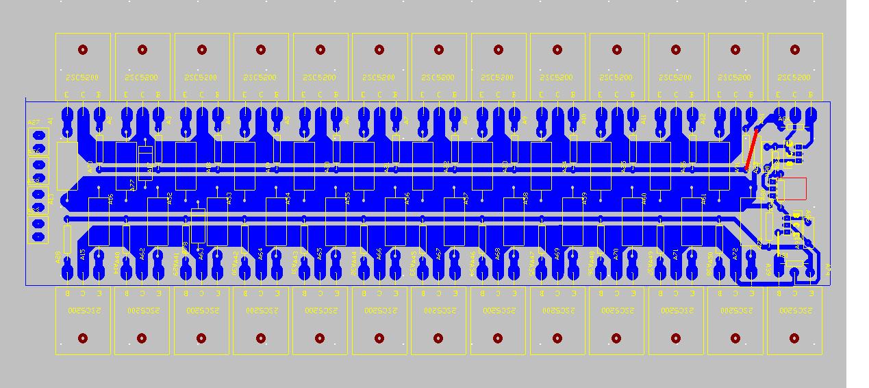

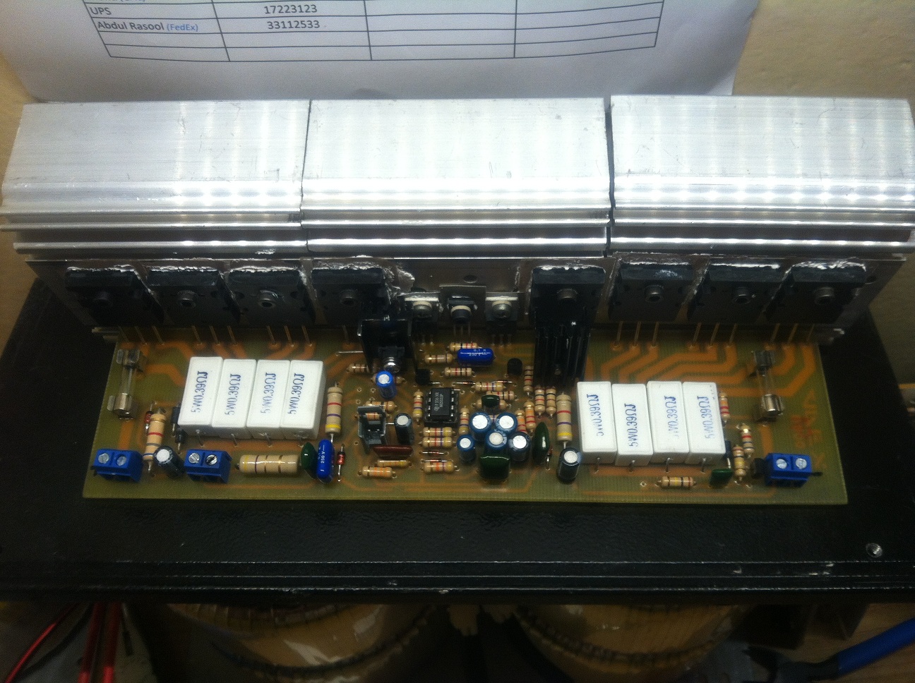

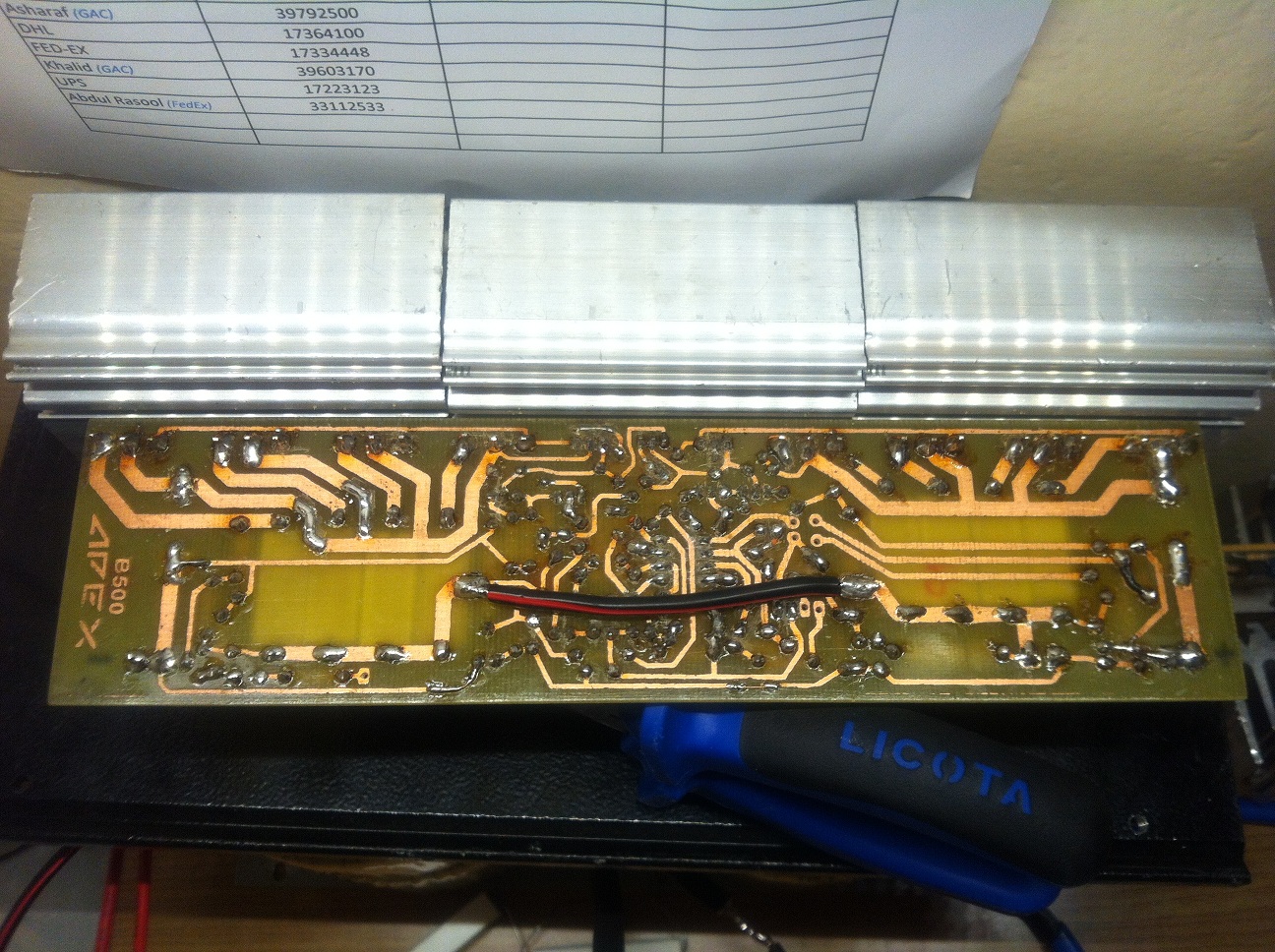

I finally finish my B500 and my rail voltage is +/- 76VDC, but on the testing process i connected Input Ground and PSU Gnd as per your instruction but i'm still getting DC OUT (57VDC).
Please kindly check if i have mistake i attached herewith the pictures for component layout and copper side.
Looking forward your kind expertise/help and thank you in advance if anyone can help.

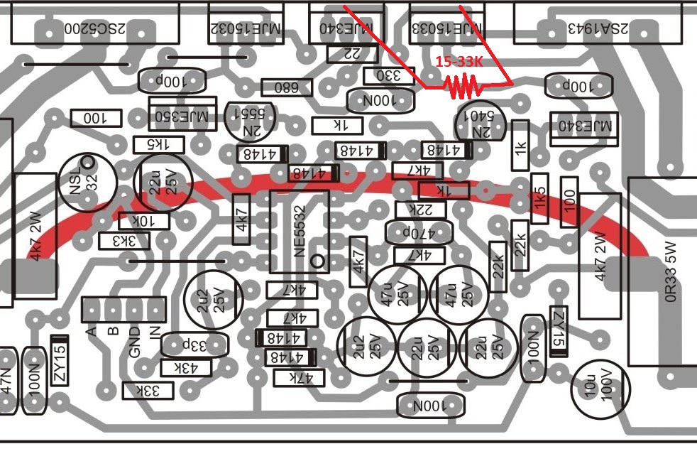

Last night i pulled out those mje's for check's and they where all fine, i double checked the traces and even adding jumper for doubted traces.
Maybe i need to etch new pcb and try again...
But placing 15-33K as per attached pic below 67VDC offset gone, i'm getting 1.2mV or lower. I treid to give input signal the amp works but not that powerful and distorted sound.
Any comments or suggestions are welcome.

Measure voltages on 1k5 and 100R resistors around MJE340/350... check tracks on pcb and resistors value...Mr. Miles,

I spend my whole night checking all components on board, with all the hard works i finally found where the fault lies, i found Q3,Q5 MJE340 has 1.Emmiter,2.Collector,3.Base have reverse pin orientation on my MJE340G 1.Base,2.Collector,3.Emmiter, my fault is i focus and depending more on the component guide orientation than having the actual test of the reanies before soldering the parts on board, when i corrected those tranies Damn... DC offset is gone and i'm just getting 1.5mVDC offset.
I hope my piece of experince can help other DIYer's whos interested to build this Amp.
I installed back the 4K7/2W when the DC offset gone though its hot but i feel more comfortable than 2K2/2W that giving smell.
I tested the Amp last nigh and the sound quality of this B500 is perfect, very quiet no hum,hiss etc.. the blending of Low,mid and high are very clear for my hearing, such a nice Amp.
