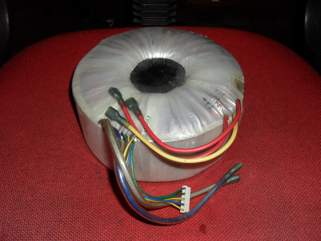

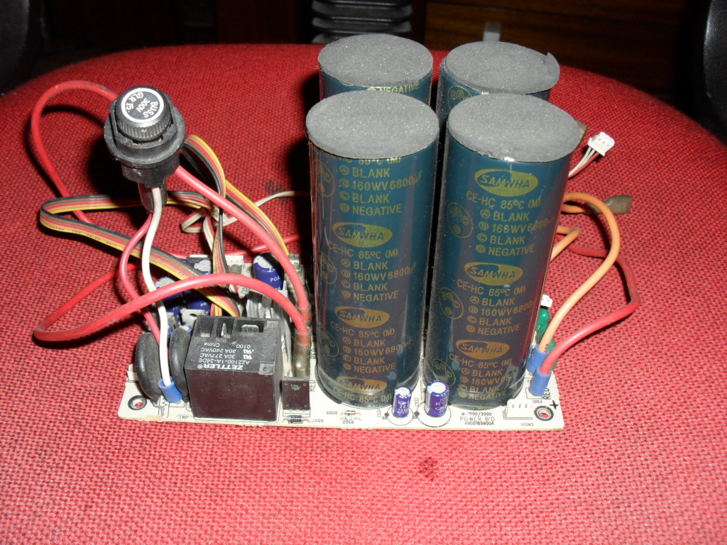

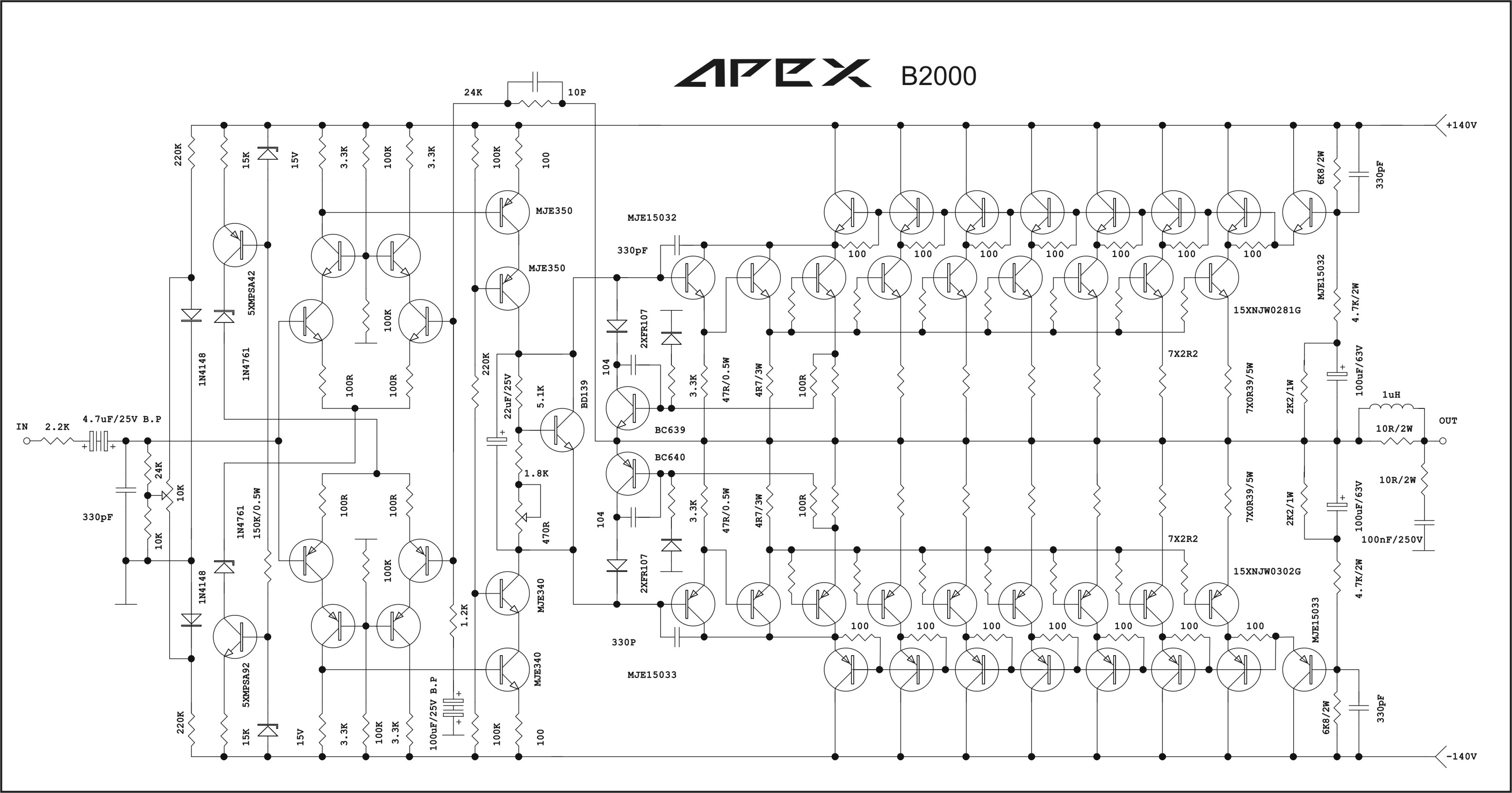

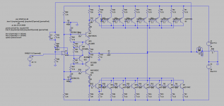

P { margin-bottom: 0.21cm; } [FONT=Verdana, sans-serif]I Mister Mile, I Have a power suply from an old Inter M amplifier CM20.5, this unit give +135 VDC / -135 VDC. Can I do the Apex B2000 ? If I can, tel me please the volts of blue, red and green condensers. Thanks in advance.[/FONT]

Escuse me, I forgot the electronic diagram
Regards

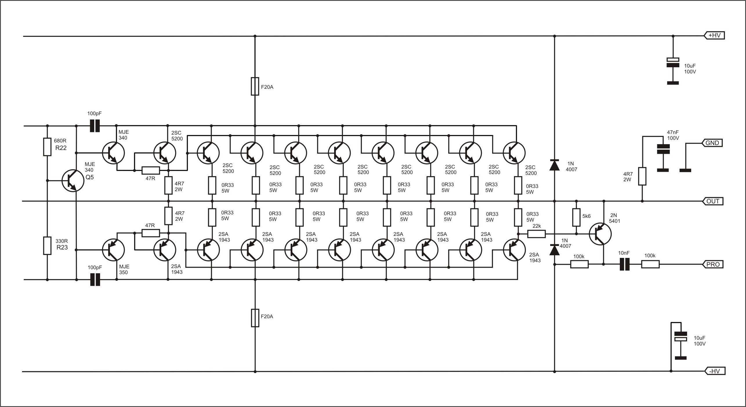

This is just idea,
Regards

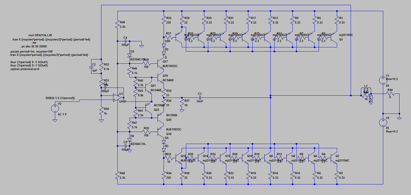

B700 simulation was succesfully done. I will work with some fine tuning...
Sajti
Sajti
Any Idea what the projected supply rails will be?
The simulation was done with +/-85V. I think this is the maximum safe voltage with 100V psu capacitors. The simulation gives about 1000-1100W/2ohms.

Any way that it can be run off +/- 96v rails. I only need a minimum 4Ohm load? I already have the PSU from an old amp. are there PCB's / PCB designs available?
You can try it, of course, but I would not recommend.

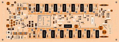

B500 tef 8 pairs

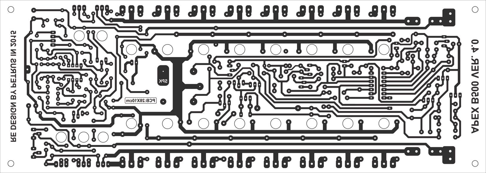

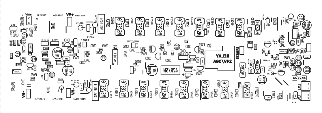

Sir mile iwant to build B500 TEF 8 PAIRS Sir this layout is ok sir? thank you so much sir Mile Advance merry x mas sir..
