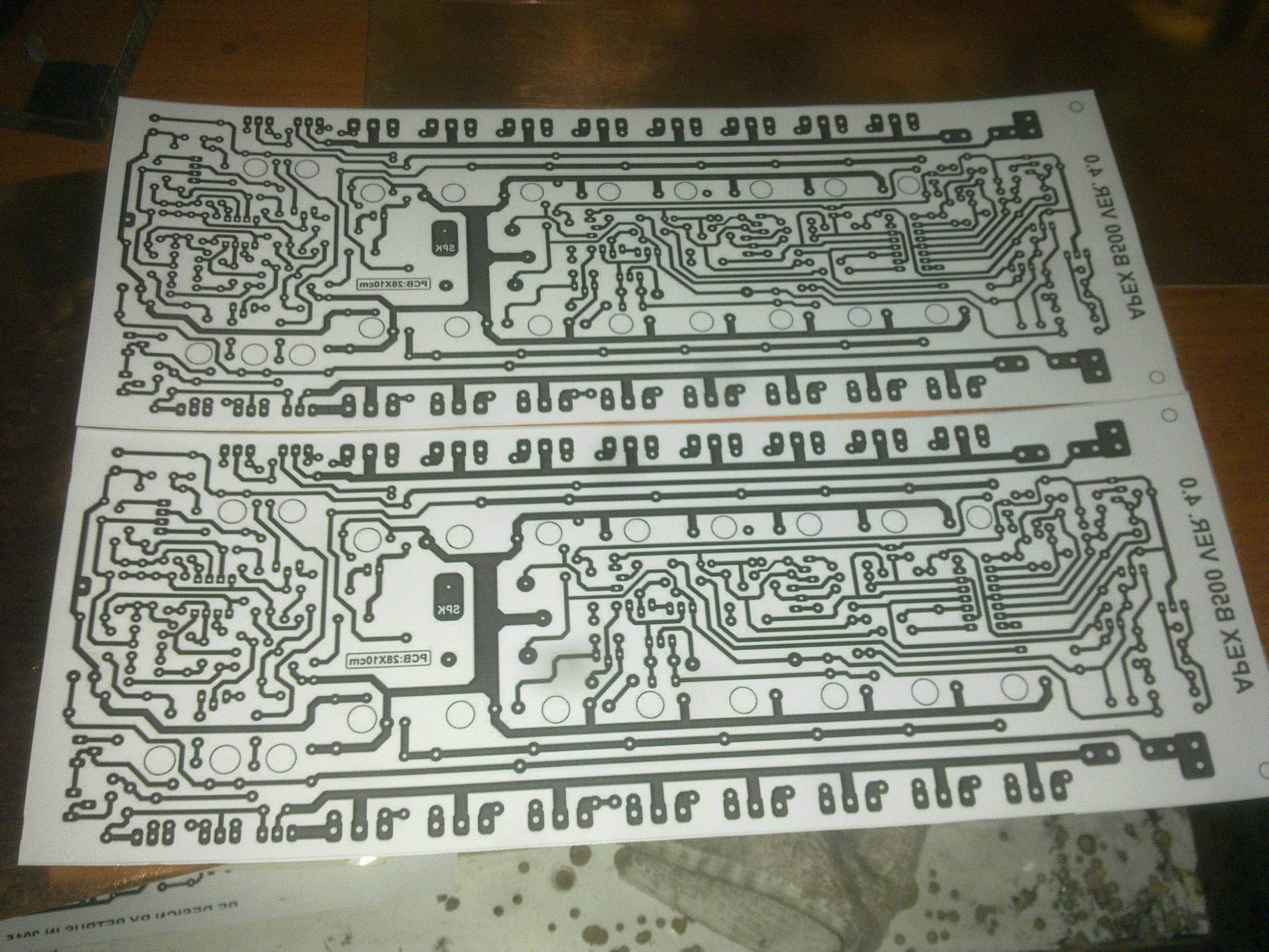

Apex B500 tef 8 pairs
just waiting sir mile advice if this ok or not because he is the owner author of this amp.
he is author of b500 but not that pcb.you have to ask from that man who made that pcb. pcb is not good and issue of protect circuit too.may be work but no one can say 100%.as diy i suggest you make b500 with apex pcb and use njw series.using more transistor never mean you got much power.b500 powerful with 4 pair.this is my view you can do as you wish.
i make already B500 tef by sir willy cerna but i wish to build with attach speaker protect. and more power..thanks for your info sir rohinhe is author of b500 but not that pcb.you have to ask from that man who made that pcb. pcb is not good and issue of protect circuit too.may be work but no one can say 100%.as diy i suggest you make b500 with apex pcb and use njw series.using more transistor never mean you got much power.b500 powerful with 4 pair.this is my view you can do as you wish.

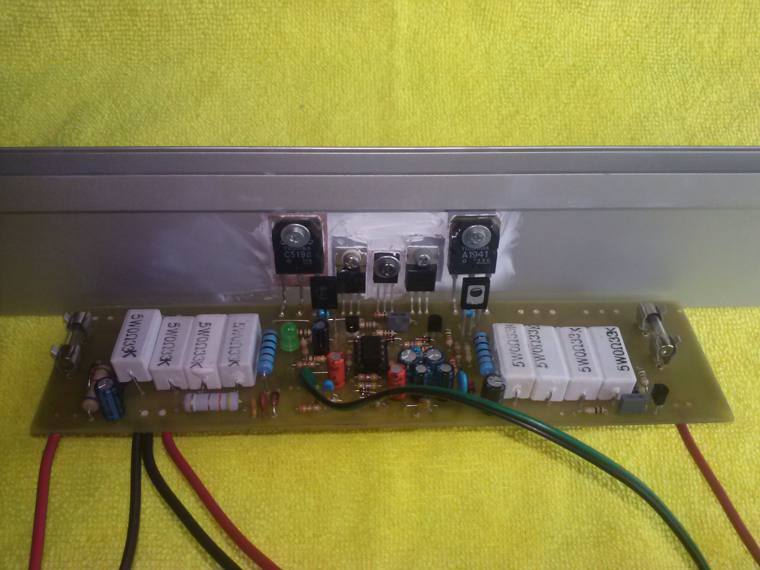

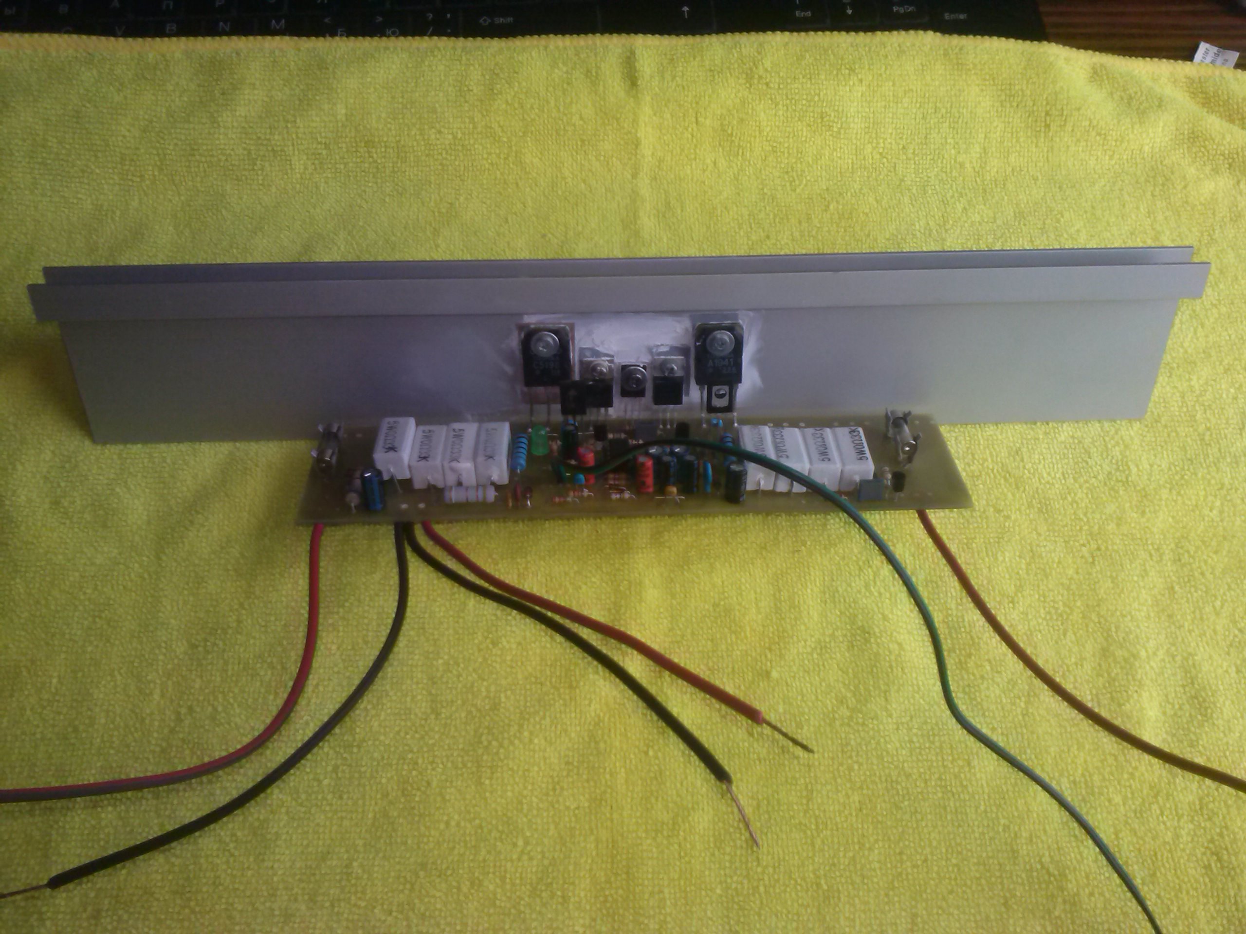

HELLO ... lHello all my friends!!!!!!!!!
just wait for me ,i already get the b500 pcb and put the componnet just for 1x 24h i will share the result (newbe)I hope that nobody go to build this amp as his first amp ever. Some expirience is welcome, and can help with first powered.

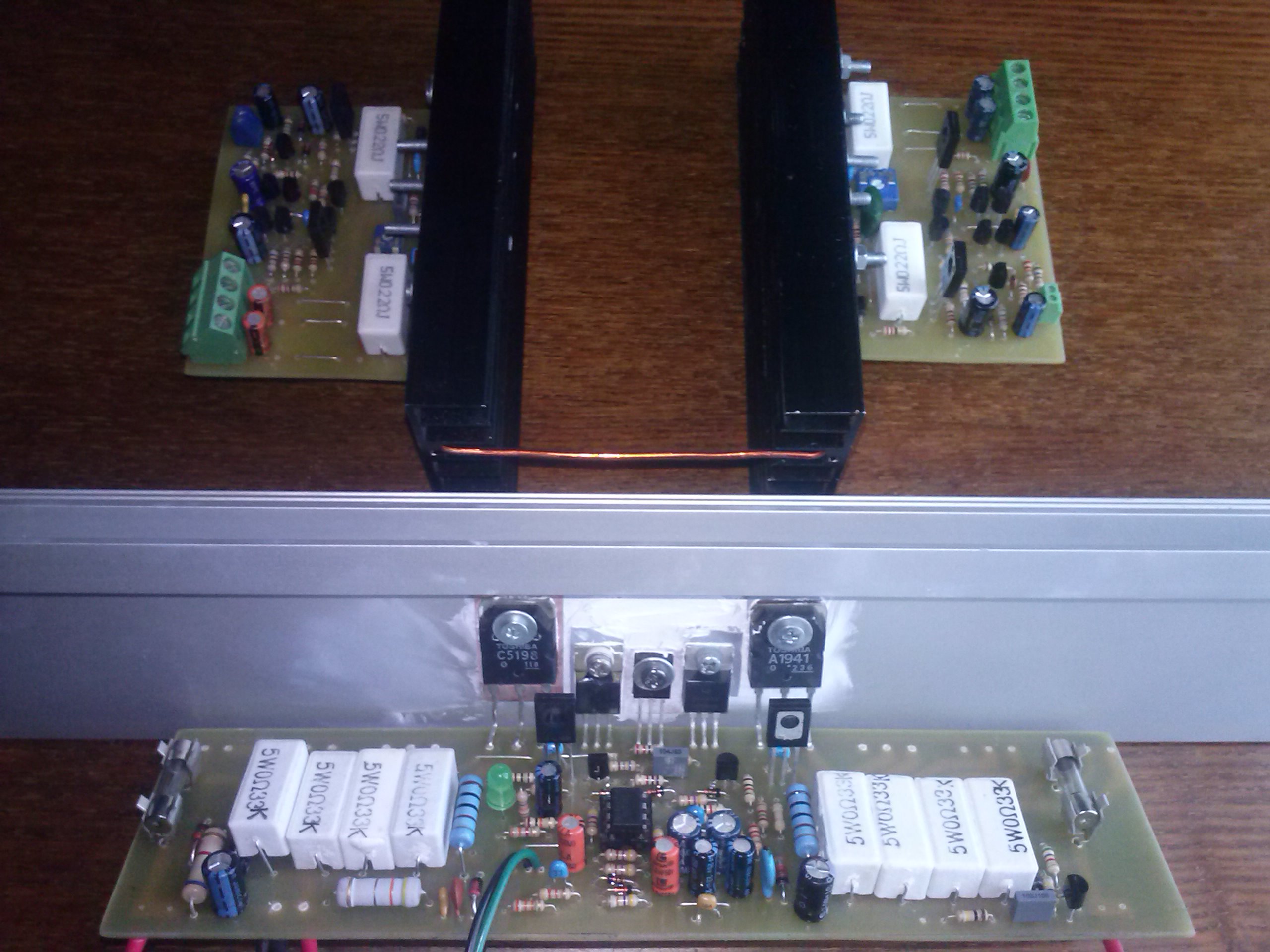

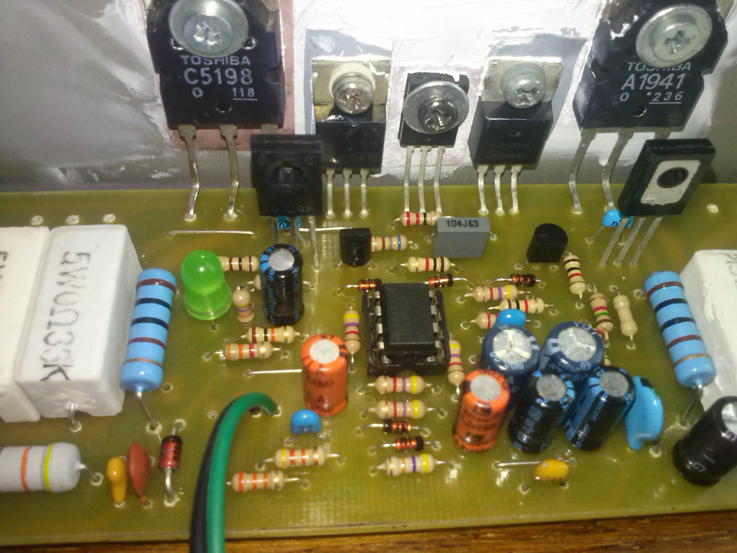

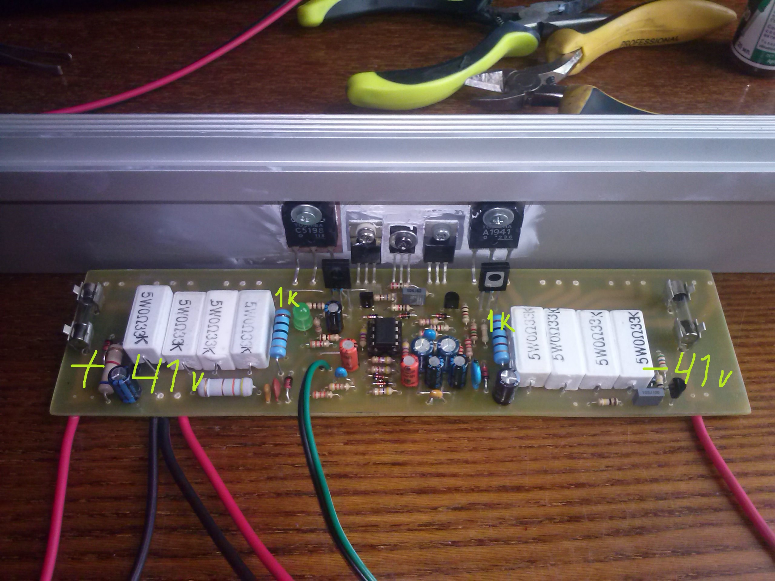

Hello everybody! I did B500, it works, but it does not play cleanly in a small volume. But with an increase in volume plays perfectly. What to check?
all of you solders is good? And check the input capacitor too.
To my old amp that problem it was from input capacitor, was leaking.
