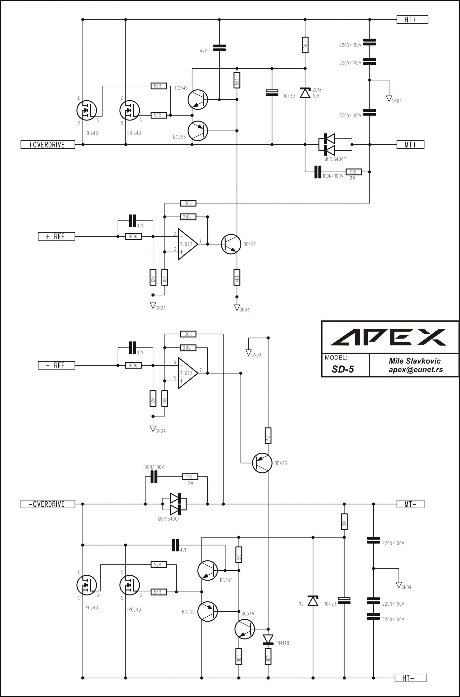

Hi every body! Can you share for me "H-class step driver with TL072" ?
I have found in this topic but the image is blur. I can see!!
Thanks!!!
900W H-class PA Amp with Limiter
hi lengo check the above links
Thank you my friend!
But I only want to look for "schematic diagram of step driver using TL072". It is a power switch circuit.
It is this circuit, but it is too blur. I can see all value!

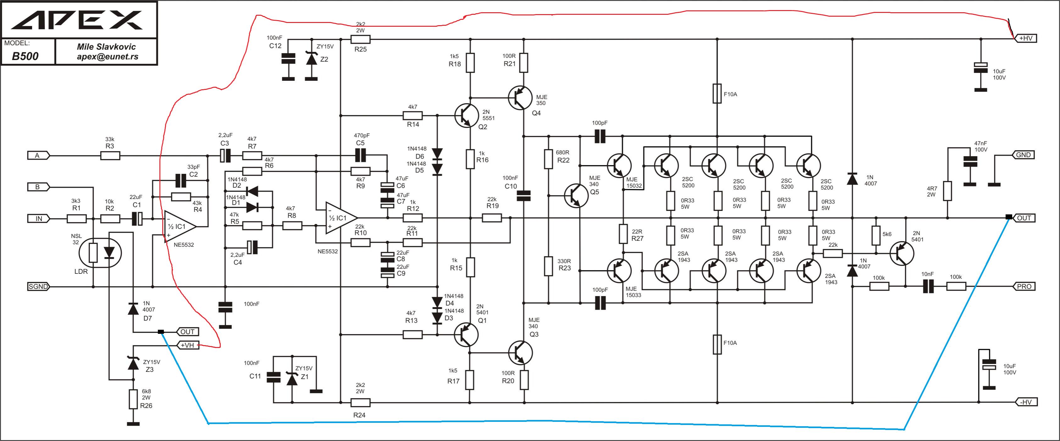

i starting to build this amp and im little bit confused
can somebody explain to me what is this connectors
A&B, And this pin +vh beneath nsl32 ,and Pro Pin.
Where i must connect this pins to amplifier work
i will be very thankful If somebody can explain to me.
for the Rest of components everything is clear to me.

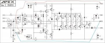

An externally hosted image should be here but it was not working when we last tested it.An externally hosted image should be here but it was not working when we last tested it.
A and B pins are for bridge mode and pro pin is for the protection (if you have one) as far as I remember. There was a post from Apex with schematic somewhere here how to connect them properly. I have not tested this option to share my own experience.
You do not need to connect any of those for the amplifier to work, they are only optional.
