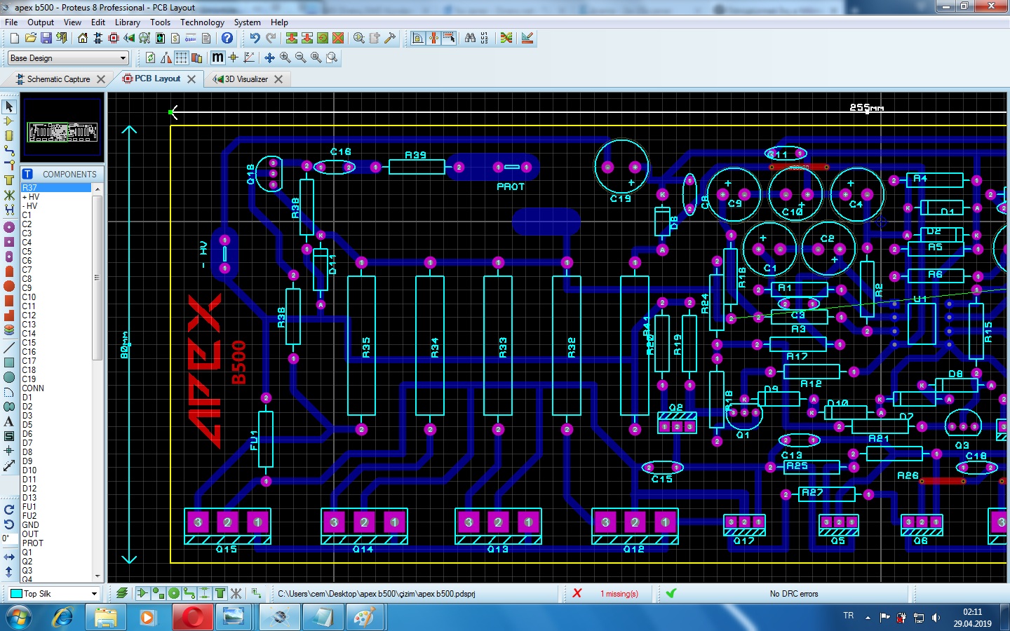

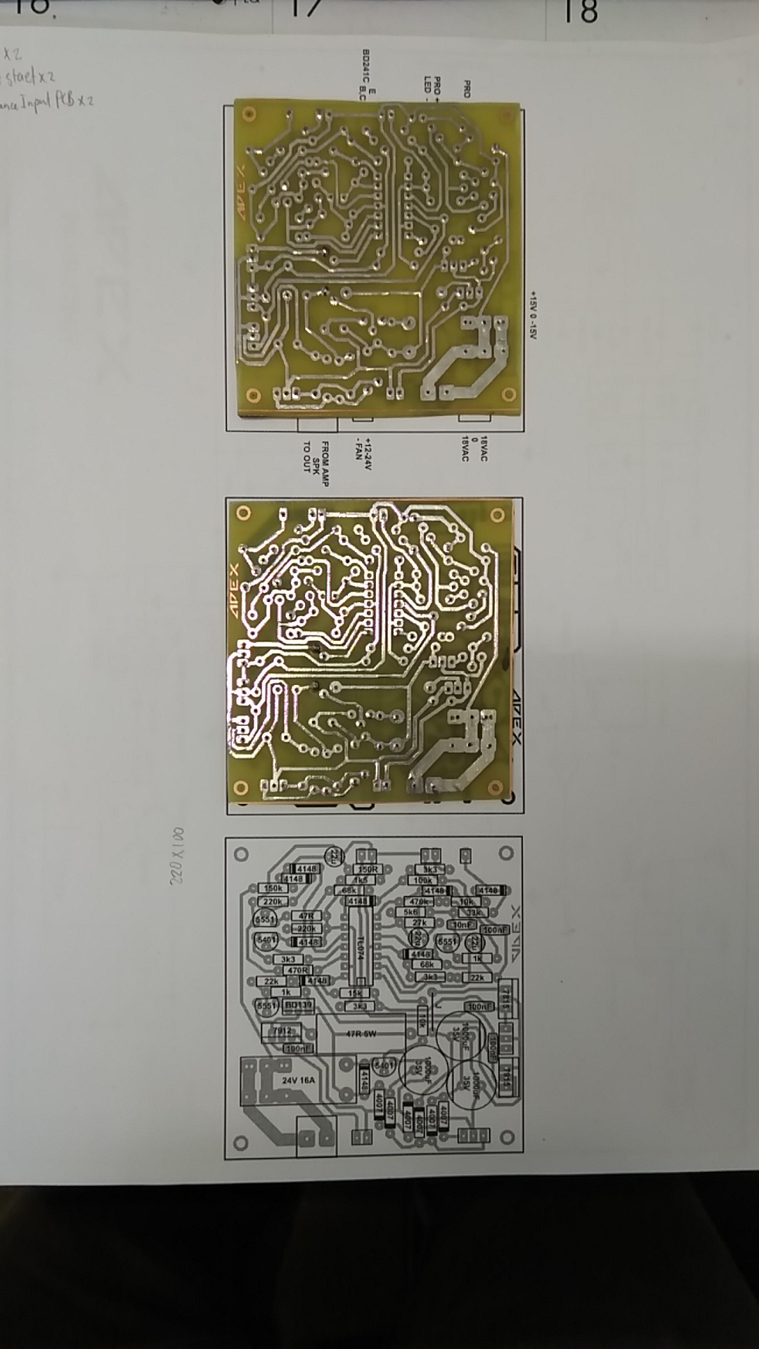

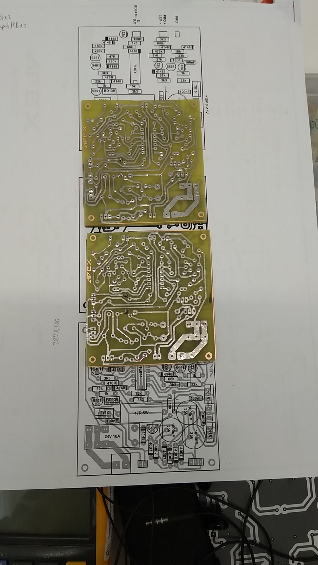

To masters
I found this pcb from internet. I converted from pdf to lay6.But my experience not enough to build and I did not to be sure,it is true or not. therefore I'am asking to masters. İf it is possible please can you check it

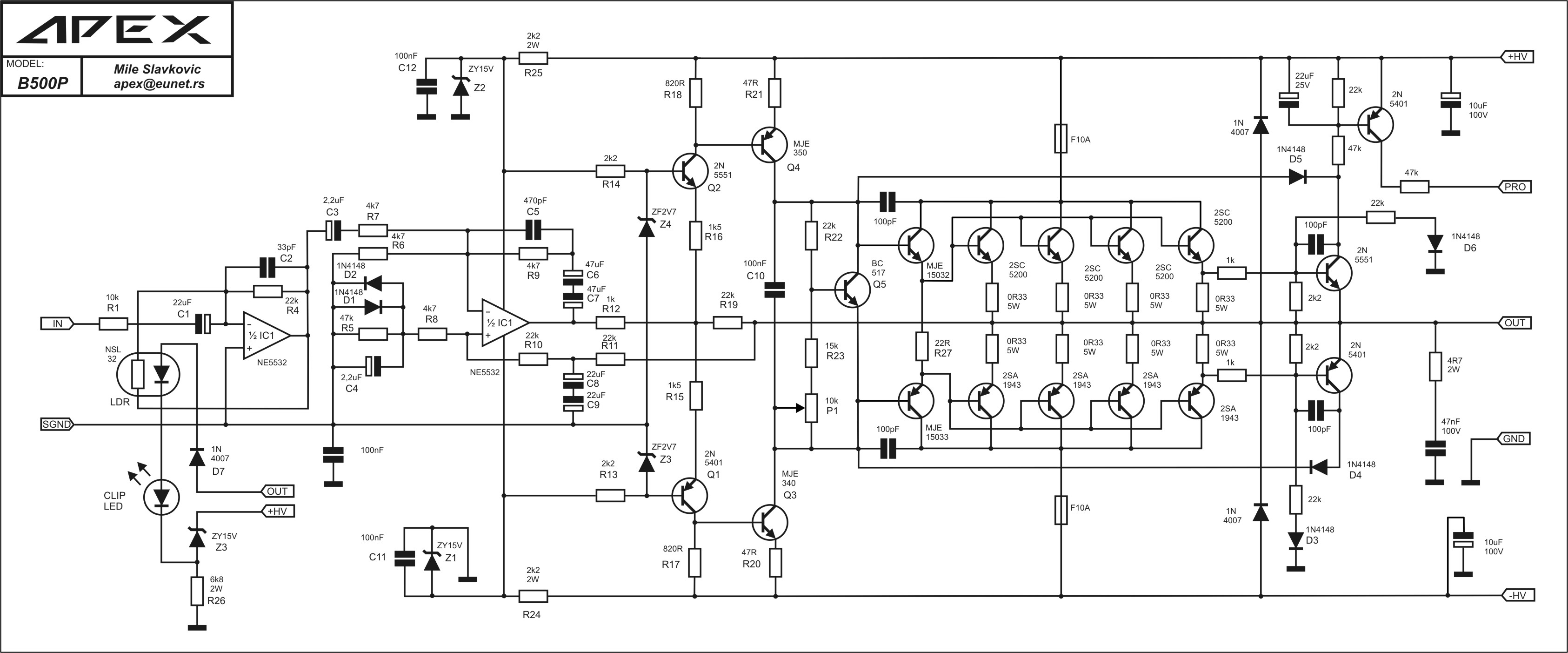

Yes, D3 must be inverted as you can see in Apex components PCB.

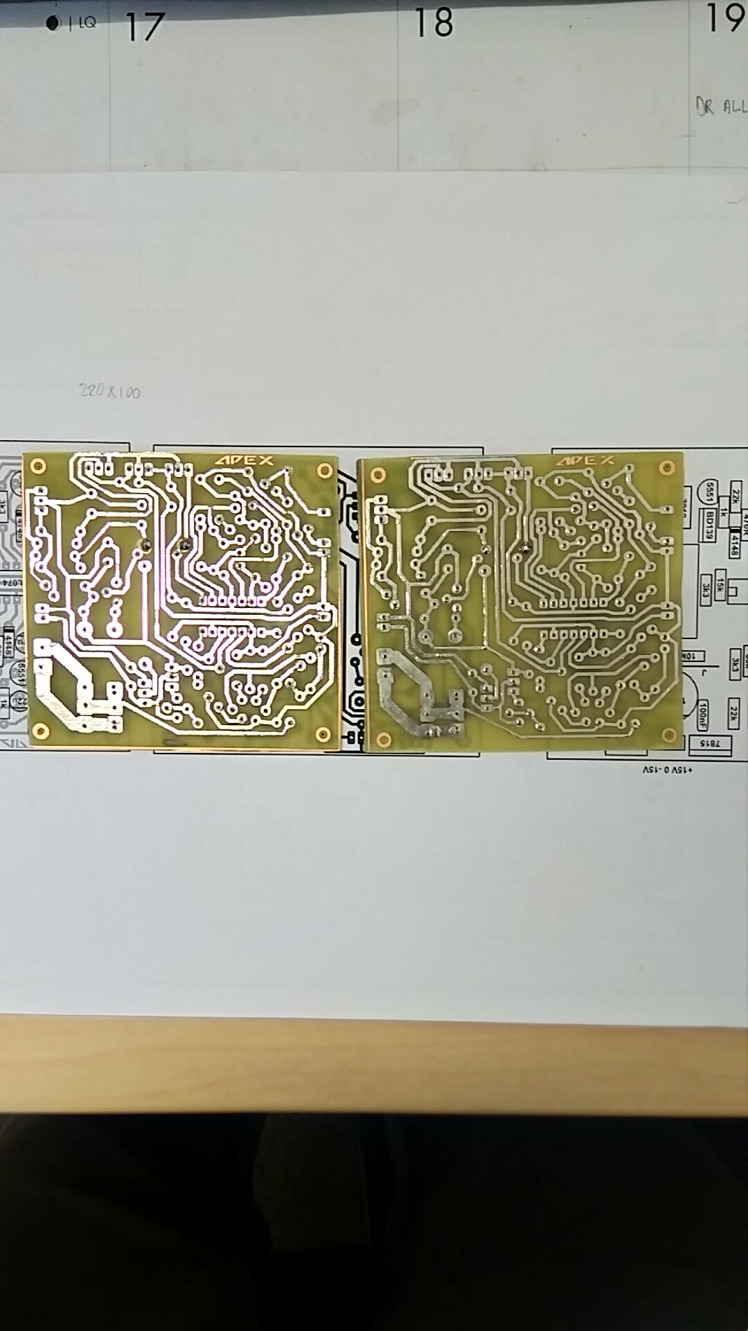

A nasty PCB, without numbered parts ... could be better. However, the schematic should be in correlation with PCB.
A nicer PCB is the one posted by @student II although the distance between PCB tracks should be checked there!!!
Regarding the schematic, you would need a resistor or jumper between SGND and GND, very useful especially if we want to test only PCB amplifier.
Fuses should protect all the amplifier. I'm saying this because in my experience I had customers who have dropped cognac inside the amplifier - through the air vents of the casing - and so there was a short circuit in the VAS circuit. The lack of fuses to interrupt this was useful because it limited the damage. So you never know who you sell your amplifier !!! There are rare cases, but they can exist!

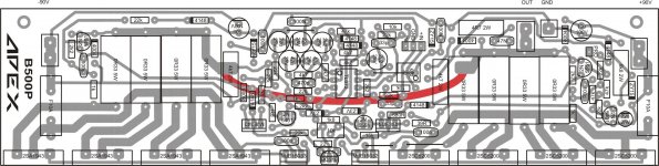

Ola yo poderia hablar castelhano pero esto es un english forum, so you should speak in english. I gona send tou you information about B500P.
Regards

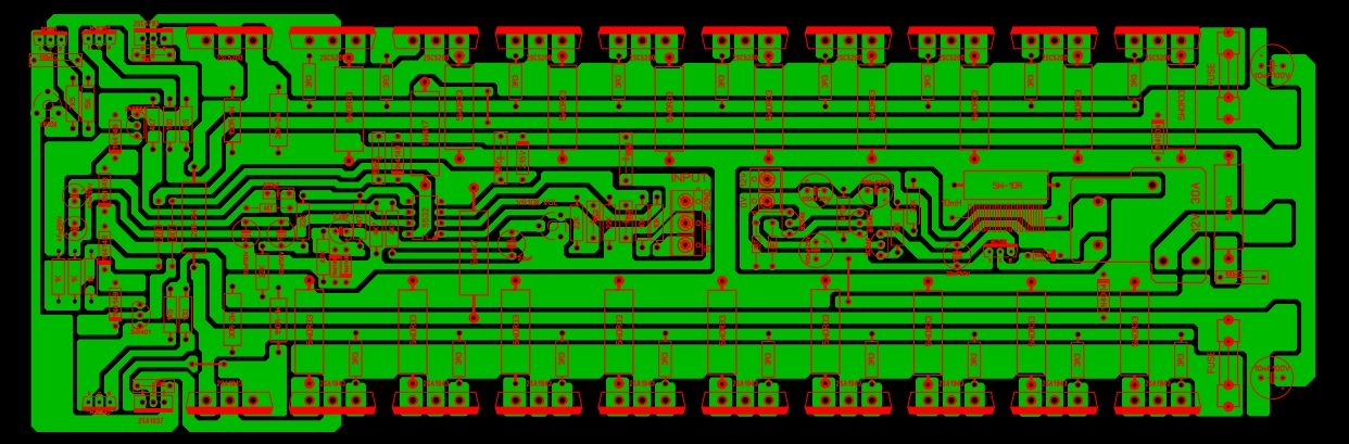

Hİ friends,
can any one tell me pls what is different with B500 and B500p? i start pcb but i like make my own. but now i see there is another pcb B500p just a little bit different from B500. please some one explane this.
i just finish my pcb desing but not check if there is a anything wrong. in 2 days i will start make my B500. ty to apex for share it.

As you can see in Post #3432, you have VI limiter as well as Prot. detection to activate PSU 7 Protection, and you have more: Led indication for ON, Signal and overload.
Regards
