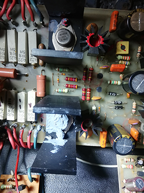

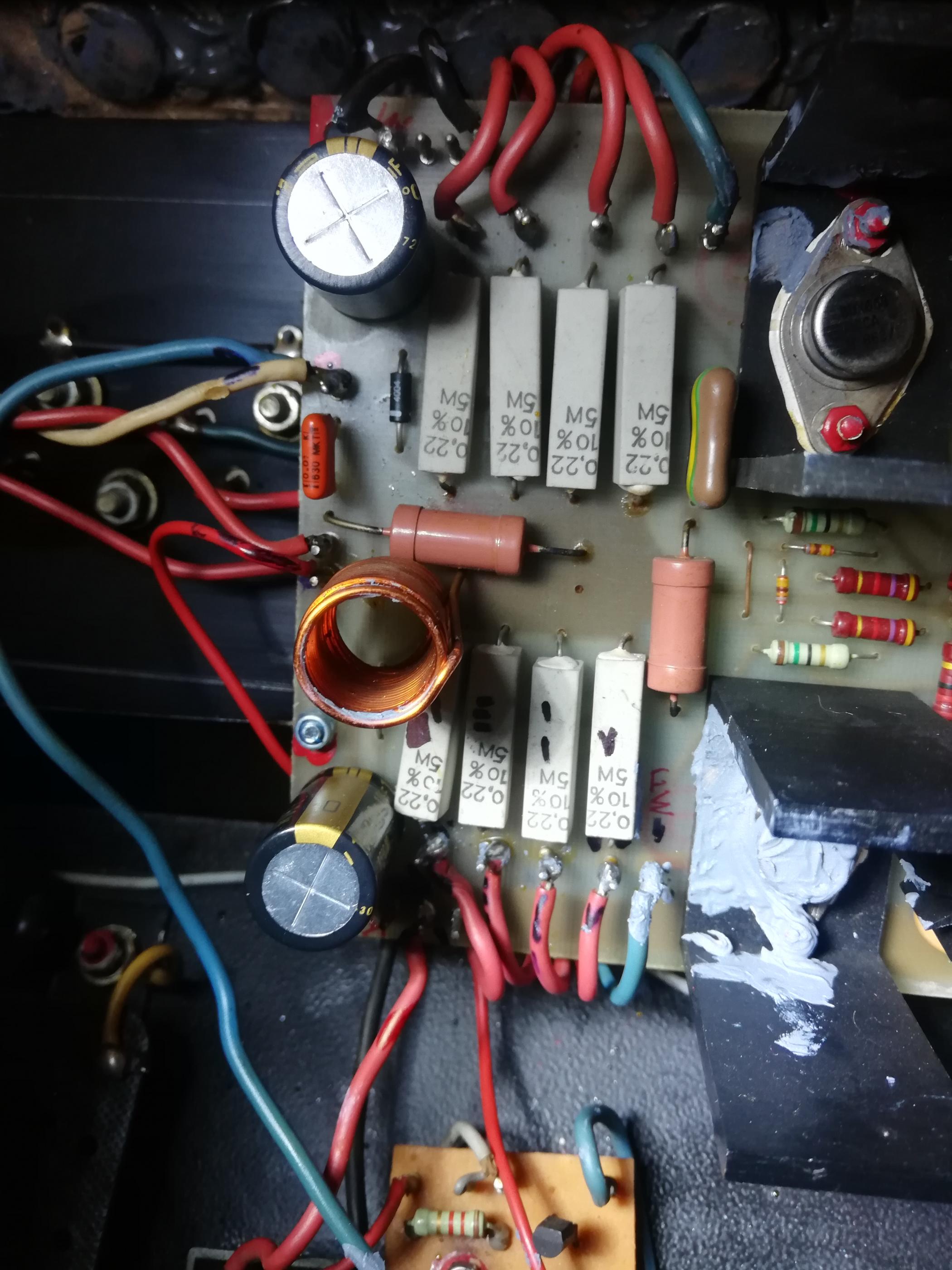

I fixed an old Amp 2x250W Rms it has four pairs mj15003 and mj15004 and a Darlington driver 2n5015 with bux67 and 2n3440 with bux66 (I don't remember which is pnp and npn) but I am sure for the numbers
I fixed an old Amp 2x250W Rms it has four pairs mj15003 and mj15004 and a Darlington driver 2n5015 with bux67 and 2n3440 with bux66 (I don't remember which is pnp and npn) but I am sure for the numbers. But I'm not sure for the Vbe if I put it about 500mv transistors get very hot quickly if I keep it about 380mv then temperature is not too high I can touch them what is the best option?
The technician who made it erase the transistor numbers from the protection circuits on purpose.
Service was a challenge for me. I change all caps sound is very clear. for me
Main Voltage is +62V 0 - 62V
The voltage between the base of 2n5015 -2n3440 is 3Volts and between bux67 -bux66 is 2Volts
I am not sure for the Vbe of mj15003 and mj15004 why to put it at 600mv it gets too hot quickly the drivers don't have o good cooling system the out put transistors have a fan might be ok? but driver don't I don't know what to do?

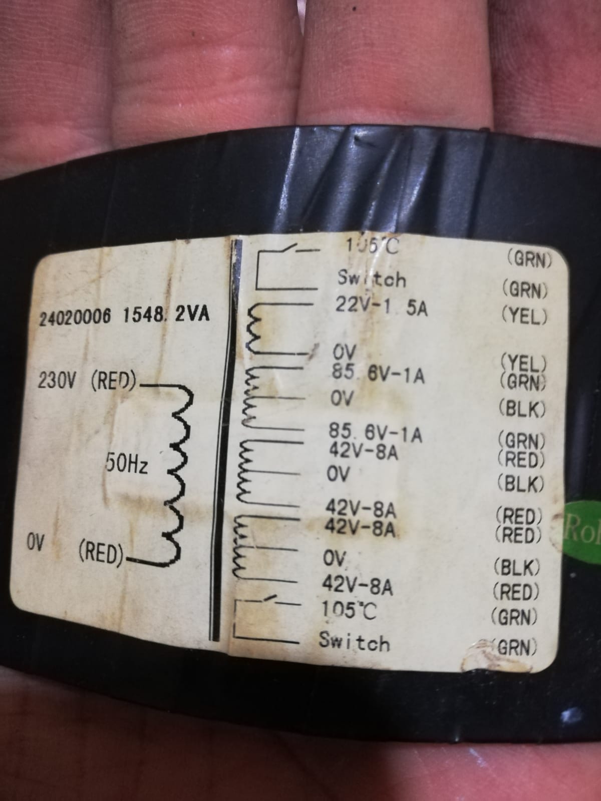

hi friends.

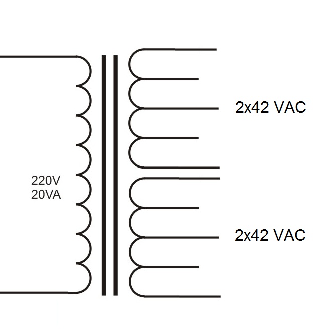

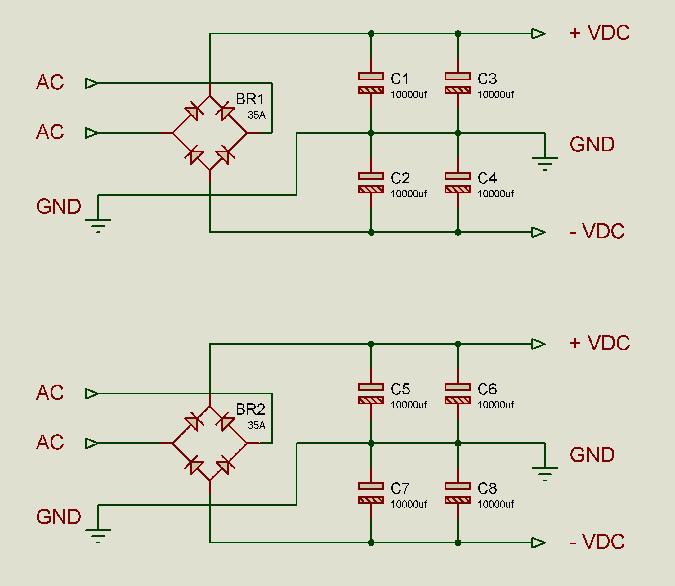

i find this transformer from old amp and want to use it for b500.
i want use first 2x42Vac for one channel and another 2x42Vac for second channel. i will make this schematic for power but i want to know do i need to connect all GND from 2 different PSU ? or need to work like a 2 different mono amp. which one is better.
thank you.

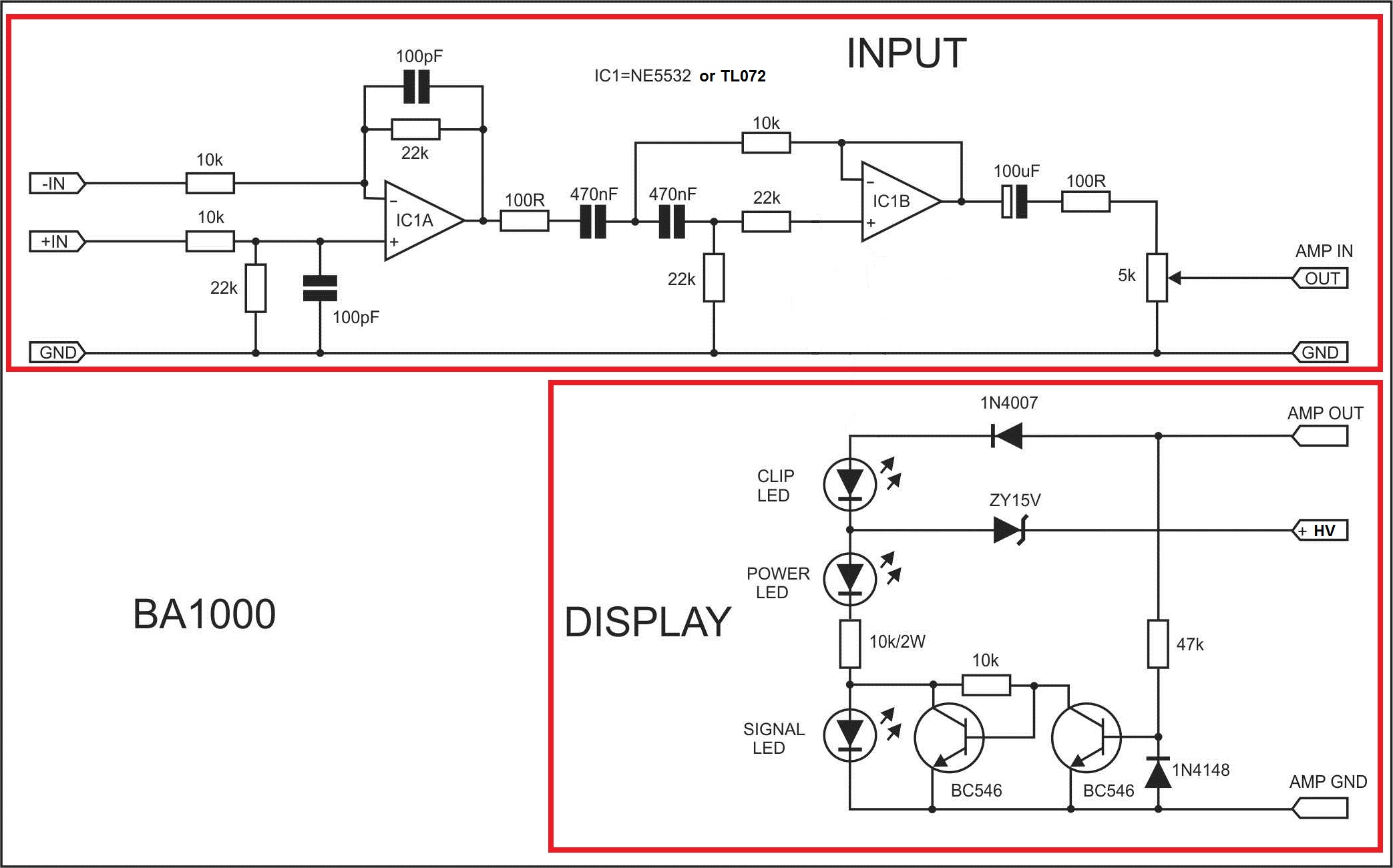

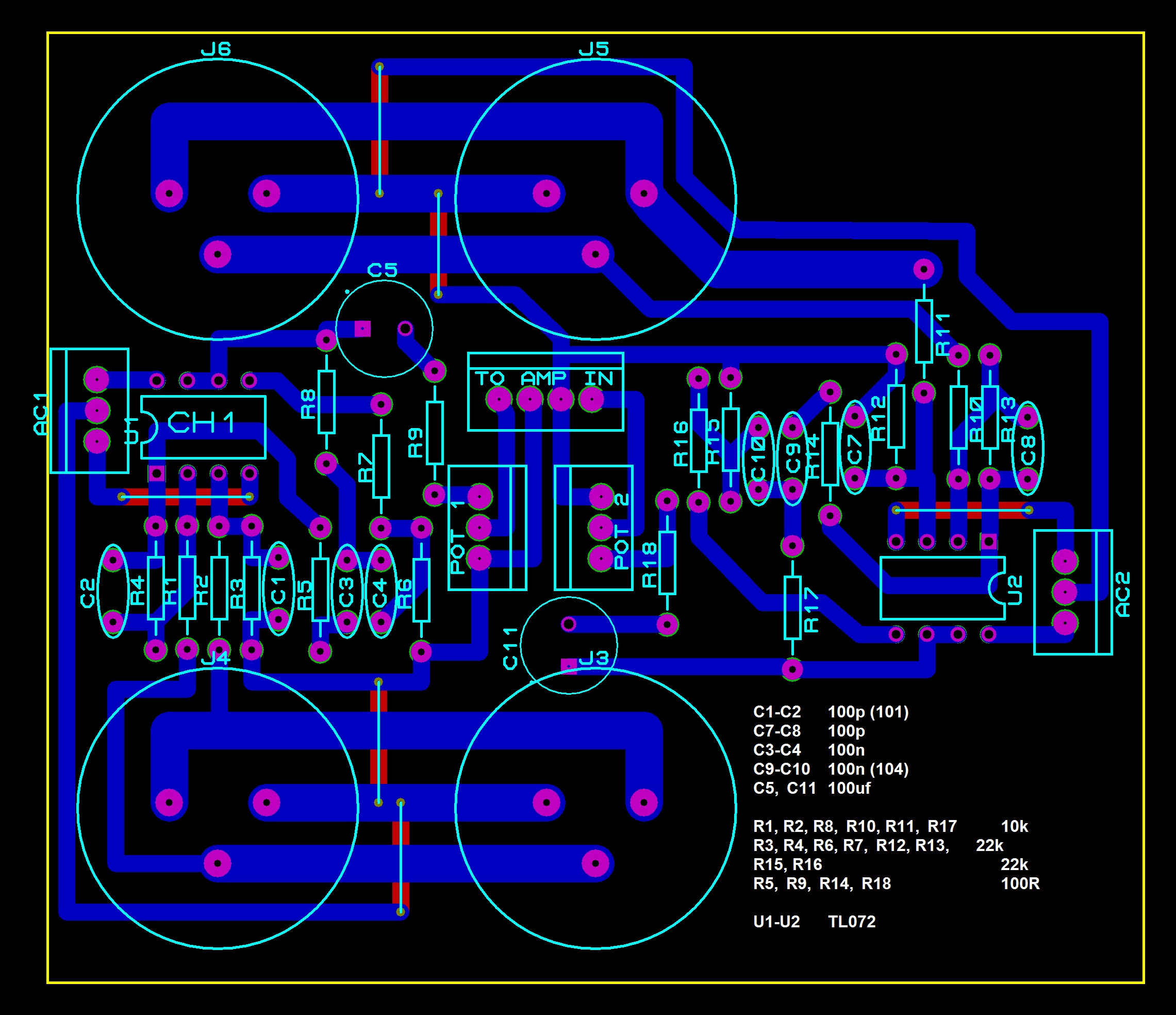

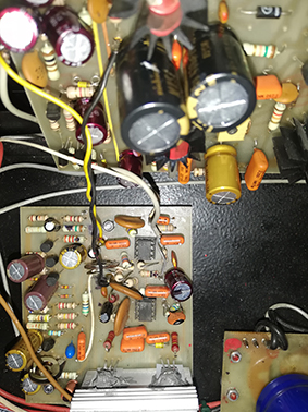

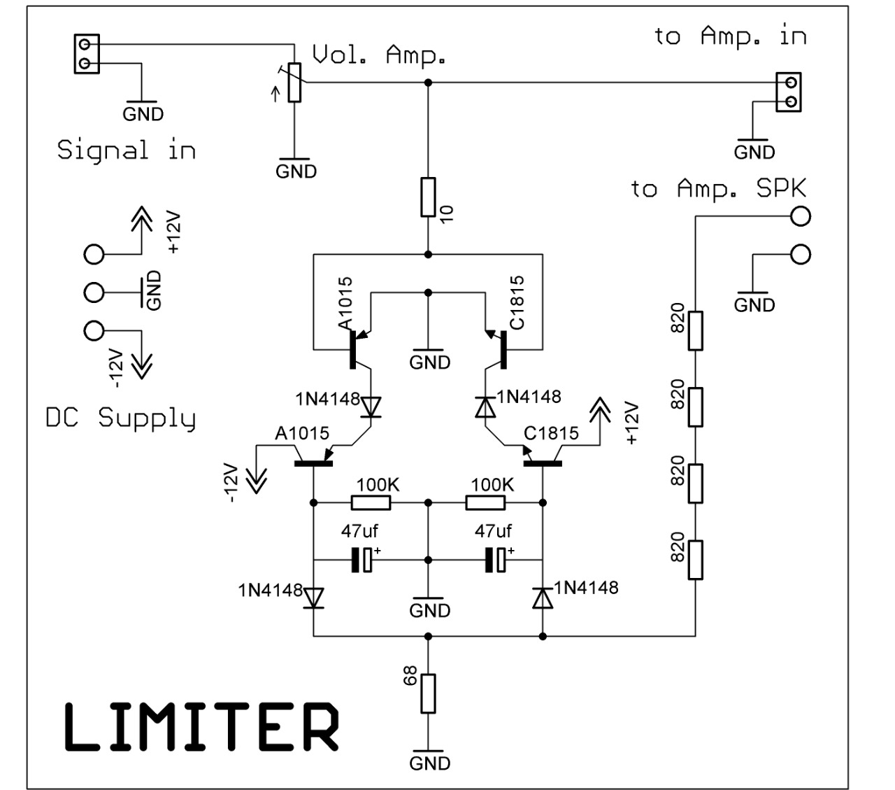

hi friends..
i want to add input board on b500 amp. but i dont want limiter on input. this is ok if i change shematic from apexaudio like tis and add on my b500? there is signal and input is different pcb. if any one make input from apexaudio is there any changes or values i need to change for my b500?
on schematic there is 2 470n i dont have it and i put there 100n is this ok? :confused::confused:

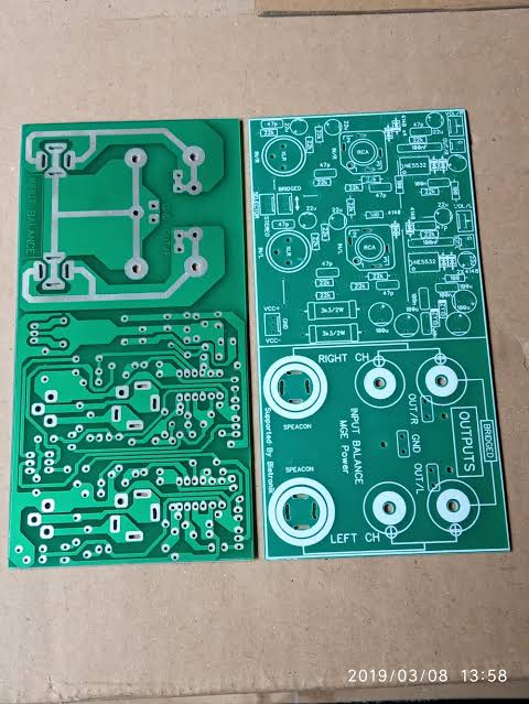

Pcb inbal

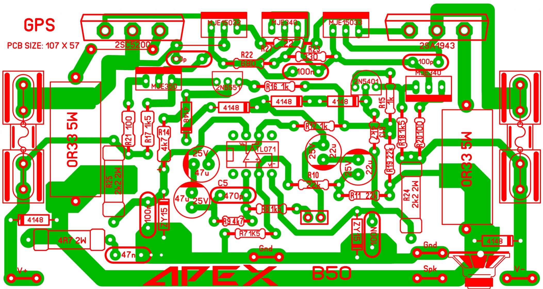

I have try to make B50 PCB layout without darlington output transistor. I am used c4793/a1837 as as a driver and to c5200/a1943 as output just like B500. Please check for any error.
