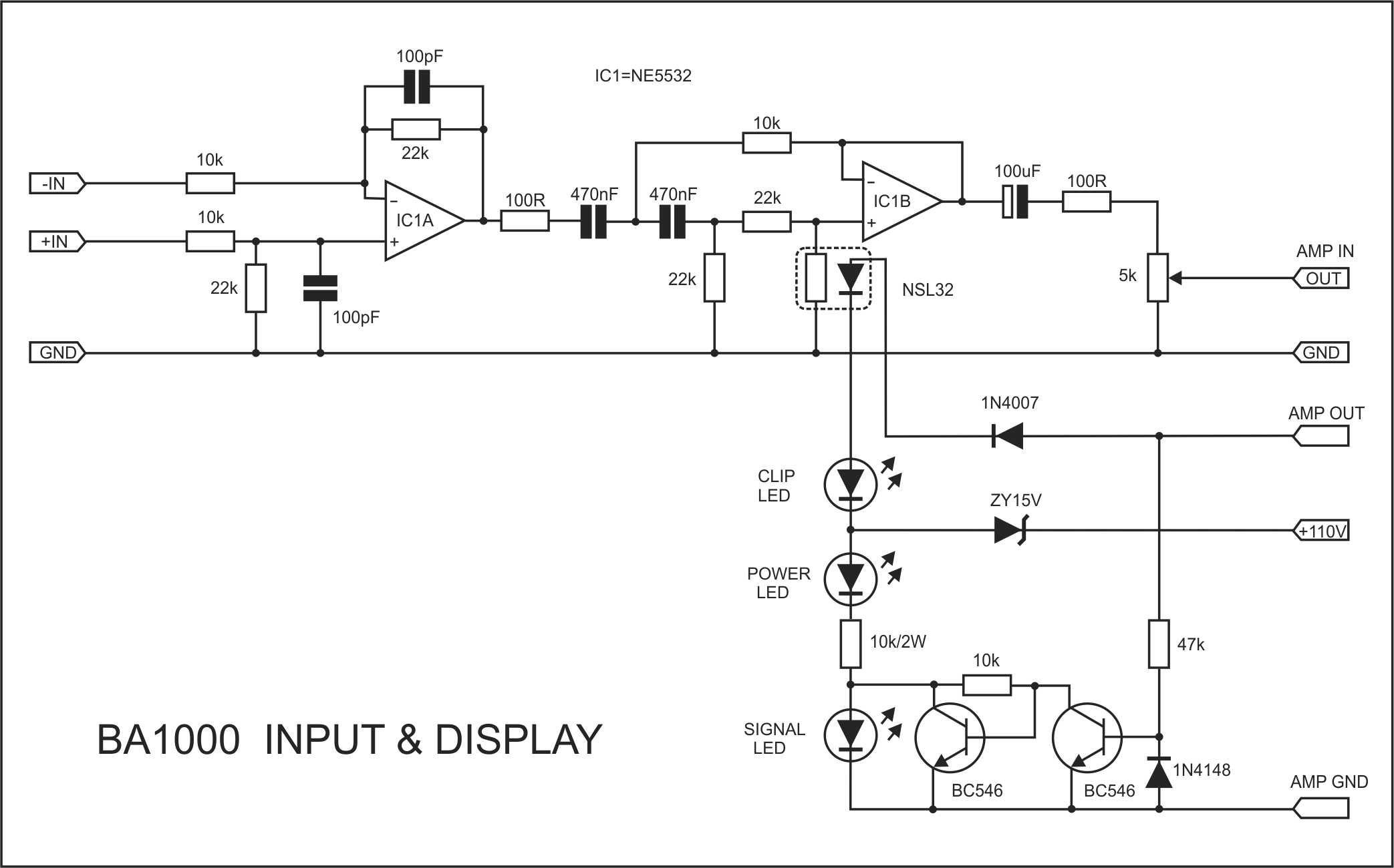

hi friends i finaly test my b500 in the bar for a sub bass pa amp. before amp i put professional crossower. and then connect to the b500 amp to 2 8 ohm subbass. but this volume and bass not enough like a 1000w. mid range is more then bass.
inside the b500 amp i use apex ba1000 input and display circuit. i dont use limiter and display parts. there is any thing i can change for more bass and volume? i think that 10k resistors can be 1k for volume but i dont know what can i do for more bass.
thank you for answers

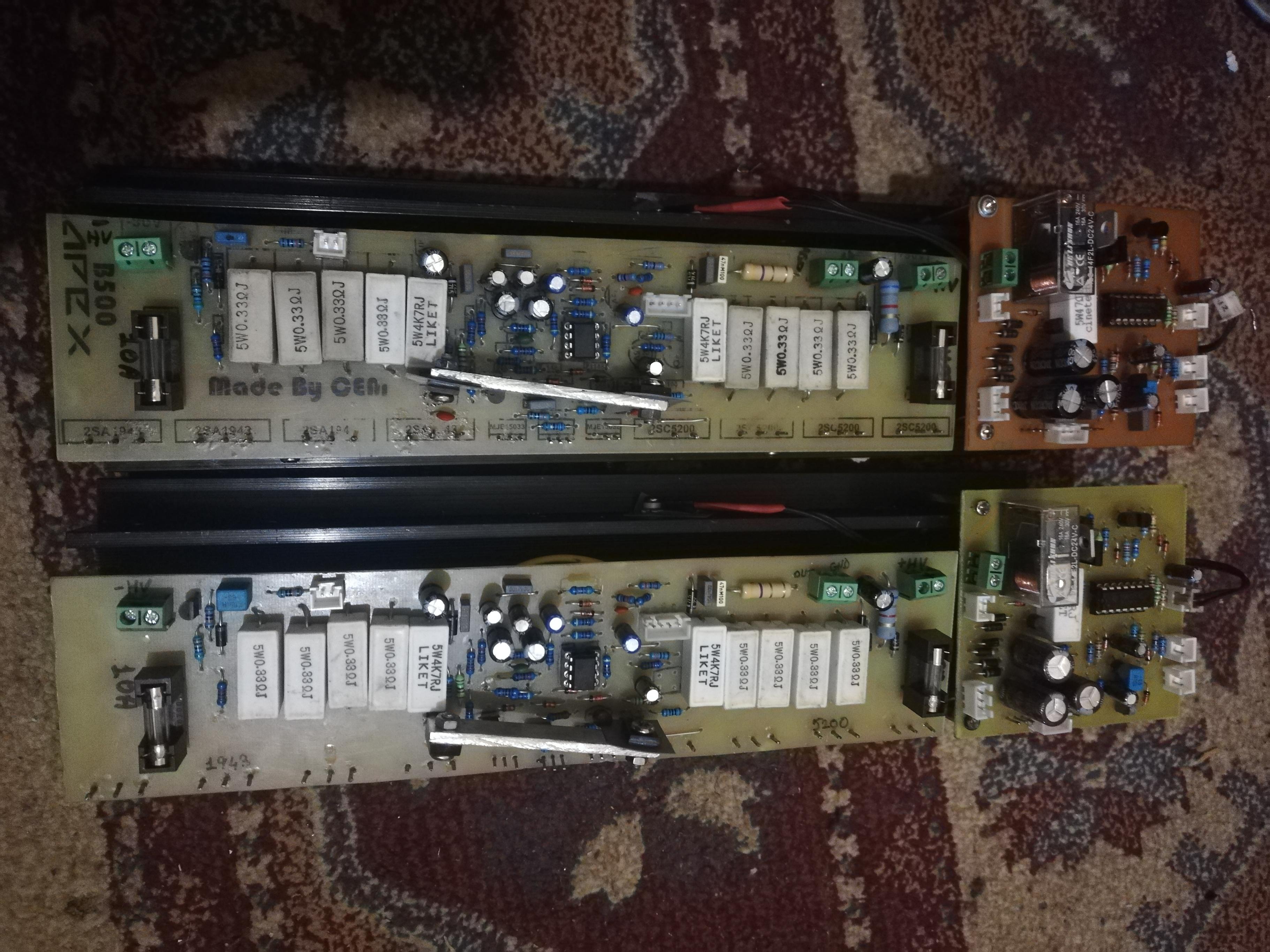

B500p
Is BC516 correct or BC517 in B500p, Schematic shows BC517...
B500P pcb

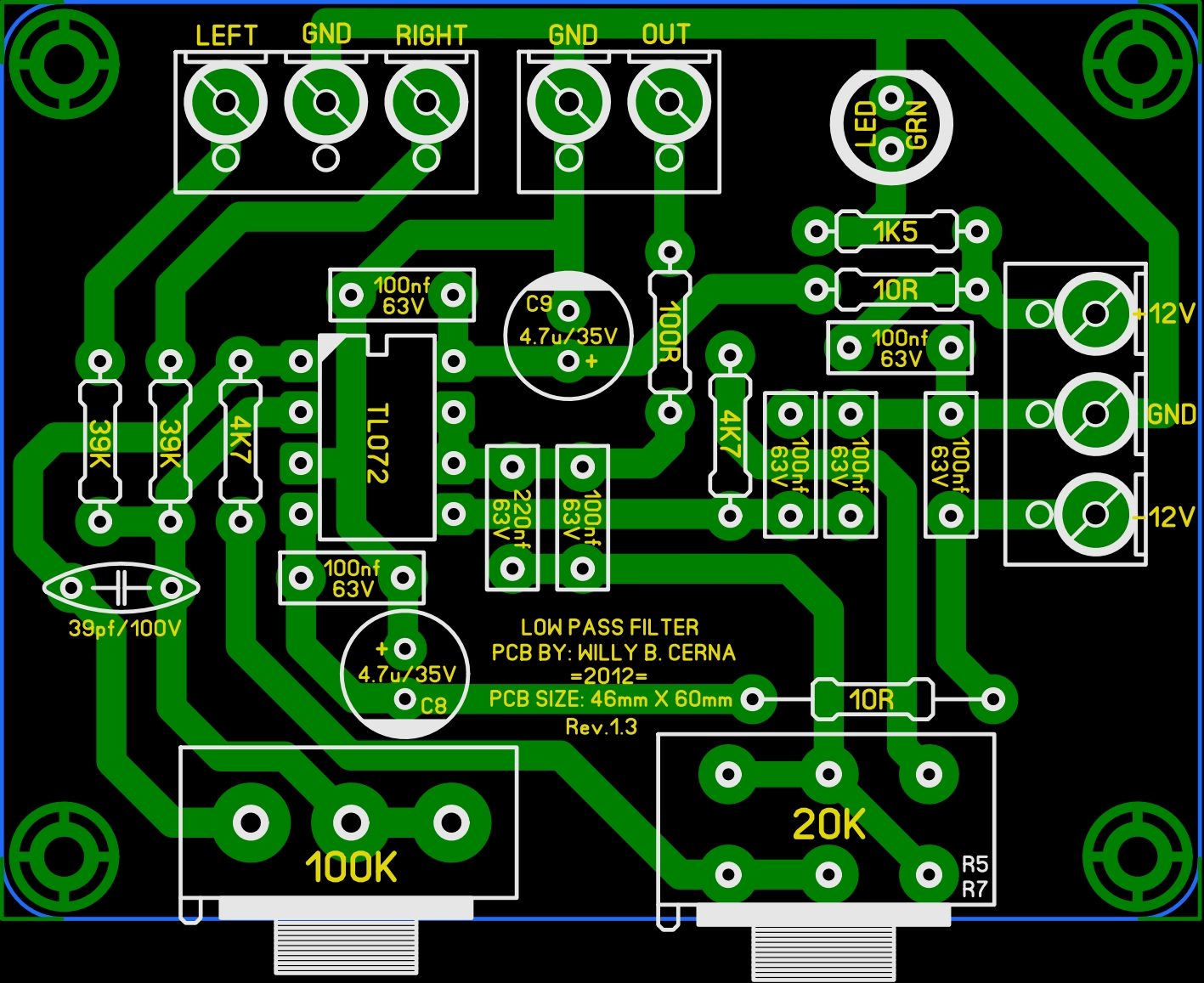

Need active low pass filter for B500
Hello Mr mile sir
I am going to build B500 in 250w/8ohm,
Can you have good active Low pass for B500. I want to give low frq to B500 and mid & high to I already build Ax-14. Can you help. It's good if you have for stereo.
