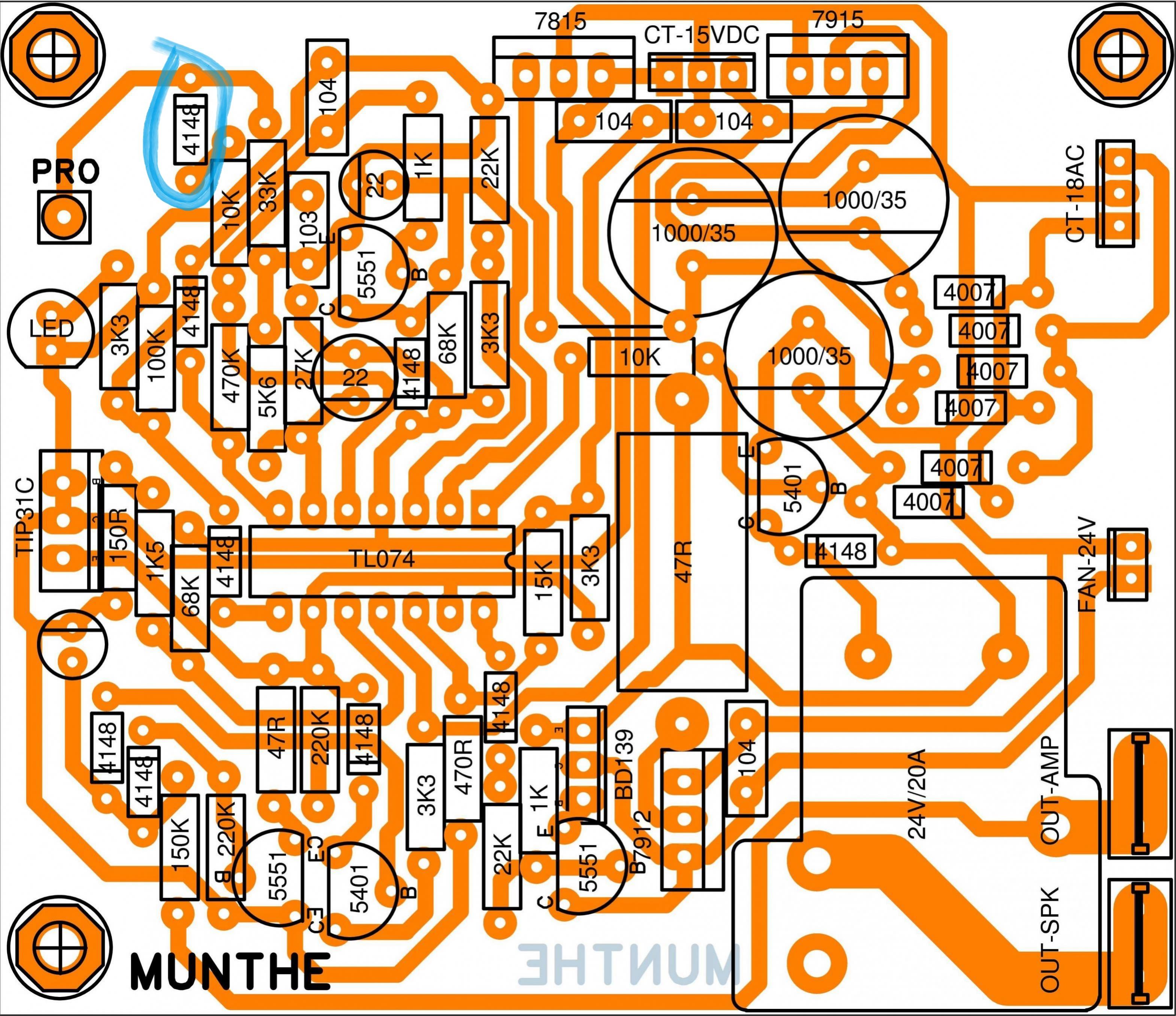

Now can you correct the wrong places in the diagram and send it to me? The diode isn't reverse like I said, is it?

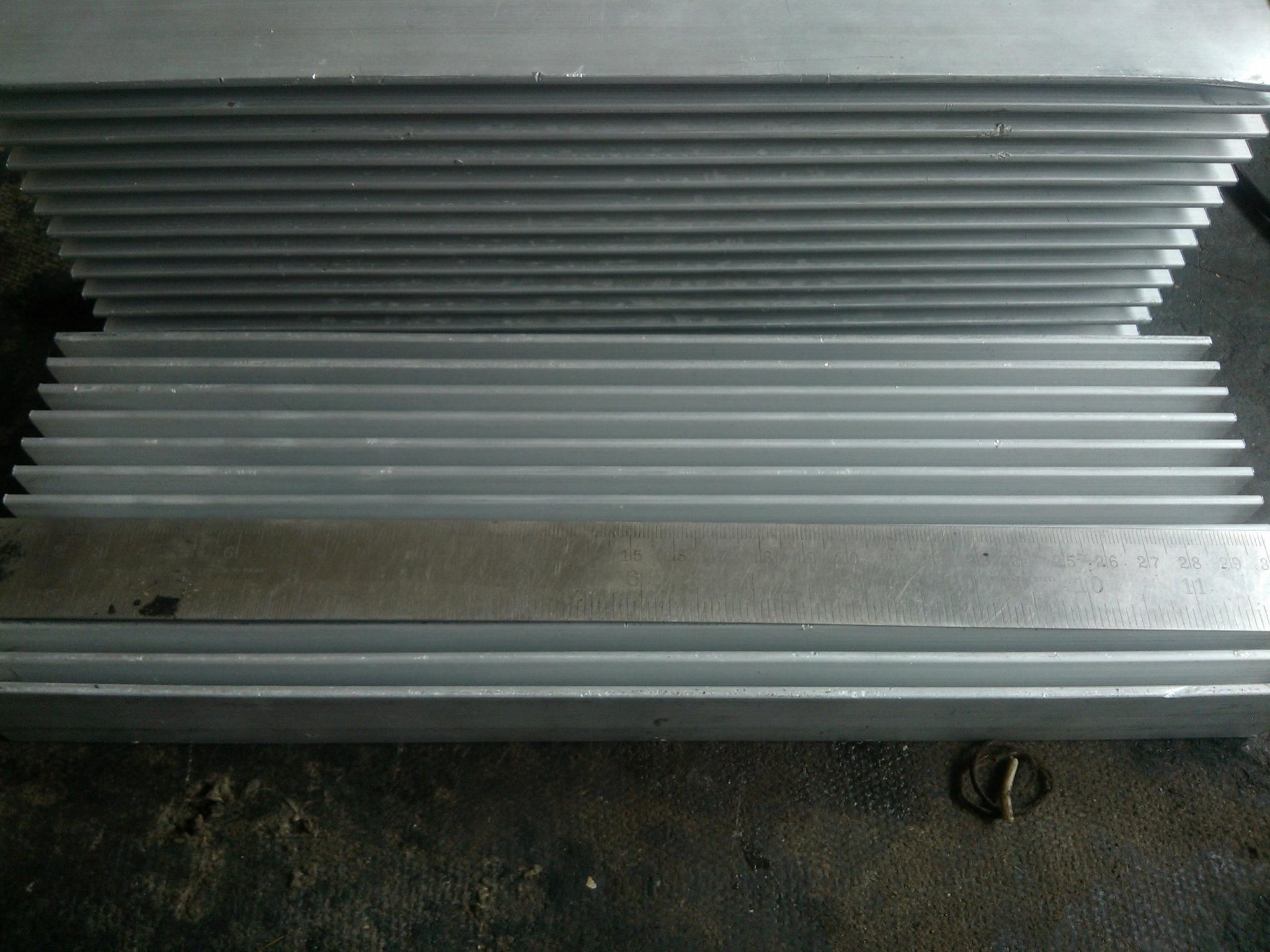

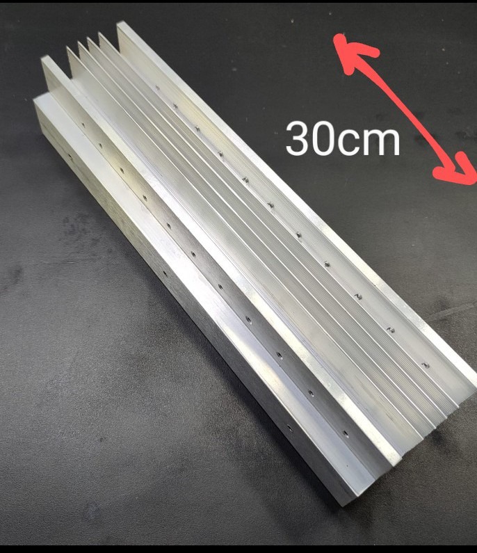

whear did you get that heatsink please help.

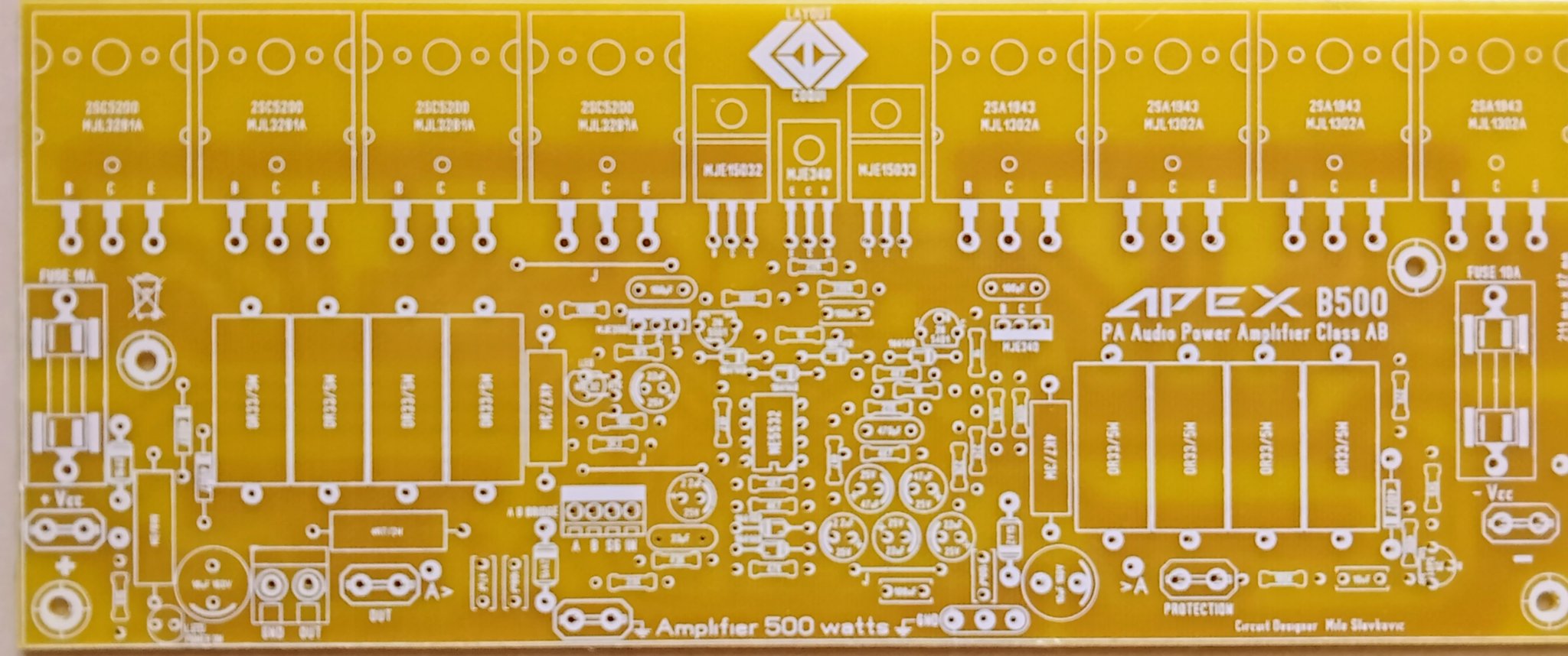

Can anyone tell me ,
Who design this PCB because I am confused about, Apex sir layout and this PCB have little different is this B500P PCB or what.
Please help
And is this Heatsink ok for B500 mono
Please help
