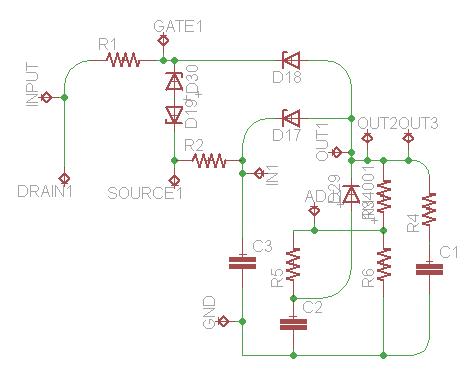

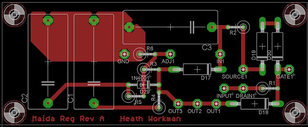

I just did a board layout for two Maida regulators on a single board and am willing to share gerber files if you are interested.

It's not really my design. I just lifted it from Jones's Valve Amplifiers and the Michael Maida paper. I used the input bypass cap (C33) that Jones uses but that Maida states must not be used if the regulator is to survive a short circuit. There is a trade-off here between robustness and performance. I guess don't bypass the input of the LM317 if you want it to have a chance of short circuit survival.
I chose the divider values to pass enough current to guarantee regulation with no load. The 50k is a 1% caddock thick film power resistor bolted to the chassis. They don't offer many values, so I change R35 to change output value, adjust on test. LM317 is supposed to have 1.24 or 1.25V between output and adjust pin so just use Ohm's law to figure out a new value. Let me know if you have trouble.
After my rectifier prior to the regulator I have...a capacitor, that's it. I never used the inrush limiter and I used 100uF for the filter cap. I stacked two 200uF caps with equalizing resistors because these 800VCT Hammonds put out a lot of voltage.
Would you like me to whip out a board with a single Maida on it or are you interested in the double board? It would be trivial as I just have to delete half the board.

I'll try to whip out a board soon. Gotta do some yard work today. My wife is crackin the whip already.
You can download a free Gerber viewer here:
http://www.pentalogix.com/Download/download.html#item8
I looked at your gerbers and they look like the picture you posted in an earlier post.
Thanks George. I'll download that program and test it out.
For the leads that go into the board, I intended on buying those test point loops and soldering wires to them. That would also make a convenient point to hook a scope probe.
I'm open to any pointers on improving the board.

I use pentalogix also ... good free program.
There is another site that you should use - freedfm.com
You can submit your gerber's and answer questions about the design (size, layers, silk etc) and they will analyze your design and send you a report and a quote.
and it's free...
and it's free...

OK, I have been giving this some thought today. Here is what I have come up with.... I will follow Tubelab's LTP driver board as linked above pretty much to the letter. Drivers will be Octal 6SN7.

This should work well. I used Maida type regulation in my original 300Beast amp, but the regulator blew up twice, creating a bright red glow in the 300B's, so I ditched the regulator and switched to a choke input filter which gave me about the same voltage. I don't think that is possible in your case. My mosfets were rather wimpy, so I think that's why they fried. The Maida I have now has a monster 1000 volt fet that costs $7. It hasn't fried yet.
Add an ordinary diode (1N4007) from the regulator output to ground in the non-conducting direction. This prevents the B+ from being pulled negative before the rectifier tube warms up.
Keep in mind that you will be dissipating some serious power in the mosfet. Your transformer will put the B+ in the 480 to 500 volt range, maybe more (it is a Hammond!). The idle current for each channel is around 150 to 170 mA (100 mA for output tubes, 10 mA for the input tube (total), 20 mA for the second stage, and 10 to 20mA for each mosfet. Current at full power will increase to 220 to 250 mA per channel. Assuming a 100 volt drop across the mosfet, and 200 mA of average current you will burn 20 watts per channel in the mosfets. I would use two Maidas, one for each channel. This will spread out the heat and improve the channel separation. You are still going to need something more that the chassis for this.

primaries for 115 volt input, but plug them in to my 240 mains
You can't do that. The 115 volt primary will not have enough inductance to run on 230 volts. It will draw too much current and usually leads to a rather smokey result. Someone told me this a long time ago when I wanted to use a 115 to 75 volt trasnformer in reverse to make 150 volts. I didn't believe them and I stunk up the whole house. The 2 X 55 volt windings can be used as is to make about + and - 75 volts which is enough for the 7591's but may be marginal for 6L6GC's or 6550's.
but this is twice now that Tubelab has advised a separate transformer for lower-voltage supply to MOSFETs and bias. I would be foolish not to take that advice
OK, don't get me wrong. I use the seperate transformer approach because it is the easiest way for ME to get the job done. In fact my version of this amp may indeed use one transformer. It just happens to have a pair of 70 volt taps which will make an easy + and - 100 volts.
You have OD3's, and want the cool glow. I would go ahead and use one as the reference for a mosfet follower type regulator. Feed it with a solid state rectifier for instant on negative voltage. I used this approach in my 845SE amp. The Allied power transformer feeds a 5AR4 into a cap input filter for driver B+ (about 450 volts). The same winding also feeds a pair of solid state diodes into a choke input filter for the negative supply. I get about - 400 volts which is used directly by the PowerDrive board to feed the 845's. You can use a negative voltage regulator here, which could be as simple as a resistor, an OD3 and a P channel mosfet.
