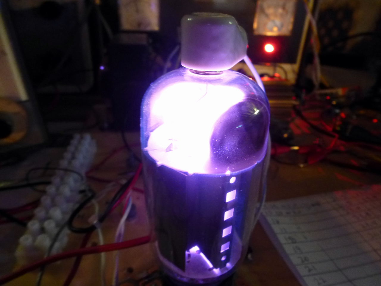

Have you ever seen lightning in a bottle......how about a full blown thunder storm! Well, I created one today. This happened just testing tubes, but when you are playing with 600 to 750 volts at over an amp, stuff can go wrong quickly. This was just a bad tube.
