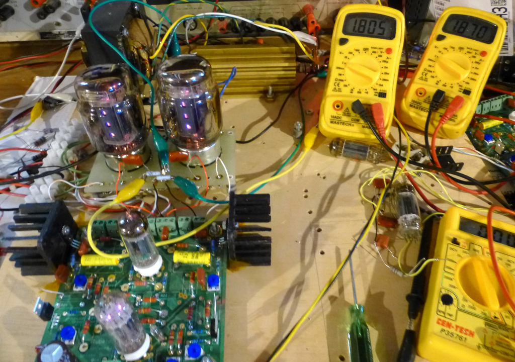

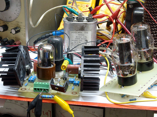

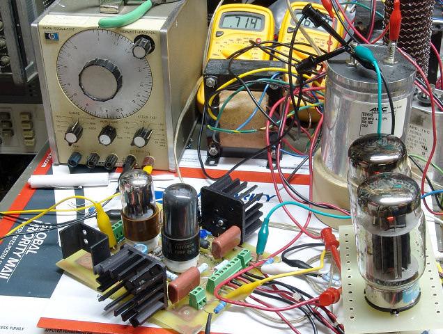

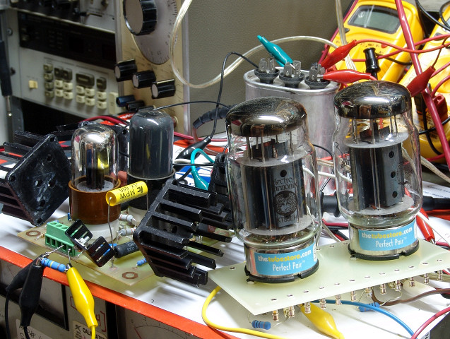

I found a few pictures from the 6L6GC AB2 design days.
The 9 pin boards allow for more flexibility with tubes. I have had good luck with some 5751's in the first stage.

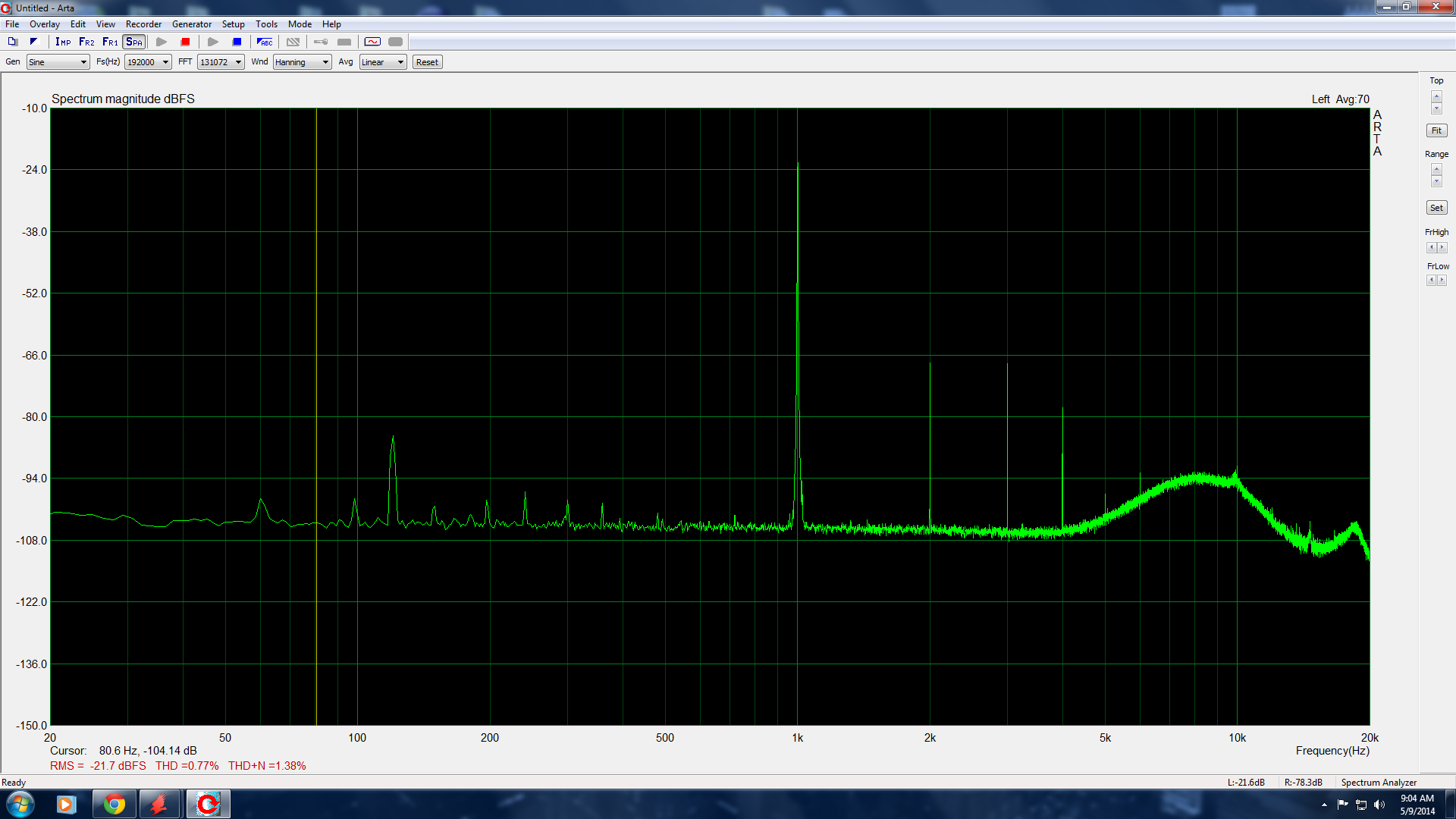

ETA: The first graphic is CCS-loaded 6SN7 @ 200Vrms, second is 841 @ 230Vrms.

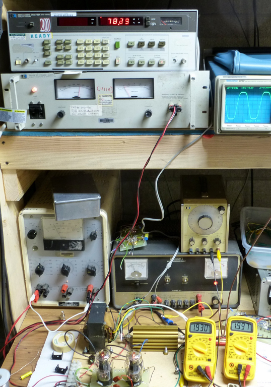

I have put the breadboard back together, wired for common octal audio tubes. The driver feeding into the 8903A audio analyzer with no output tubes installed reads 0.14% distortion at 30 V RMS output. More testing is coming......I can smell the aroma of glowing tubes.

I plugged in my crispy old set of Chinese "6L6GC's" wired in pentode mode. These tubes came to me in a Fender Bandmaster. A friend asked me to put some new Russian tubes in his amp, he had grown tire of the Chinese "Ruby Tubes" that were in there. I did so, and decided that the Rubys would be used for "testing." These are the same tubes seen in post #127 making 75 watts with 500 volts on them, so I set the amp up under the same test conditions, and let it rip. They still put out 75 watts at 1.8% THD, and still hit clipping around 95 watts. 3300 ohm load 500 volts B+, 400 volts G2, idle current 50 mA.

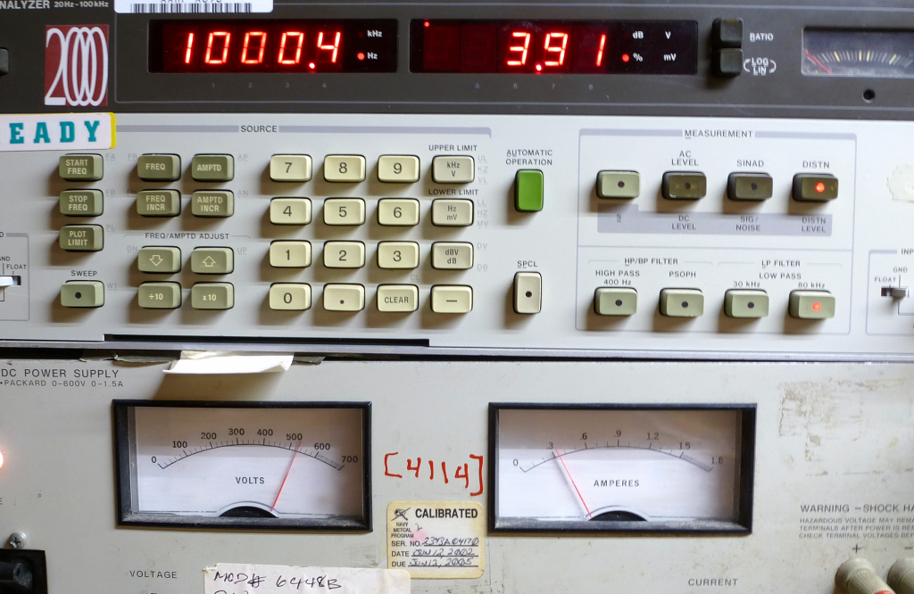

I then wired them as triodes, 500 volts B+, 3300 ohm load, 50mA idle, and cranked the drive until I got severe clipping.....watt meter reads 78 watts. OK, it's alive....
I was asked about 385 volts in triode, so I went there. I have a 6600 ohm OPT that works well at 3300 ohms, so I tested at these two impedances. No feedback was used. I'm guessing the best spot is somewhere between these impedances. THD at various power levels:
Power THD @ 3300 ohm load THD @ 6600 ohm load
1W 0.177% 0.183%
10W 0.91% 0.90%
20W 1.63% 1.69%
30W 2.73% 4.41%
35W 3.70% 10.86%
40W 5.42% severe clipping

I'd be curious if h3 is dominant.
I would bet that H3 is the dominant harmonic, there should be very little H2. I have not set my FFT PC up yet. Still need a few bits that are in a box somewhere. I have moved twice since I last had my lab set up. Can't find squat. I'm still missing two power supplies.

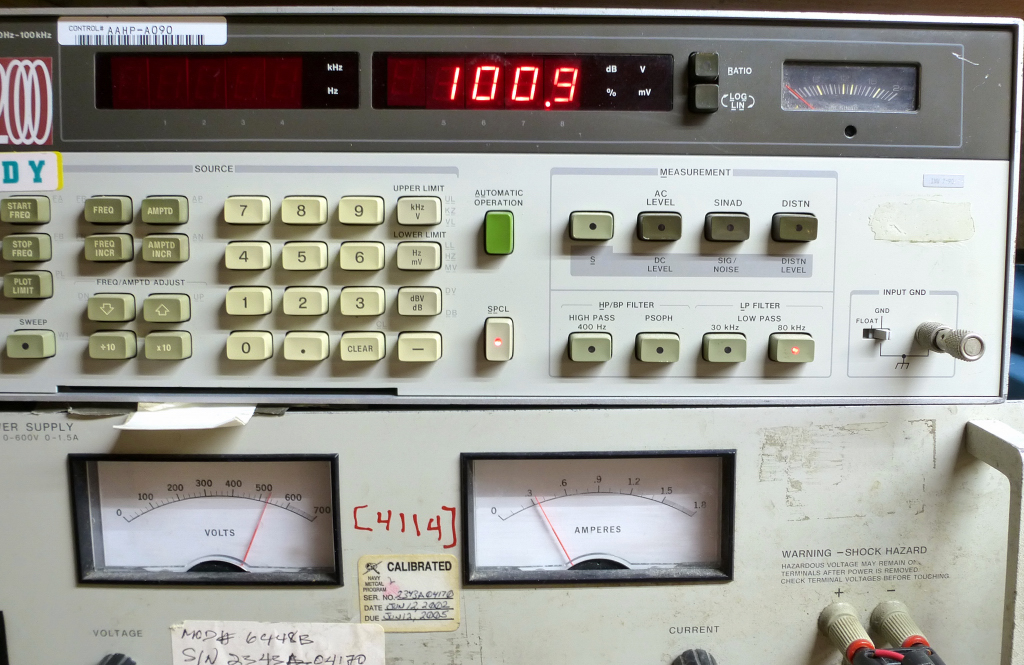

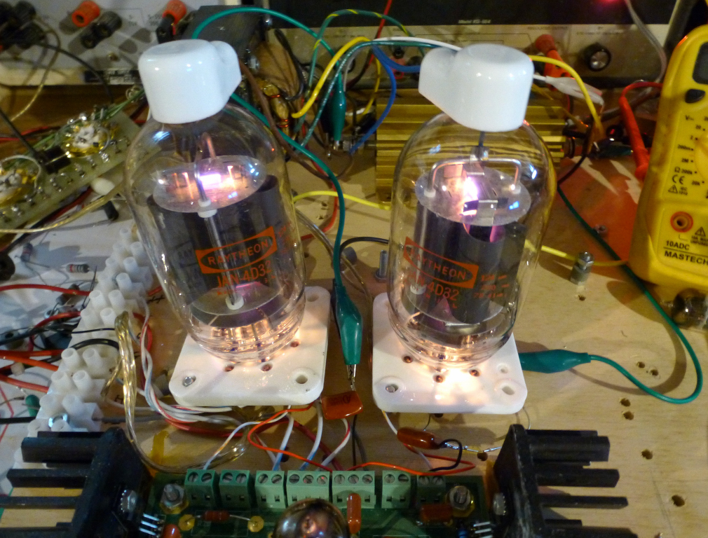

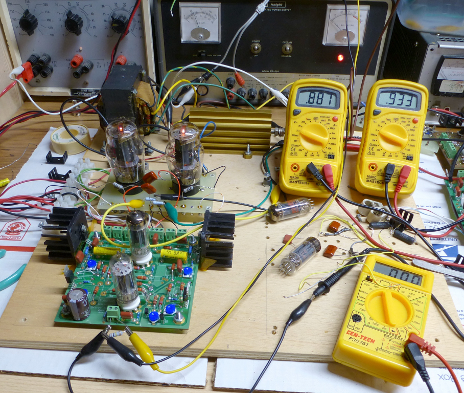

I plugged in a pair of 6BQ6GA sweep tubes. They have the same pinout as the 6L6GC except there is a plate cap, wire it to pin 3.....Do not try this unless you know what you are doing. These are NOT compatible tubes unless the amp is designed to deal with tubes having really different characteristics. The 6BQ6GA's cranked out 100 watts without complaint on 500 volts. Screen voltage was 190, idle current 50 mA.
1W 0.115%
5W 0.150%
10W 0.334%
20W 1.152%
30W 2.033%
50W 3.27%
75W 3.99%
100W 3.41%
I had a pair of unmarked tubes. It took 25 volts on the heater to make them light up, and they looked like 50L6's, so I am assuming that's what they are. I decided to see how far they would go before turning into red light bulbs.......40 watts brought some pale glow in a dark room and 44 watts brought clipping. More plate voltage invited runaway, and a bright red glow. Yes, I bent the plate voltage spec a wee bit......400 volts! 120V on the screen. These tubes seemed OK at 400 volts and 40 watts for about 10 minutes.
I tried a pair of 6Y6GA's with about the same results, 40 watts on 400 volts.

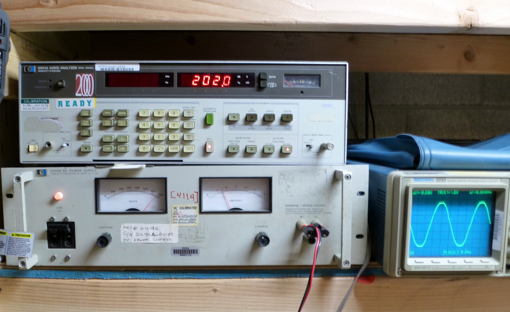

What can they do......202 watts on 650 volts. That's the limit on my power supply. The load resistor is only good for 125 watts, and the OPT is only rated for 80 watts in guitar amp duty.....I haven't blown anything up, or set anything on fire yet, so, for now, I'm going to quit while I'm ahead.
