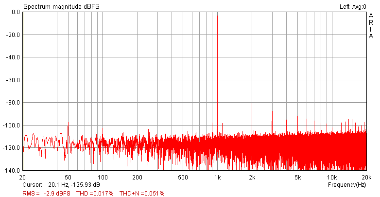

This chart is from triode-wired push pull KT88s in a 14dB feedback amp that I once made. The output level is low, near 1W, not to fry the audio PC card. Has higher 2nd than 3rd although symmetrical output, but that maybe comes from the drivers mainly, and/or output stage imbalances.
The amp designed here is fully symmetrical from input to output. In theory it should have near zero 2nd harmonic output. Surprise...Mine has higher 2H than 3H for most operating conditions.
It is common belief that push pull amplifiers cancel all the second harmonic generated in the push pull stages. This is only true if everything is perfectly balanced for every operating condition. What are the chances of finding a pair of output tubes that have exactly matched Gm over the entire current range that will be seen in the amp? What are the chances that they will stay matched after a few months? Is your OPT perfectly balanced from one side to the other for all audio frequencies?
It has been my experience that the 2H can be minimized at one frequency and power level. it will creep up as you deviate from the conditions that it was adjusted for.
I find that amps (especially big amps) often sound better at low volume levels if the output stage is a bit off balance. This may be due to the ears preference for some 2H or it may be due to moving the transition through the OPT's dead zone out of the low power listening area (the "First Watt" phenomenon).
Here is another unexplained phenomenon. Put a load resistor on a big tube amp. Crank it to a fairly high power level with a constant tone (1 KHz works). Most OPT's will emit some sound. Tweak the output tube DC balance. You will hear a point where the OPT "singing" is minimized. This point will be at a DC imbalance, but tends to sound better than a perfectly balanced amp.

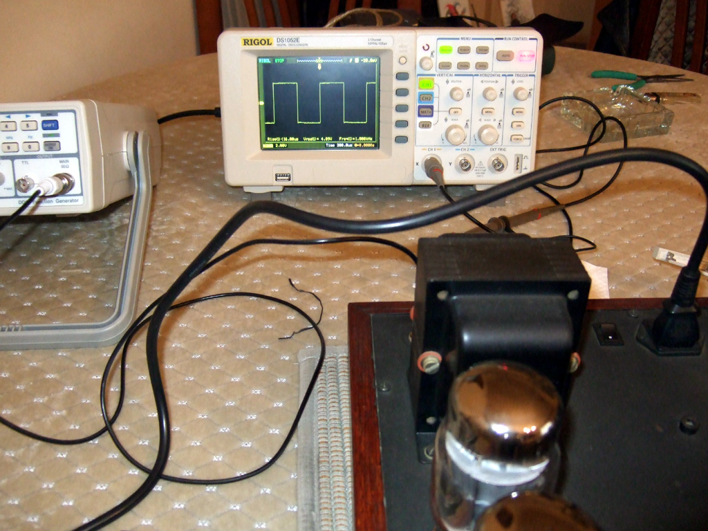

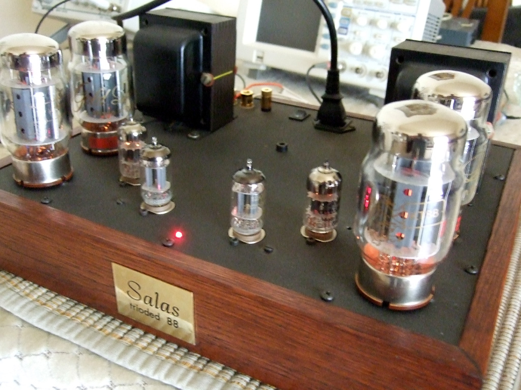

All you mention above is wise. Bias imbalance should be ''de-tuning'' the mechanical resonances of the output transformer's halves also. Some analogue ''dither'' maybe a delight, rather natural to accept. That one in the following pics was the amp BTW. Has non symmetrical paralleled sections 1st stage, and BJT cascode cathode side CCSed splitter. 235kHz bandwidth at 1W.
