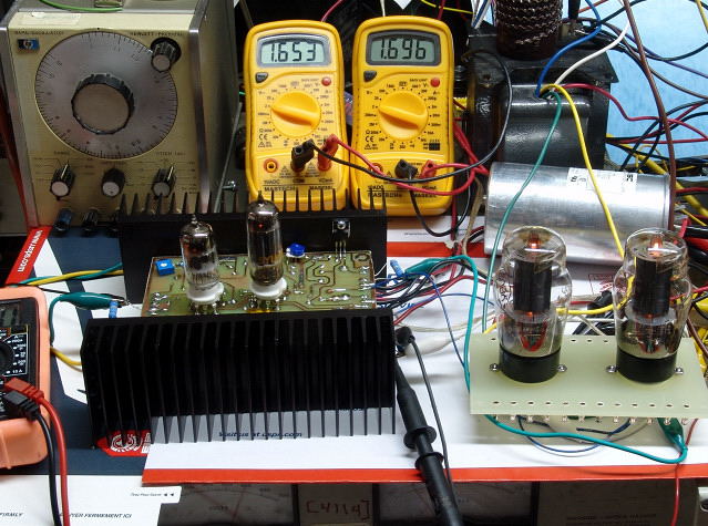

This was too easy, and rather anti-climatic. I wired up the 6L6GC P-P class AB2 power amp using the driver board I built yesterday. I have adjustable power supplies on everything so I set the knobs to what I remembered to be the max specs for an RCA 6L6GC, but there is no way I am going to put my black plate RCA's into something that has never been tested, NOPE, CHINESE. I got out my old friends the Chinese Coke bottles that have been seen glowing brightly on this forum before. The tubes were wired in pentode mode. 400 volts on G2, 500 volts on the plate 6600 ohm load. I set the current to 50 mA per tube (25 watts).

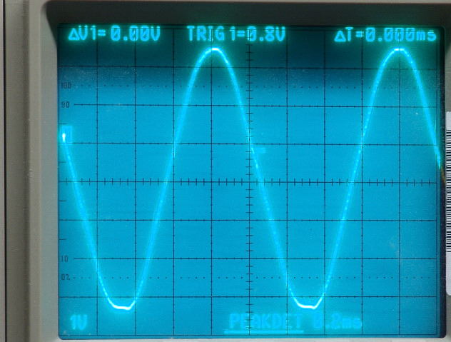

I started cranking up the audio generator. The power flowed freely. I cranked the generator up until the distortion meter read 2%. At 2% distortion the output power was 75 watts. OK, run it into clipping. 90 watts. Clean clipping, no ringing or funny stuff. Backing the power down to the 5% distortion point yielded 85 watts with visible clipping present.
I consulted the tube manual and found that the max screen grid spec in pentode mode is 450 volts, so I went there. It didn't help, in fact I think that I lost ground. The bias became touchy, power output didn't go up, so I shut it off.
I returned to 400 volts and played with the other knobs. I found that raising the bias current to 60mA per tube cleaned up the slight flatening that was visible on the bottom of the sine wave in the scope photo. Power at 2% improved to 80 watts, but the 5% level only went up to 87 watts. A full crank on the signal generator could make the analyzer read 104 watts but I am not sure how accurate it is when reading a square wave.
I also put the scope on the output tubes grid. The signal was swinging from -95 volts to +27 volts indicating the fact that the positive grid region was reached. We are well into AB2.

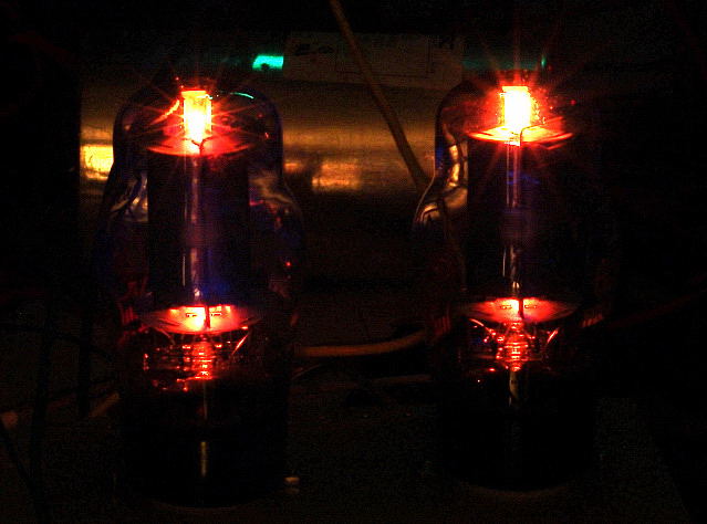

OK, I just had to take the obligatory picture with the lights turned off. We all want to see the glowing plates and melting grids, right?
Well, there aren't any. No GLOW, none, zip, nada, zilch! Maybe a little blue on the glass, but nothing in the red department. The red line seen in the picture is actually a reflection from the glowing heater. This thing ran at full power for at least 45 minutes, nothing got toasty except the load resistor.
I am sure that I could make red happen but the plate power supply I am using is capable of putting out 1.5 AMPS! It just eats tubes, and I would hate to kill these tubes they have served me well for 2 years, and I got them out of a Bandmaster that I retubed. I do have a box full of Chinese firecrackers (old KT88's) and some Penta EL34's, but that experiment will have to wait until I install a crummy OPT.

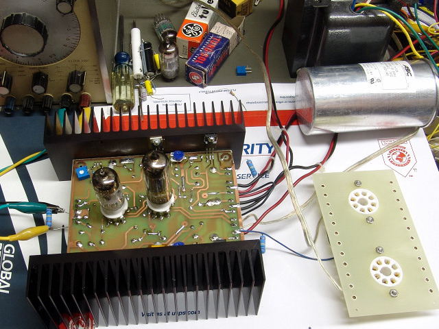

Which tubes did you use in the driver board in said experiment?
The input tube is a 12AT7 and the driver tube is a 6CG7. I started with a 5751 for the input tube and switched to a 12AT7 as an experiment. I don't remember it making much difference but I never got around to putting the 5751 back.
I noticed that the whole amp seemed to have plenty of gain, maybe too much, but I haven't tried connecting any feedback yet.
The power supply that was feeding just the plates of the output tubes was set at 500 volts. Idle current was 120 mA. The current meter was reading about 300 mA at full power.
The 400 volt supply ran the driver board and the screen grids of the output tubes. The current was about 60 mA at idle and went to about 120 mA at full power.

I designed the driver board such that it could be used for everything from the 6L6GC types used here to some monster sweep tubes. These experiments were just the first step in the testing and refinement of the driver. I would call this step a success even with my stupid moment with the PC board. The next step will involve some glowing sweep tubes!
Those are some serious heat sinks on that puppy.
I got a whole box full of those heat sinks at a hamfest for $5 for all of them. They happened to have 4-40 tapped holes in the right places so I used them here. They are indeed serious overkill for this application, but as I found out no heat sink at all makes the 10M45 start smoking. They didn't blow however. I plan to use a piece of 1 inch angle aluminum screwed to the chassis for the heat sink in the final version. The big heat sinks are for the mosfets and CCS's in a monster SLCF output stage I have been planning.
I made a big F.U. when I did the PC board so the whole thing almost landed in the trash. After thinking about it for a while I made it live. Then I was in a hurry to see it work on Sunday so I got a little careless and tempted Murphy a bit, but he didn't visit. That story (short) is here:
