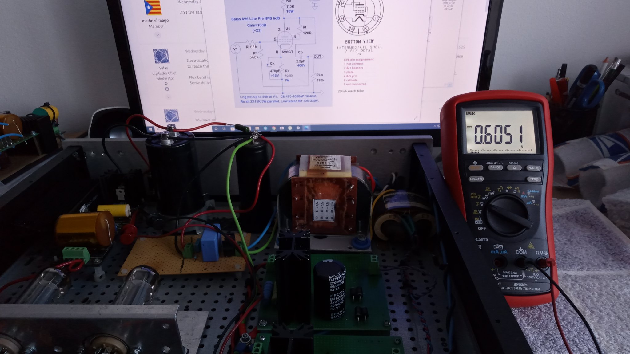

Following the good experience settings up well the SSHV2 for Valve Itch I revisited the 6V6 NFB PSU, one 220uF of the two in the BG gone so added one 820uF 550V Kemet and now the CCS set to 60mA without problems but still can't reach the 330Vout because the Vin SSHV2 is 325V so I left the B+ 300V waiting the new mains power transformer.
