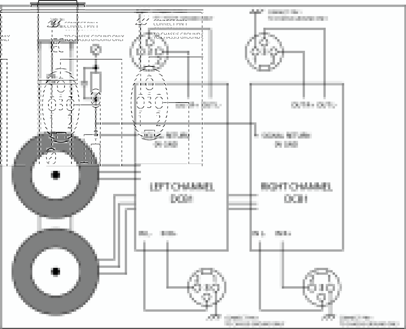

*Where DCB1 blocks imagine 6V6 stereo blocks to give our readers a better picture of what config we discuss now

Just 6dB of shunt NFB (Schade). No worries, cuts some noise & keeps gain in a more useful range. Many may be skeptical but those few who modified the classic common cathode version to the G3X kept it. By "deeper sound" I mean more image depth and better mid-bass.
