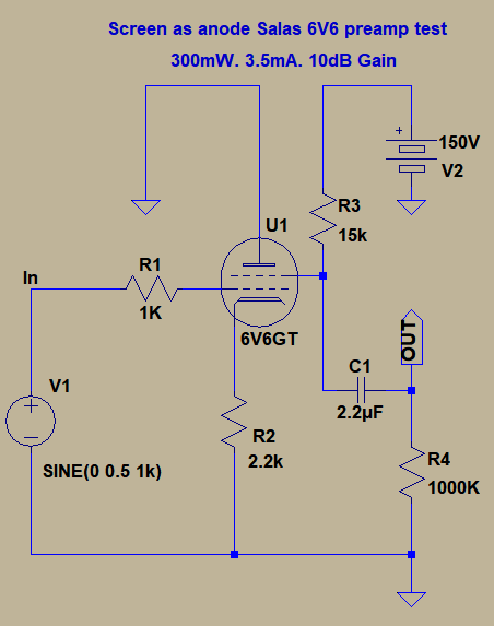

6V6 screen used 'as a plate'.

6V6:
The screen is rated for 2 watts dissipation.
g2 to g1 mu (u) is about 8 or 9.
Start with 250V on the screen, and 15V bias.
Try a 3900 Ohm self bias resistor, and see what current you get. 4mA would be 15.6V self bias.
Just a place to start, and adjust from there.
But you probably do not have 350V B+, to get 100V across a plate load resistor.
So . . .
Or, to get close to a real world circuit, 250V B+, a 30k plate load, and a 1500 Ohm self bias resistor, should get you close to VP 125V, and 3 to 7 mA.
You Can't hurt the screen with these starting resistor values, it will be far less than 1 watt screen dissipation.

I've never tried that. How do you get the operating conditions and curves and max. dissipation?
An example

Of course you don't want to drive a low impedance power amp from a screen output preamp. Zout is high. You got to lose some kind of ability when running at 300mW. But many tube power amps are/can be high Zin 100kΩ or so, hence interfacing is not always a problem. Low capacitance output interconnect cables are also preferable.

I estimate the screen impedance, rs, to be Less than 5k Ohms at 4mA screen current (with the plate Grounded).
That is about 1/2 of a 12AT7 plate impedance, rp.
That is about 50% less than a 12AU7 or 6SN7 plate impedance, rp.
Etc.
That is plenty low enough screen impedance, rs, to drive the input stages of many vacuum tube power amplifiers.
Build the preamp. Capacitor couple it from the screen to the output, start with a 1 Meg Ohm to ground at the output of the capacitor. Wait until the coupling cap charges.
Put a small signal into g1.
Measure the plate signal voltage out.
Connect a 5k resistor to ground in parallel with the 1 Meg resistor.
Measure the plate signal voltage again, if the voltage is 50% or more of the first voltage reading, the output impedance is 5k Ohms or less.
Done.
Try it and see.
Please let us know.
Just my opinions.
Reactions: 4 users
diyAudio Chief Moderator
Joined 2002
It should be about 10k Zo in my example. Because I have already tried that procedure in LT Spice. Maybe lower if the cathode resistor is bypassed. In exchange of more gain, and higher THD most probably. More than three times (9-10dB) voltage gain is impractical for line level control when using modern source equipment in my experience.
