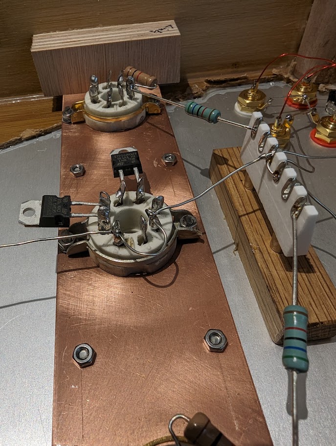

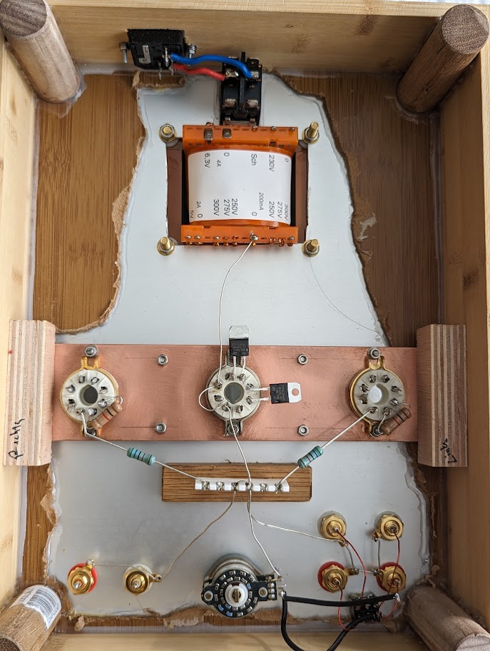

Cout 250V voltage rating should be good enough when the bias current is nominal. Thus voltage drop across the plate resistor has fully developed. Same for rail elements like RC filters. Since its on the plate node it will see about 165V DC + AC output swing peak.
I put 400V Cout schematic note rating to be >B+ safe in case of current source heating which is soft start and takes significantly longer time to develop full emission.
Yes, voltage at the plate is 150 or thereabouts. There's a bit of surge at turnon but the Maida board quickly drops this to 330 volts and that then drops down further as the 6V6s warm up. I figure a few seconds won't hurt the cap. I might also add a slow-start board to the HV.
I have been listening all evening to this. I hear nothing wrong and a lot right! Tubes are nothing special, some Groove Tube Russian-made guitar amp tubes. HIP Baroque bands are tangy but never "screechy," piano is full and rich, classic jazz recordings have great "PRAT" and deep, clean bass. Gain is perfect for my system. Everything I put on sounds natural and "right." I'm waiting for that one recording that comes out "wrong" but haven't found it yet. ;-) I have some Bendix 5992's on the way. Eager to hear them.

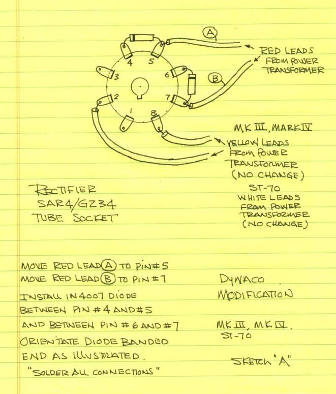

Yellow sheet mod. Just some help for the tube 5AR4/GZ34.
https://dynacotubeaudio.forumotion.com/t1006-tube-rectifier-yellow-sheet-diode-mod
![TubeRectifier-DiodeMod.jpg TubeRectifier-DiodeMod.jpg](https://www.diyaudio.com/community/data/attachments/1061/1061460-76061cb98e1c2a66851393cec843f079.jpg)
