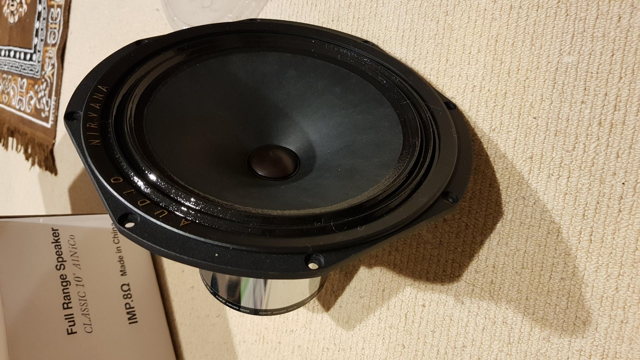

Just to wet the appetite.
These ones are 10" Alnico Classic.
I have
15" Ferrite Super
10" Super Neo
10" Classic Alnico (Not yet listened to)
10" Classic Ferrite (Not yet listened to)

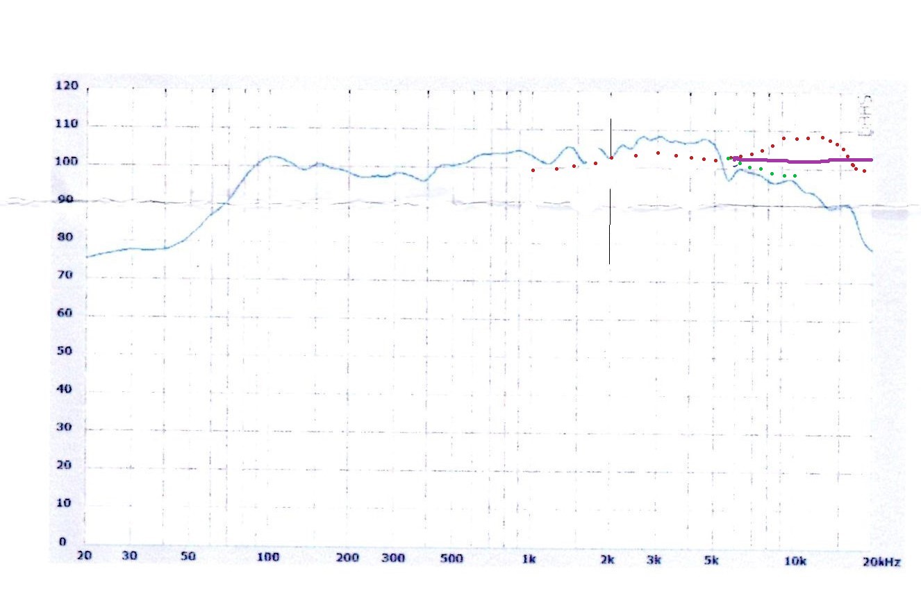

I’ve realized that I very likely didn’t need to build the Big’un speaker as big as I did, it could have been smaller without loss of performance.
I've been modeling up the AN 15 classic ferrite along with the Aurum Cantus G1 giant ribbon together...The classic Ferrite responds better than the Alnico version, a high Db all along the board. The biggest of the AC ribbons is a top Db performer as well.
A first order filter coming in at appx. 6K is needed to keep the big ribbon away from 110 Dbs.
----------------------------------------------------------------------Rick.....
