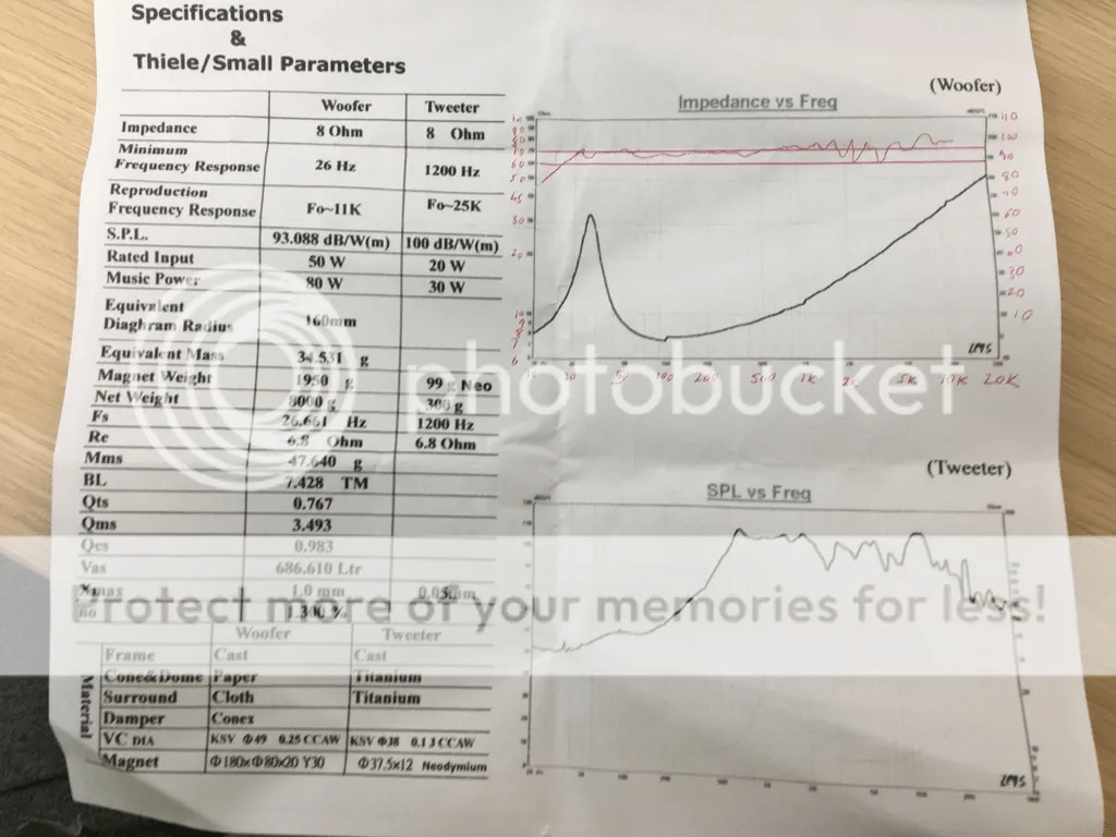

Like to bring this back from the vaults if I may. I have had tucked away for a good few years a pair of Super 15's which I'd now like to do something with, however they are the coaxial version- I cannot find any threads specifically referring to these, and looking at the specs they appear to differ substantially to the other versions. Can anyone advise what a good cabinet volume would be for these please?
Joined 2009
That driver indeed has a large Vas, meaning it wants to have a large volume of air behind it. Whether an Infinite Baffle (IB) or a large box. Not everyone can do an IB in their house, so try a large box, big as you find practical such as the size of box I built in this thread.

I tried to crunch some numbers.............
Sealed qtc 1.1 (+3db bump at fsb ?)
Sealed qtc 1.3
Open baffle, even 4' wide baffle, it would dip maybe 300hz, peak 150hz, then roll.....................
VB = | 22.94 | Ft3 |
fsb = | 38.72 | hz |
F3 = | 29.30 | hz |
Sealed qtc 1.3
VB = | 12.94 | Ft3 |
fsb = | 45.76 | hz |
F3 = | 32.96 | hz |
Thanks all, most useful. Since I now have a man cave I'll go for IB 22.94 box, should be interesting!
Looking at a box 170cm x 85cm x 45cm width, so a reasonable size (!), will put the driver at seated ear height. Will need a fair bit of bracing..
I'll also have to build a crossover for these, would you advise passing the woofer at 2k or so, or let it run full range?
I can put a cap on the tweeter for the high pass- specs show 1.2k minimum, maybe pass at 1.5?
First order be best?

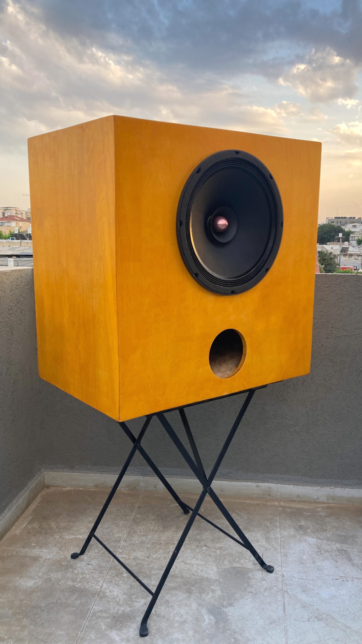

However, I made my project in Israel using Audio Nirvana Super Ferrite '15 drivers in 2023.
Before I decided to build a 2 channel stereo sound system for a small Wine Bar in Tel Aviv I auditioned different speakers in a big enclosure based on Audio Nirvana drivers and Lii Song drivers, to my ears th Audio Nirvana was a superior sounding driver!
Here is a quick pic of the first prototype designed by myself in a superheavy front ported internally dampened 287 liters plywood cabinet.
I tested the speakers on my roof using an analog setup, no fancy components used, everything is pretty basic with a big $500 Harman Kadron receiver.
Those huge speakers with AN '15 drivers on my roof produced a silky smooth sound with very warm bass from my vintage Funk, Soul, Latin, Disco, Reggae vinyl records pressed in the '70s.
I don't understand people who think there is not enough bass from a full range speaker, maybe not enough in those ugly open baffle designs, but in a classic ported cabinet there is more than enough bass response in the music where the bass guitar and rhythm section plays a very important role.
It was a cost effective solution for a sound system designed for a public place - a wine bar where people usually talk loud while selectors spinning vinyl records.
Of course the overall presentation was much better on my roof with no walls than in a small bar, because of all the reflections in a room without acoustic treatment (which is a common problem for all those "reviewers" in their typical small apartments with low ceilings etc).
I don't know why AN drivers are forgotten now, in my opinion they are much more lively than their Chinese contenders in the same price range.
