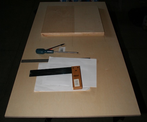

so I've glued up some scrap pieces of birch ply on the back of the baffle to provide some additional depth and support for the driver to mount into. I'll be dusting off my router shortly.
