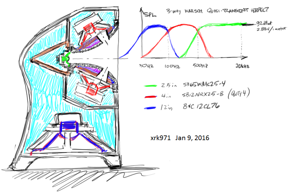

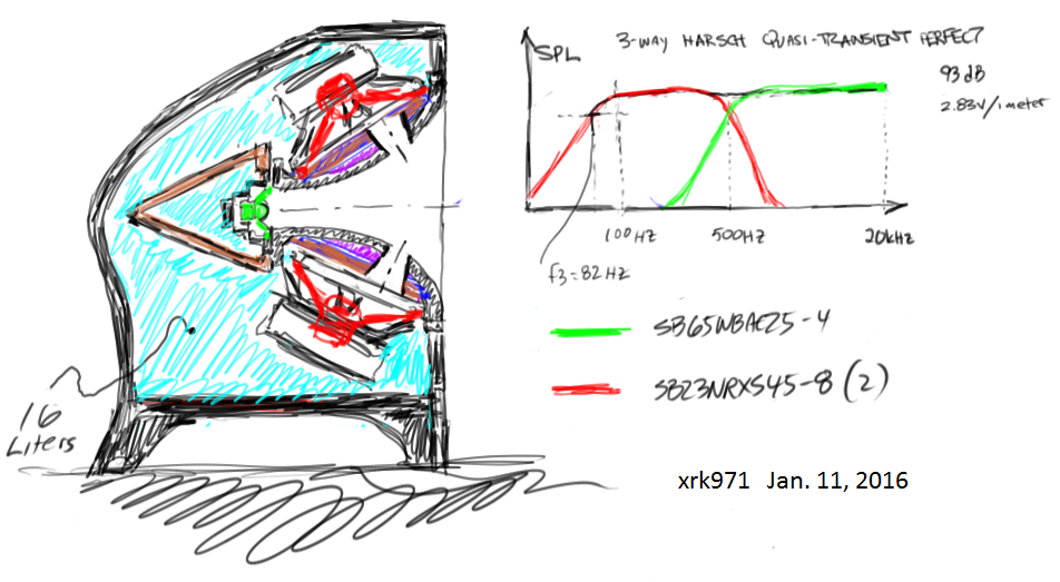

So here is sort of my vision of the end goal. It's all very fluid and we try to make things smaller where possible. The reality is it might be closer to a small stand mount. Decisions of which WG to bass the system on sets overall size.

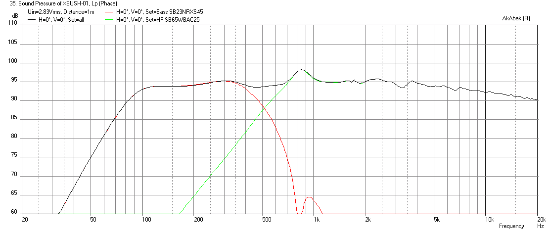

Predicted sensitivity and response before EQ using a Harsch XO at 500Hz and SB23NRXS45-8 woofers:

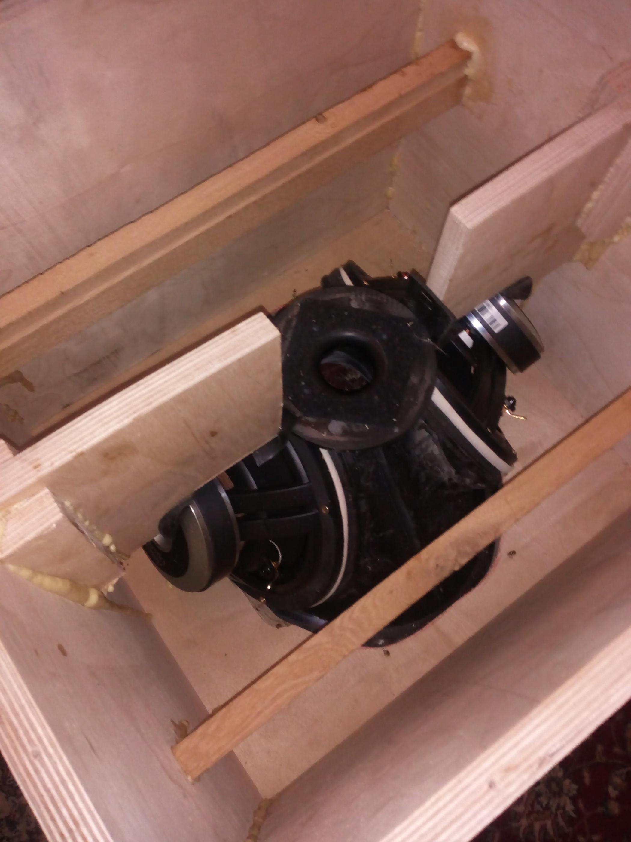

The business side of the horn normally not visible when boxed up:
Mounted inside cabinet:

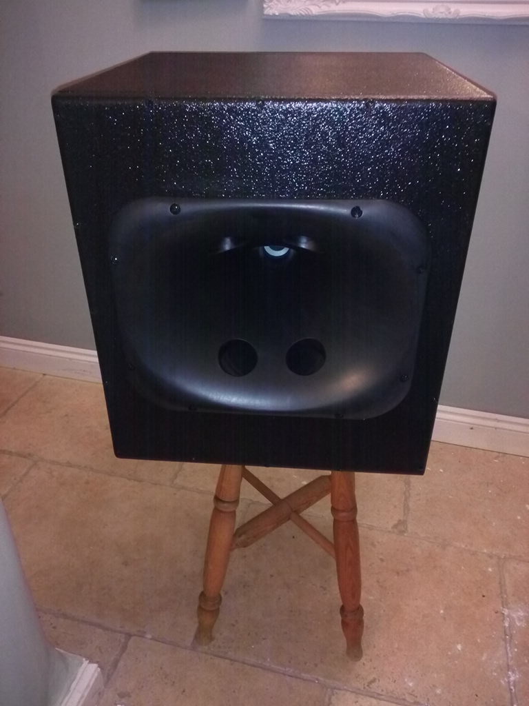

Finished speaker:

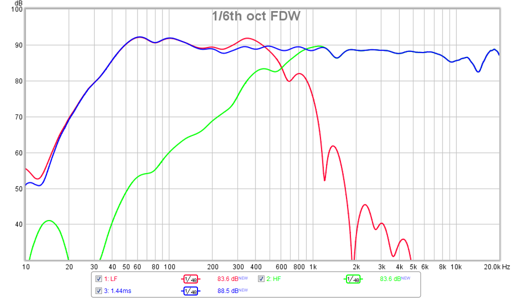

Acoustic XO slopes for Harsch:

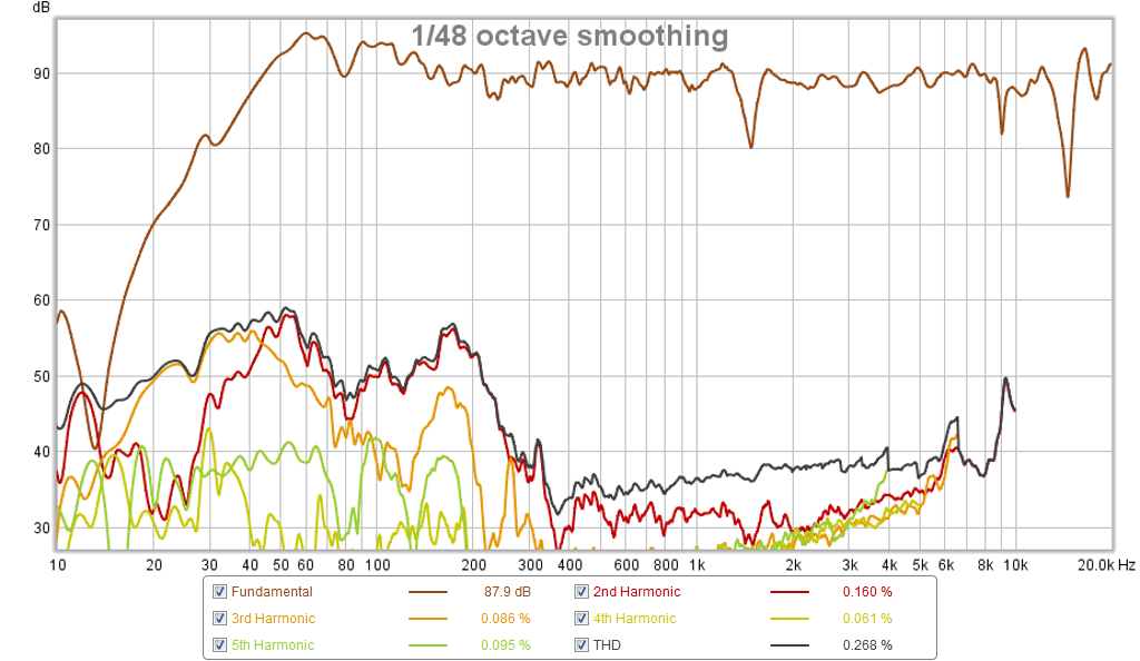

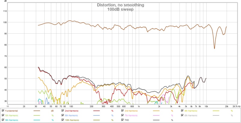

Harmonic distortion at 100dB and 1m (nice!). Note that this is just a 2-wa speaker with two sealed 8in drivers - that manage to produce nice deep bass extension with low distortion:

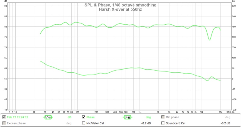

Measured acoustic phase:

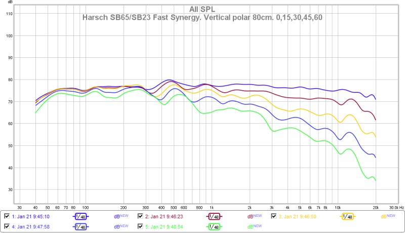

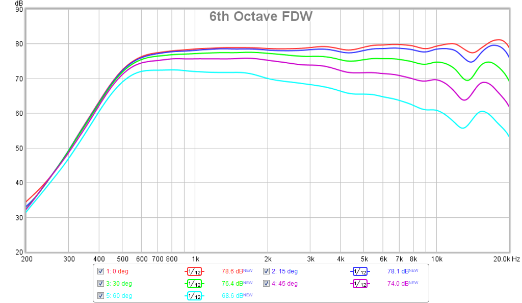

Measured Horizontal Polar Directivity:
Measured Vertical Polar Directivity:

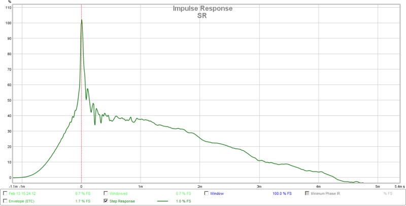

Step Response:

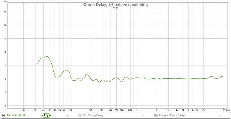

Measured Group Delay:

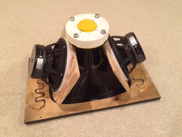

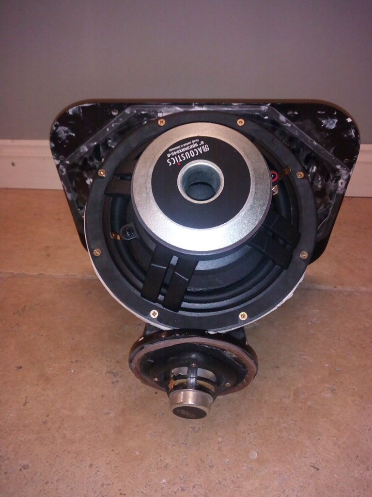

Not fully up to snuff yet when compared to Bushmeister's amazing effort, but here is Xrk971's attempt which uses a Faital Pro LTH142 waveguide, dual Dayton RS180P-8 woofers, and same SB65WBAC25-4 mid/tweeter:

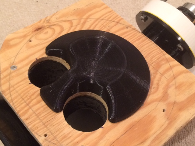

Internals with all 3d printed driver to horn adapters (here shown with early version using DC200-8 wofoer):
Later version with RS180P-8 woofers:

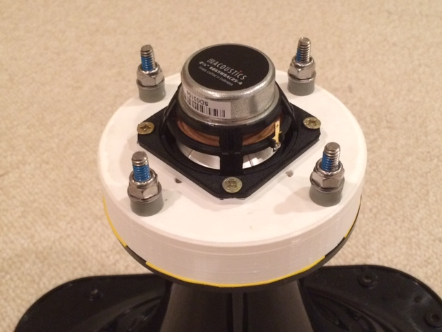

Detail of SB65 throat adapter:

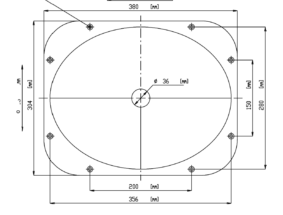

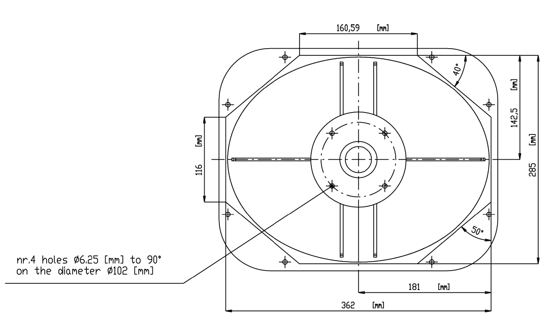

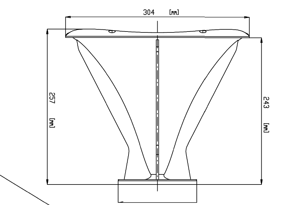

CAD drawing of adapter:
All 3D files (STL) for xrk971’s Xbush are here:

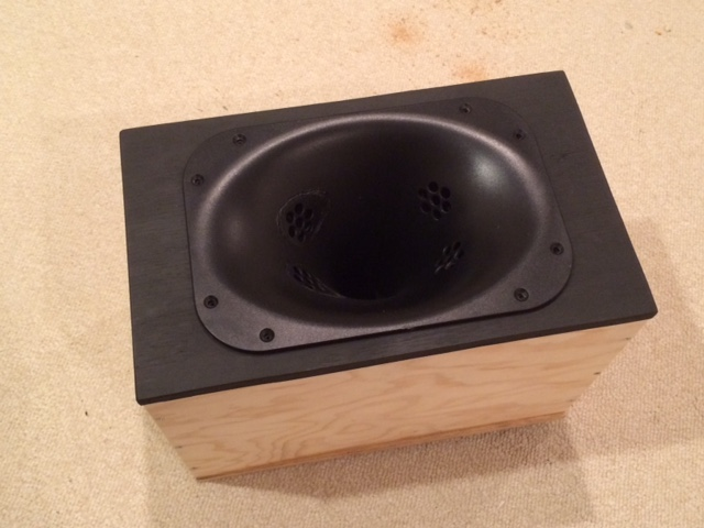

Fitting into box for first time:

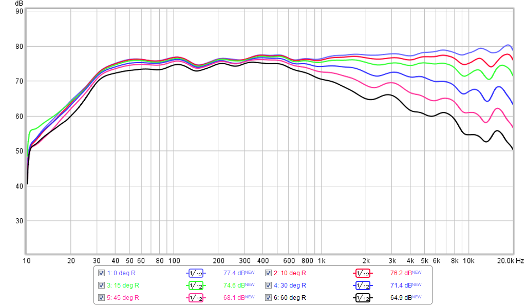

Measured Polar directivity of SB65 in LTH142 waveguide:
3d printed woofer to waveguide adapter:
3d printed woofer chamber volume reducer plug:
Polar directivity with woofer holes:

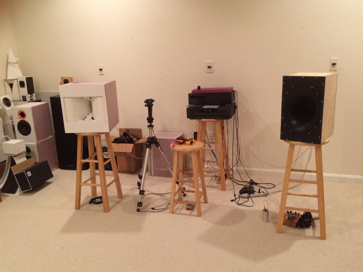

Used in stereo with uTrynergy on left and Xrk's speaker on right:

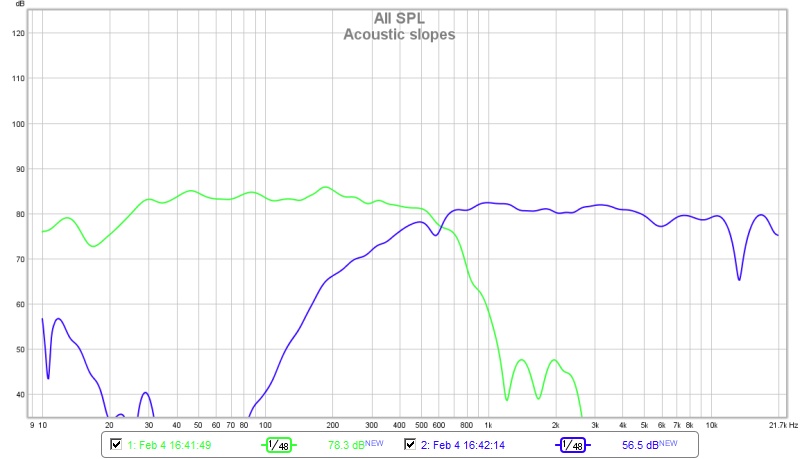

Acoustic XO slopes of Xrk's speaker:

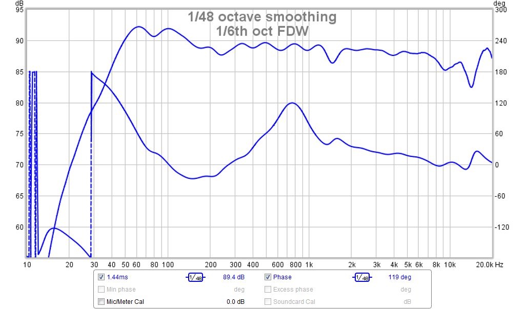

Phase of Xrk's speaker (still working on getting it flatter and proper 55deg phase bump for Harsch):
Harmonic Distortion of Xrk's speaker (not very good - many leagues below what Bushmeister is able to do):
I suspect the higher HD has to do with a number of things including: driver choice, cabinet volume and wall material, cabinet resonance damping methods, waveguide inertness via 4kg of epoxy Bondo, and larger holes (60mm vs equiv 29mm).
All pieces and adapters on Xrk's speaker were 3d printed PLA vs hand cut and epoxy for Bushmeister's excellent effort. Sometimes low tech gives better results.
So, my speaker is still a project waiting for more work to improve the phase, the step response, and improve the harmonic distortion.
![524229d1452489305-bookshelf-multi-way-point-source-horn-xbush-01-sb23nrxs45-8-design-sketch.png](https://www.diyaudio.com/forums/attachments/multi-way/524229d1452489305-bookshelf-multi-way-point-source-horn-xbush-01-sb23nrxs45-8-design-sketch.png)
![536584d1457613073-bookshelf-multi-way-point-source-horn-slopes.jpg](https://www.diyaudio.com/forums/attachments/multi-way/536584d1457613073-bookshelf-multi-way-point-source-horn-slopes.jpg)
![536585d1457613073-bookshelf-multi-way-point-source-horn-dist-2-.jpg](https://www.diyaudio.com/forums/attachments/multi-way/536585d1457613073-bookshelf-multi-way-point-source-horn-dist-2-.jpg)
![536586d1457613073-bookshelf-multi-way-point-source-horn-phase-1-.jpg](https://www.diyaudio.com/forums/attachments/multi-way/536586d1457613073-bookshelf-multi-way-point-source-horn-phase-1-.jpg)
![536587d1457613073-bookshelf-multi-way-point-source-horn-polar.jpg](https://www.diyaudio.com/forums/attachments/multi-way/536587d1457613073-bookshelf-multi-way-point-source-horn-polar.jpg)
![536588d1457613073-bookshelf-multi-way-point-source-horn-vert-polar.jpg](https://www.diyaudio.com/forums/attachments/multi-way/536588d1457613073-bookshelf-multi-way-point-source-horn-vert-polar.jpg)
![536590d1457613073-bookshelf-multi-way-point-source-horn-gd.jpg](https://www.diyaudio.com/forums/attachments/multi-way/536590d1457613073-bookshelf-multi-way-point-source-horn-gd.jpg)
![528945d1454484423-bookshelf-multi-way-point-source-horn-lth142-swcond-woofer-01.jpg](https://www.diyaudio.com/forums/attachments/multi-way/528945d1454484423-bookshelf-multi-way-point-source-horn-lth142-swcond-woofer-01.jpg)
![530860d1455371559-bookshelf-multi-way-point-source-horn-image.jpeg](https://www.diyaudio.com/forums/attachments/multi-way/530860d1455371559-bookshelf-multi-way-point-source-horn-image.jpeg)
![526756d1453501391-bookshelf-multi-way-point-source-horn-sb65-long-adapter-photo.png](https://www.diyaudio.com/forums/attachments/multi-way/526756d1453501391-bookshelf-multi-way-point-source-horn-sb65-long-adapter-photo.png)
![526771d1453502400-bookshelf-multi-way-point-source-horn-xbush-throat-adapter-v3-wireframe.png](https://www.diyaudio.com/forums/attachments/multi-way/526771d1453502400-bookshelf-multi-way-point-source-horn-xbush-throat-adapter-v3-wireframe.png)
![529771d1454885057-bookshelf-multi-way-point-source-horn-baffle-black-1.png](https://www.diyaudio.com/forums/attachments/multi-way/529771d1454885057-bookshelf-multi-way-point-source-horn-baffle-black-1.png)
![531021d1455442962-bookshelf-multi-way-point-source-horn-utryn-xbush-stereo-setup.jpg](https://www.diyaudio.com/forums/attachments/multi-way/531021d1455442962-bookshelf-multi-way-point-source-horn-utryn-xbush-stereo-setup.jpg)

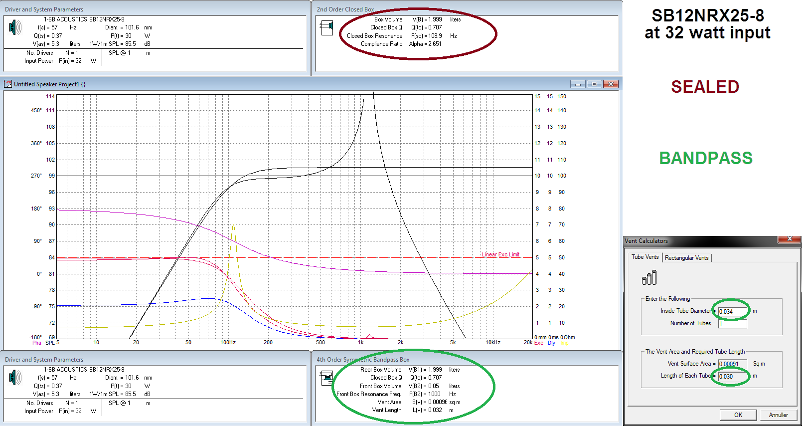

Discovered my WinSpeakerz program can model band pass box so for fun did model SB12NRX25-8 in Q 0,7 sealed verse same having a band pass front box and port. xrk971 if you find time could you run Akabak and see if it agree frq response for band pass setup, data used is 32 watt input, 1,999 liter back box volume, 0,05 liter front box volume, port diameter 34mm, port length 30mm, front box resonance 1000Hz, BW2 low end roll off for sealed example is 108,9Hz for band pass looks more like 88Hz with a couple dB lost sensitivity verse ordinary sealed.
Thanks for running that Byrtt. Once it couples into the horn - the behavior may be different in that horn adds a few more dB mostly due to directionally because of horn. There will be overshoot peak from port but that can be EQ'd out. Does look like 500Hz is a good XO point. I need to estimate to expansion profile of the 18Sound WG and put that geometry into the model for Akabak to predict this well. I guess it's time to put some simulation to this to predict bandpass hole size and location for optimum results.

Tapping the horns - they are extremely rigid, light, with a very high pitched 'ring' on the 'tap test'. In my experience, this tells me they will likely have very high stiffness with high resonances. These can often be tamed very successfully with existential damping - of the form used in cars (think dynamat) to dampen resonances in the metal structure. (This form of damping is much less useful for lower resonances you get in heavy thick MDF/Ply constructed cabinets - for which the best technique is CLD.)
So I am thinking, that covering the outer surface of the horn profile with 4mm thick bitumen damping product could help reduce unwanted resonances and lower distortion further.
I hope this, combined with the sorbothane gaskets - which should minimize direct energy transfer and mechanical excitation of the horns - should give us a very clean output.
You are in luck because according to Byrtt's sim of the woofers in a 2liter(ea) rear chamber it goes down to about 80Hz. Now it is much smaller and closer to a "bookshelf" vs a design with built in woofer. XO around 80Hz with your distributed subs is perfect then. I still need to confirm Byrtt's simulation but we are probably at least not completely off. There is always LT to push it up a bit at expense of excursion so max SPL may be affected.
Do you know if the profile of the WG is available anywhere? I would like to model this horn with bass injection holes and we can get close to optimal before cutting injection ports.
It would be useful if you can take the factory PDF drawing and use a ruler to get me at least 5 dimensions of horn height and width at 5 different axial distances. Every 20% of length basically. This would be enough to form a rough model in Akabak.
Also, can you can please use either geometry to estimate the volume of the front cone of the woofer formed if you place it against a flat wall. If you have driver in hand easy to use dry rice or beans and measure volume.
These hard numbers come a long way to getting to a rough model.
Once this is done it would be great to measure it Geddes style and send the files to him. If you ask him nicely he will likely map it for you.
GedLee LLC
Good idea - I am sure Bushmeister has capability to measure polar response.
2d color contour plots of SPL vs frequency aren't exactly hard if you have scientific plotting SW that does interpolation from an array. Like Mathcad can do this quite readily. I have not plotted DI maps before but this type of plot is standard fare in Mcad.
Another thought I have had:
Good idea, but you can take it further by covering the whole exterior side of the hard plastic with sand loaded caulking or other viscous adhesive. Use it to fill gaps between the wooden board and the horn. I have heard of people covering plastic horns with dampening caulking to great success. If you tap it and it rings there may be an issue there. Once the four wooden boards are attached and holes drilled the mode of vibration will probably change (for the better as less "bell like").
OK Xrk, these are the best plans I could get online - using screenshot etc.
What further measurements specifically would be helpful?
So along 5 points on axis of middle picture measure correspond max and min elliptical diameter (Max is horiz and min is vertical) and label it in a sketch similar to third picture on right. See how it starts as 36mm round (actually now modified by you) then goes egg shape elliptical? I basically need these to calculate the WG cross sectional area as a function of axial distance from the 36 mm throat.
You can sketch the drawing and save as PNG or whatever.
Thanks.
Tip : it is much more precise if you cut cardboard ellipse to fit and measure cardboard. Do this for 4 points since throat is round.
