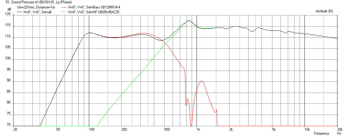

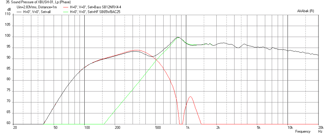

I put the WG dimensions into Akabak, put the TS parameters for the SB12NRX25-4 in, adjusted where the bass injection port goes (currently at 10cm back from exit plane at mouth - adjustment closer to front possible with a few dB loss). I used the 2 liter per woofer rear chamber suggested by Byrtt along with Byrtt's estimate of 50cc volume for cone and 34mm dia injection ports that are 30mm long.
For this simulation, we are assuming that the SB65WBAC25-4 couples into the WG perfectly with no throat cancellation effects, and a minimal front chamber effect (volume formed by driver and throat is assumed neglible).
Electrical Filter settings are set as:
SB65WBAC25 is Butterworth -12dB/oct high pass at 350Hz with a 1.12ms delay. Also -3dB padding is applied to get SPL to be closer to woofer.
Qnty 4 SB12NRX25-4's in series/parallel and have -24dB/oct Butterworth low pass filter at 350Hz. A -12dB/oct Butterworth high pass at 80Hz is used to prevent over excursion and for handover to sub woofer.
These electrical filter settings combined with the acoustic filters produce an overall acoustic XO at 500Hz and are Harsch like. This cannot be done until you have actually built it because electrical filters will need to be adjusted to get acoustic target to match the BW4 for the woofer and Bessel 2 for the mid/tweet.
Ok, enough talk, here are the initial results - no EQ applied.

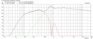

SPL at 2.83v and 1 meter - so first thing we notice is that the system will probably work and the drivers will cover their own territory, the horn is quite efficient and these little 4 inch woofers really can't keep up, 500Hz XO seems to be a sweet spot, note that HF performance of SB65WB above 3kHz is probably not going to be as flat or as high - expect -12dB falloff and several dips due to throat cancellation. Overall a very promising start and I would say the main problem is not enough SPL at 80Hz for the XO to sub. If you are OK with 98dB max at 80Hz then get these drivers. The overall system sensitivity of 91dB that I estimated based on the woofer seems to be good - you can just -ve EQ everything to flat at 91dB and save distortion on SB65WB:

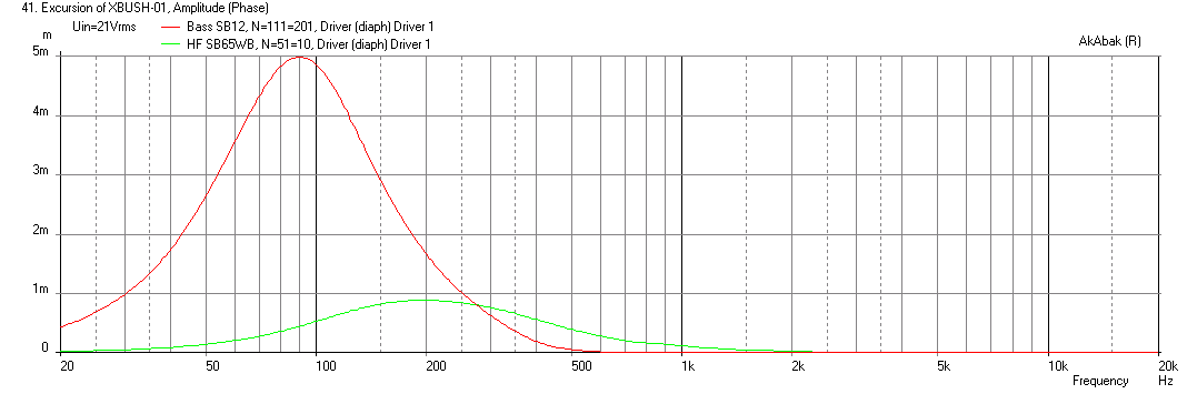

Cone displacement at xmax with 21v (-3dB on on SB65WB) - the SB65WB is hardly moving so the HD should be low:

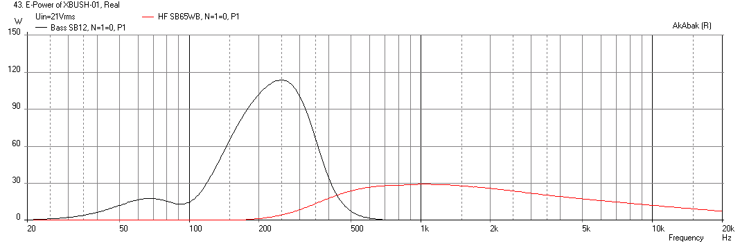

Electrical input power at 21v (-3dB on SB65WB) this is excellent and shows all thermal values are not exceeded with some room for EQ'ing the SB65WB:

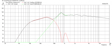

Interestingly, if you were to use bass reflex re-injection right along periphery of horn mouth, you can get quite a bit more reach and integrate well with the sub. Here is what it would look like with 4 Liter rear chambers ea and a 1.75in dia x 8.5in long duct x qnty 4 ducts total, the max voltage can go up to 22v and HPF can be backed off to 70Hz:

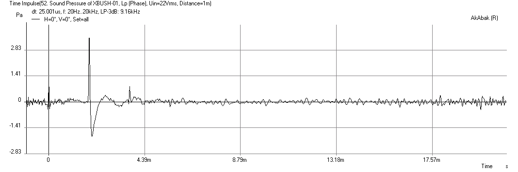

The predicted impulse response doesn't look too bad actually:
![524083d1452441434-bookshelf-multi-way-point-source-horn-xbush-01-freq-2.83v-500hz.png](https://www.diyaudio.com/forums/attachments/multi-way/524083d1452441434-bookshelf-multi-way-point-source-horn-xbush-01-freq-2.83v-500hz.png)
![524086d1452441434-bookshelf-multi-way-point-source-horn-xbush-01-disp-21v-500hz.png](https://www.diyaudio.com/forums/attachments/multi-way/524086d1452441434-bookshelf-multi-way-point-source-horn-xbush-01-disp-21v-500hz.png)
![524084d1452441434-bookshelf-multi-way-point-source-horn-xbush-01-elect-power-max-spl-21v-500hz.png](https://www.diyaudio.com/forums/attachments/multi-way/524084d1452441434-bookshelf-multi-way-point-source-horn-xbush-01-elect-power-max-spl-21v-500hz.png)
![524088d1452442587-bookshelf-multi-way-point-source-horn-xbush-01-max-spl-21v-500hz-br-reinject.png](https://www.diyaudio.com/forums/attachments/multi-way/524088d1452442587-bookshelf-multi-way-point-source-horn-xbush-01-max-spl-21v-500hz-br-reinject.png)

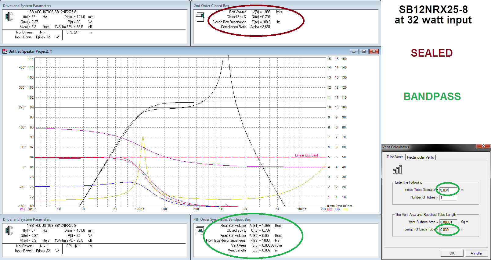

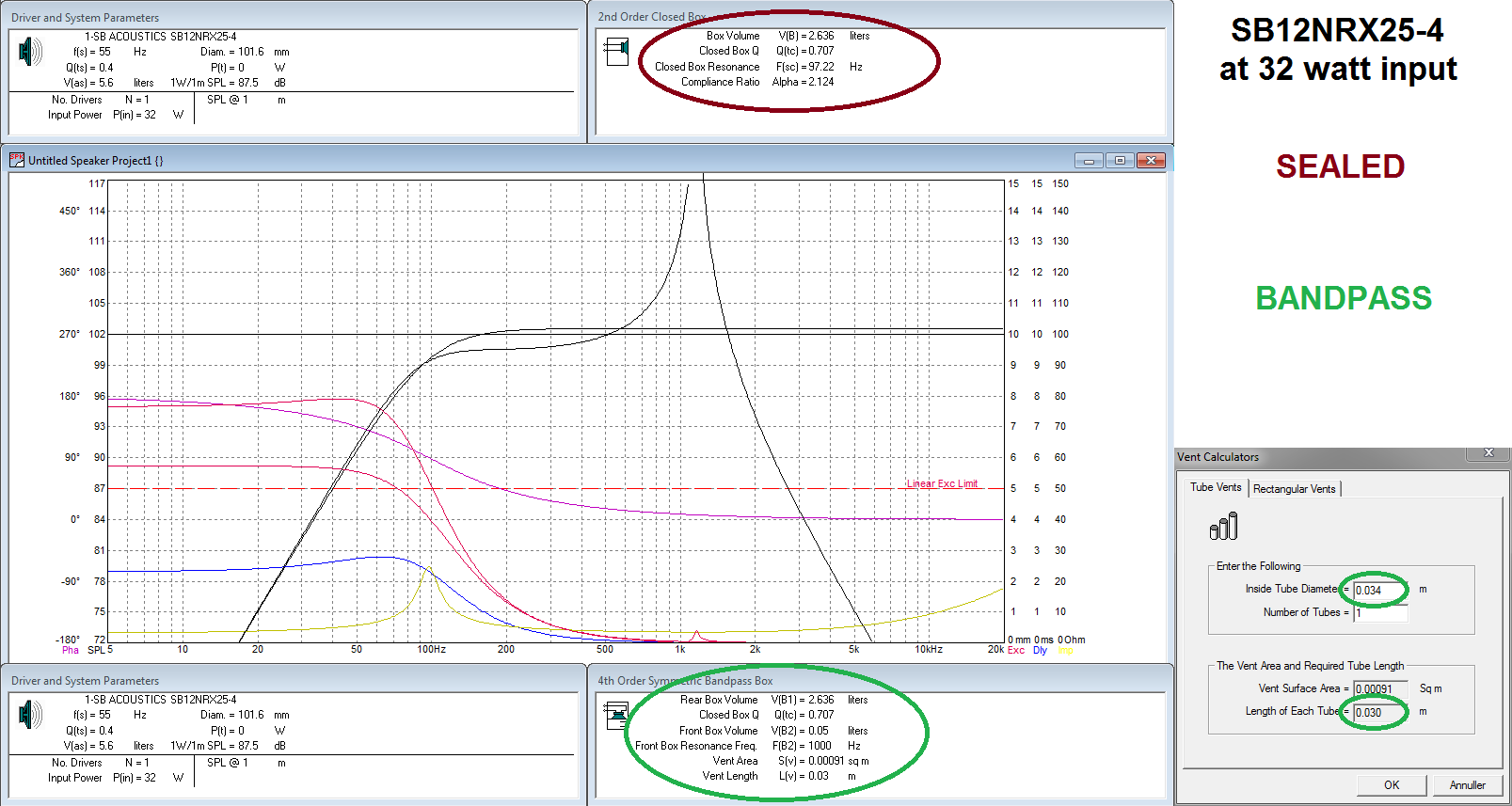

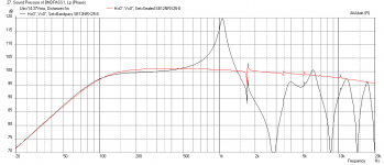

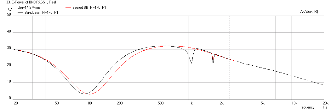

Discovered my WinSpeakerz program can model band pass box so for fun did model SB12NRX25-8 in Q 0,7 sealed verse same having a band pass front box and port. xrk971 if you find time could you run Akabak and see if it agree frq response for band pass setup, data used is 32 watt input, 1,999 liter back box volume, 0,05 liter front box volume, port diameter 34mm, port length 30mm, front box resonance 1000Hz, BW2 low end roll off for sealed example is 108,9Hz for band pass looks more like 88Hz with a couple dB lost sensitivity verse ordinary sealed.
Hi Byrtt,

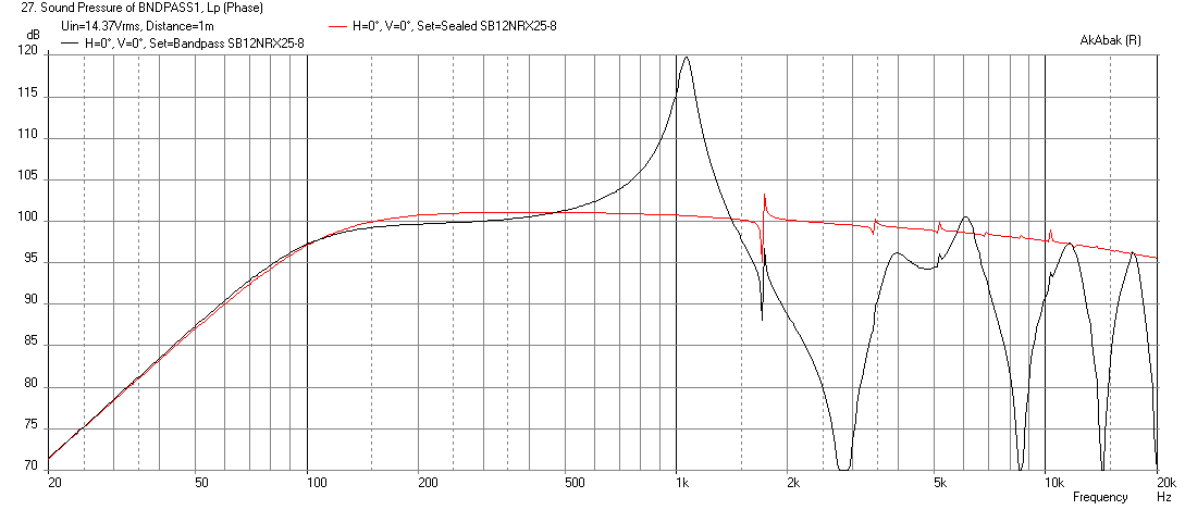

Here are the equivalent sims in Akabak. Akabak uses voltage as the independent variable input so I had to tweak that and watch power to get 32 watts. Ended up at 14.37 volts to get 32 watts.
Here is predicted SPL vs Freq for bandpass and sealed:
![524106d1452447404-bookshelf-multi-way-point-source-horn-sb12nrx25-8-bandpass-sealed-compare-32watts.png](https://www.diyaudio.com/forums/attachments/multi-way/524106d1452447404-bookshelf-multi-way-point-source-horn-sb12nrx25-8-bandpass-sealed-compare-32watts.png)

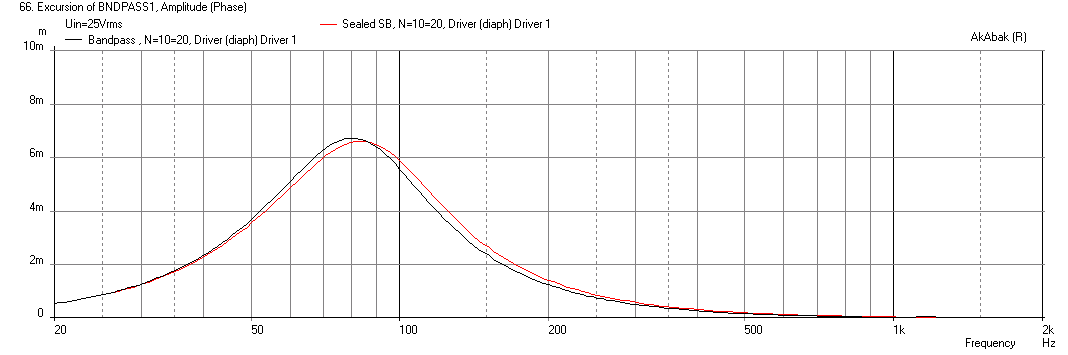

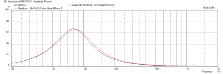

Here is predicted cone displacement:
![524107d1452447404-bookshelf-multi-way-point-source-horn-sb12nrx25-8-bandpass-sealed-compare-32watts-displ.png](https://www.diyaudio.com/forums/attachments/multi-way/524107d1452447404-bookshelf-multi-way-point-source-horn-sb12nrx25-8-bandpass-sealed-compare-32watts-displ.png)

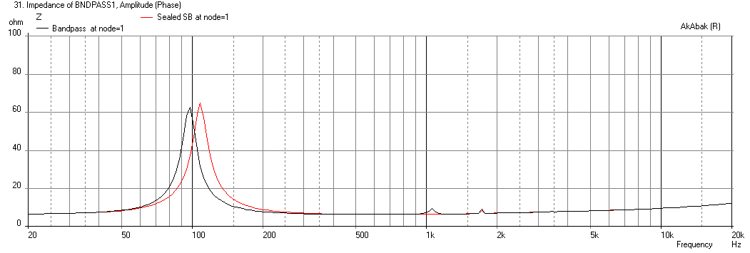

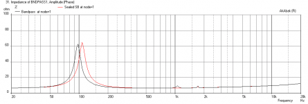

Predicted Impedance:
![524108d1452447404-bookshelf-multi-way-point-source-horn-sb12nrx25-8-bandpass-sealed-compare-32watts-impedance.png](https://www.diyaudio.com/forums/attachments/multi-way/524108d1452447404-bookshelf-multi-way-point-source-horn-sb12nrx25-8-bandpass-sealed-compare-32watts-impedance.png)
Predicted Electrical Power:
![524109d1452447404-bookshelf-multi-way-point-source-horn-sb12nrx25-8-bandpass-sealed-compare-32watts-elect-power.png](https://www.diyaudio.com/forums/attachments/multi-way/524109d1452447404-bookshelf-multi-way-point-source-horn-sb12nrx25-8-bandpass-sealed-compare-32watts-elect-power.png)
It appears to match your sims. In Akabak there is also the main depth of the front and rear chambers that comes into play (a long one will have resonances). I picked 30mm for the front and 100mm for the back chamber depths.
Here is Akabak script if you ever want to try it out yourself.

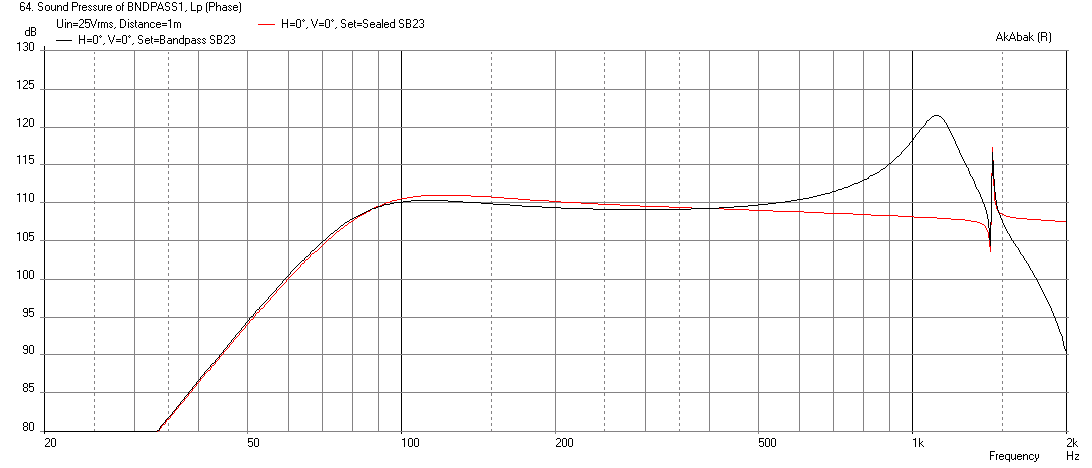

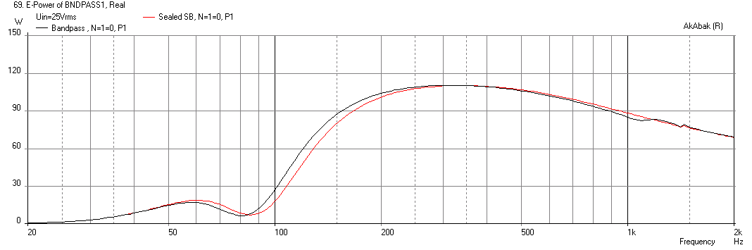

Bandpass sim of SB23NRXS45-8
It was good I made the little code package to check the bandpass for Byrtt. I used to to quickly size the rear chamber and bandpass hole for the new 8in SB23NRXS45-8. The driver has a very large Vas but we will undersize the rear chamber to keep the speaker small. It may not have the ideal Q but the powerful motor and EQ will just be used to overpower the box Q and it will comply.
I think a 10 liter rear chamber is not too big and qnty 2 x 65mm dia bandpass holes per driver is needed. I assumed the front volume to be 165cc and the depth of the front chamber to be on average 40mm.
With one driver and a -12dB/oct BW high pass filter at 70Hz, I able to get 110 dB SPL at xmax with 25 volts and f3 of 77Hz. This should cross nicely with the sub. For the horn we can drive in parallel for +6dB at 116dB at 25v.

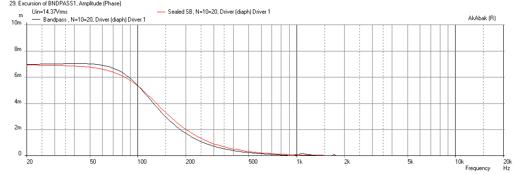

Predicted displacement:
![524121d1452452153-bookshelf-multi-way-point-source-horn-sb23nrxs45-8-bandpass-sealed-compare-displ-25v.png](https://www.diyaudio.com/forums/attachments/multi-way/524121d1452452153-bookshelf-multi-way-point-source-horn-sb23nrxs45-8-bandpass-sealed-compare-displ-25v.png)
![524122d1452452153-bookshelf-multi-way-point-source-horn-sb23nrxs45-8-bandpass-sealed-compare-electrical-power-25v.png](https://www.diyaudio.com/forums/attachments/multi-way/524122d1452452153-bookshelf-multi-way-point-source-horn-sb23nrxs45-8-bandpass-sealed-compare-electrical-power-25v.png)

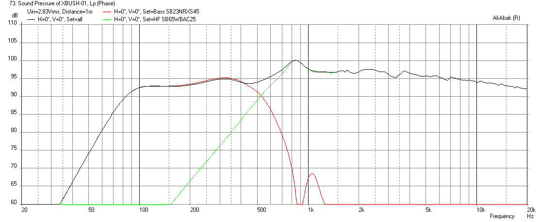

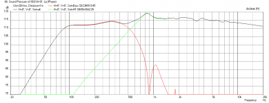

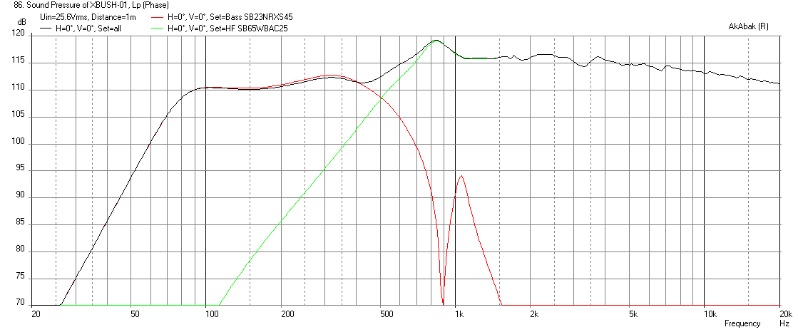

xBUSH v1.1 with SB23NRXS45-8
I think this is going to work well with the dual 8 inch woofers. It's almost a perfect match for the little SB65WBAC25. Funny how the WG is such a big equalizer for that tiny driver and two massive 8in woofers.

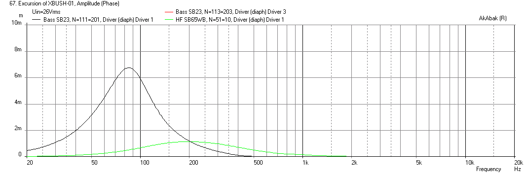

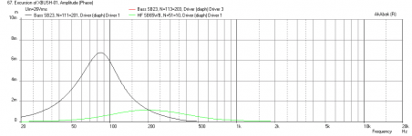

Here is the predicted max SPL with an 8.0 liter rear chamber for each woofer. I think that works out not too bad. I am using qnty 4 x 65mm injection holes here. We are able to get 112dB at 26v at xmax. Using -12dB/oct BW high pass at 70Hz. The f3 is 82Hz - should be doable for the sub woofer to cross over now.
Here is predicted electrical power input, at max SPL the thermal rating on the little SB65 is being exceeded so can't operate at max continuously. Should be OK for crest factor though.
Based on this, if two 8 liter chambers are OK, I would get these woofers for this project. A good match and they are nice low distortion drivers.
And for reference, sensitivity at 2.83v is about 93dB:
![524126d1452454062-bookshelf-multi-way-point-source-horn-xbush-01-sb23nrxs45-8-max-spl-26v.png](https://www.diyaudio.com/forums/attachments/multi-way/524126d1452454062-bookshelf-multi-way-point-source-horn-xbush-01-sb23nrxs45-8-max-spl-26v.png)
![524127d1452454062-bookshelf-multi-way-point-source-horn-xbush-01-sb23nrxs45-8-max-spl-displ-26v.png](https://www.diyaudio.com/forums/attachments/multi-way/524127d1452454062-bookshelf-multi-way-point-source-horn-xbush-01-sb23nrxs45-8-max-spl-displ-26v.png)
![524128d1452454062-bookshelf-multi-way-point-source-horn-xbush-01-sb23nrxs45-8-max-spl-electrical-power-26v.png](https://www.diyaudio.com/forums/attachments/multi-way/524128d1452454062-bookshelf-multi-way-point-source-horn-xbush-01-sb23nrxs45-8-max-spl-electrical-power-26v.png)
![524129d1452454370-bookshelf-multi-way-point-source-horn-xbush-01-sb23nrxs45-8-max-spl-2.83v.png](https://www.diyaudio.com/forums/attachments/multi-way/524129d1452454370-bookshelf-multi-way-point-source-horn-xbush-01-sb23nrxs45-8-max-spl-2.83v.png)

I will order four 8 inch woofers tonight!
Rear chambers of 8 litres per driver seems very doable.
If I simply created a box to enclose the horn, with the 15x12x11inch dimensions it is going to be over 42 litres volume I reckon - even keeping it tight.
I would imagine calculating for horn volume, driver displacement, a sealed (3 litre ish) chamber for the SB65 there will still be more than 16 litres left over for the two woofers.

One thing Akabak does not do is provide overall volume of the horn. I would just estimate it as a 4 sided pyramid. If you have it already, you can measure it with water. So you like being able to hit 112dB then it sounds like. If you rotate the horn 90 so it it tall, the width is manageable. It's not a small bookshelf speaker by any means. A lot has to do with the WG you pick - that is the foundation that sets everything else. This WG is not huge, but not tiny.

Your max bass SPL will go down - it may be a sacrifice worth considering. And like Byrtt says, even with the four 4in woofers, if this is really a bookshelf and not a stand mount monitor, the 98dB was not too bad. Holes there are smaller.
Let me run sim with smaller holes. Tell me what size you want - 20% Sd?
Ok, here are qnty 4 x 37mm dia holes - much more reasonable and you give up a few dB. Probably worth it and have max SPL at 110.5db. This is the great thing about having a model - you can try all sorts of things and get closer to the solution or know that the solution is possible.
I think this looks pretty good, 37mm dia holes are not too obtrusive at all. That is 2 holes per driver and 4 total for the horn.
