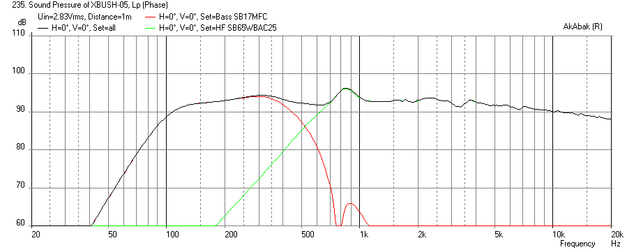

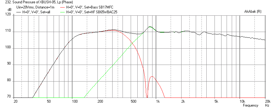

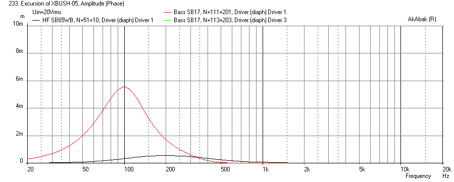

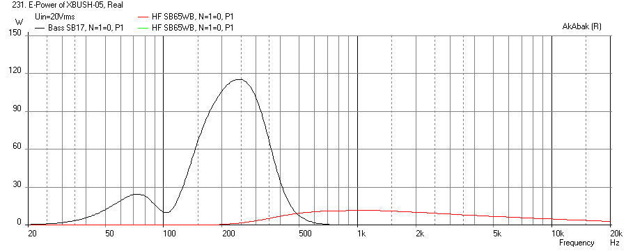

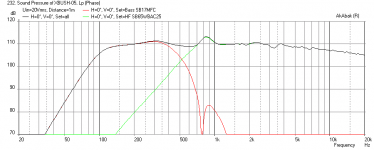

Here are sims for the 8Sound XT1464 60x50deg waveguide with two SB17MFC35-8 drivers pushing through a 40mm dia x 2 injection holes with a 4 liter rear chamber ea and 100 cc front cone volume assumed. -12dB/oct high pass filter at 85Hz to limit cone excursion. This gives thermal max matching xmax at 20v RMS. Max sustained RMS SPL is about 110dB.
SPL at 2.83v and 1m:
![578012d1478116083-bookshelf-multi-way-point-source-horn-sb17mfc-lth142-spl-2.83v.png](https://www.diyaudio.com/forums/attachments/multi-way/578012d1478116083-bookshelf-multi-way-point-source-horn-sb17mfc-lth142-spl-2.83v.png)
SPL at xmax and themal max at 20v RMS:
![578013d1478116083-bookshelf-multi-way-point-source-horn-sb17mfc-lth142-max-spl.png](https://www.diyaudio.com/forums/attachments/multi-way/578013d1478116083-bookshelf-multi-way-point-source-horn-sb17mfc-lth142-max-spl.png)
Cone displacement at 20V:
![578014d1478116083-bookshelf-multi-way-point-source-horn-sb17mfc-lth142-max-cone-displ.png](https://www.diyaudio.com/forums/attachments/multi-way/578014d1478116083-bookshelf-multi-way-point-source-horn-sb17mfc-lth142-max-cone-displ.png)
Electrical Power at max SPL:
![578015d1478116083-bookshelf-multi-way-point-source-horn-sb17mfc-lth142-elect-power.png](https://www.diyaudio.com/forums/attachments/multi-way/578015d1478116083-bookshelf-multi-way-point-source-horn-sb17mfc-lth142-elect-power.png)
X,
Thanks for doing that, much appreciated. Given the fact the enclosure is half the size losing 15Hz extension on the bottom compared to the 8" seems acceptable.
Can I ask at what distance down the horn the ports were?
Also is it 40mm x2 injection holes per driver?
After seeing some of plots of the MFC that were linked to in your monitor thread, it looks to have a pretty horrible distortion profile so I think I would choose the paper cone in this application as the breakup is less of an issue when filtered in the bandpass. The T/S parameters look to be very similar (as only the cone has changed) so the sim should still be valid.

Hi Fluid,
You are welcome.
The ports were located 50mm dia (axial distance) from the exit plane of the mouth of the waveguide.
Yes, qnty 2 x 40mm dia ports per driver. If you think you can stuff 4 drivers on this WG, I can sim that too if you want.
