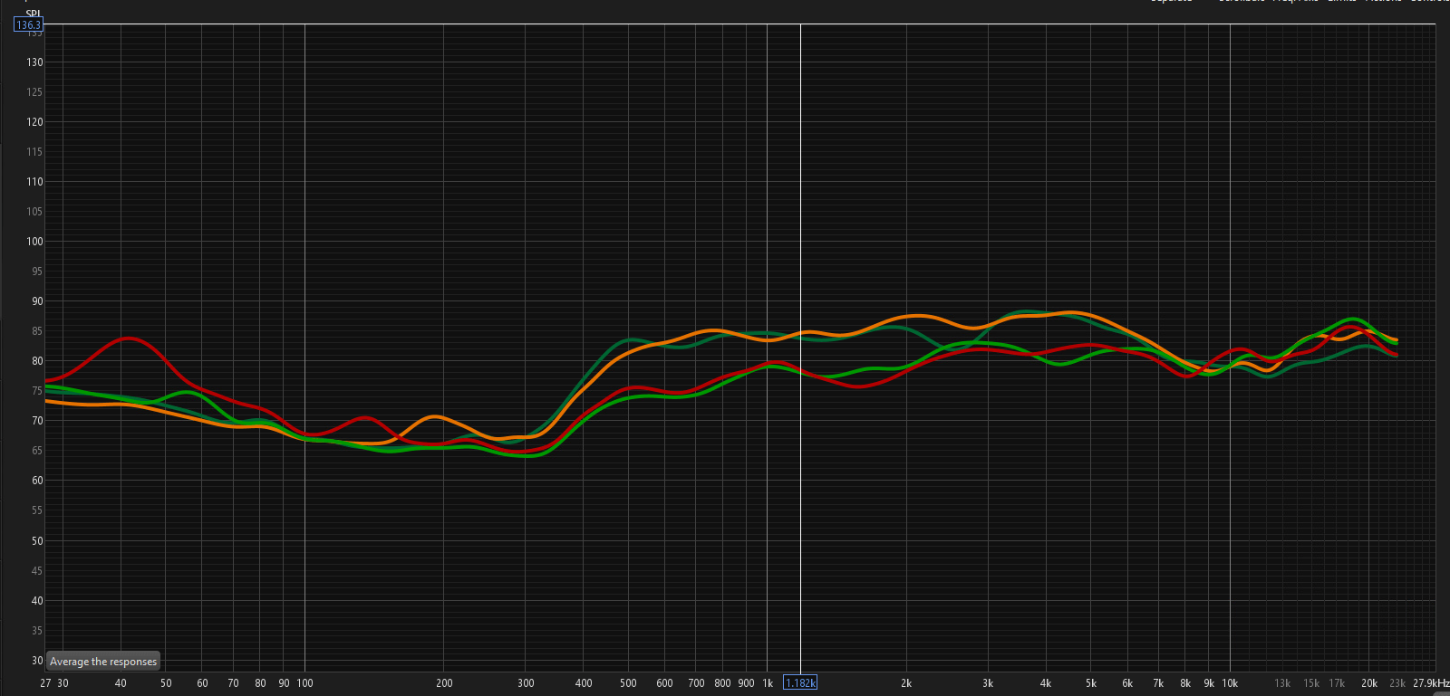

Great result on orange curve adapter. Maybe stuffing got rid of 3.5kHz notch?

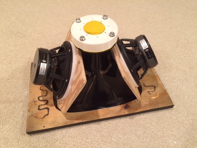

You can fit an 8in woofer by mounting that to a larger piece of plywood then mount that to horn wall. The holes for woofer injection are quite small so you have plenty of room. I would aim for hole area of about 20% to 30% of cone Sd. It can be smaller if you have less need for deeper bass. Make two racetrack shaped oval apertures angled along corner of the horn wall.
Sort of like this but you won’t need such a long adapter plate.

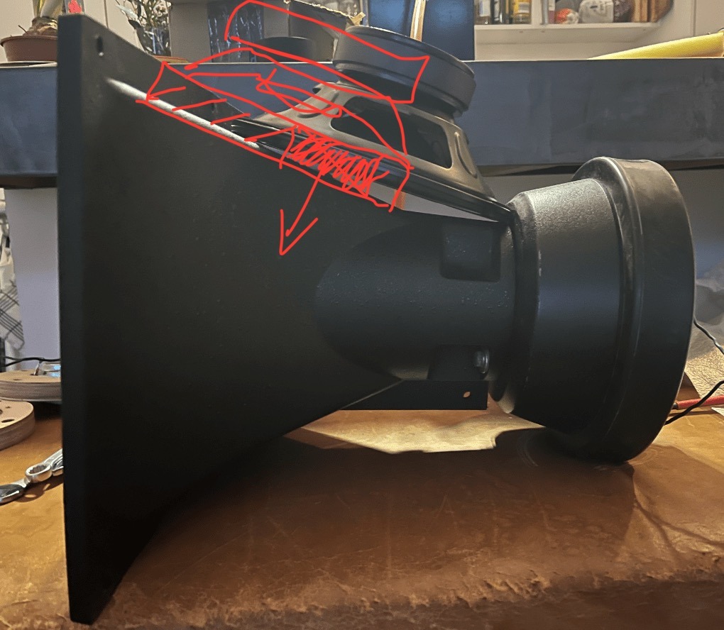

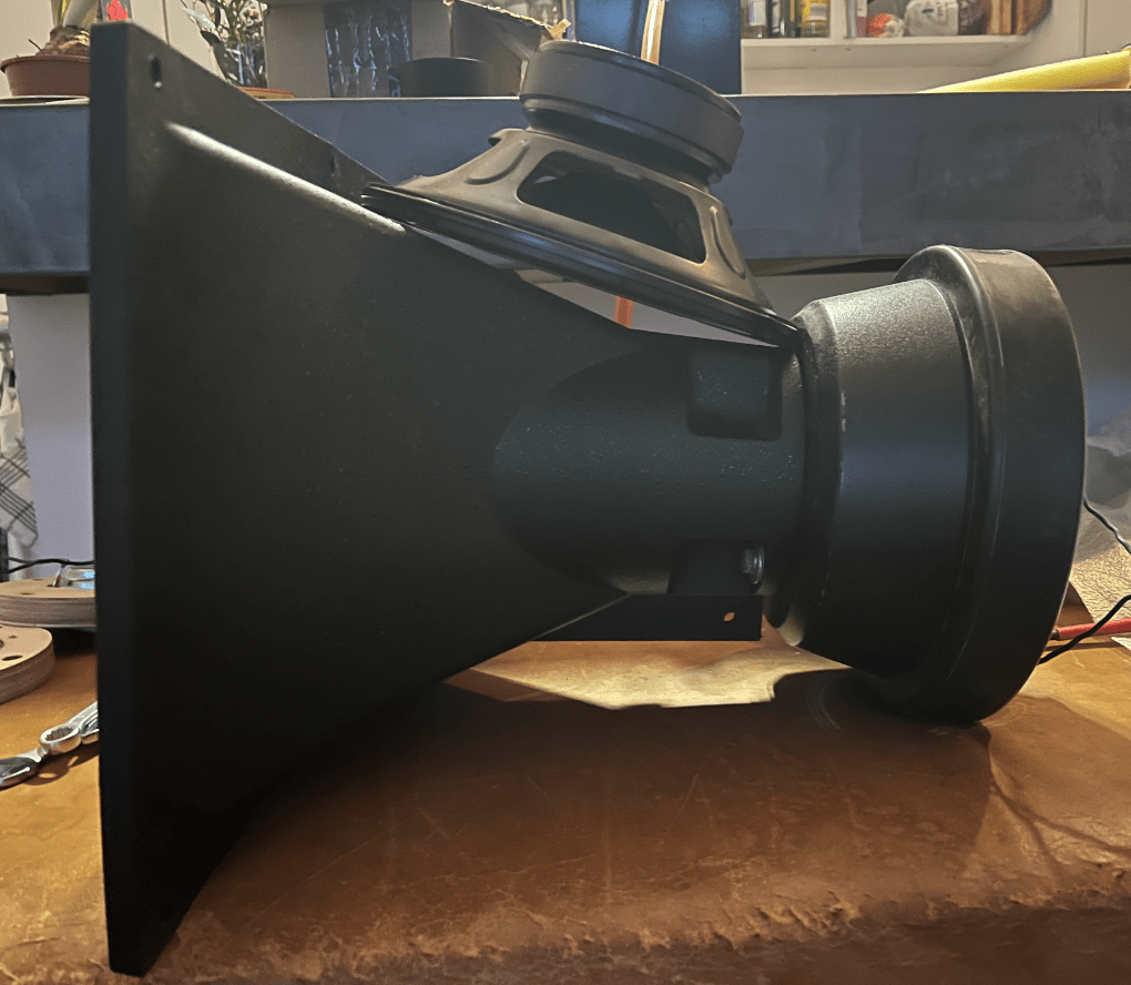

That’s what I meant with thicker plywood and cut outMaybe thicker wood to elevate bezel to fit?
There is not much space to move to the mouth like the driver in your sketch… the perspective shows it wrong
Now you made it worse

Another option is to cut the front face and add 3d printed attachment to it, making smth like
This is from manufacturing perspective. Have no idea how that will affect acoustics
Ok... Which starting point to chose...
Lets start

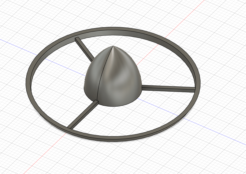

The Top and bottom wall is straight... inside of the horn ;(
Outside the throat has a diameter of 120mm. Now i need to decide: modify/ cut the throat or using thick plywood and cut this out

Regarding phase plug on TB cone. It’s all very dependent on geometry. It may be helping you. Only way to know is to try driver without it. In general, throats of horns benefit from phase plug if designed correctly. All compression drivers use a phase plug. Purpose is to equalize the path from edges to the middle.

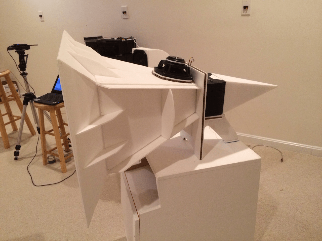

Reminds me of my AMT synergy:
The box it sits on is my own horn loaded sub woofer with a new topology as described here.
Vs Sanbourine:
Vs Sanbourine:

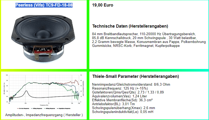

I have a bunch of Peerless (Vifa) TC9-FD-18-08. Do you think using 4 (or more) of them from 150Hz up could work? They don't have the strongest motor ;(
In my big EV6040 i have 4 5" FaitalPro wich work pretty well down to 90Hz
I think at the end i definitely need 3 way because i don't think, that i can bring them down to <40Hz.
To keep the budget for testing small:
I have used TC9FD in many prototype synergy horns. Good choice.

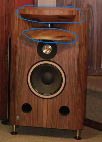

@diyuser2010 - what horn is that shown above?

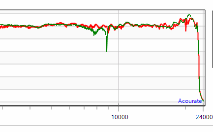

A little bit of smoothness is because of smoothing the Signal... but over all, i am happy with the measurement.
It seems to be a good idea to cover the whole surrounding!
AND: i have a 2" Throat... so by covering the surrounding, my adapter always gets wider never smaller.
I have attached my latest stl-file. If you like, i can send the Fusion file.
Some news.
I noticed, that i have a big problem in the frequency response when measuring exactly on axis with the sb- acoustic, so i tried printing a phaseplug, without any success. Next i tried two pieces of wood, which covers the horn on top and buttom by ~2cm. THIS makes a huge difference:
