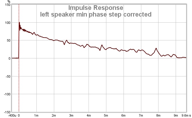

I gave it a shot as well yesterday. The result was not what I was expecting. It came out with a garbled impulse and step, and also a worse looking frequency sweep.

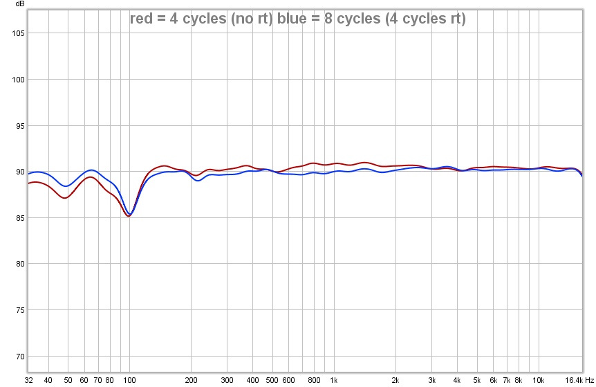

A longer prefilter window with no RT means high Q dips/peaks in the filter response (which cause it to ring longer). The filter that is generated by the custom config file (8 cycles prefilter/4 cycles RT) is smooth like the old 4 cycles filter, but just a bit more effective for some reason. It's sort of like doing the windowing after the inversion rather than before it, which if you think about it, isn't really all that different. The effect of the RT stage is really only "minimal" if it's using the same size window as the prefilter stage. Tomorrow we'll look at some graphs; let me know what you want to see.
What might shed a light is seeing the FR + Phase of the convolution filter itself in REW from your previous 4 cycle filter, an 8 cycle filter without RT stage and your latest template which includes the RT stage. That would show the actual correction that will be applied to the speaker.

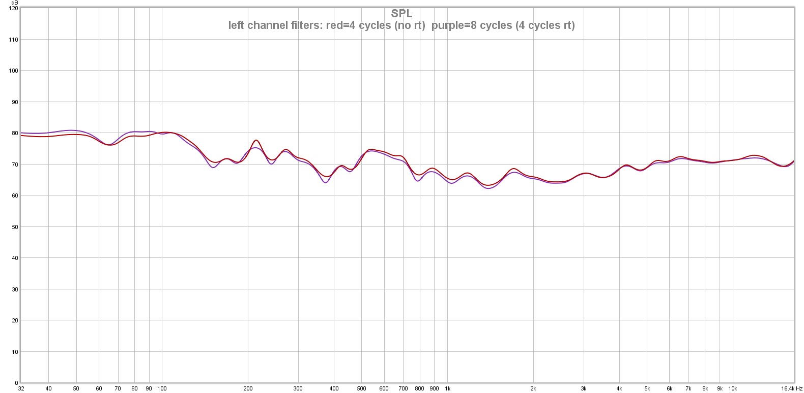

Thanks for helping me think this through. The attached graphs show old vs. new filter response, and also the effect of the RT with the new filter. It's interesting to study both of these; despite the smoothness of the new filter, it does seem to be retaining some of the attributes of a longer windowing - things that the 4 cycles filter isn't seeing.

Can you also show the phase? It could be likely that there are differences there too.
I know they are, that doesn't matter, it's what they do that counts. Minimum phase filters in DRC will still alter phase of the speaker, as these plots show. They will probably differ once you look trough them with cycled filters, though REW is too smoothed to tell the whole story. The phase manipulation of the longer pré filter window could show differences. This isn't much difference though, which means if the resulting FR graph is better behaved (by the RT stage removing over compensation) it will be potentially better overall.
This looks like an improvement, as the filters without RT stage look way more aggressive.
