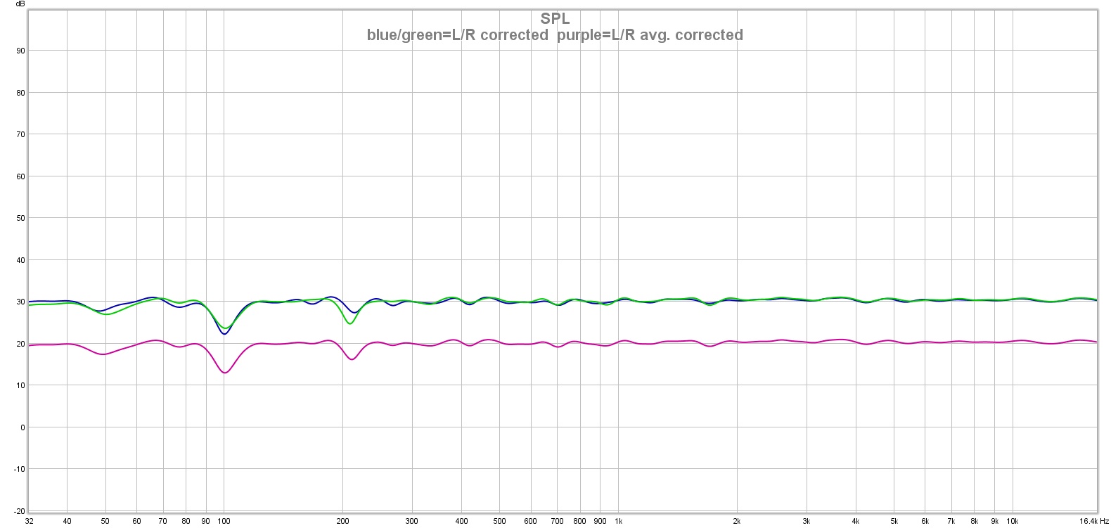

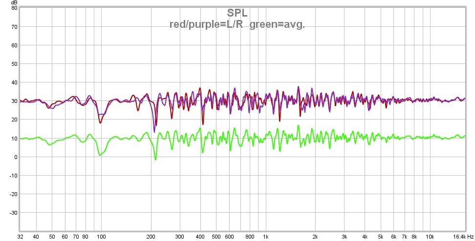

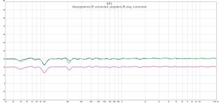

Room anomaly from corner placement. The other side makes up for it with a slight boost.
(that's the stuff where a Sub could help me out so I don't have to use the other channel)
At 30 Hz you see more heavy lifting being done by the left channel. The right channel needs way more boost because it doesn't have that corner support. This way one channel makes up for the other's imbalance, so both use similar amount of boost as to not run out of digital headroom.
Here's the 6 cycle plot including the Left + Right sum

I'd use A+B to see if the phase lines up, it should be about 6 dB higher. Better would be to record it out in the room and just run a sweep running both speakers. That's what I do.
The predictions are always just that bit smoother than real life measurements.
Near field looks awesome though, I'm jealous. An advertisement for using DSP on a set of full range drivers in the near field if I ever saw one.

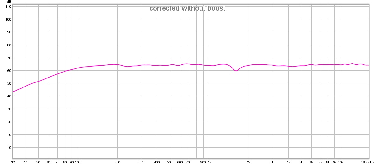

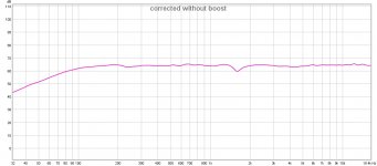

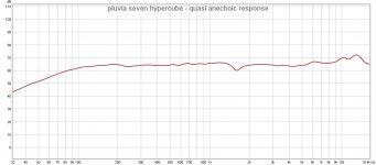

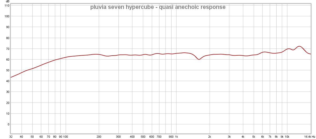

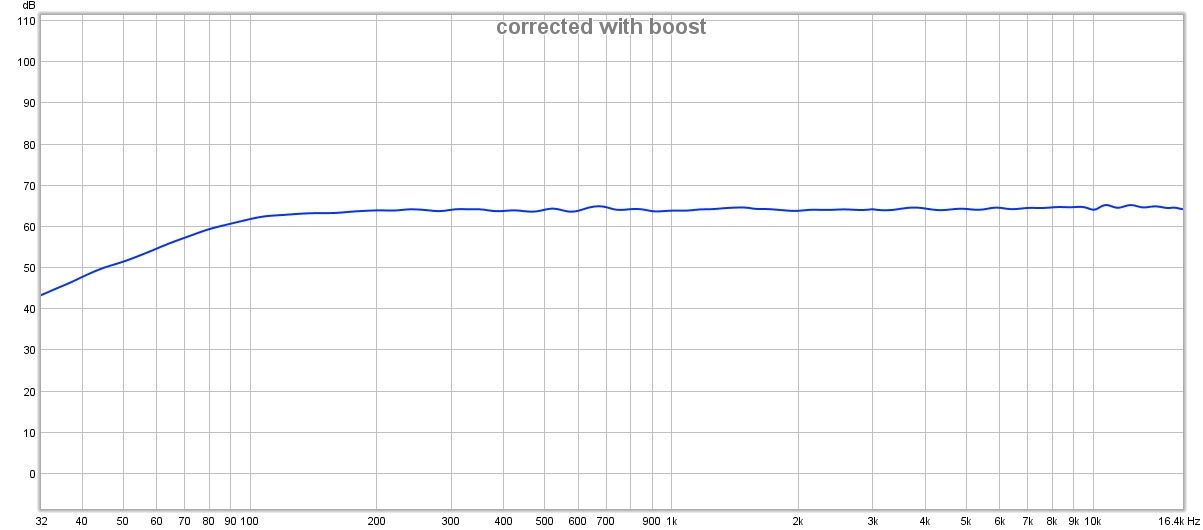

Here's a quasi-anechoic measurement (sort of ...quasi-quasi-anechoic?) of my Pluvia Seven Hypercubes (avg. of both speakers) using REW. A 3" measurement was merged with a (gated) 18" measurement at 3kHz (about 2.5 oct above predicted baffle step f3). The total response was windowed (FDW) at 1/12 octave. No dac or mic calibration was used.* I used this to run some filters with REW and I think they work very well (in conjunction with predicted baffle step compensation). One filter does not use any boosting and would be more like what could be done with a (complex) electrical speaker network. The other filter uses boosting and cutting to totally linearize the response (at the expense of a little digital gain reduction).
*I posted the same measurement in the Pluvia Seven thread with dac compensation used (my dac rolls off a bit in the top octave)
