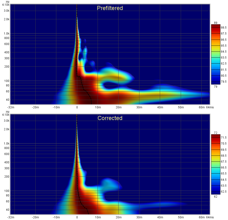

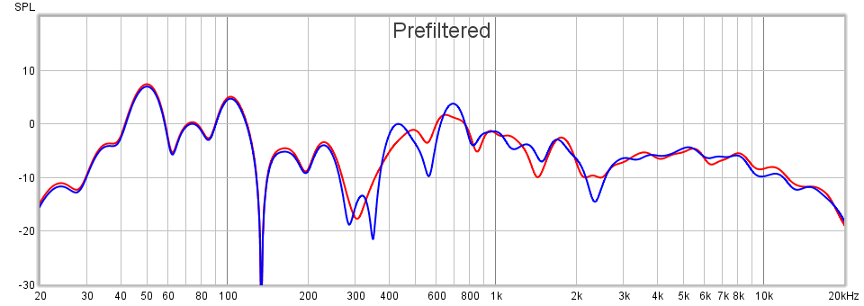

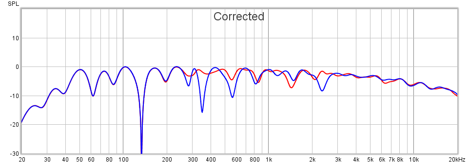

The purpose of the custom (two pass) configuration is to generate a filter based on a single (listening position) measurement which brings the perceived direct sound into alignment, while minimizing (room induced) audible filter resonances away from the measurement location.
The prefilter stage discards the excess phase information, and applies a short (and fairly sharp) frequency dependent window. These combined steps remove a fairly significant portion of the "room sound".
The second stage calculates (and inverts) the frequency response envelope, and applies a target response. This further reduces the possibility of excessive room correction (room induced dips are largely ignored) while providing good perceived channel matching (due to the well matched response envelopes).
The current (Bark resolution) configuration is meant to clean up the speaker response, while optimizing frequency balance and channel matching. The 1/3 octave configuration I'm working on does a bit more "room EQ".

That's basically it. After the prefiltering, much of the remaining room effect is seen as dips in the modal range, and we can ignore this to a degree since we're processing in the frequency domain. With the Bark resolution filter, the resolution rapidly diminishes in this range so there is especially very little room EQ taking place provided the speakers are not too close to a wall. Of course we're giving up some precision with such a smooth filter response, but the response is still optimized for the sweet spot as long as a single measurement is used.
BTW, the prefiltering window of the 1/3 oct config is 4.3 cycles (1/6 oct), and the EQ resolution is 1/3 oct over the whole range.
