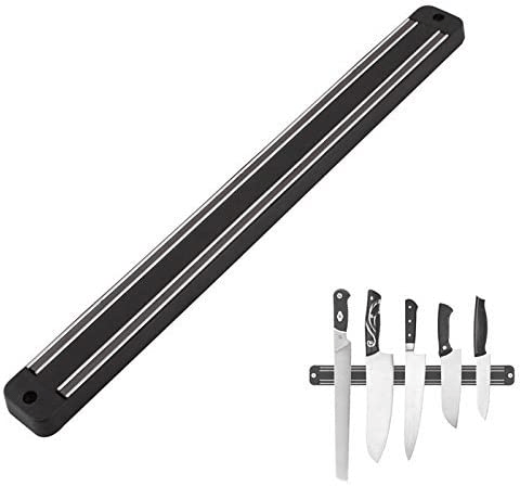

Hi ChrisMy first post on this thread. (I've only read pages 73 -50)
I found this (@ 4 minutes flat coil winding)
Would magnetic kitchen knife holders work?
Thank You
The original design by M.Deminiere used vertical stacks of neodymium magnets, each
measuring 30mm W x 30mm L x 10mm Thick.....you literally cannot pull a pair of them apart
with fingers, need some kind of jig to pry off the block stack.
You need this kind of force to accelerate the voicecoil/diaphragm, the little kitchen knife holder
would make a weak motor.
The polarity of the two magnet horseshoes also needs to be N/S not N/N.

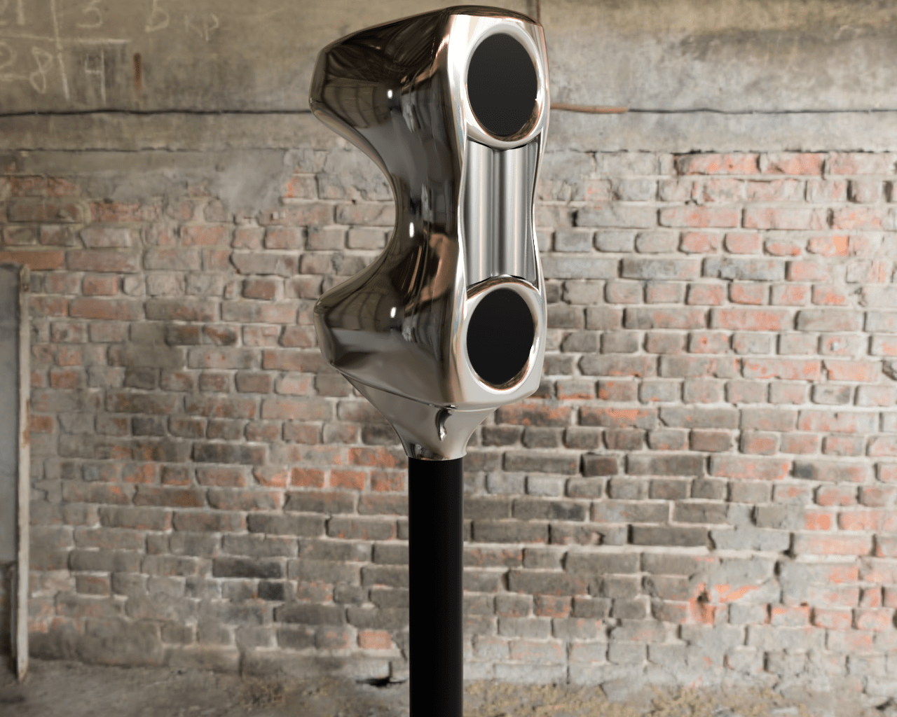

I'm unsure if I have the strength to get back into this game however after a few years hiatus, I think I own a few people an apology and more - Ti Jerry.
We all know that the Rubanoide is old tech (1920s) but with the aid of Finite software, cheap computing and AI, this is what can be achieved in the 21st century!
What do you think?
What do you think?
