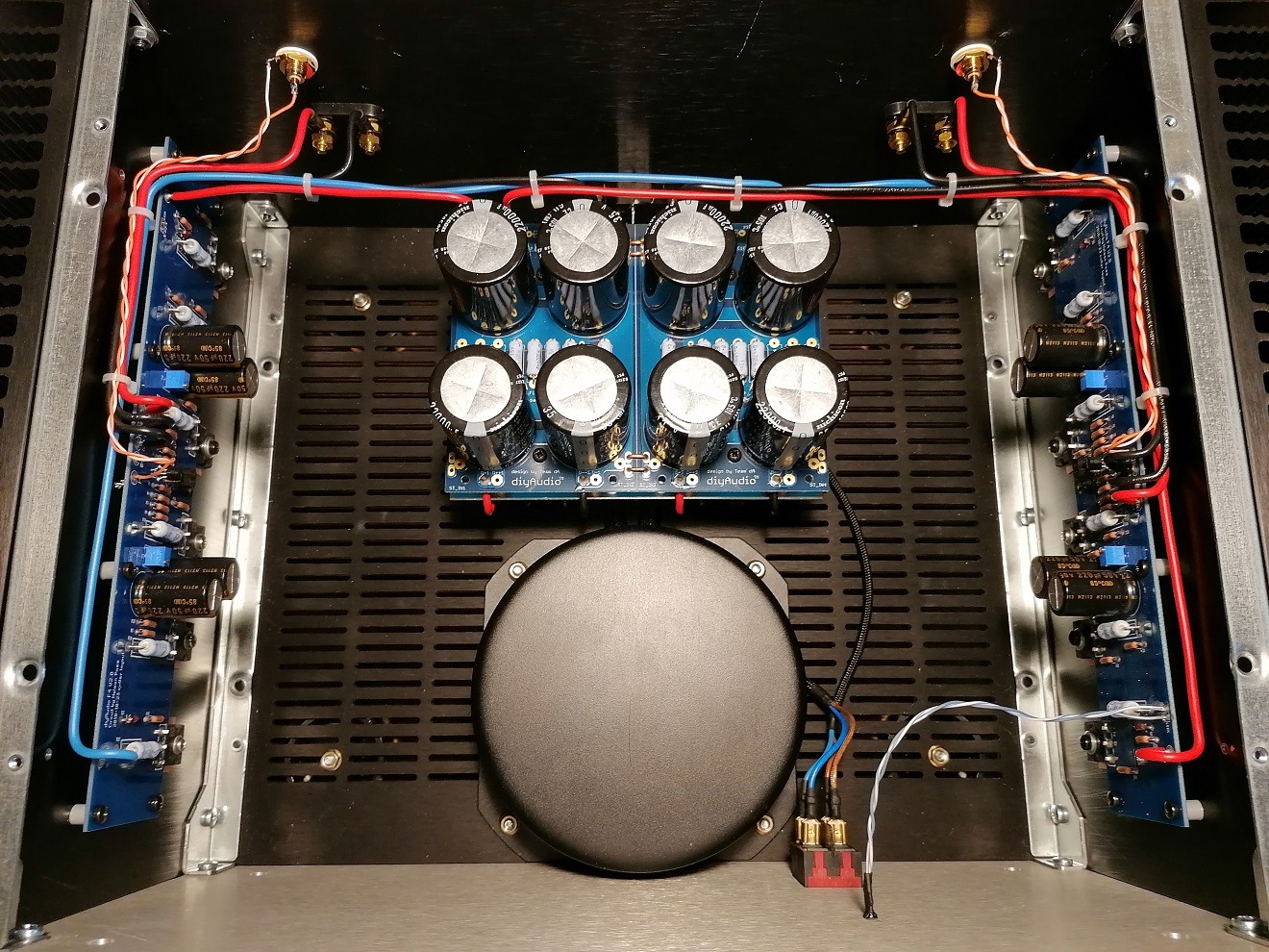

I have successfully finished building my first F4.
The #%@& metalwork aside, it was plain sailing. I did change R8 to 27k before mounting everything though.
I have been listening to it for a couple of days now, and it is hands down the best power-amp I have ever heard!
Totally transparent and in control. The GRIP this thing has on the speakers is quite simply phenomenal.
My reference in this regard, is a pair of pretty hefty monoblocks from the 80's, with the power to weld, and I honestly never thought I would ever listen to anything that would surpass these.
Well... now I have!
I cannot thank you all enough for making this possible. Papa for sharing your brain, and to all of you guys at diyAudio for making it possible to realize. THANK YOU!
Now... I do of course have ONE question:
Bias is set to 50C on the sinks, and I measure 210-230mV on all 6 critters in one channel.
On the other channel i get 170-190mV on 5 of them, and 285mV on the last (a Harris).
Is this a normal/acceptable spread or something I should worry about? I bought the kit from the diyAudio store.

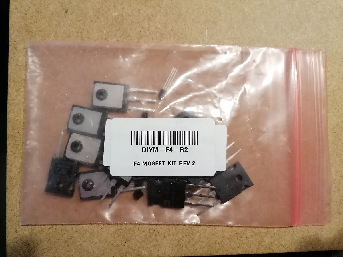

It's not 'normal', but if you've mixed one Harris part with let's say Vishay or other in the other 2 positions ... it's expected. I believe the Harris parts are known for having a slightly lower Vgs (it will turn on at a lower voltage and allow more current to flow at the same voltage). Not sure if that's accurate for your situation. Overall, the N channel parts are supposed to be matched for Vgs within each channel as are the P channel parts.Now... I do of course have ONE question:
Can't be certain until you provide measurements for each of the others and clarify if you just used that one Harris part in that one position or not... Until then, just speculating re: that one part.

Everything is quadruple-checked, and I did actually swap 2 of the Harris' to be sure I didn't mess up somewhere.
One of the Harris' is definately drawing more current, I just wasn't sure if it was within what could be expected from a matched set.
As ZM says it's not, would it be reasonable to ask the diyAudio store for a new Harris triplet?

Does the FET have an ID number? Maybe it can help the Store to find/solve your issue.
Quoting from the Store:
Any numbers on the MOSFETs are ID numbers only, and are not related to their measurements nor their matching
If it is not too much of a PITA, could you take some pictures of the case markings (mfg case markings) of the FETs.
It seems unusual (to me, but others may know better) that there would be two manufacturers within the same N or P channel MOSFETs. I may have misunderstood you previously though....
If they're the same product and matched properly (which should be the situation) then the issue is likely with your build. If they're not the same... then it is not certain, but it could be that the FETs are not matched to Vgs and it's just a simple mistake in your parts.
Either can be fixed, but it would be great to rule out any issues with assembly also. It would be a shame to get new matched FETs and have the same or a similar issue.

Yes, I have checked all resistors both visually and by measuring (multiple times).
The small ones are Dale RF55's and they are all spot-on. The big ones are Panasonics, AFAIR.
I have also moved the offending Harris, and the current draw follows this particilar one.
There is NO doubt that one of the Harris' is drawing more current than the rest.
I just wanted to know if the difference was enough to worry about, and since it is, I will get a new matched triplet.
