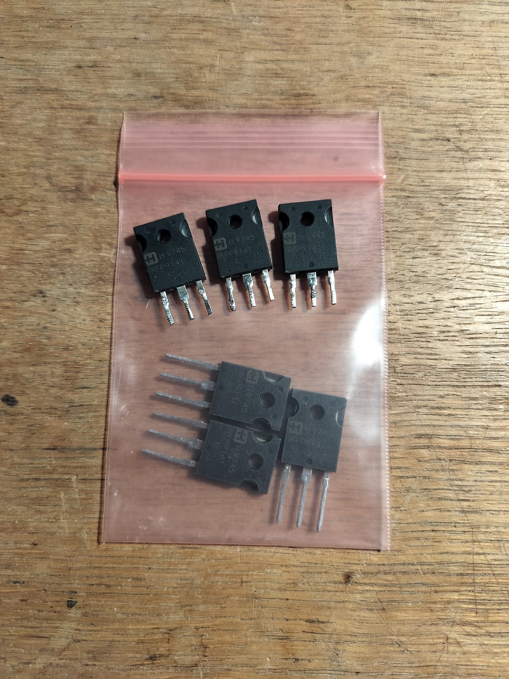

Send me your shipping address and I'll send you the Harris triplet.
Package from Mr. Harris arrived!
After cooking for a couple of hours i now have 212-228mV on all 12 critters. Sub mV offset.

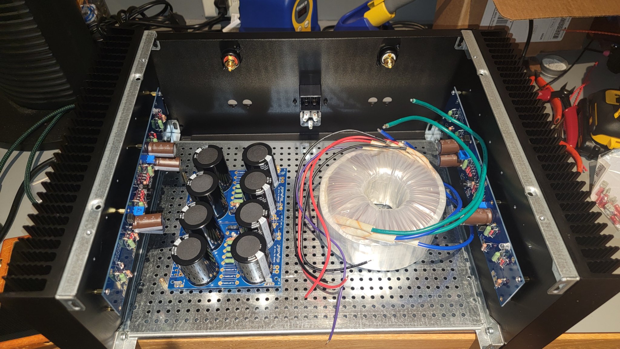

As I finished stuffing my F4, the 4U chassis arrived! I gotta say, it's a much tighter fit than I was expecting. I'm thinking about splitting the PSU board so the transformer can be centered. Wiring will be...fun...XD
Did you try to place the toroid in a upright position? With te cap-bank turned 90° you‘d get a symmetrical arrangement, And you would have all in 1 chassis. Not sure about switch, led, and rectifiers though…

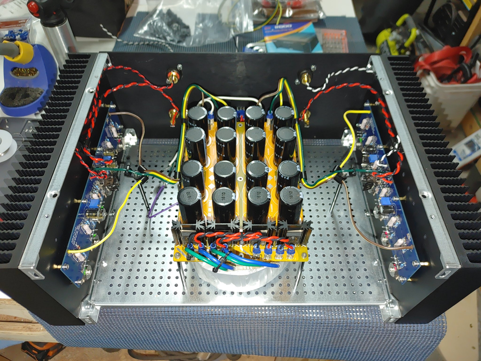

Here’s mine, 4u 300 mini… (toroid laying around under the capbank

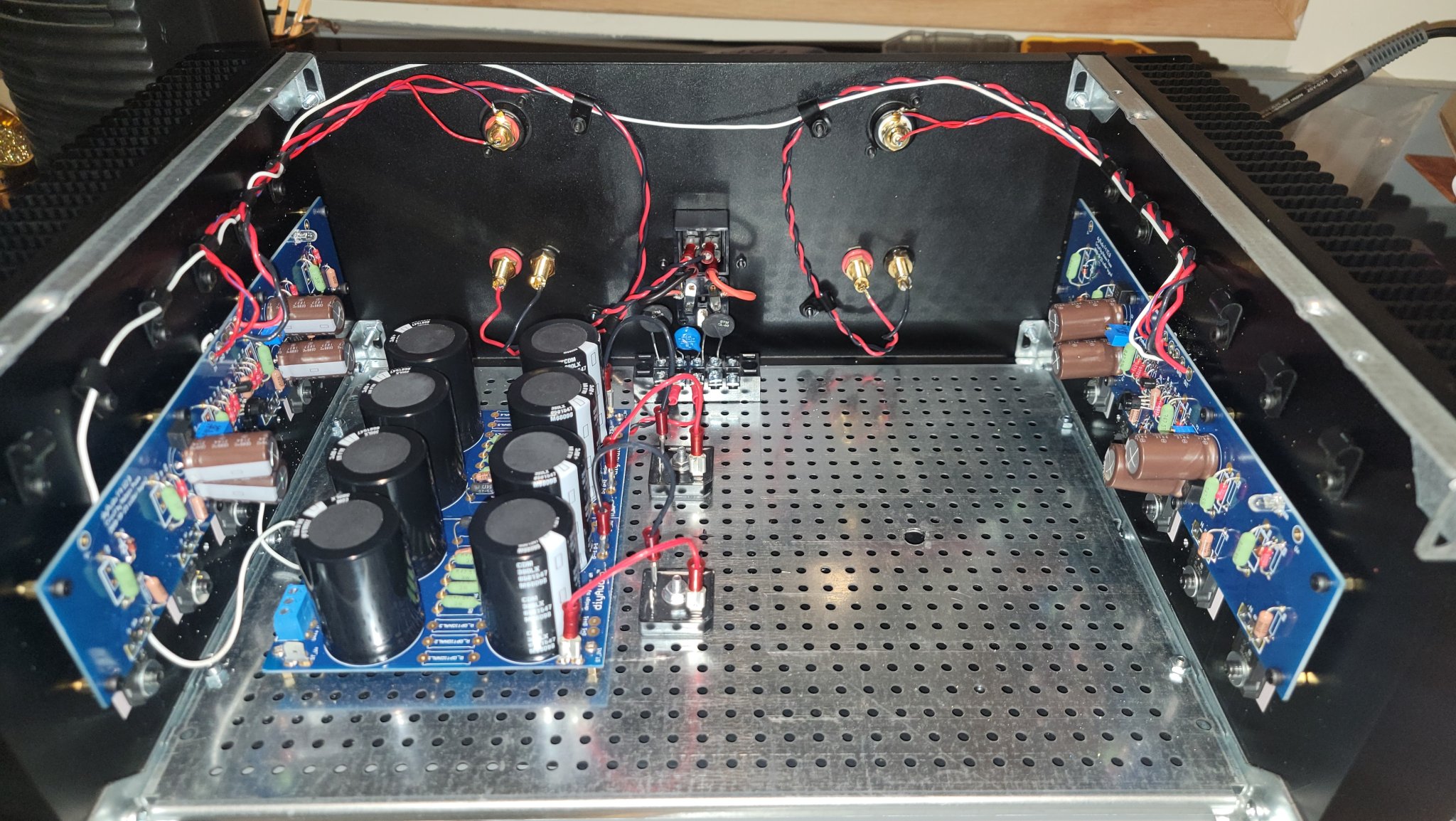

Wiring coming along! Calling it a night due to lack of usable light and beer. Transformer and power lines to be installed tomorrow or Monday. Yeah, keeping the xfmr on the right side; easier to work and it's an amp, not a jet. I don't care where its CG is!
...and cheap channel delay for echo effect.why I didn't ever think of that - having PSU wires longer to one channel and xformer closer to same one ....... just leads to greater entertainment factor!

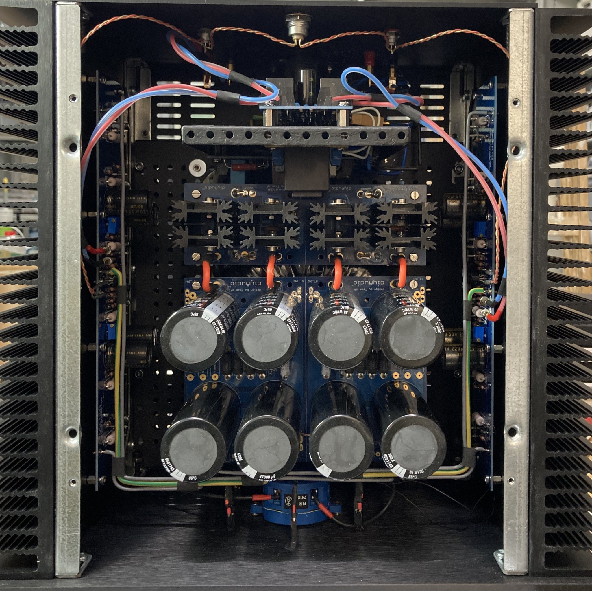

xformer all the way up to front plate , then bridges then Cap Bank centrally
equal length of power wires to channels, easy arrangement of signal wires to avoid ground loops
as I'm always saying - if in doubt - look at original FW pics - plenty of those around
6moons site, for example - almost every FW amp covered with high res content
if you keep it symmetrical, no troubles
