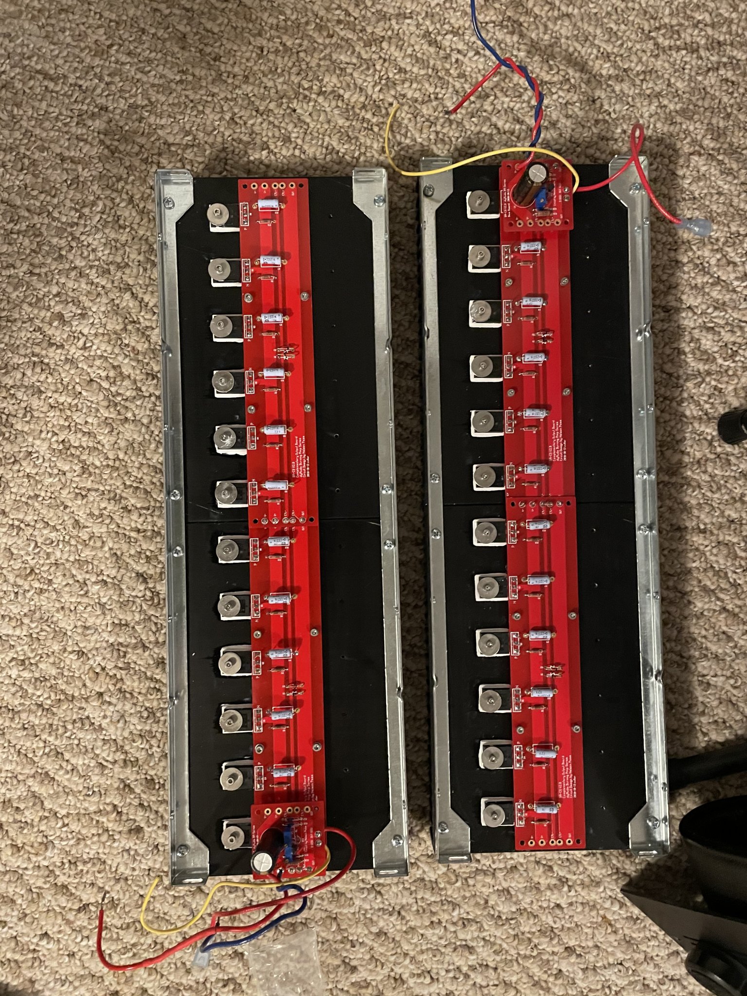

^ I say go for it. I think my sinks in this were ~55C in a 21C room. That may have been at more total dissipation than you're planning for your F4s... I think I was at ~150W per side / pair of sinks when I tried to make it a true burning amp. I can check my files if it's critical. I think I took temps at each bias setting.
The 5U/400 have a wee tad more surface area / mass than the 4U/500... I recall like 2%. Also, Nelson published the doc attached... He notes 158W for a 30 degree rise.... so... that seems to be close enough...
Depending on the voodoo that you do, you'll be cool... or hot...
Both meaning ... Me... I'd go for it. but ... others may not like it quite so hot.
Edited to add - If you have the space... 5U / 500 ensures a proper fun factor.

Note - My temps are on the FINS... not on the hottest part of the sink. I was/am more concerned with the more practical, is it too hot to touch. I typically measured 10ish or so C higher on the hottest part of the heatsinks to see if the devices would break a sweat. In my case, the dissipation per device was no big deal, and I was not worried about junction temps.
Nelson's temps (I think) are calculated from the Modushop data (I believe) vs. actual measured temps from use. It's also lkely that those temps are from the hottest part of the sinks to make the temp data look the best it can look. They published their study. It's REALLY good. (Attached). That ModuShop data is not derated.
So... all that is to say... YMMV... and you're going to be close. If you've never put your mitts on a 55C sink, it's likely going to surprise you.
Do some calculations based on your expected dissipation and get a few others to chime in. I'm a fraidy cat, but I also don't mind a hot pair of heatsinks. No kids, pets etc, and no worries (too much) re: cooking output devices.
Edited to add a little more context and the modushop study upon which their data is derived.
^ Awesome! When I started getting things a tad warmer, it REALLY surprised me the difference between 45, 55, and 60. Nelson describes it well, but ... until I experienced it for myself. Resting my forearms on the sinks while tweaking pots was ill-advised.

How many channels of Mofo boards do you need?
M.R. mentioned there will be more boards in store after BA. I have 2 pair monoblocs made for bi-amping or bridging. Newark messed up my heatsink order so I have a spare 180MM that I can use for a sub channel. Do I order another Boyd H/S and bridge or run what I have????

Right now Xmo is not letting me werk. I am thinking I will bridge a sub channel.
There‘s also the possibility to add a ZM Babysitter (enhanced airflow).
If going for that much temp, I would consider some measures to keep away the Capacitors from it, to save some lifetime.
