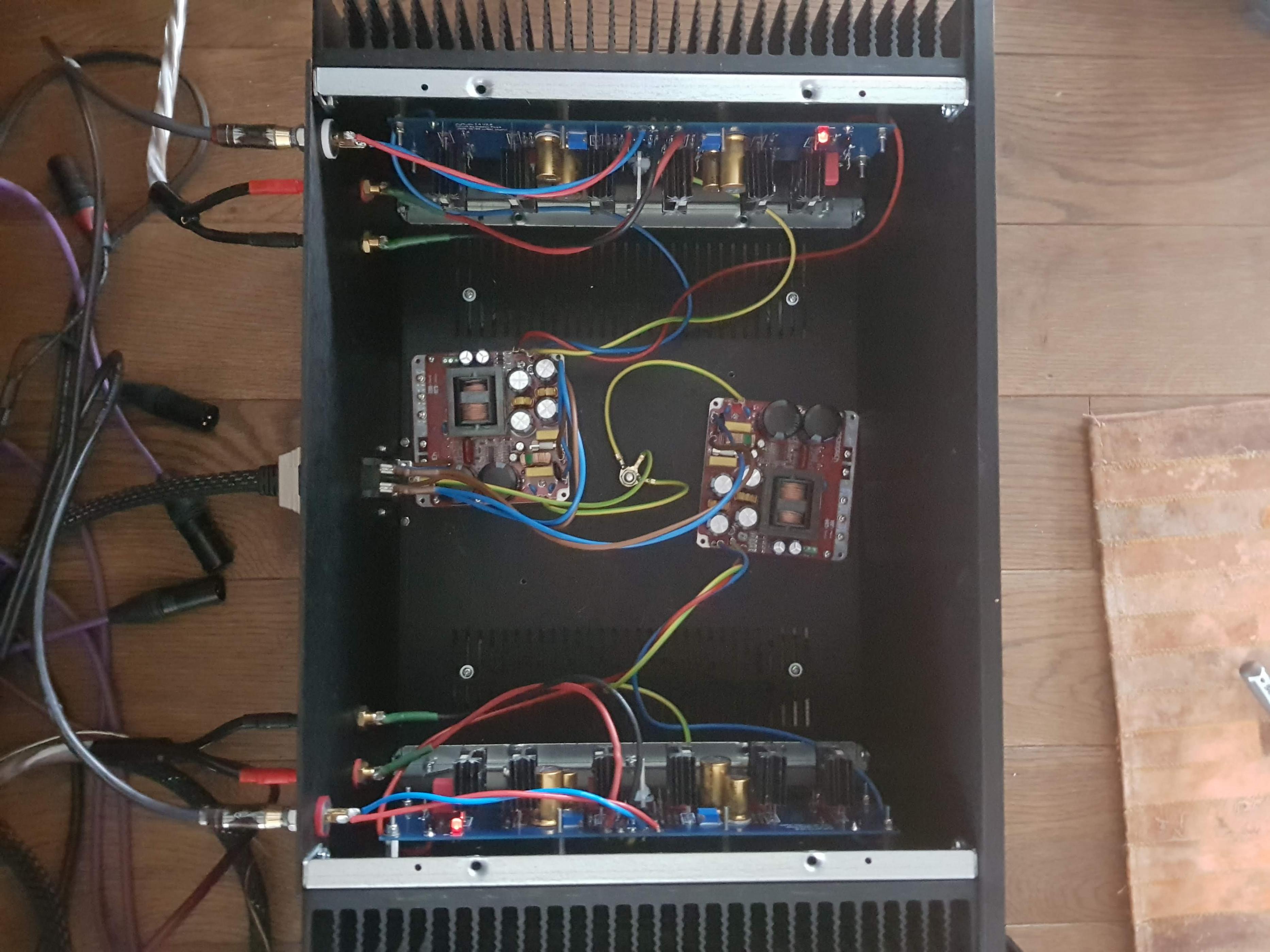

F4 running on two SMPS300RAh -/+23V from connexelectronic (soft start already built in). One unit per channel.
200mV bias. None of the electronic components (both smps nor transistors) exceeding 50 degrees (celcius) in 5U/300mm chassis.
I will compare it to traditional transformer + caps sometime soon ... but so far I have no motivation, because it sounds amazing! The sound integration and continuity is just phenomenal. Especially different bass layers and top end!
It is driven by 2xad1865 dac (transformer I/V out) directly. No additional gain needed for my needs on TQWT MKIII speakers.

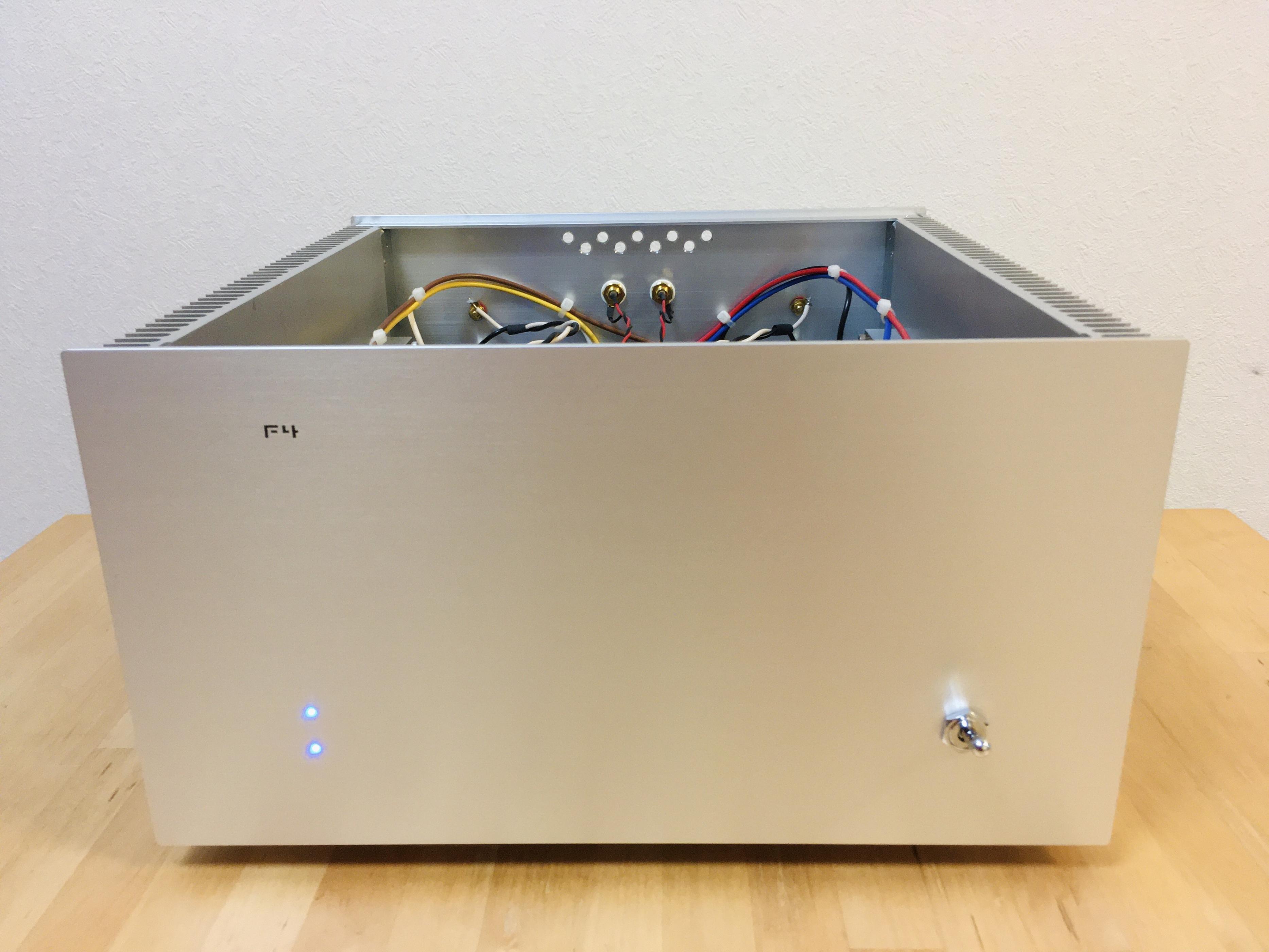

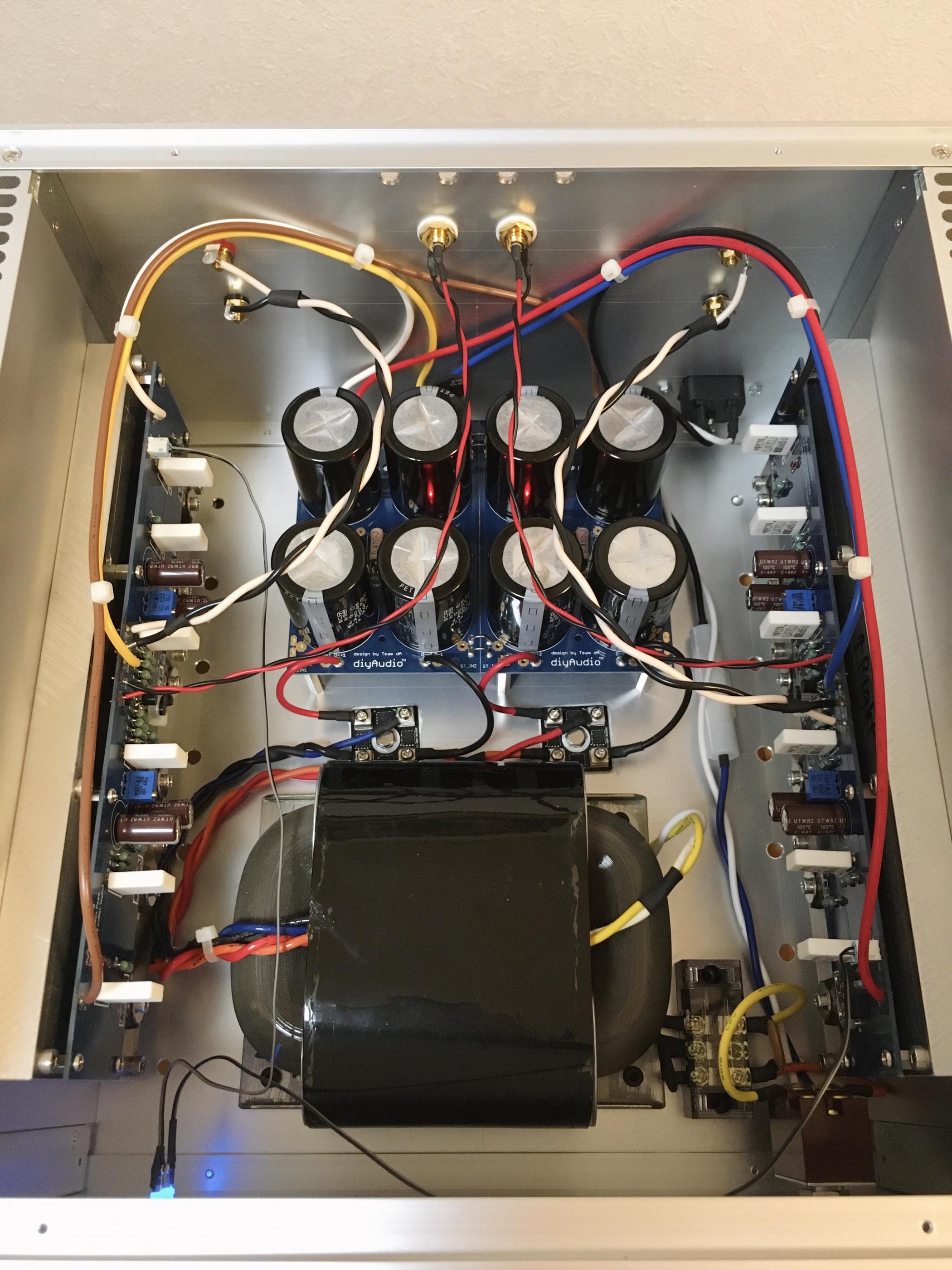

Another F4
Finished up an F4 few days ago.
It may sound different from original design, because I use japanese audio grade parts. Anyway It sounds good. Really good.
Thank you 6L6, Nelson.

Bad news 🙁
Although those SMPS were designed for continuous current of Class A amps, after couple of days of playback one of the SMPS failed 🙁 Fortunately they are -/+, so both rails at the same time. Nothing happened to F4 Module nor to my speakers.
No I got my motivation to go with traditional approach: transformer and caps 🙂
On the other hand those units are very good. I used them with success and no issue with many Class AB amps. Either I had bad luck and received faulty one this time or F4 is simply too power demanding for them, especially @ 200mV bias.
