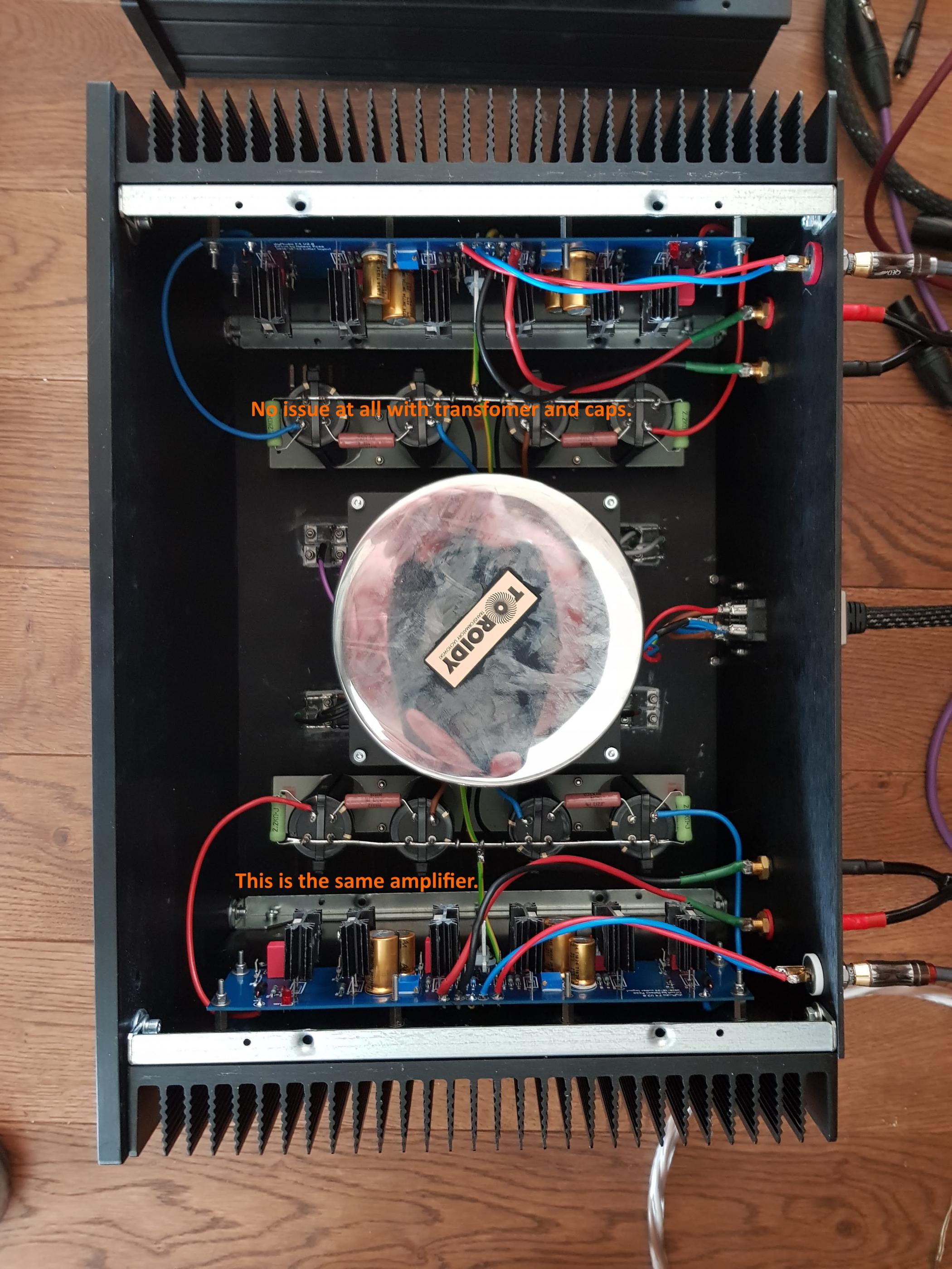

Parallel vs Balanced
I am in my final stages of my F4 build.
I have two mono block chassis and two F4 amps per mono block. 650VA per block.
Speakers are 4ohm and 88db and I listen mostly to music with good bass
Shall I go balanced or parallel?
Balanced the amp will see the speakers as 2ohm and damping factor will be 20 instead of 40.
Will I lose bass punch with lower damping factor?
Will the amp go out of Class-A early due to 2ohm?
In Parallel mode the amp will see the speakers as 8 ohm so I guess the amp will not go out of Class-A early.
Will parallel give me a damping factor of 80 and a bit tighter bass?
Do any one havde good experience?
Many thanks in advance.

I’d suspect bridge balanced would work better for you, the F4 has no issues with current delivery.
Thanks!
Balanced the amp will see the speakers as 2ohm and damping factor will be 20 instead of 40 so will I lose bass punch with lower damping factor?
Will the amp go out of Class-A at low watt due to 2ohm?
