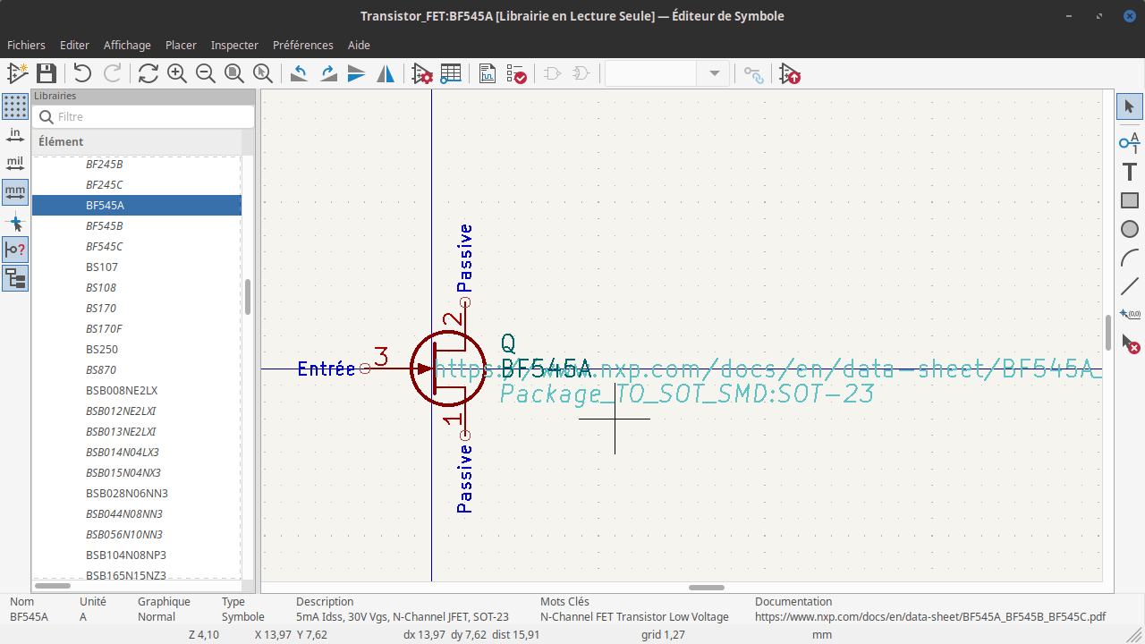

This morning I was ready to start putting everything into the KiCad software. Unfortunately, I am already blocked at the LSK489 and LSJ689 schematic transistors. First, they don't exist in the library! I am comfortable to create my own library parts but these are two units in a single package. It is already risky to create a library part with it's footprint with three legs without making mistake, now this one has two parts in a single package, nothing to minimize risk or error on the final PCB!

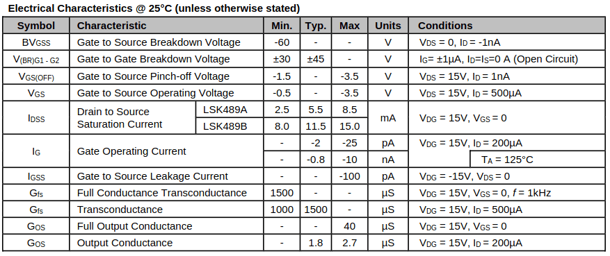

Second, I could find the LSK489 on Mouser, but as usual, the brother LSJ689 is not available :-/
Are these already obsolete?
Does some one have a good source for these JFET?
Is is a good think to sacrifice the benefit of these JFET and replace them with 2N5401/2N5551 transistor? I bought 100 of each!

Lsj689 is not obsolete it’s just not stocked by mouser or digikey. Always refer to the mfr web site
For the Dh-220c kits I sell on eBay I buy mine directly from linear systems
I have bought them elsewhere too iirc it was a place in Florida but that was a few years ago

We specified lsk489 before they offered Idss grading. Does not matter because lsj689 is not graded anyways. I test, select/match them as pairs. That’s why I designed a sot-23 to dip6 adapter to make selection and service easier.
Bob has a write up on selecting the jfets in his web site, all a good read in understanding the mechanism

Of course the easiest way to build a new part is to start with an existing closest one. The only one I can find in the library list, close to a JFET, is the BF545A part. Now I did that mistake with the inverted Drain and Source of the PNP ECX10P20 in my first design and I don't want to do a similar mistake here. Again the Gate of this library is placed in the center compared to the Gate of the Figure 9.20 Example IPS-VAS of the book. Both are labeled "Passive" in the library. Does the Drain and Source pins really are Passive pins or this particular library part is different?It’s pretty common to have to build your own library components for unique parts, all part of learning ecad, a lot easier than building a 3D model I would think
You need to double check your work and the library. Need to check schematic symbol, pin numbering, assignments against pcb footprint and pin orientation against the device data sheet
I would not worry about the pin function assignment, passive that just for some electrical rules checking.
I do not use kicad so I can only speak in ecad general terms and usage.
One thing I have learnt over the years do not trust the generic libraries in the ecad toolset distribution, everything needs verification.

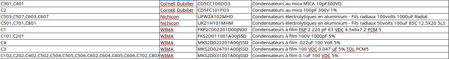

- While creating my parts list, I tried to use WIMA MKS 2 Polypropylene capacitors but I wasn't able to find all values in this series. Is it a good choice to use something else, like MKP_4 or FKP_2 ? Here are my actual parts list:

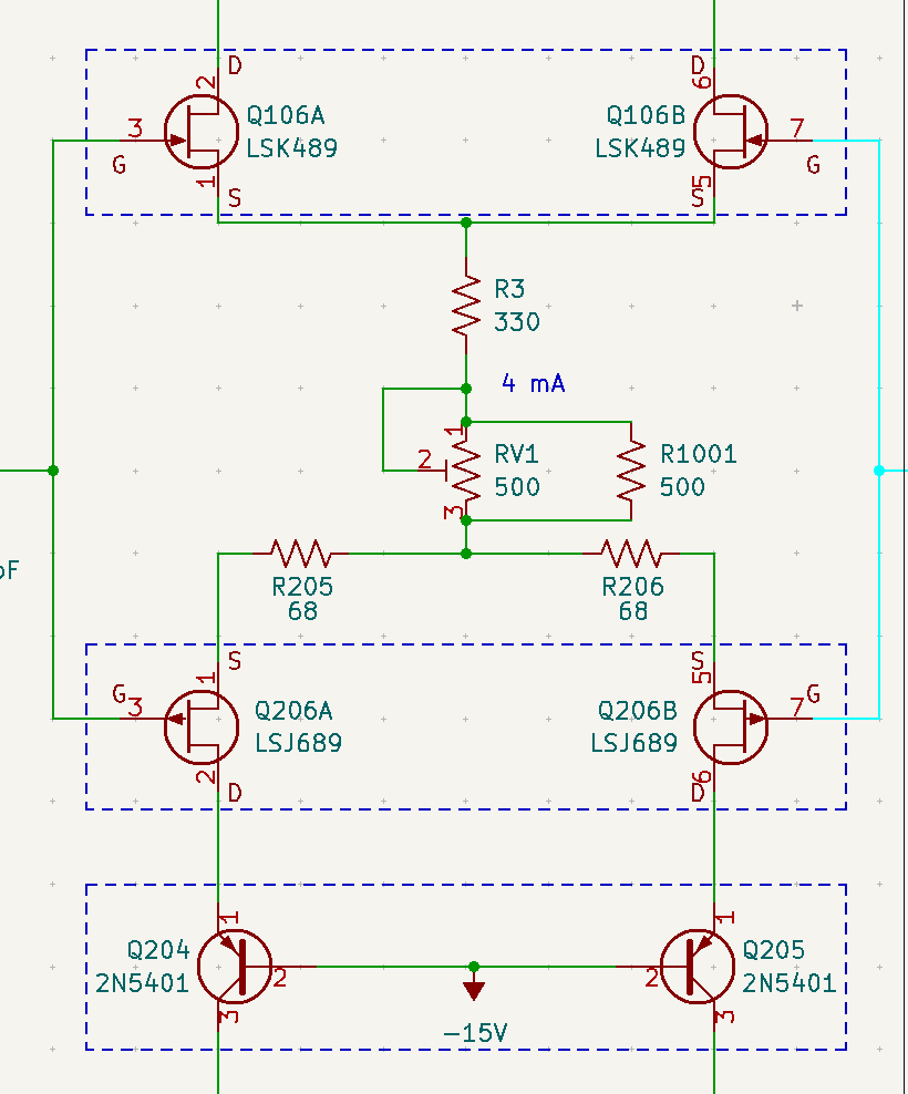

I have achieved a lot since my last post. First, I found a ton of LTSpice libraries compatibles with my KiCad software under Linux. Here is the link...
Second, and the most beautiful thing, I don't have to redraw the schematic to use the simulator. I only have to add three Simulator components; 2 DC voltage sources and one AC voltage source.
Third, I found one library that had the two LSK489 and LSJ689 JFET. Here is the link:
But now, when I try to run the DC simulation, I get this error message and I cannot figure why I got it (if we pass over all the warnings for now):
Q206A
Is if it doesn't see the connection between Q206-pad5 and R206-pad2. When I play with them, trying to redo the connection, I got the same error excepted that it complain with:
What do I miss ??
Note: Compatibility modes selected: lt
warning, can't find model 'net-q206-pad5' from line
jq206 net-r205-pad1 net-q204-pad1 net-q106-pad3 net-q206-pad5 net-q205-pad1 net-q106-pad7 lsj689a-ls
warning, can't find model '<no_net>' from line
jq? <no_net> <no_net> <no_net> <no_net> <no_net> <no_net> lsj689a-ls
Circuit: KiCad schematic
Warning: Model issue on line 10712 :
.model d1n5240 d(is=1.953f rs=2.305 ikf=0 n=1 xti=3 eg=1.11 cjo=68p m=.3 ...
unrecognized parameter (ibvl) - ignored
unrecognized parameter (nbvl) - ignored
unrecognized parameter (tbv1) - ignored
Warning: Model issue on line 10737 :
.model d1n5245 d(is=3.142f rs=3.536 ikf=0 n=1 xti=3 eg=1.11 cjo=80.5p m= ...
Error on line 39 or its substitute:
Unable to find definition of model net-q206-pad5
Background thread stopped with timeout = 0
Error: no such device or model name
Error: circuit not parsed.
My understanding is that the jq206 model has 6 nets listed above and that they correspond to each pin of the model, like this:Q206A
1(S) -> net-r205-pad1
2(D) -> net-q204-pad1
3(G) -> net-q106-pad3
Q206B5(S) -> net-q206-pad5
6(D) -> net-q205-pad1
7(G) -> net-q106-pad7
Unable to find definition of model net-r206-pad2
What do I miss ??
