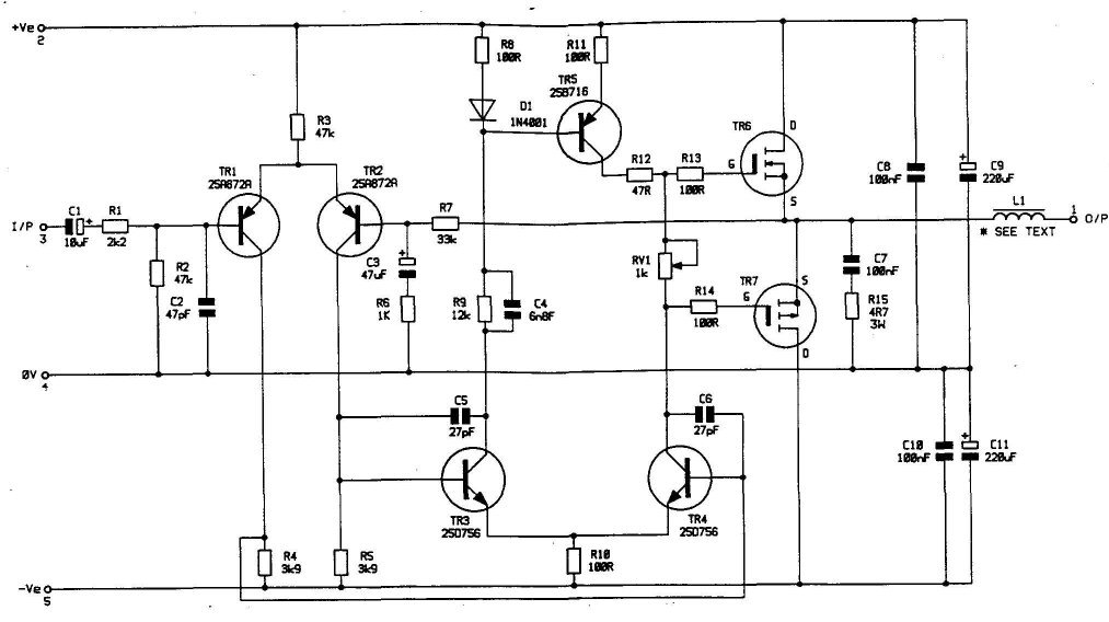

This part is a double dice. For now, I contoured the problem by using two JFET A units instead of one JFET with units A and B in the simulation. But I have no gain in the simulation. I also disabled all the zener diodes and replaced them with DC voltage sources in the simulation to get ride of their errors in the log.Please post your original simulation files. Then some expert will chip in and help you !
I do suspect now that these JFET models aren't right. I have start the chapter of the book on the model creation and modifications. I will test the models following the procedures in the book first.

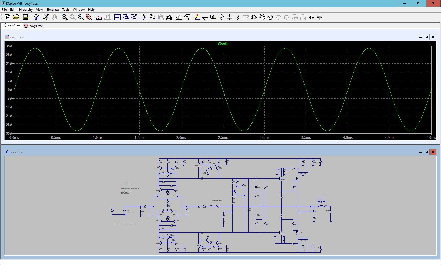

V3 (negative 55V) is drawn upside down. So you have 2 rails of +55V.
Here is corrected asc file that at least plots Sinus at the output. Run sim, and click on 'Out' to see it.
Not sure how you could have simulated "DC operating point" or "AC Analysis" with bad rails.

I am now able to get the expected results. RV1 is set at 170 Ohms with R3 at 120 Ohms for a current of 4mA into R3. RV2 is set at 379 Ohms for a current of 18mA across R505 (TP3).
I can raise the input to 1.8 Vpp and get an output of 50 Vpp without distortion. At 1.9 Vpp I start to see distortion.

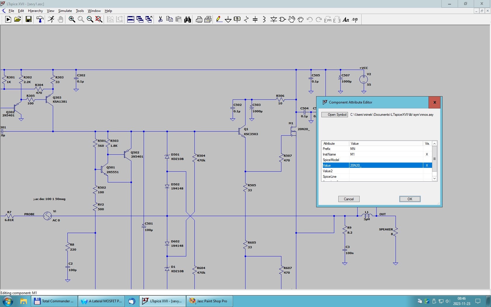

Quick LT Spice hint on how to use models from user's lib file:
a) CTRL + Right Click on the element
b) a popup will show up, see picture attached
c) Change (manually type) the 'Value' field to some 'name' from your lib
d) Click OK
Now here is a tricky part:
In the attached example image you see 'Prefix' set to 'MN' (N channel Mosfet), that's correct, BUT
if your model in the lib file is defined using .SUBCKT keyword (e.g. for FQA36P15 mosfet in my minek.lib),
as opposed to .MODEL keyword, then you need to set prefix to 'X'.
