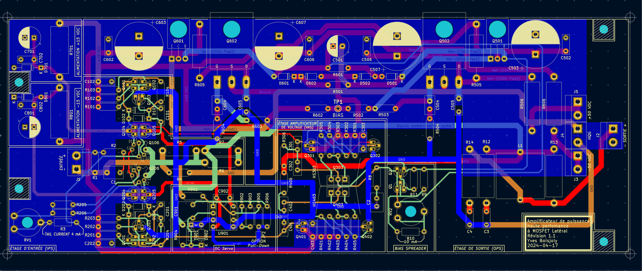

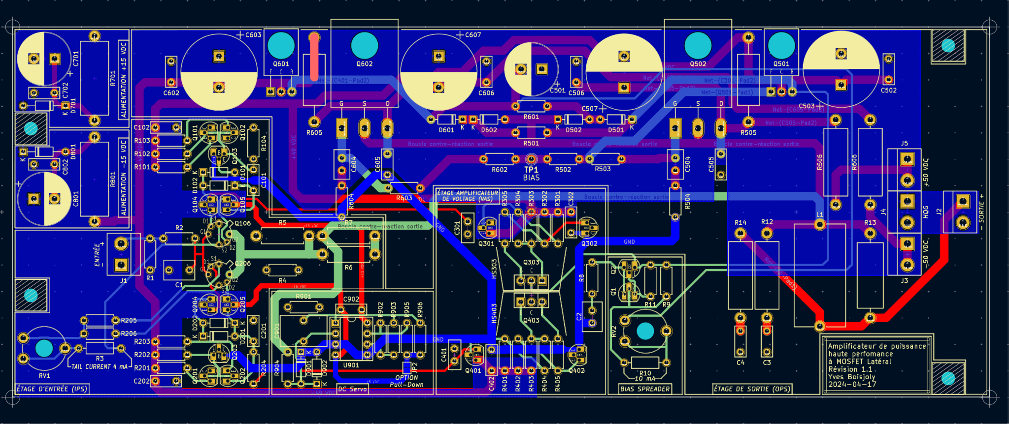

It’s not really a ground plane - the ground, supply and output rails are just grouped to minimise EM radiation while for the input small signal ground and feedback paths, it’s grouped together to minimise susceptibility. The ground connections at HQG are definitely star ground to make sure there is no common impedance coupling.

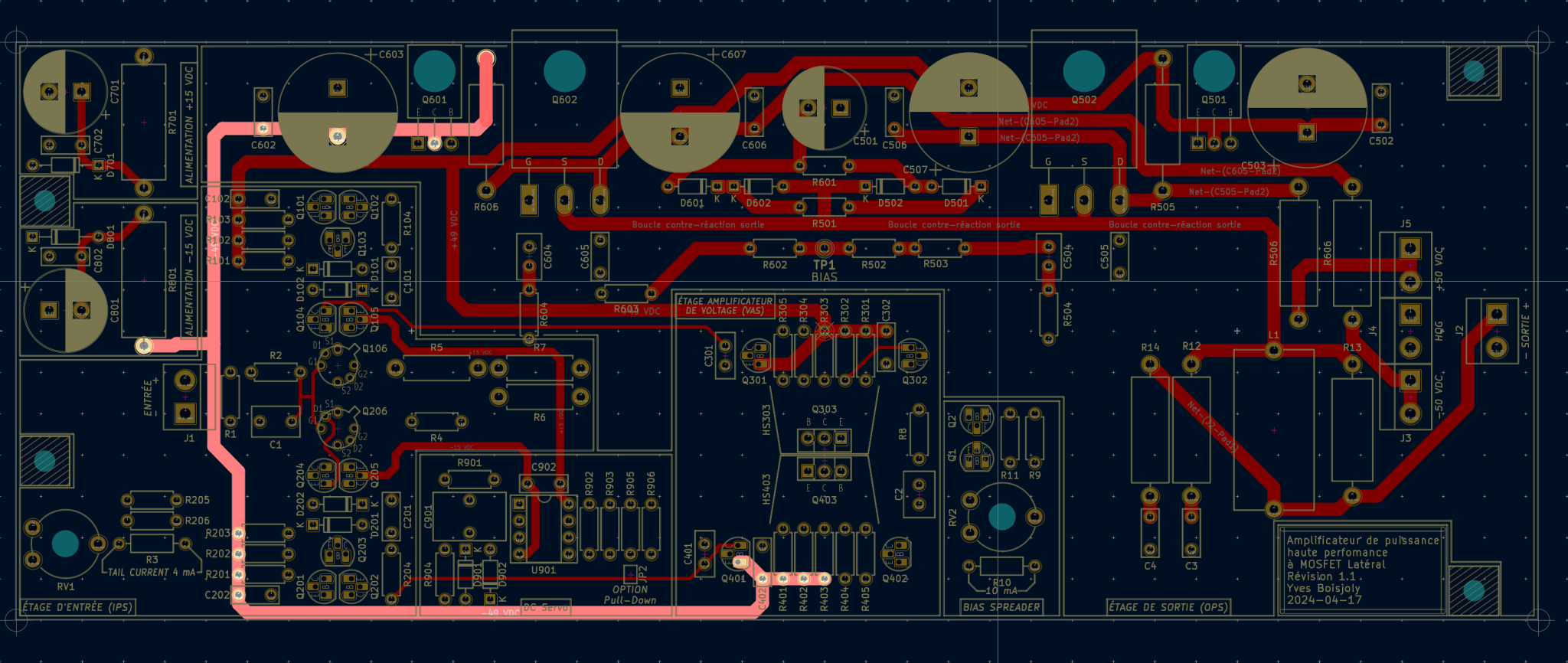

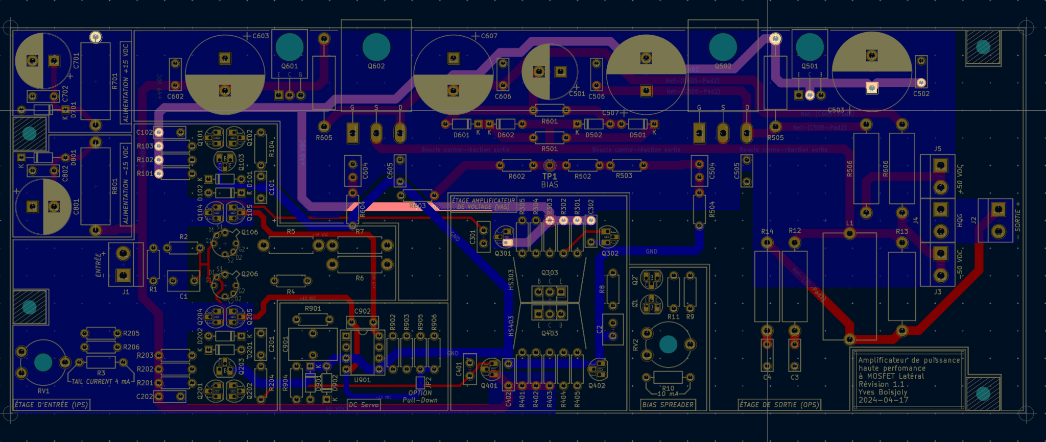

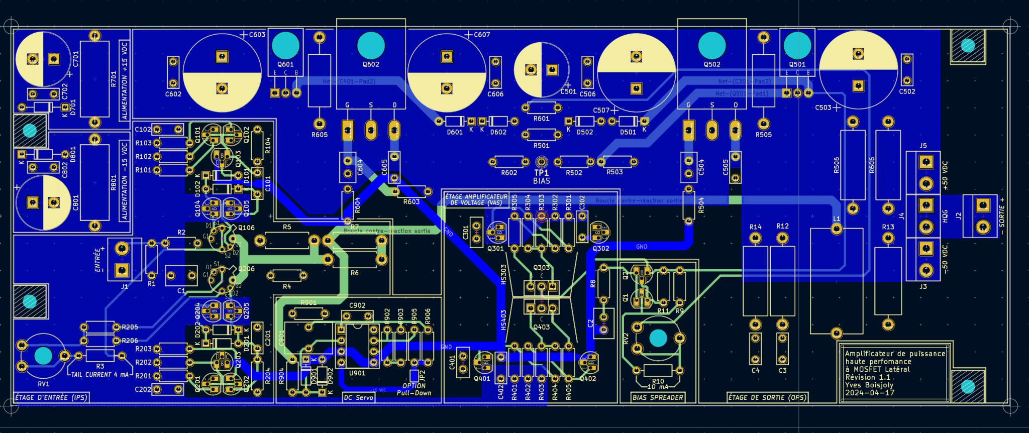

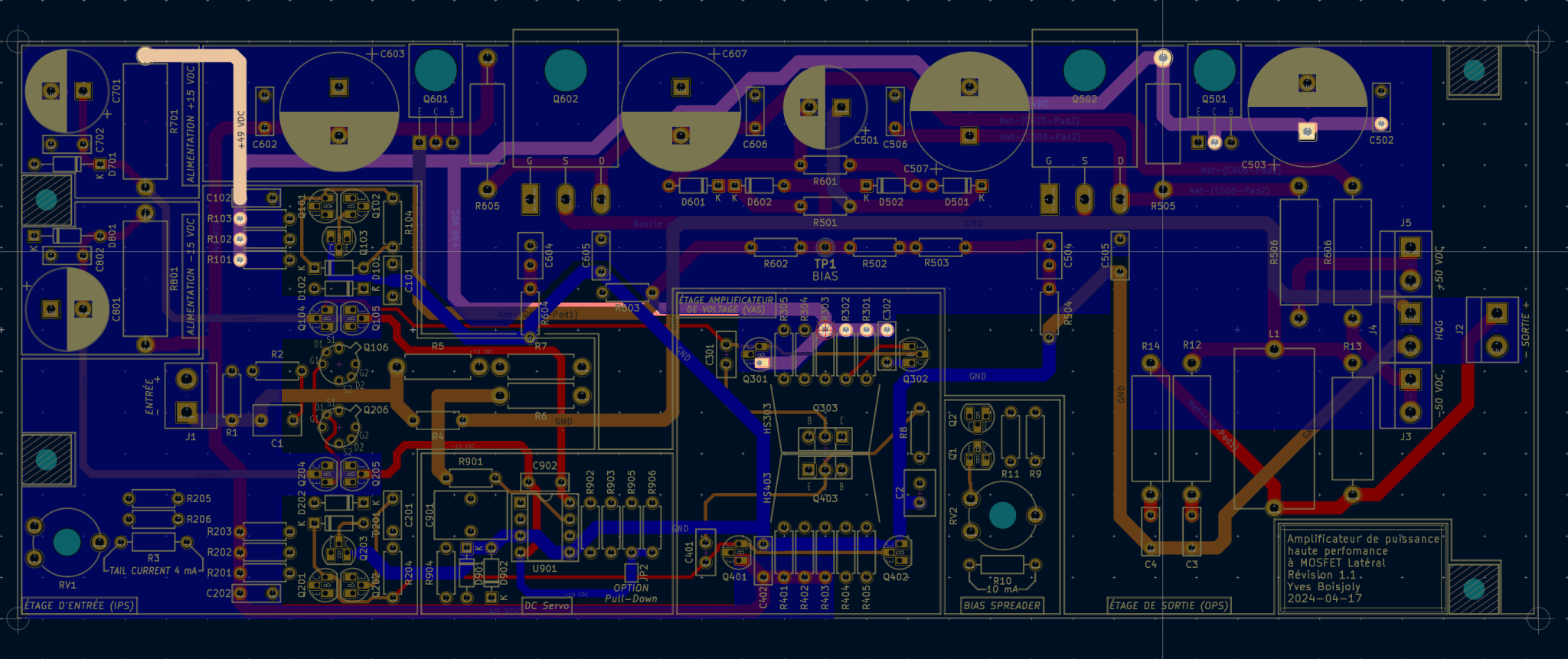

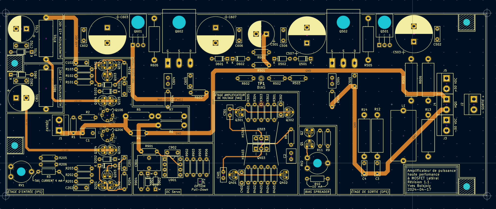

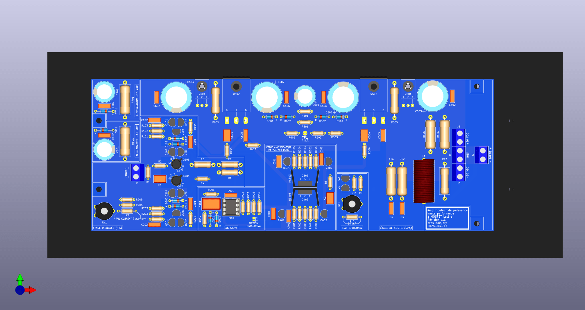

So, here is the latest version. I tried to keep in mind that all powers rails and NFB traces should have a ground surface over them on the components side. I also putted the two TO-220 transistors of the VAS back to back with their own heat-sink. I am surprised how space available is still there, even after having shorter the length of the PCB. I also minimized the Power of resistors R503/504 and R603/604 to 0.250W. I kept some spare space for the coil L1 knowing that the number of required turns an diameter for the original 3uH is a bit bigger and longer than the 3D model.
I kept the R4 resistor ground trace to the Speakers connector isolated with it's own trace on layer Cu2. I also tried to minimise the components ground surface as much as possible while prioritizing the cover of sensible traces under it on the others layers.
All the Input and VAS ground are isolated from the components ground surface, the latest reserved for +/-rails ground. Here some captures in the goal to well visualize all the details explained above.

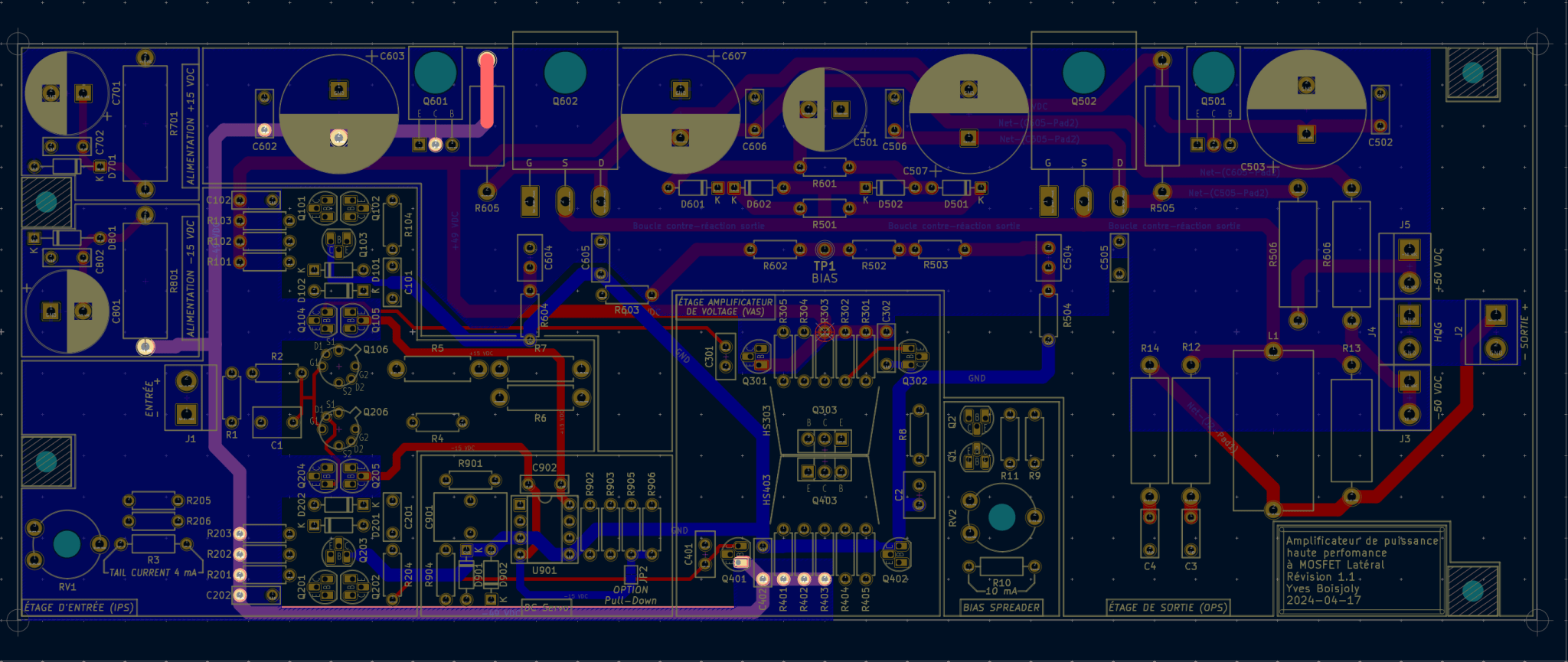

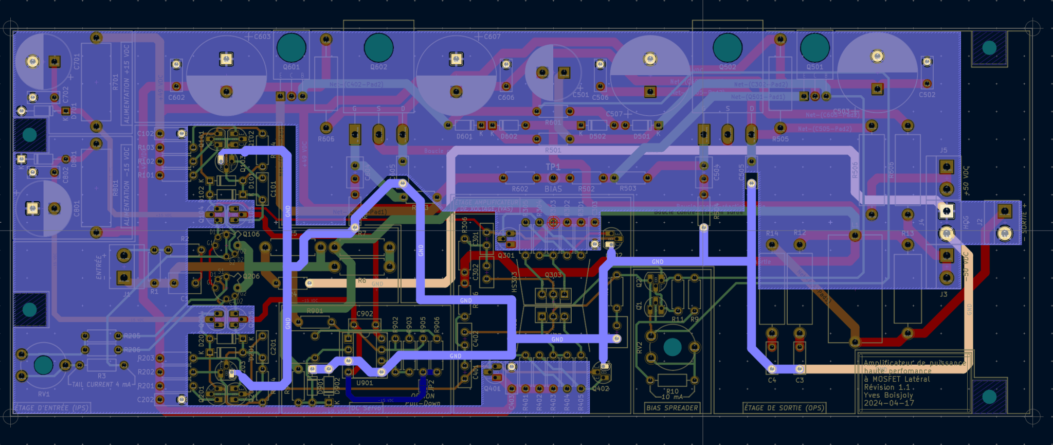

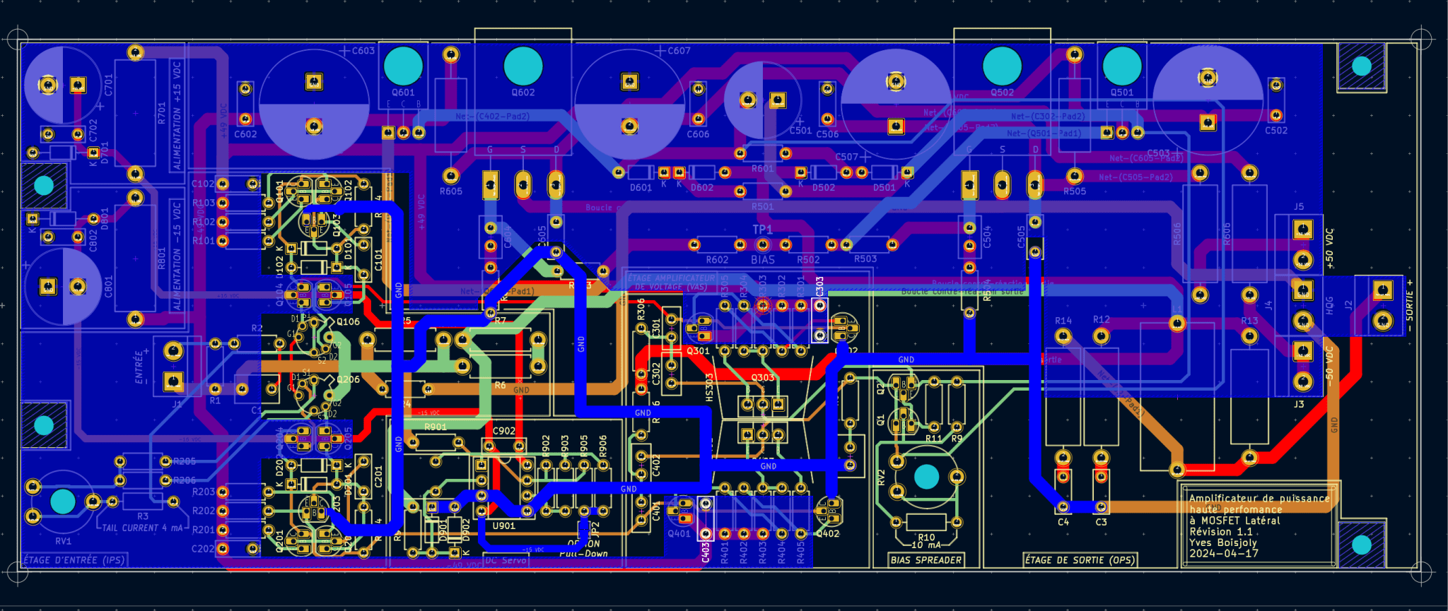

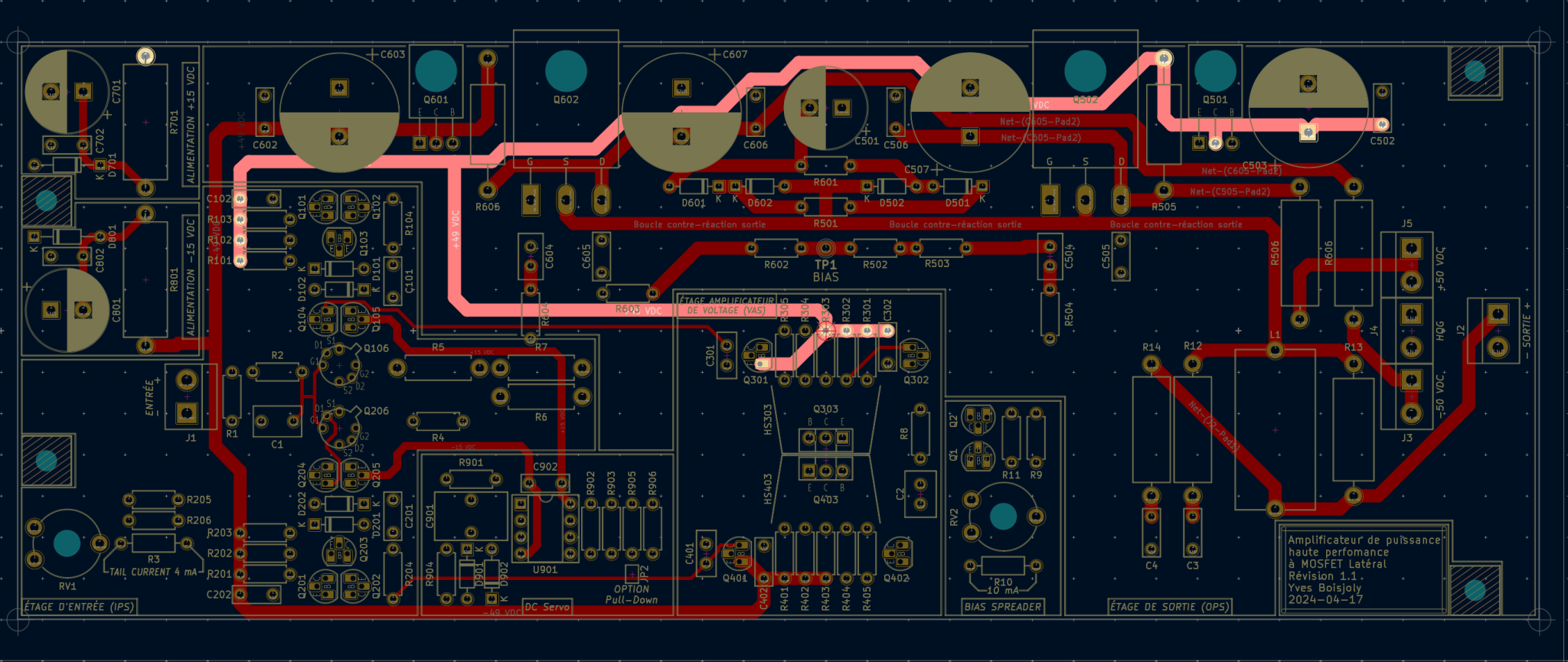

Here are the +49 VDC traces first, followed by the same picture with the ground surface of the components layer. The only one trace on another layer is highlighted on the Cu2 layer in the third picture:

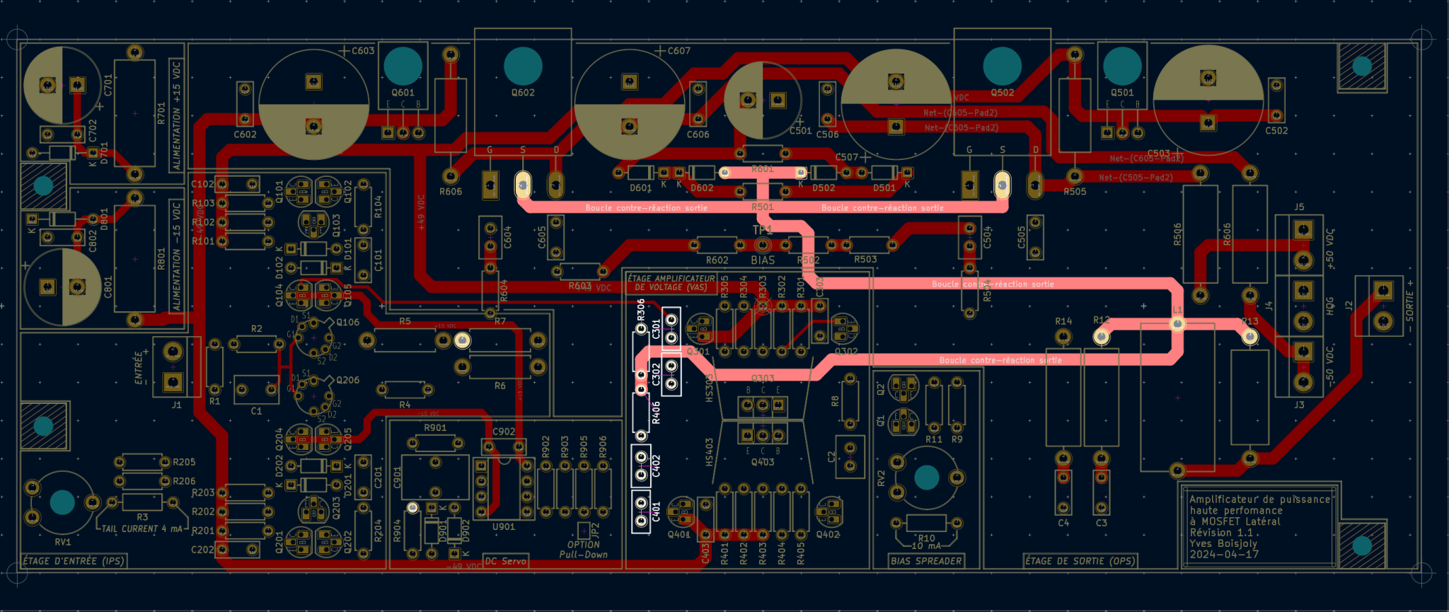

Here are the -49 VDC traces first, followed by the same picture with the ground surface of the components layer:

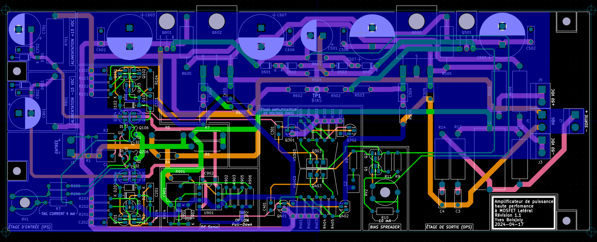

Then the Cu1 internal layer, followed by the same image with the Components layer surface that cover the NFB traces:
Idem for the Cu2 internal layer:

And finally all four layers showed:

If this is an initial design, I may be tempted to make the board out of multiple lower cost PCBs (smaller size that fit into their cheap protoboard size) split - powersupply, driver, power stage etc. That way you can adjust as you go along and typically you get 5 boards or so for each panel design (although protoboards typically are restricted in copper thickness).
The reason is the larger boards typically are more expensive and one mistake in a 4 layer board can result in a completely unusable board.
This technique doesn't stop you from making a panel that is a number of designs on one - such as a driver section but to use up the board space, add some regulator designs etc that are separate from the copper pour etc and then cut them to divide them using a Dremel or tile hacksaw. Just remember to have enough thickness for the blade and some more for human accuracy between the designs.
I do this for my PCB designs and you build up an inventory of bits you know you will need for future projects.
Also note that you will probably get charged more for internal via or micro vias. I will typically use through visa for the most part.
Last point - careful of the tolerances of manufactured parts. C506 seems to be up against the large cap next to it. Large caps can also 'sing' under heavy load. I had that with my amp on the dummy load - you could hear the test tune due to the caps singing. You'll need to be able to glue them down too (or silicone but silicone can turn acidic over time). So any splurge at the base will cover close components too.
The splurge comment is that the silicon/glue can then act like a thermal insulator, lowering the thermal rating of that part (sorry if that reasoning wan't clear). So just consider that - I've seen 5W resistors glued to PCBs and splurge covering components that really need cooling (adds noise and can increases failures).
This is not a first design. I have already builted two working PCBs based on the exact same schematic. The raison I redo the PCB is because my lack of experience in Amplifier routing have made me make the mistake of routing long separate traces for the +/-rails power supply, that have created ground loop. The amplifier is already builted into it's 3U Modushop case and it was already pleasant to listen, except for a tiny tiny little hum on one channel. That hum as been the whole starting point of this new thread.
I have no micro VIA. I made a simulation of the cost and yes it is more than the double for the same size two layers one. But if you have a closer look at the traces layers above, unless you make the design on separate boards as you proposed for each section (IPS, VAS, OPS), it is impossible to make it with only two layers. I tried more then fifteen time lol.

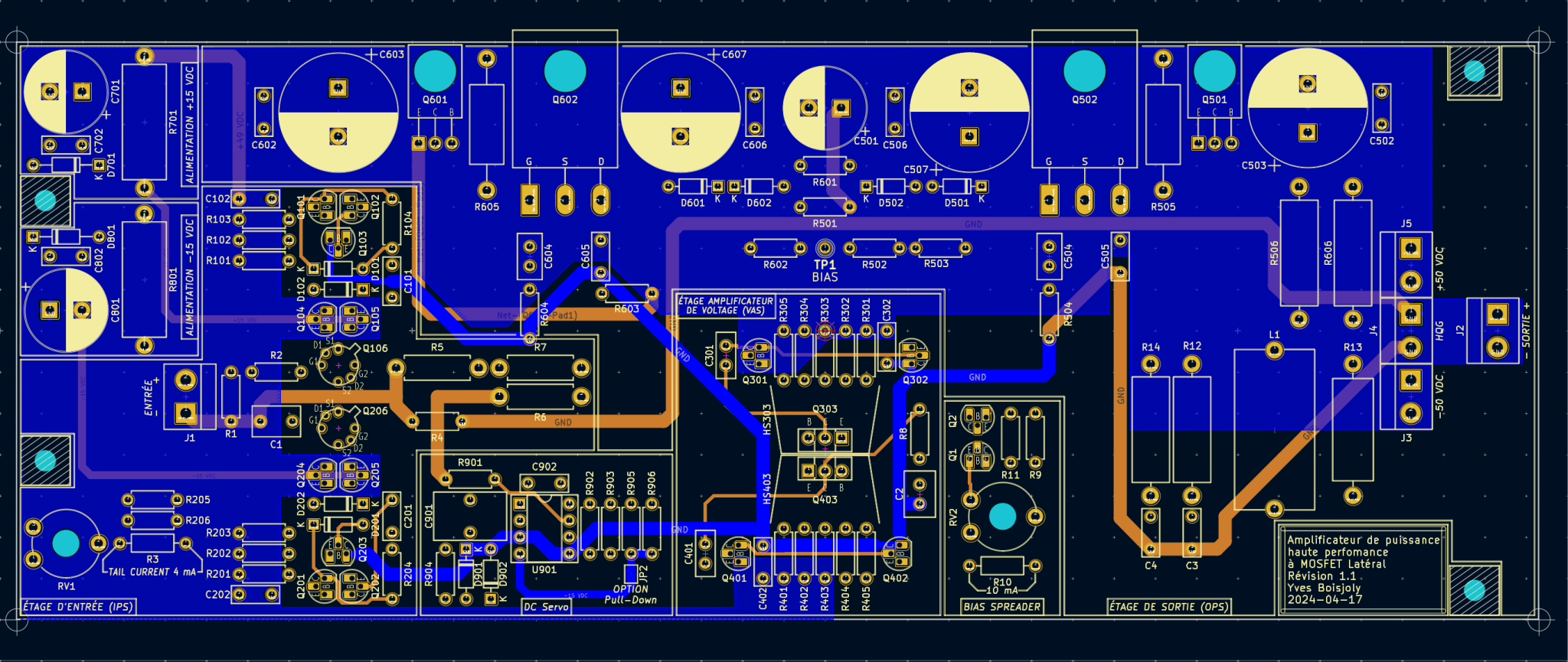

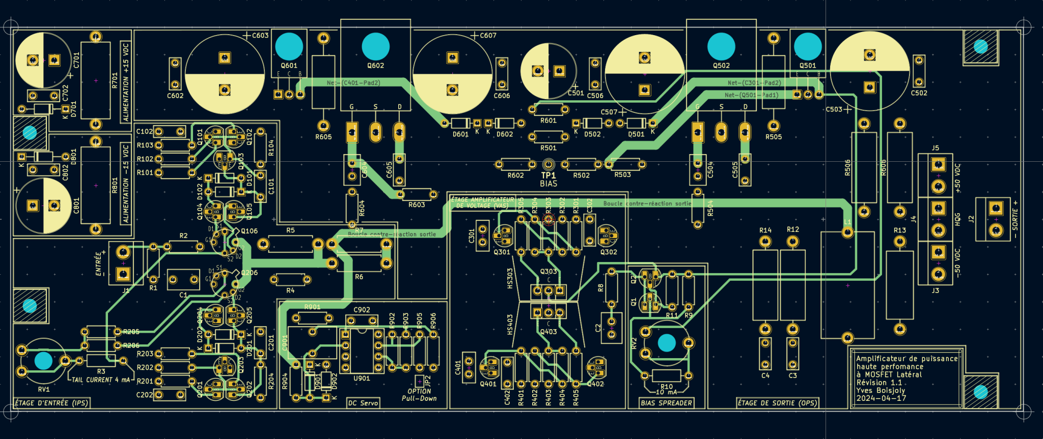

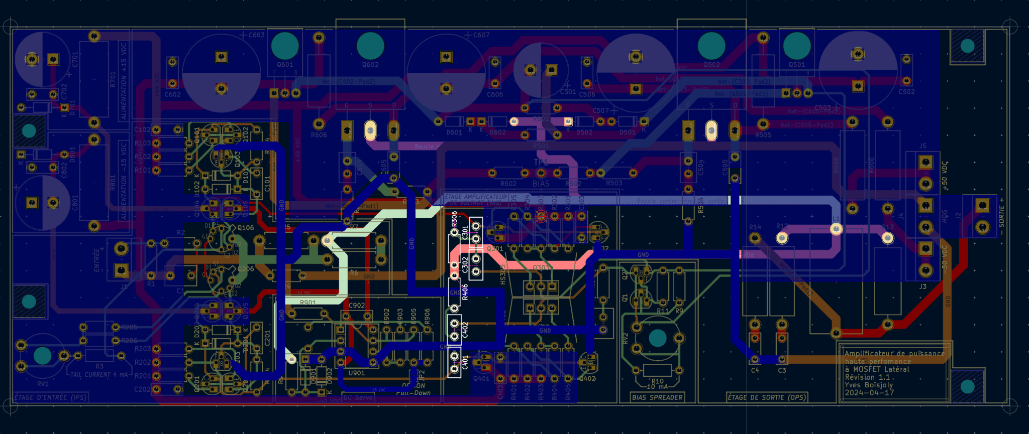

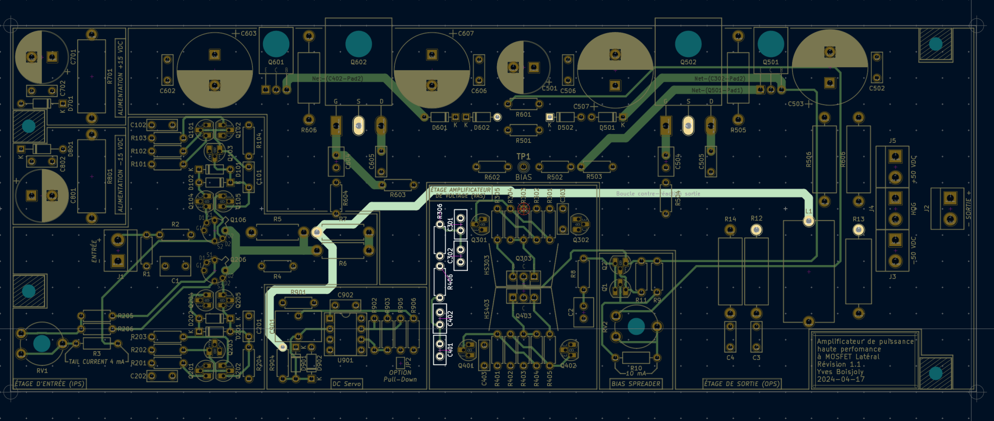

With the goal to include TMC on my circuit, I added two capacitors and two resistors to the board. This make me realized one big mistake I did. The decoupling capacitors C303/C403 were wrongly connected to the audio path ground. I corrected them and stretched the ground surface over them. And I rerouted the ground traces.
New ground traces highlighted.
I also rerouted the NFB traces in order to have two traces of them on different layers; one above the other. I also rerouted the L1 coil to the MOSFET more symmetrical, for the minimum traces resistance possible.

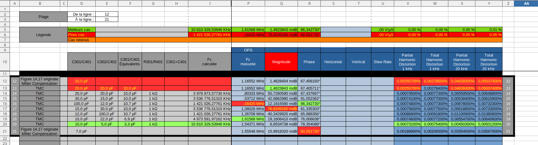

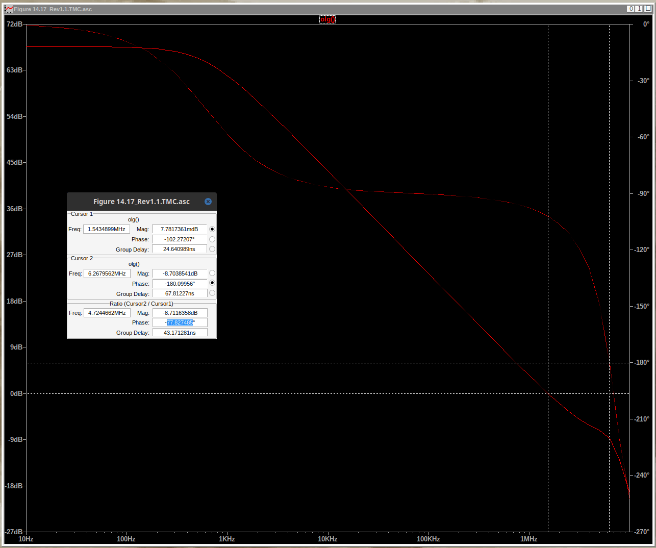

Now, back into LTSpice for simulation to search the best TMC capacitor values, I had the best results when I keep the C301/401 lower than the C302/402. From all the books I have, it is written that the C2 (here C302/402) should be much greater than C1 (here C301/401). In my case, in the goal to keep the 0dB Frequency pole between 1MHz and 2MHz, I MUST keep C1 (C301/401) close to it's original Miller Compensation value of 10pF. Then I obtain better THD at 1kHz and 20kHz if I lowered the C2 value (C302/402). Here is a table showing all the results. The color code formula compare all the values in the same column and report the best (Green) and the Worst (Red) case. I get the best result with C1 (C301/401) at 10pF and C2 (C302/402) at 5pF. The resulting sum would get 3.3pF, much lower than the 10pF original Miller value!

After several simulations in LTSpice and with a first PCB version without electrical errors, I am confident to proceed with the fabrication of this new PCB design. This circuit offers me the possibility of preserving Cdom according to the original design and experimenting with a TMC design by adjusting capacitor and resistor values in practice. However, given the double cost of manufacturing a 4-layer circuit, I obviously want to do my utmost to ensure the success of this design. This is where I appeal to all members experienced in audio PCB design to let me know if you have any doubts about this design. If you believe that certain traces are unsuitable for an audio amplifier, I'm always open to your suggestions and/or advice.
In drawing up my parts list, I had to replace the diameters of the C501, 701 and 801 capacitors with smaller ones, as the previous capacitors were no longer available from Mouser. I'm attaching a final capture of all the layers for reference, but the traces have been modified only very slightly to adopt the new pin spacing.

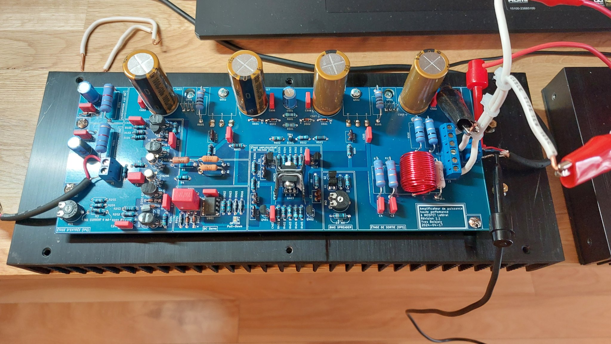

I received my PCBs. I build-ed one and must say I am very happy for now.
I did preliminary tests with success. I started with +/-5 VDC Power Supply, raising it until +/-30 VDC and tested with a sinusoïdal wave reaching 100 kHz. Another test with a square wave at 50 kHz. After these, I listened music from my Focusrite 2i2 in mono, with the amplifier connected to two B&W V201 in series, for a total of 8 Ohms, for about 1 hour. The sound is very impressive. I also short-circuited the input to listen the noise with my headphones. At first I though that something was disconnected, hearing nothing. No, removing the short at the input, I could hear some noise when my finger came close to the hot wire. So with a short at the input, I cannot hear anything, It is as if noting was powered.
Then I finished to build my Jig to test the output as proposed by Bonsai:

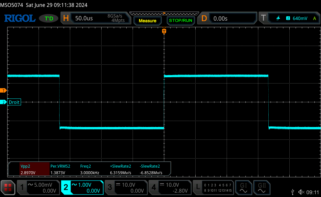

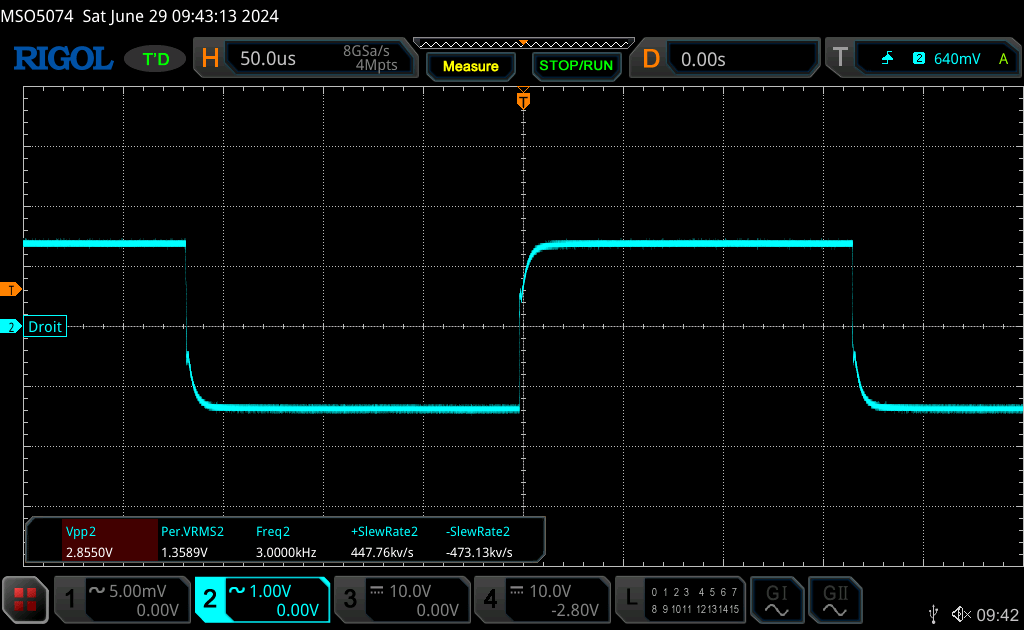

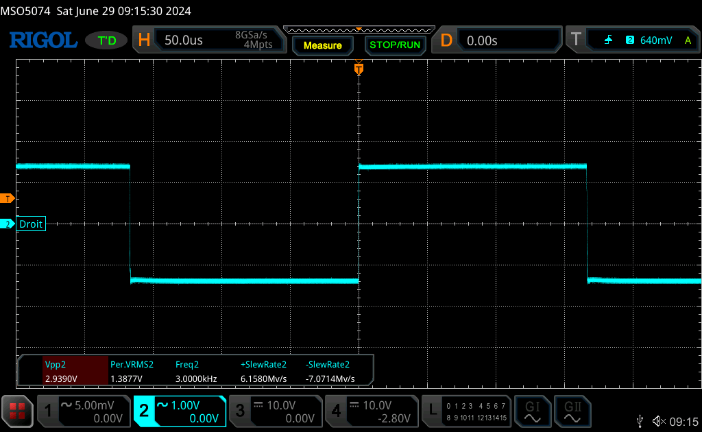

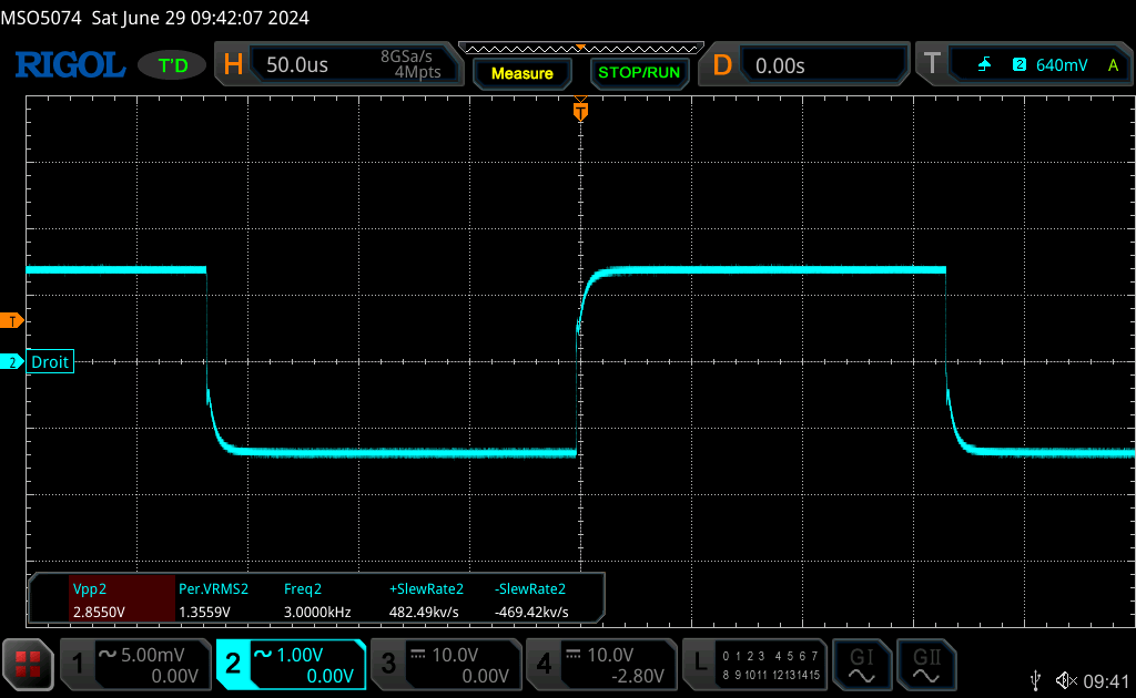

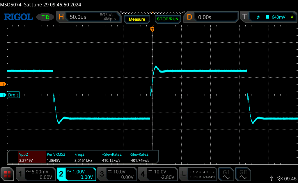

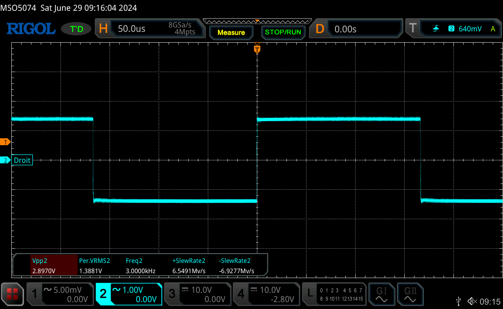

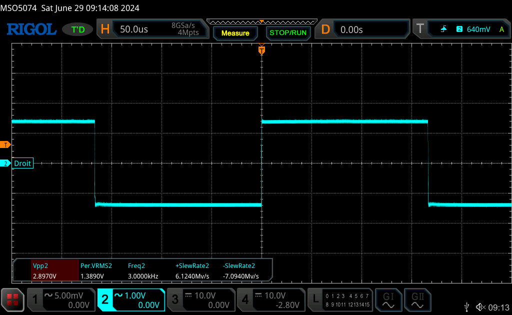

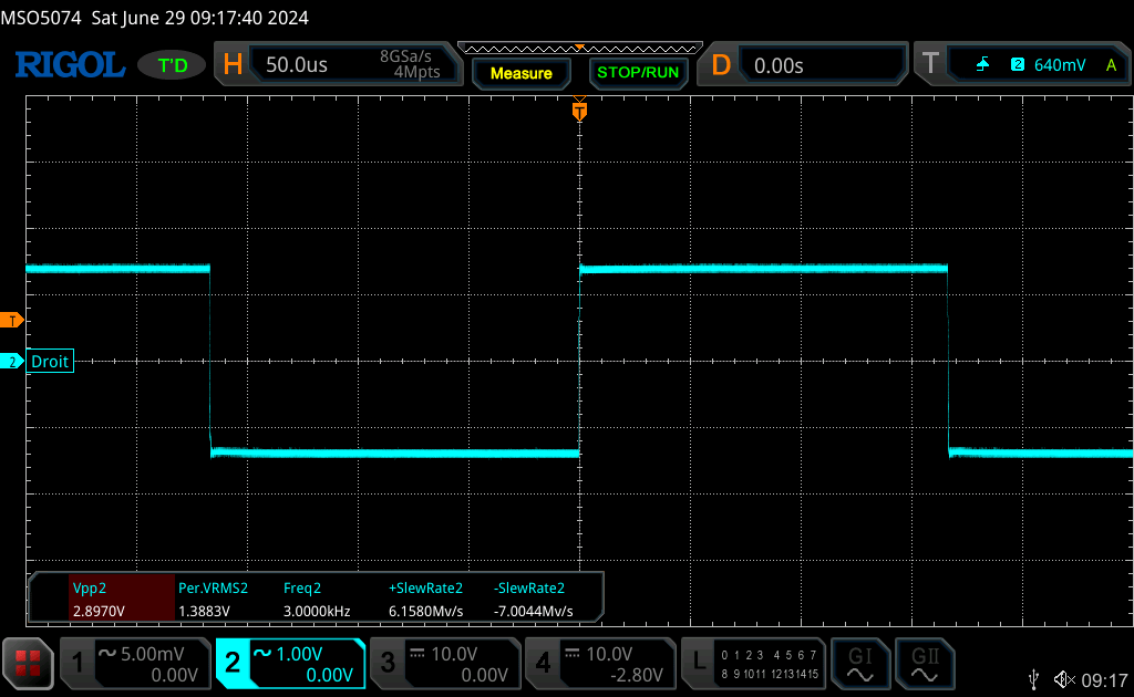

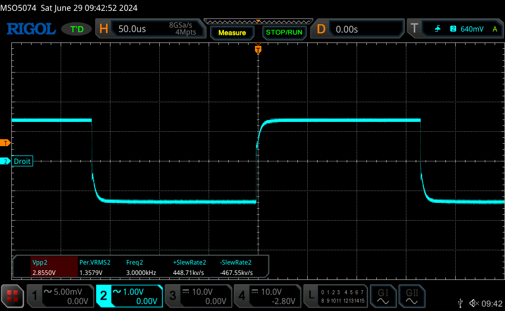

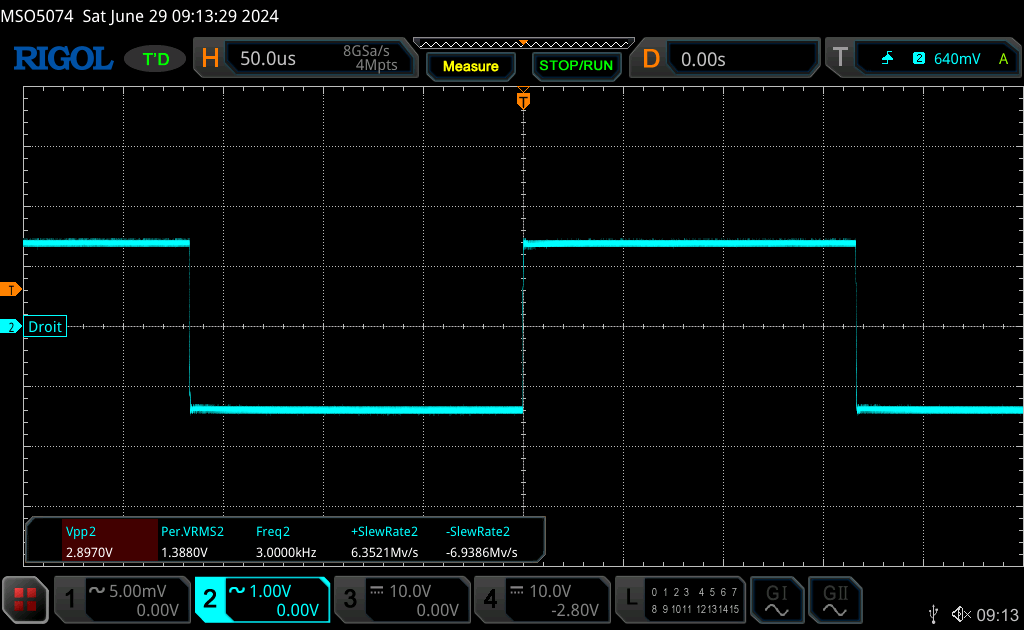

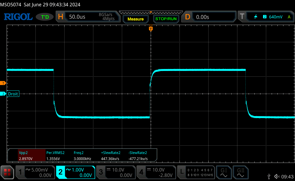

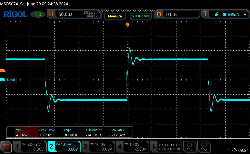

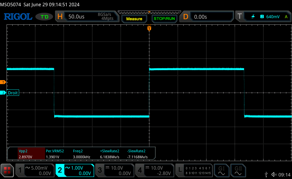

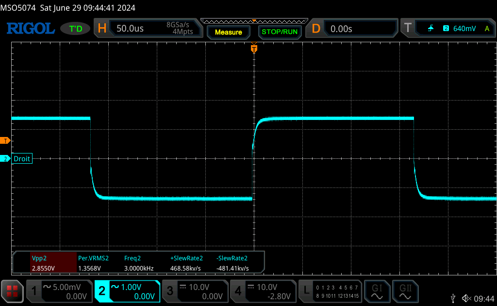

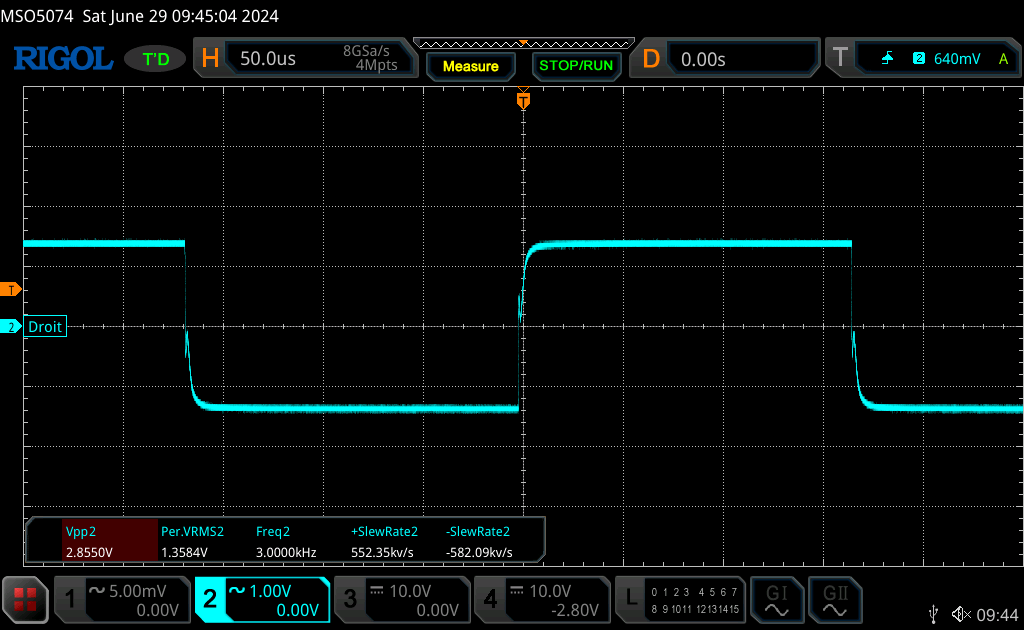

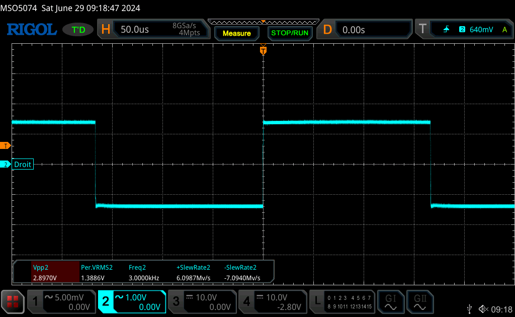

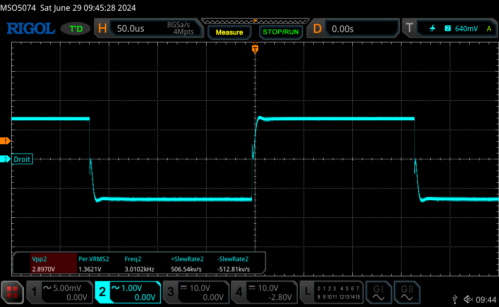

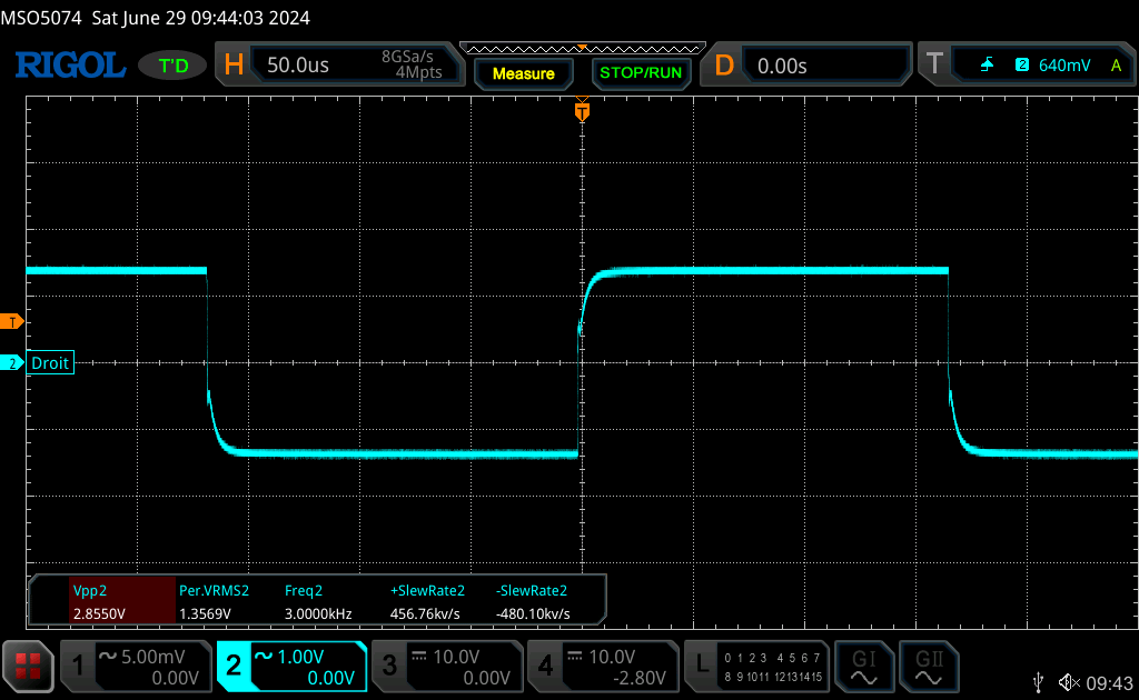

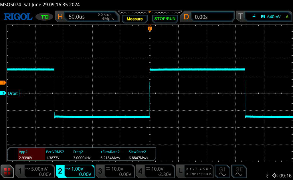

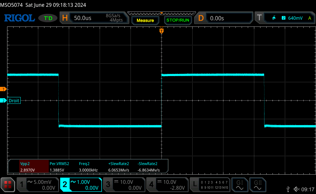

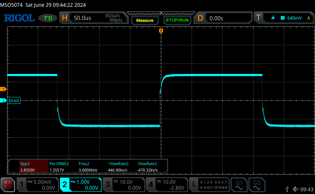

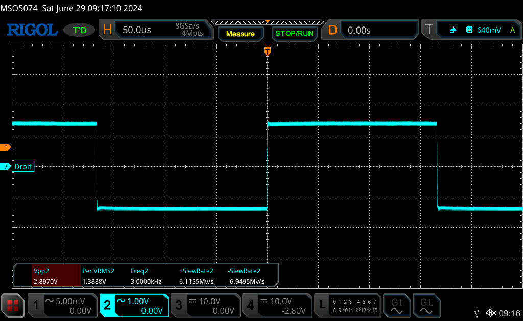

I did all tests with about 3 Vp-p and 3 kHz square wave. I did all combinations possibles. That is a total of 66 captures so I will not post them entirelly. But comparing them, the worse case is with a 100 Ohms in parallel with 1 uF capacitor, here :
And here are the captures of no resistor present with all capacitor values:
No capacitor connected:
100pF:
470pF:
1nF:
4.7nF:
10nF:
47nF:
100nF:
470nF:
1uF:
2.2uF:
And maybe I can share the theorical worse case, 2 Ohms in parallel with capacitors. Although, as mentioned above, the worse case as been with 100 Ohms and 1 uF:

I'm just wondering if the glitch isn't the Mosfet gate capacitance in response to fast rise/fall times. Have you got one of those plots that show Vgs vs Cg for the devices you are using? With slower rise/fall times (you will never get anything faster than 10's of us with a digital source anyway) the problem goes away. What are the rise/fall times you are using?
Am I reading this correctly? The other issue you may have here rather than MOSFET gate charge glitches is the amp is slew limiting and operating open loop as it slews, then the loop recovers and you get the glitch (overshoot) you see.
You should be limiting the amplifier bandwidth with the front-end filter set to between 200 and 300 kHz.
The front-end cut-off filter here is 3.29 MHz - about 10x too high.
The loop flight time in a compensated amp is in the low us (note: this is NOT the same as the speed of the electrical signal around the amp which happens relativistic speeds), i.e. the difference in time at the diff pair between the peak input signal and the peak feedback signal. If you feed a very fast rise/fall time signal into the amp, the front end will run open loop and slew because the loop cannot follow the input signal slew rate. This is usually mitigated using two techniques: degeneration of the diff pair to open up the linear operating range to about 1V and secondly by bandwidth limiting the amplifier with a front-end filter. In amps with insufficient diff pair degeneration, the linear operating region is very narrow and it is easy to flip the diff pair on or off. This was a major problem in early slid state amps where designers tried to raise the loop gain as high as possible to get low distortion and one of the ways was not to degenerate the diff amp. This led to slew rate problems and TIM.
Reactions: chermann and stv
