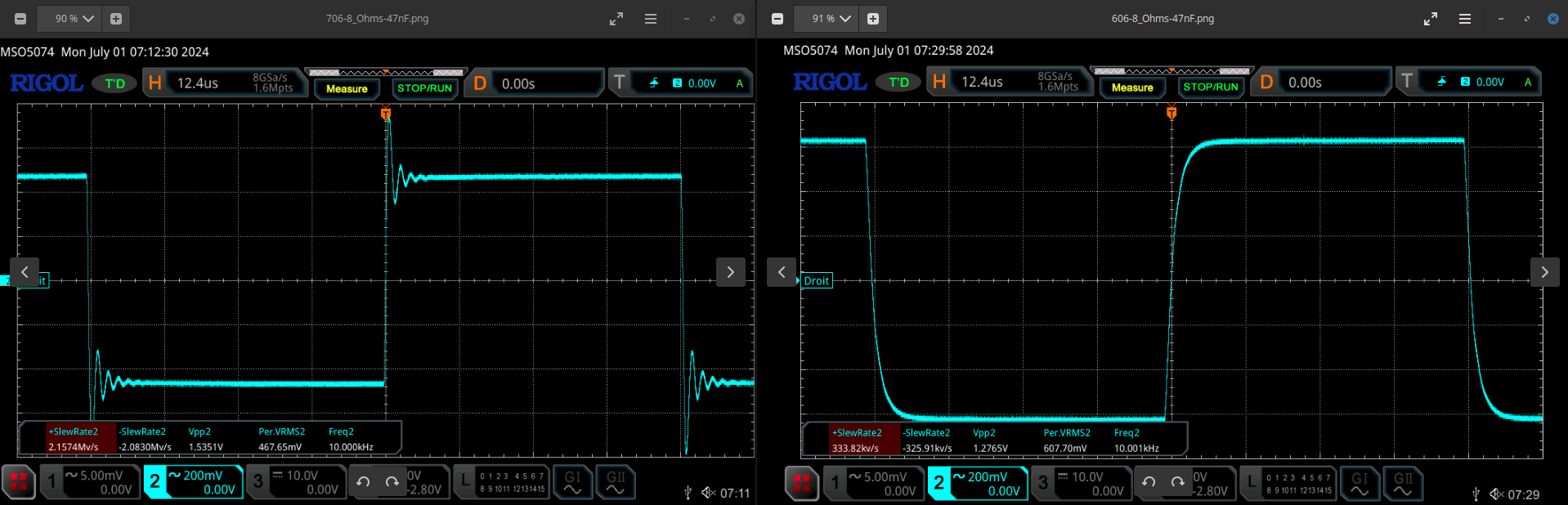

I have to say that all parts are totally new, except for three of them. The capacitor C901, 1uF/63 VDC of the DC Servo section, wasn't available at Mouser so I removed the one from the previous board, the board that has it's resistor smoking in the preceding test at 4 Ohms impedance. Also, with the very high price of the MOSFETs, I reused the two MOSFETs from the same board. I don't have new MOSFETs anymore. They all have been used at least once. Does this glitch could be a result of a bad MOSFETs that would have suffer from the test when the resistor make smoke? Maybe... As for the glitch, I already have started to build the second board. I will continue it and use it for more tests. Again I will have to reuse the two MOSFETs of the second preceding board but these didn't suffer from nothing yet.

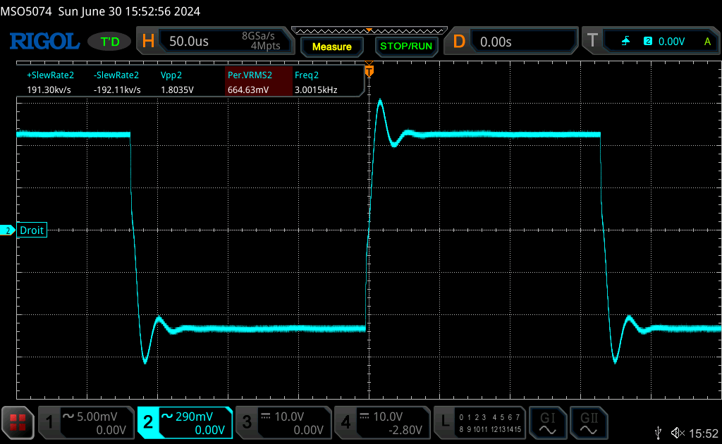

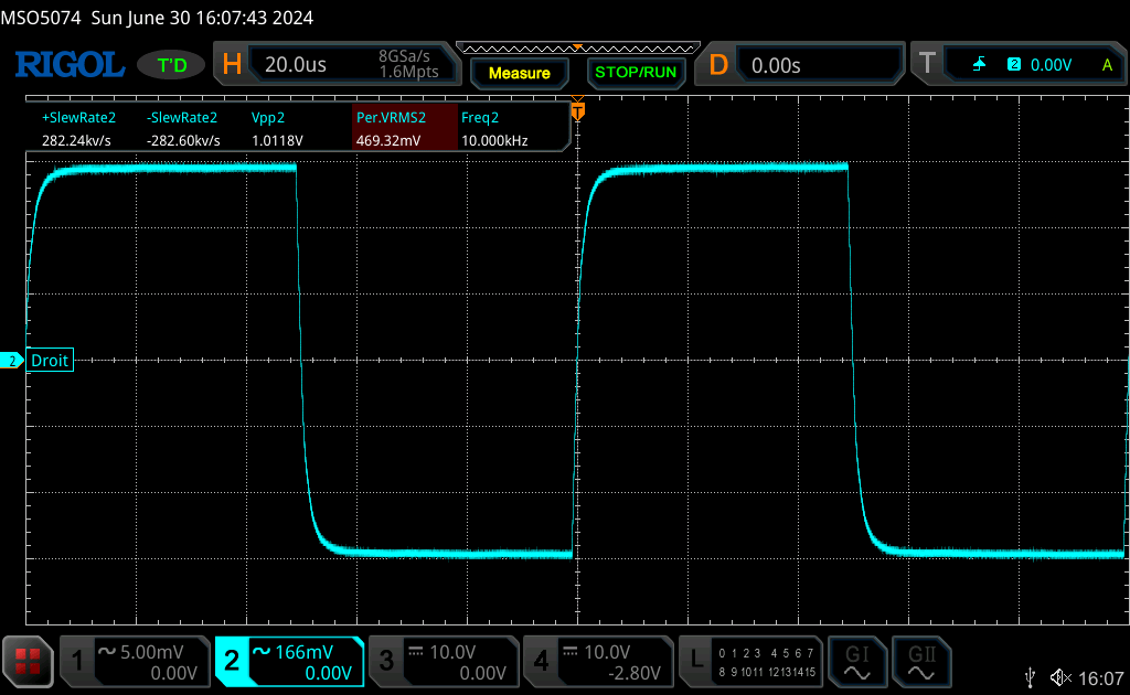

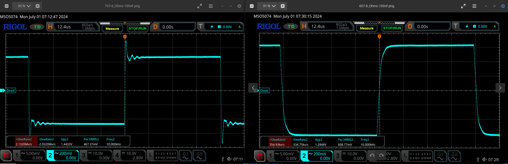

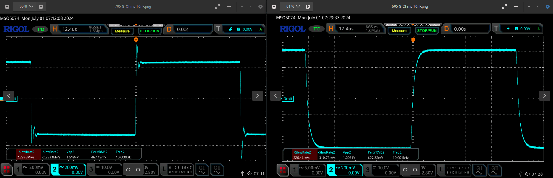

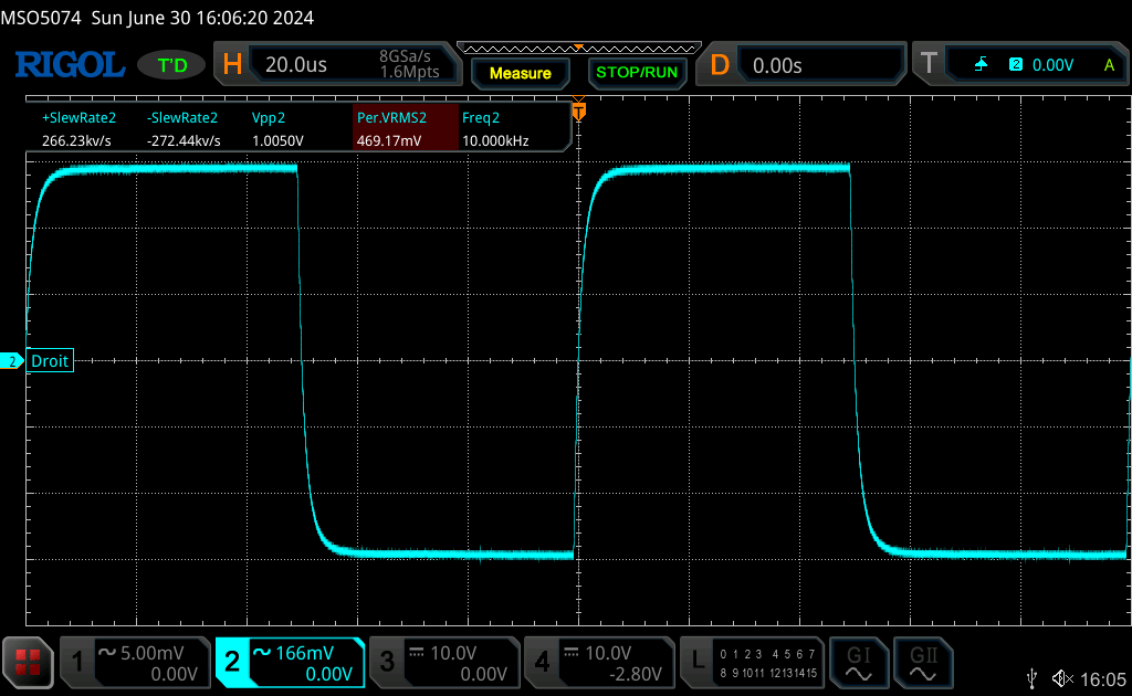

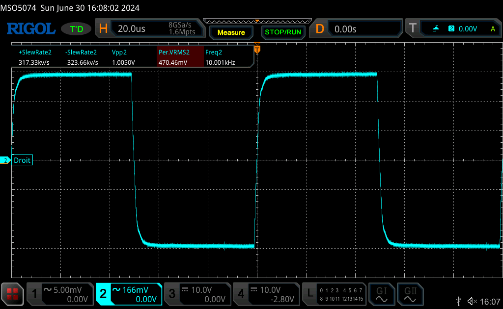

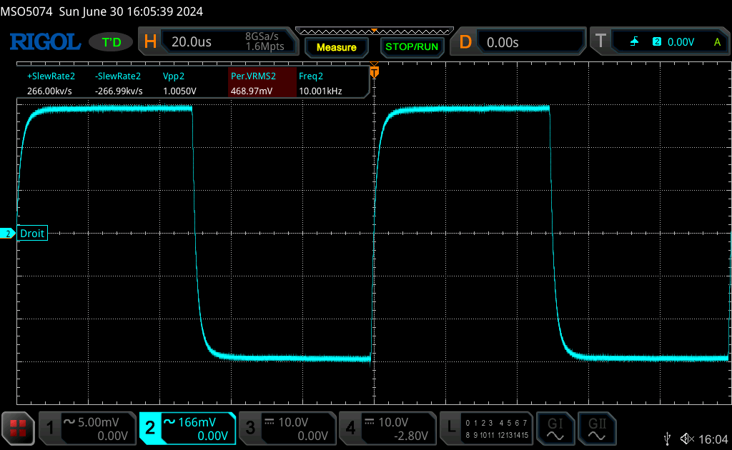

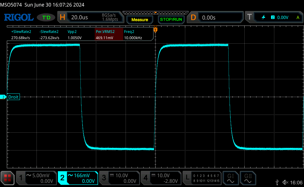

So if I wanted to keep the 220 Ohms low resistor at the input, what about 3,3 nF for C1 ? I already have ten new TDK 0,0033uF in stock, that would result to a 219,222 kHz cut off frequency.

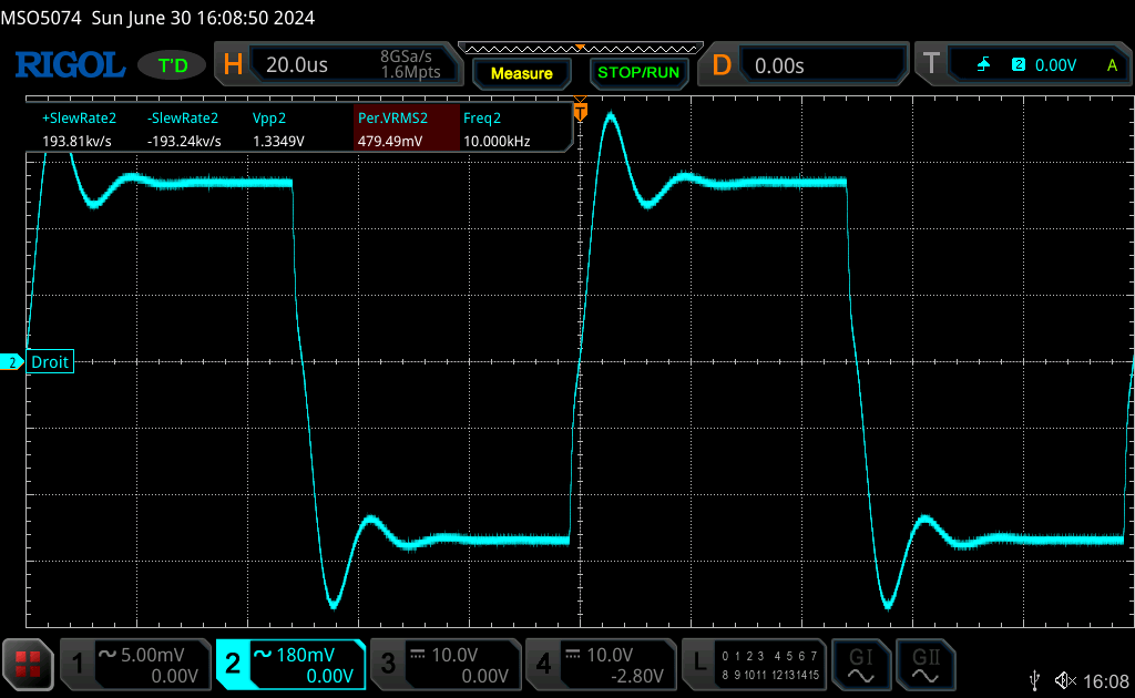

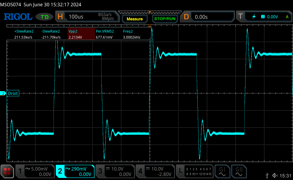

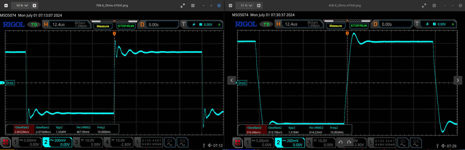

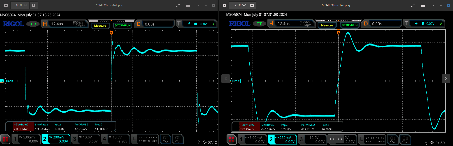

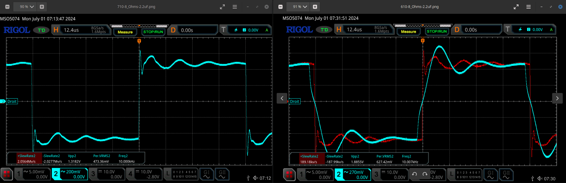

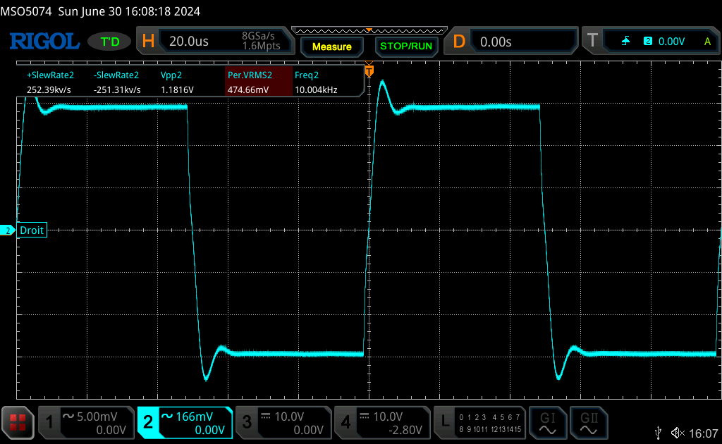

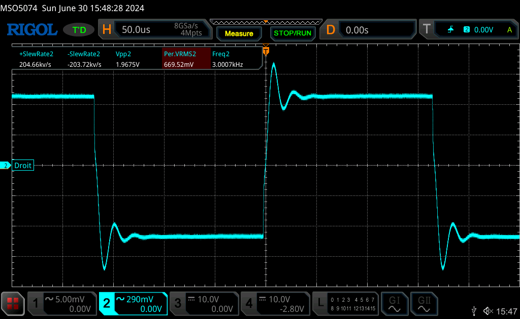

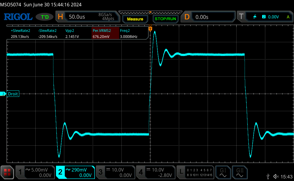

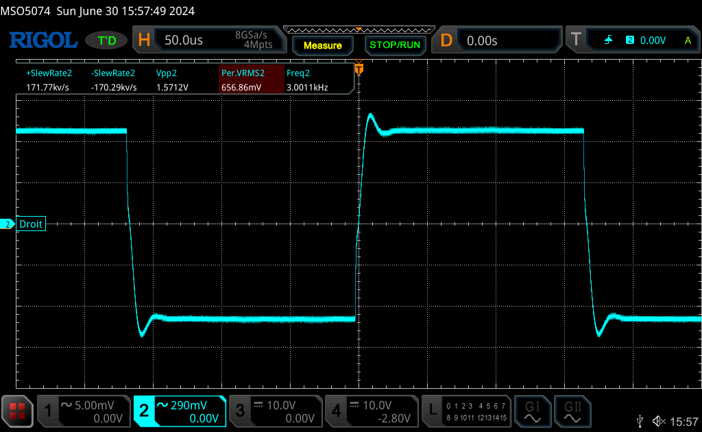

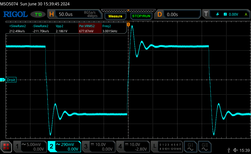

i dont like the glitch on the rising/falling edges
It looks stable, but like ctrlx, I am concerned about the glitch
I'm just wondering if the glitch isn't the Mosfet gate capacitance in response to fast rise/fall times.

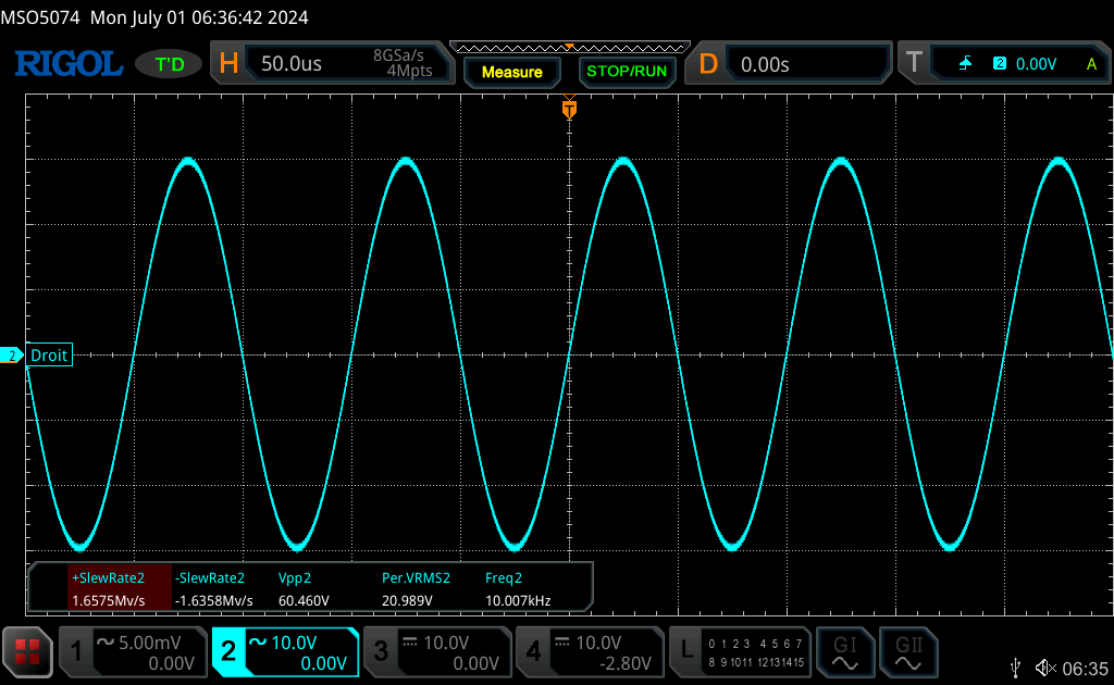

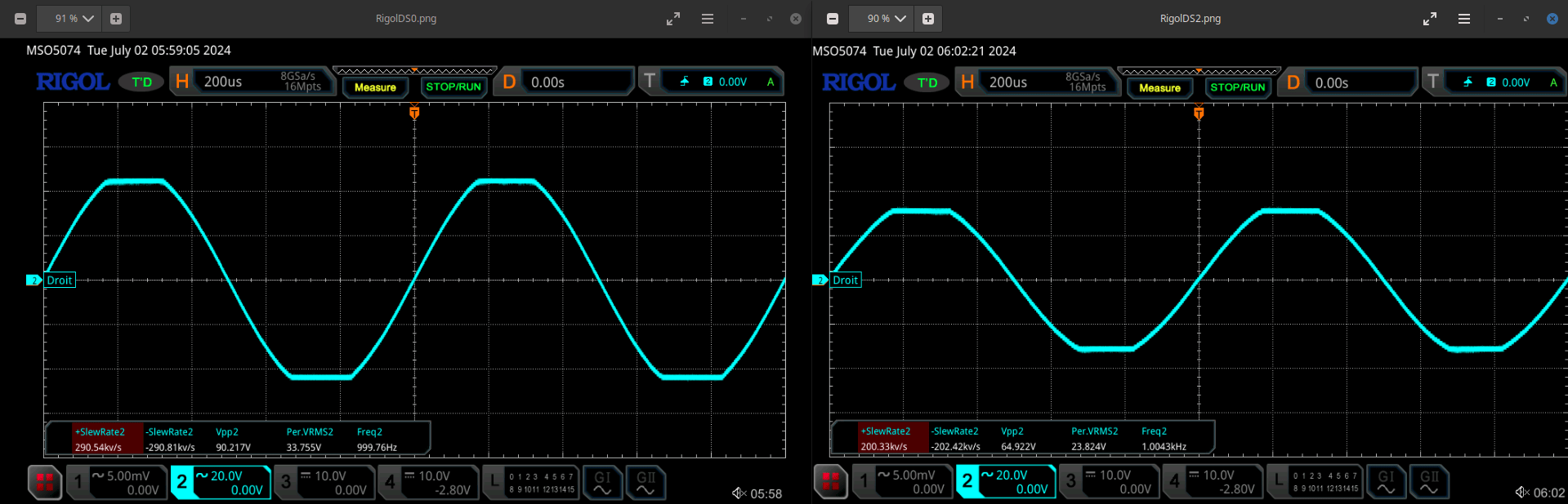

I already have put the board into the box with quiet results! I cannot ear any hum, just a tiny white noise, hard to hear even in a quiet room with my ear glued to the speaker. And as for the music, I am impressed already! The Amplifier is connected to two used B&W V201 speakers, 4 Ohms, that I bought just for testing this amplifier.When you box it up, you will have another set of challenges to keep it quiet, but this will be achievable I think with no problems.
So I guess all the designs from the books we read need revisions! My first amplifier was a disaster cause the design proposed in the book wasn't working at all from the beginning. And this one has a wrong filter setting...You should be limiting the amplifier bandwidth with the front-end filter set to between 200 and 300 kHz.
The front-end cut-off filter here is 3.29 MHz - about 10x too high.
