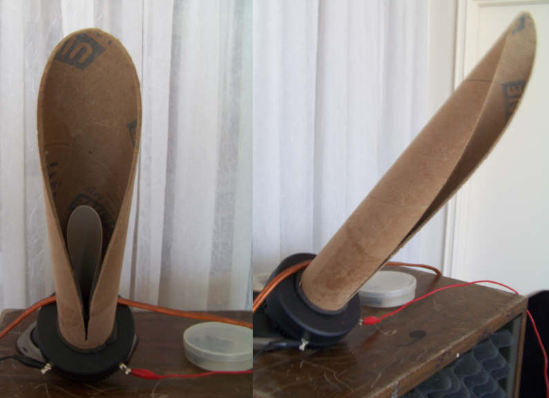

I've been messin' w/ some cheap GRS PZ1188, just trying to find a little time, and get a few things set up to listen to. Don't have anything set up to measure w/, so largely a waste of time, but putting the large 2"I.D. cardboard K-tube over the 1"I.D. fiberglass K-tube softened the response, nearly sounds promising. I used about 1.5" of acoustic foam at the base of the K-tubes to hold and center the big tube over the little one.

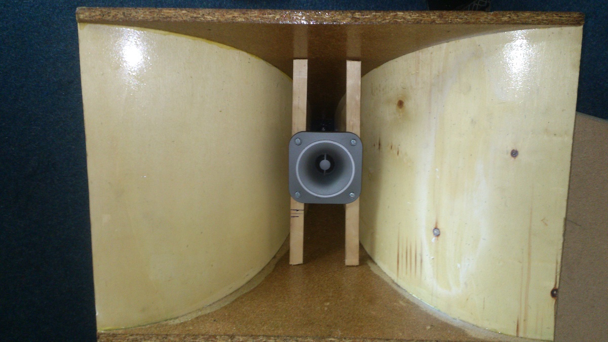

Somebody on trynergy threat did advise me to use a K-Pipe tweeter like this for injecting hf from 2 a 4 khz into the horn throat close to the 2 inch wideband driver.
For this I need a small pipe, on a 1 inch tweeter, I do not now what happens but maybe it is interesting.
I need to bend the pipe slightly.
Now I did put a tweeter in mouth for testing. I do like the pipe approach.
