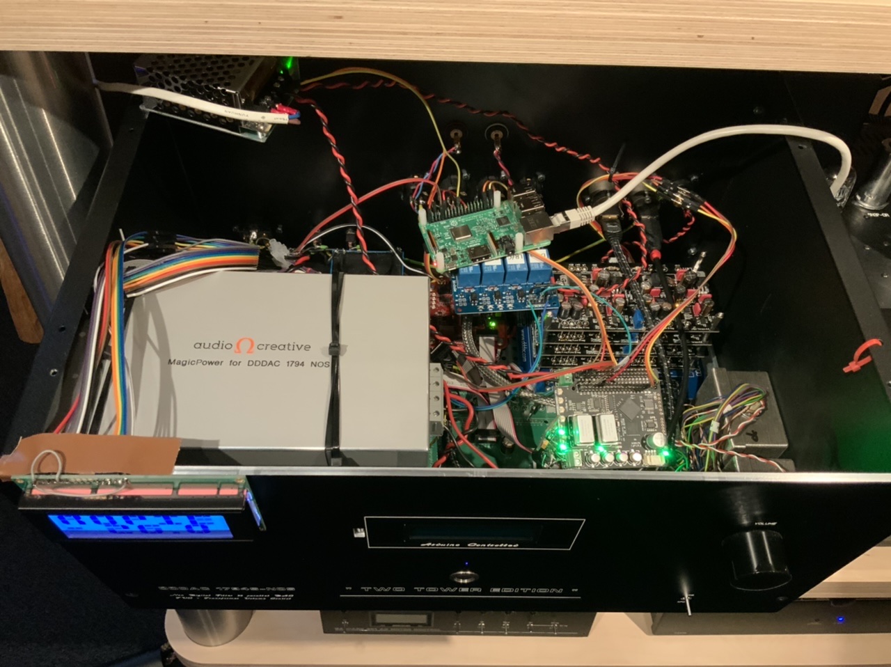

Finally I had some time to do the almost final tests with the Fifopi and the accusilicon clocks.
Remember, in earlier tests I reported back, that the PI3 with the fifopi AND the accu clocks made a clear difference for the positive. Very nice analog natural sound. Compared to this the WaveIO connected directly to the DDDAC sounded less spatial, less natural. Still great, but hey, easy to hear and you do not want to go back from the fifopi...
I could run WaveIO from the Aurender as well from the USB output on the raspberry.... compared between the two, the Aurender clearly is the better streamer. But it could not match with the raspberry with the fifopi and accu clocks...

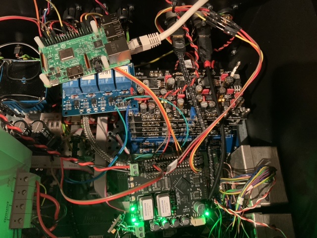

So what I did today, was make a new Frankenstein set up (see images :D ) where the fifopi was disconnected from the PI and connected directly to the DDDAC I2S input. Power supply as earlier. 3,3 Volt LDO to the clean clock section. Raw and before isolation side fed from a nothing special 5volt supply which also feeds the raspberry side of things
The INPUT of the fifopi is connected to the output of a selector board (see pics ... with the 4 blue relays) - the two inputs from the selectorboard are the raw I2S from the raspberry pi and from the WaveIO . The selector board is controlled by the Arduino in my DDDAC, so both can run in parallel from the same track and with the remote control I can switch back and forward between the two sources and do a 100% A to B comparison. No issues with getting up, selecting another source and start the track again from start and try to remember before and after...
Well this was VERY necessary, as the result was extremely simple: I could NOT hear any difference between sources, regardless of the WaveIO was fed by the Aurender or the PI or if I2S was coming from the dirty PI I2S output.... I kept switching back and forward and simply could not notice ANY difference. It might be my old ears are not so good anymore, but hey, the other difference in the previous setup was easy to hear. So IF there is a difference, that is up for people with better ears than mine, which is absolutely possible of course :D
But for now, my only conclusion can be, whatever you throw at the FIFOPI, it comes out at the same high quality, IF you use the super clocks....
This makes things VERY easy... everyone who wants a nice upgrade for his DDDAC, just put a Fifopi with the Accusilicon clocks at the DDDAC input and feed it with whatever I2S you have at hand....

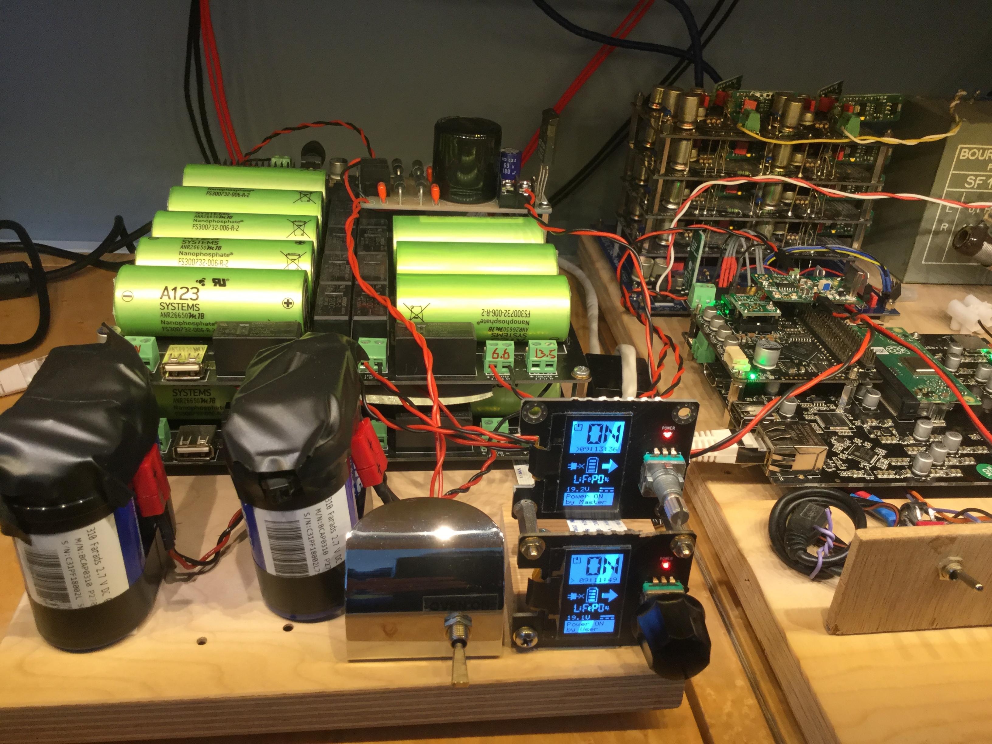

Using the fifopi with a clean battery power of 3.3v will improve the sound even more; with 3.3v you can bypass the on board ldo’s, all ldo’s make some degree of noise and this is audible through the fifopi.
I have changed the rpi for an Allo USBridge Sig. This is also an improvement.
Nice to read that the Aurender is on par with the rpi in this configuration. That means my USBridge sig solution is even better than the Aurender :D

4. Use great power supplies like the battery supply
....if you can do all that then the source can sound better than a commercial streamer.
