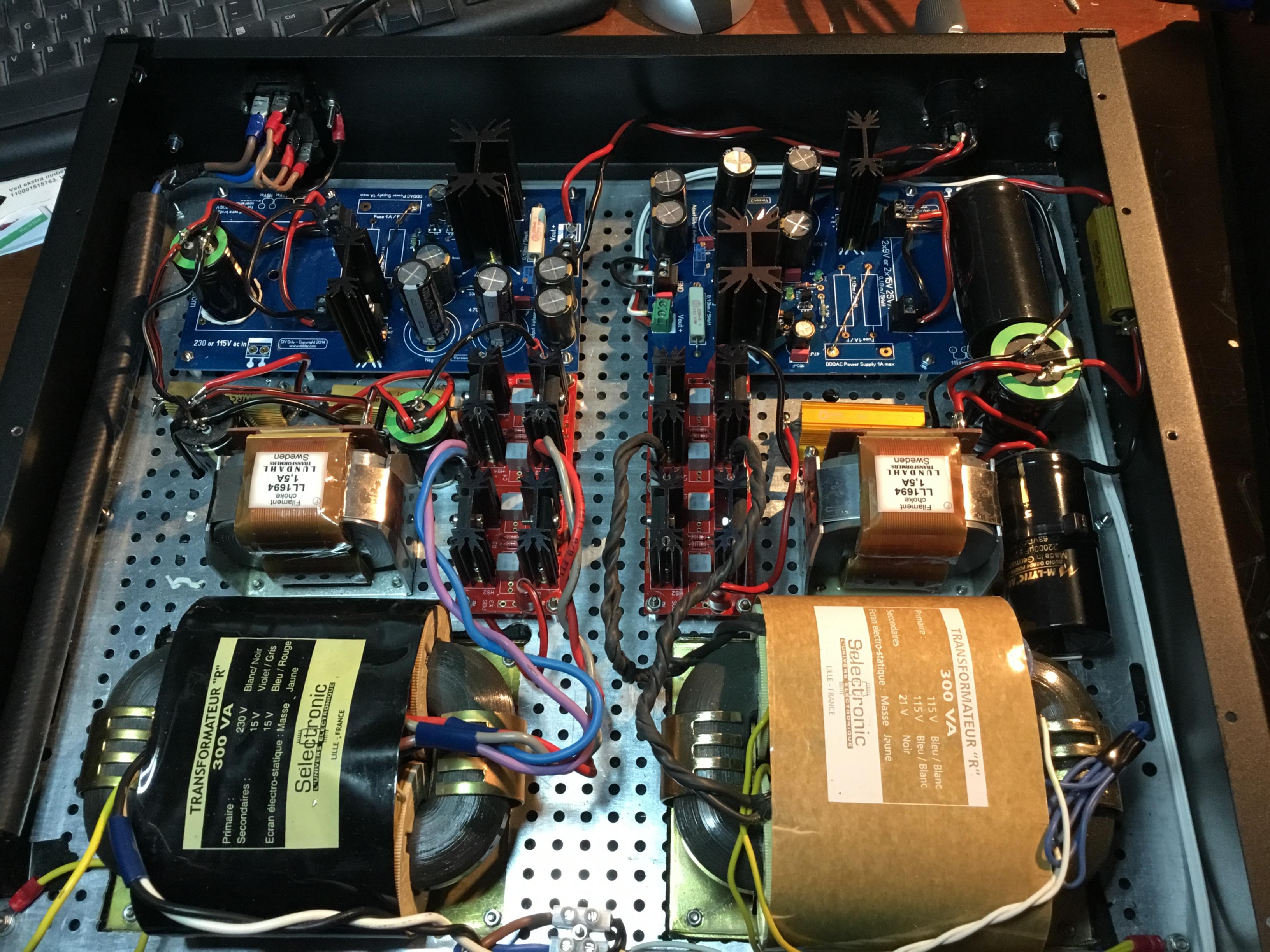

so after the build of my new PSU and the exchange of the chip i fried, I did some more testing and the sound certainly improved. I couldn't really test with and without the 74vhct244 chip as my Kali stopped working too which I didn't check first so i build everything back to standard for error checking.
With the new PSU the DDDAC has certainly gained quality. It differs from the >10k € DAC, which we used as reference while testing, more in character than in sound quality i'd guess. But I hope I can get the DDDAC to better it with better clocks in the future, as I used Ian's Fifopi with the standard clocks.
PS:
Thanks again to Doede for sending me the new chips
And thanks to smooth dancer for helping me on the PSU design
PSU:

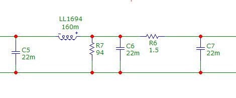

Do you have a PSU diagram?

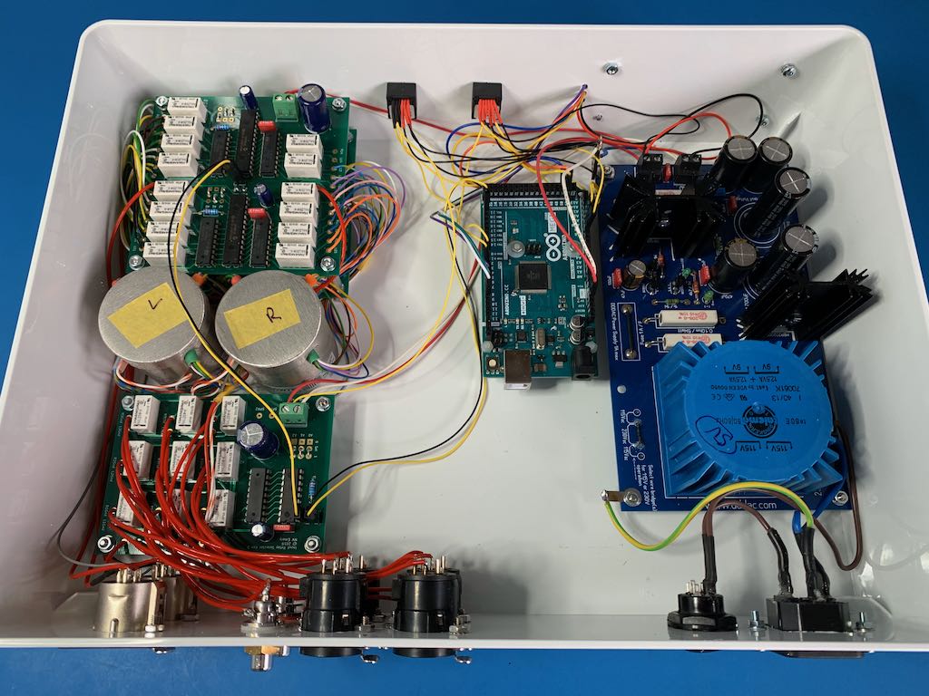

Hey Guys.
One quick transformer question... I still haven't purchased any DDDac upgrades yet like more Dac-boards or a pair of transformers.
Now I have come across a pair of Sowter 9335 for a good price and close to me. They seems to be very well liked but as I read they are for TVC usage. TVC's sounds interesting but I would need to do quite some research before being able to create an remote controlled TVC. For now I really just want to replace my Mundorf EVO Oil Caps with some simple transformers with single-ended output. I am also reasonably happy with my Tube Preamp for now.
The question is... Can the 9335 be wired as "simple" output transformers for now and would it make any sense to do so? ... or should I just go for some Cinemags or the new Audio Creative O.P.T's?
Any opinions would be welcome :)
/Martin
In the end i used a 300VA 24V toroidal into my fullwave rectifier bridge then the filter as in the attached image, after that follows Doedes PSU board without transformer and rectifier (like shown in post #7389) and i end up with around 13V with load.
PS: I used Sven Sjorstroms rectifier bridge like smooth dancer. Just to have less cable mess and more PCB niceness, they are neat little boards :)
Greetings Oli

I thought you already did ;-) you are still using them, right?
Yes, I am using them for both my DDDACs.
One is in an external enclosure with a manual Shallco switch (as described on the Sowter website), works just easy-peasy.
The other has an Arduino-controlled relay board for volume control, which is built into the DDDAC chassis. It has a small issue with noise pickup that I couldn't figure out yet (and I am not even sure it's the Arduino relay board).
Oh, and just for those who didn't read the whole thread... Some time long ago, Doede hooked up my Sowter 9335 trannies to his DDDAC and tested the setup with his Audio Precision test system. All good and clean!

I am right your photo shows the power transformers, filter chokes (and caps), and (part) of the Doedes PSU boards. Which sequence are these hooked up?
Power transformer --> Doede PSU --> Chokes+Caps
Power transformer --> Chokes+Caps --> Doede PSU
Greetings Oli
Thanks and I am using the Sven Sjorstroms rectifier bridgeand its nice :)
So the capacitor values are not clear, is it 22,000uf ? What voltage?

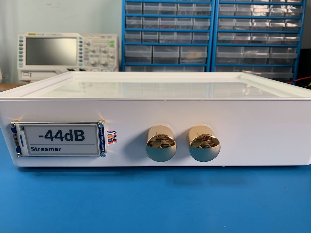

I'm also using the Sowter 9335 TVCs but with a single board DDDAC. I have the 9335 set up as a separate passive preamp and run the output of the DDDAC into one of its inputs. It works very well with the DDDAC.
The passive pre-amp is set up with latching relays that are switched using an Arduino. This means that power is only require to the pre-amp while changing the volume or input source. I added a e-ink display so that I can tell the volume at glance even when everything is power off.
