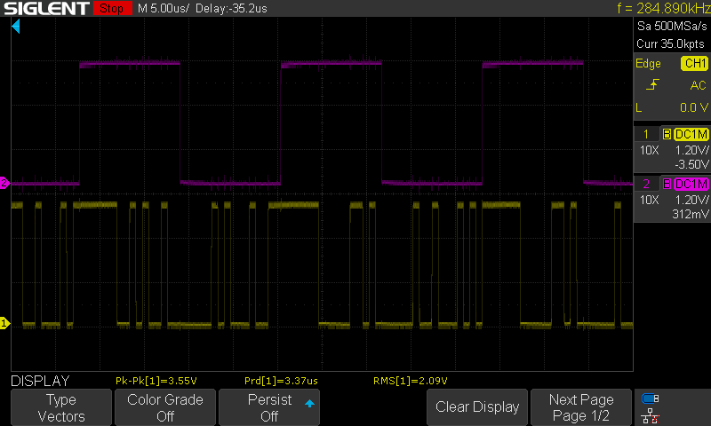

Looking good btw. seems like I get "right justified" fresh out the pi 🙂

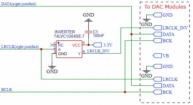

As I said, almost directly. I think something like this could work:
attachment.php
I'm about to make a PCB for a right justified input mainboard. I will post it before I order though.
And yeah the logic circuitry is tricky, perhaps someone can fill me in on my (hopefully) last piece of the puzzle there:
Why is it that the half clock cycle delay caused by the shift registers is fixed by another shift of a half clock cycle on the same signal (data) rather then shifting the other two back (lrclk, bclk) to get them in sync again Oo
At the moment it looks like the data schould be a whole cycle late when it reaches the DAC modules. I mean it's great that it works but I don't know why and it makes me a bit ( ;D ) unsure in my inverter concept :/
