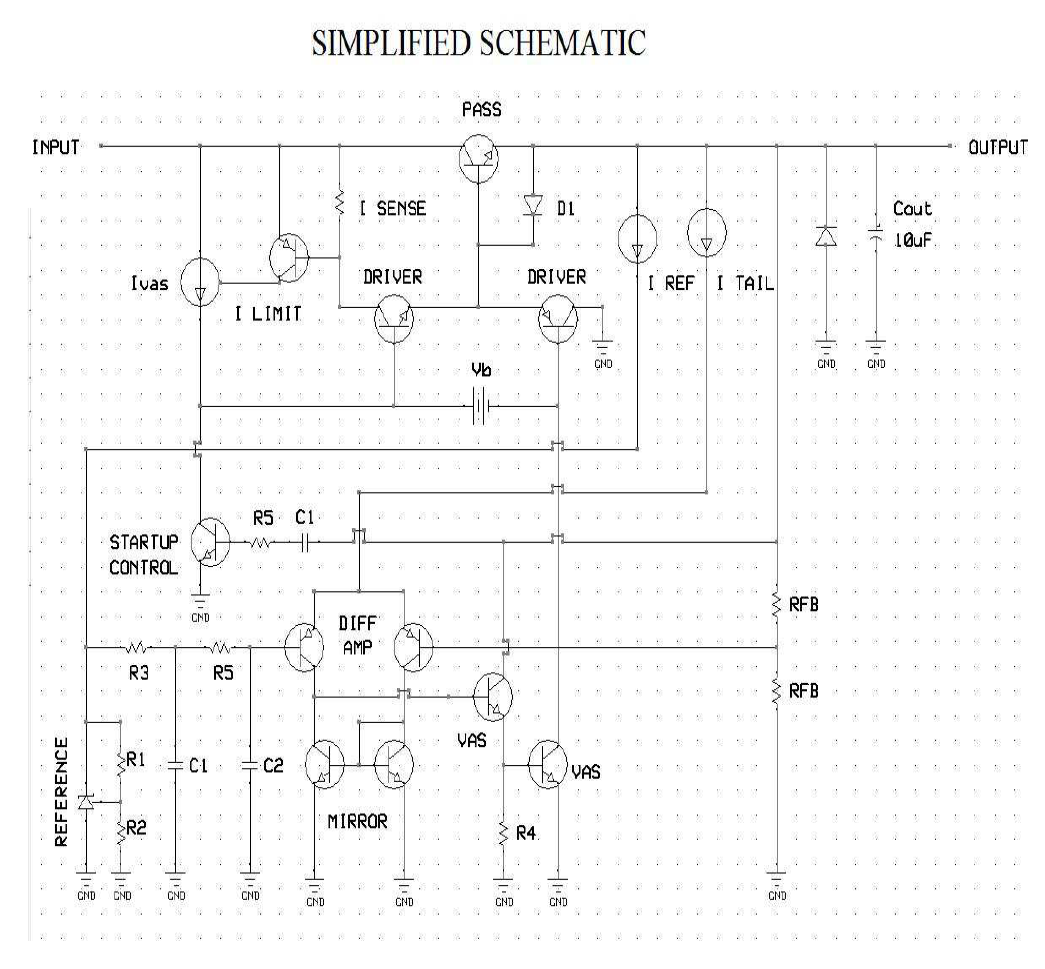

Just to get this straight, what is the function of the LF50 and why could it make a difference?
If you check my circuits, which are published on my website, you can see it in more detail, but basically there are two functions. First, to optionally power the WaveIO isolator (I am not using this anymore btw) and secondly to power the logic and SPDIF section on the Mainboard. I know there are thoughts on “all the logic on the board introducing extra Jitter”. Well it is less influential as you might think. Reason for this is, that the majority of the logic is SPDIF and to reshuffle the data and the R/L clock and not for the bit clock (BCK). This signal sees a very nice path to the dac chip by only moving it through the 74VHCT244 which is a level shifter from 3,3V to 5V logic and a buffer function (which I found out that for parallel use of the PCM1794 this is advantageous) The 244 chip is powered by the LF50 on the mainboard as well. So this position might be influenced by the solidity of the voltage supply. The rest (SPDIF, LR and Data) are not so critical, as with LR and Data, it is just filling the shift registers of the PCM1794A and the final D/A conversion actually takes place on the change of the BCK clock edge. This is the most jitter dependent point in time… I checked this with an engineer from TI by the way, as the datasheet is not very clear on this and some people thought or claimed it is the SCK or L/R signal doing this.

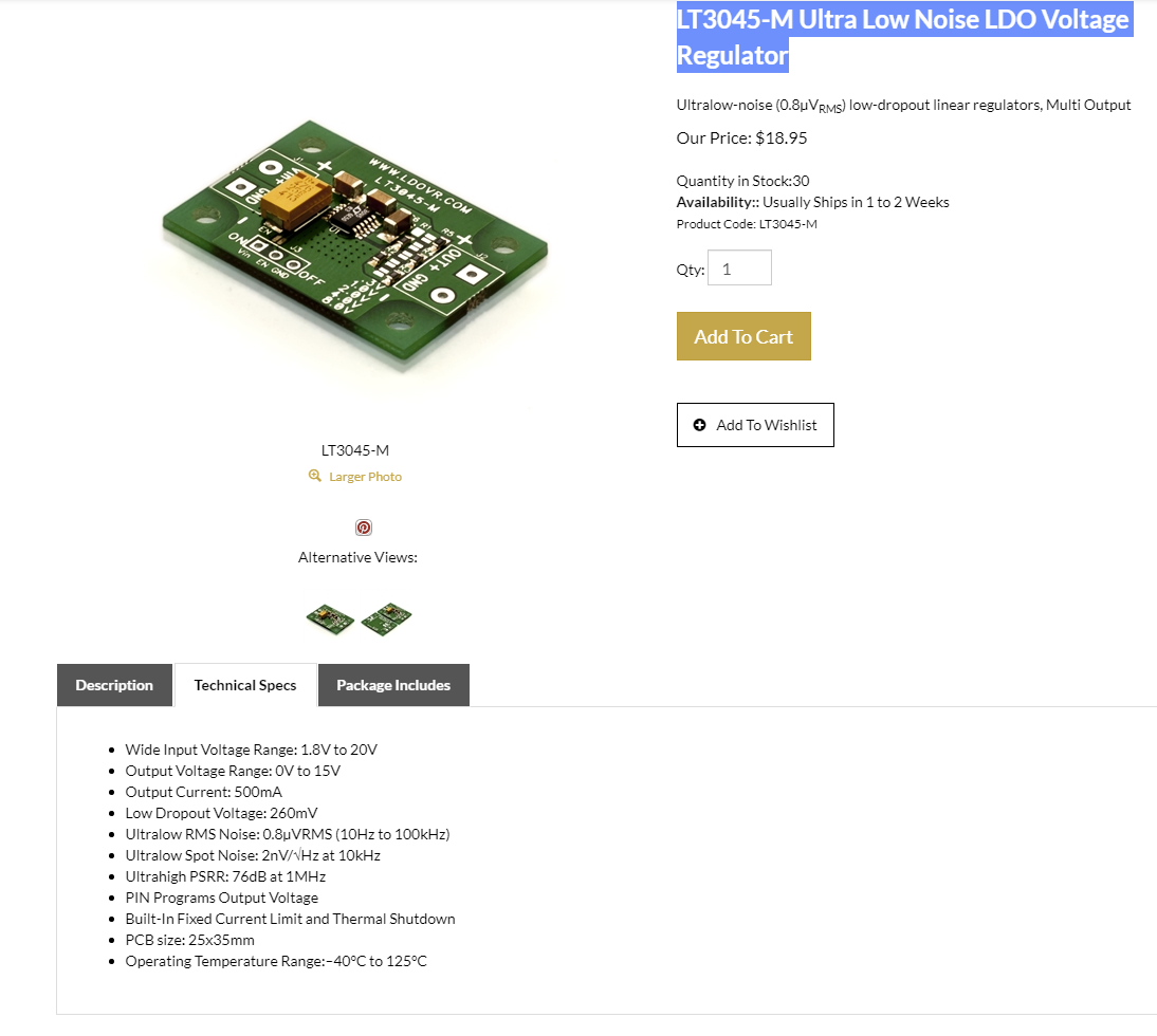

LDOVR LT3045-M 78xx replacement

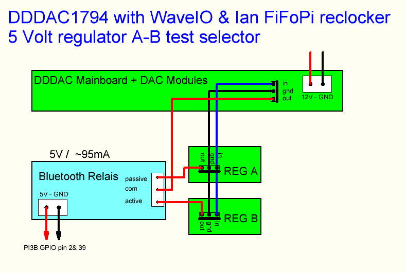

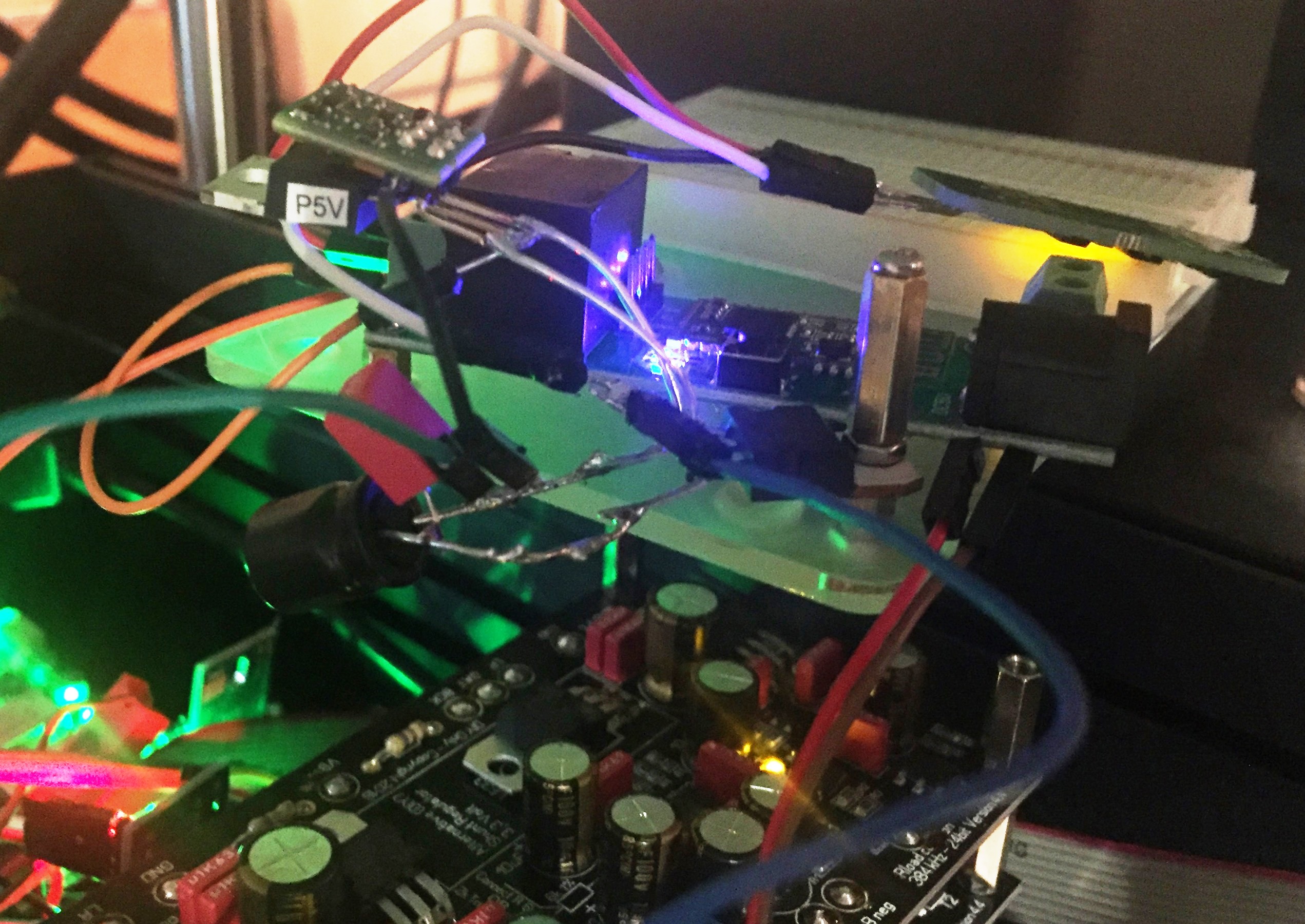

The test setup:
I wanted to rule out the effect of time lag comparing audio stuff. Be honest, we all know how tricky it can be to have a new build or modification and we listen hours, days, or even weeks later to the new situation. Even when you compare stuff by standing up, walk to your gear and flip a switch or reverse a cable or whatever, there is already a time lag. Although I agree that this is doable and our memory seems to work still pretty ok on these short time lags. But still…. I wanted to be sure….
So what I did is using one of those Bluetooth relay boards driven by a smartphone app, where you can switch between A&B from your phone. I soldered wires from the LF50 position to the board and some support structure and the two regulators to test A-B. There is picture attached. Looks like a mess, but it works just fine. It might be the 10cm of wire could influence the performance? May be, but the differences of SQ are still the same I believe for comparison purpose. After soldering my final choice back on the LF50 position, at least I could not hear anything different. So I guess it will be alright.
I must say, such an “I sit in my chair and can switch back and forward without even moving my head-solution” is really a great tool to compare detail, special moments in the music etc. With one hand I have the smartphone switching, in the other the remote control for the music streamer (in this case the DDDAC1794 with Roon/Ropieee and FiFoPi)
The only “downside” is that I could “only” compare two at a time. May be an A-B-C-D-E setup would have been better, but hey, I combined many regulators in A-B and in the end you get a very good idea on their sonic capabilities and how they compare.
Based on the extremely low noise LT3045M chip. Very detailed, sometimes you think it paints to sharp lines around everything. But it puts a very open sound stage and especially male voices get a clarity and texture you cannot hear with the LF50. The sound stage moves forward a bit – this one heavily depends on the rest of your gear I would say
