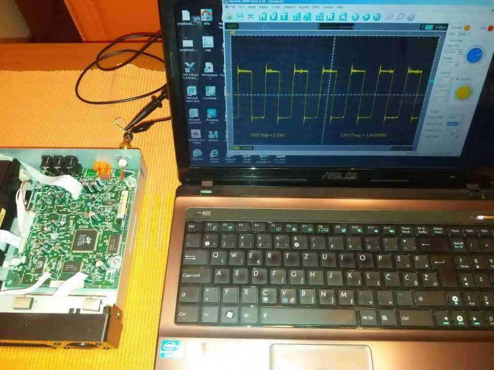

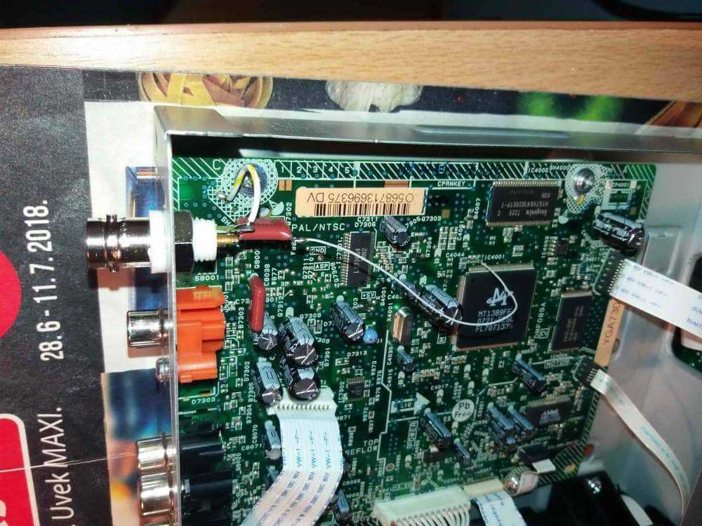

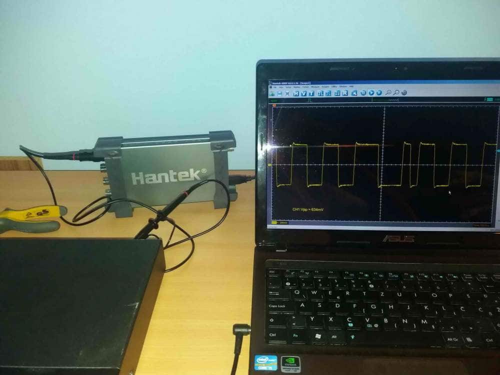

@kartick, WM8804 will tolerate 5VP-P, I tried it with 4.5VP-P and it worked. I am currently using a modified DVD player with a 2.24V P-P SPDIF signal at the output and it works quite normally. The stock output on that DVD player is 0.63V P-P. By standard, SPDIF signal is 0.5-0.6V P-P, and the minimum is 0.2V P-P.
@Doede @Nixie, basically in simple terms, I want to know if I would have been able to get a signal measuring 5V via AES/EBU to the DDDAC in place of whatever say a 2.something volts via SPIDF, would I have gotten a more robust drive on the dac and hence a better output from the dac?

I mostly don't listen to SPDIF now, using just the USB port on DDDAC. When I modified the DVD player SPDIF output by avoiding the lines on the PCB and the original output buffer and taking the SPDIF signal directly from the chip in the DVD player, I got a much better (more correct signal) and better sound. I don't believe that the improvement was due to a higher signal level, but due to a better signal shape. This is Pioneer DV300. I have also modified several pieces of DV600, DV610, DV393 with a good result so far. I got the idea from here. I just happened to have a DV610 that wasn’t used much. I later got a DV300.
