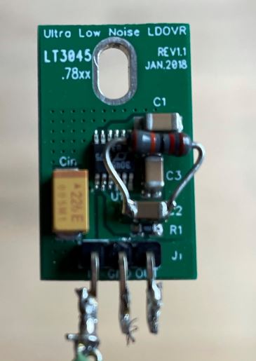

Hi Doede.
Back around post #7822 you explained why you feed the WaveIO isolated-side/FiFoPi dirty-side 4V. I think I understand that the LVTTL datasignals coming from the WaveIO was higher than 3.3V when given 5Vcc which the FiFoPi can't handle. Less than 4.6V should be better. Was that about right?
You also stated that you used a separate 12V PSU and a LDOVR regulator here.
Well, it seems that LDOVR's are not readily available at 4V so did you order a custom regulator here, or use something else. I also have a hard time finding any standard 4V LDO's which are not smd.

almost, and close enough....
the LVTTL data signals coming from the WaveIO.........
well ...It is more that the FiFoPi is LVTTL compliant. meaning you need to stay below 5 Volt.
The WaveIO outputs whatever level you put as Voltage to the isolator chip. 3,3 / 4 / 5volts / it does not matter
As the FiFoPi does not take anything close or above 5 Volt, I choose a safe level of 4 volts. 4,5 and 3,3 will also work
I just soldered another resistor on the LDOVR, making it 4 Volt
Hope that helped?

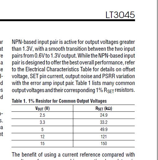

Did you remove and replace a smd-resistor on something like a programmable voltage LDOVR LT3045-S ?
I can't find any detailed information about how to do this on their website...
Hmm, can't figure what to do here. I don't want to compromise the relative clean voltage from a LinearPi psu to the FiFoPi Dirty-side (and ACCUSILICON crystals I guess), and I cannot easily get a 4V regulator (good or not). Anyone with a good suggestion?
no problem !
take the datasheet and look at the picture how I did it.... you can take any LDOVR and create a new ref resistor so to speak.
Every 10kOhm is 1 Volt output. So on an existing 5 Volt there should be like 50kOhm. Now just calculate the parallel value and solder a parallel resistor as (at the cap is more space) shown in the image (you know how to do this calculation I presume)
If you have a 3,3 V at hand, you have to remove the ref R of course

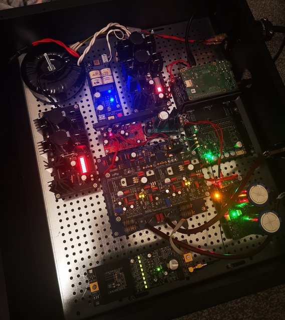

Impressions from the construction phase:

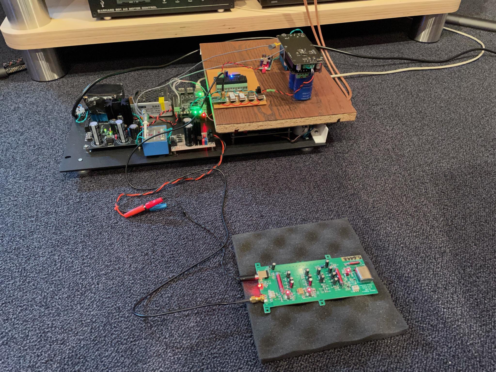

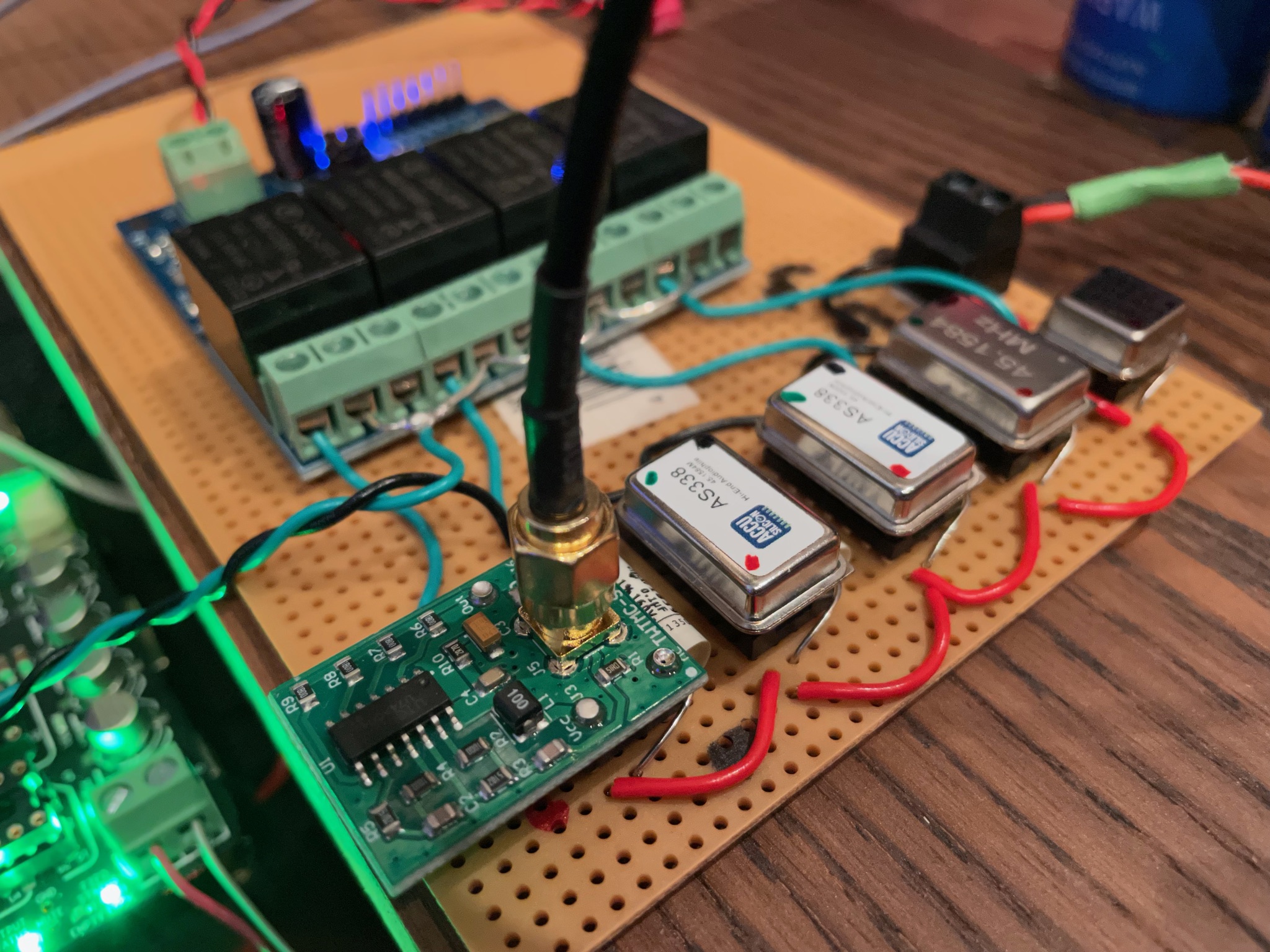

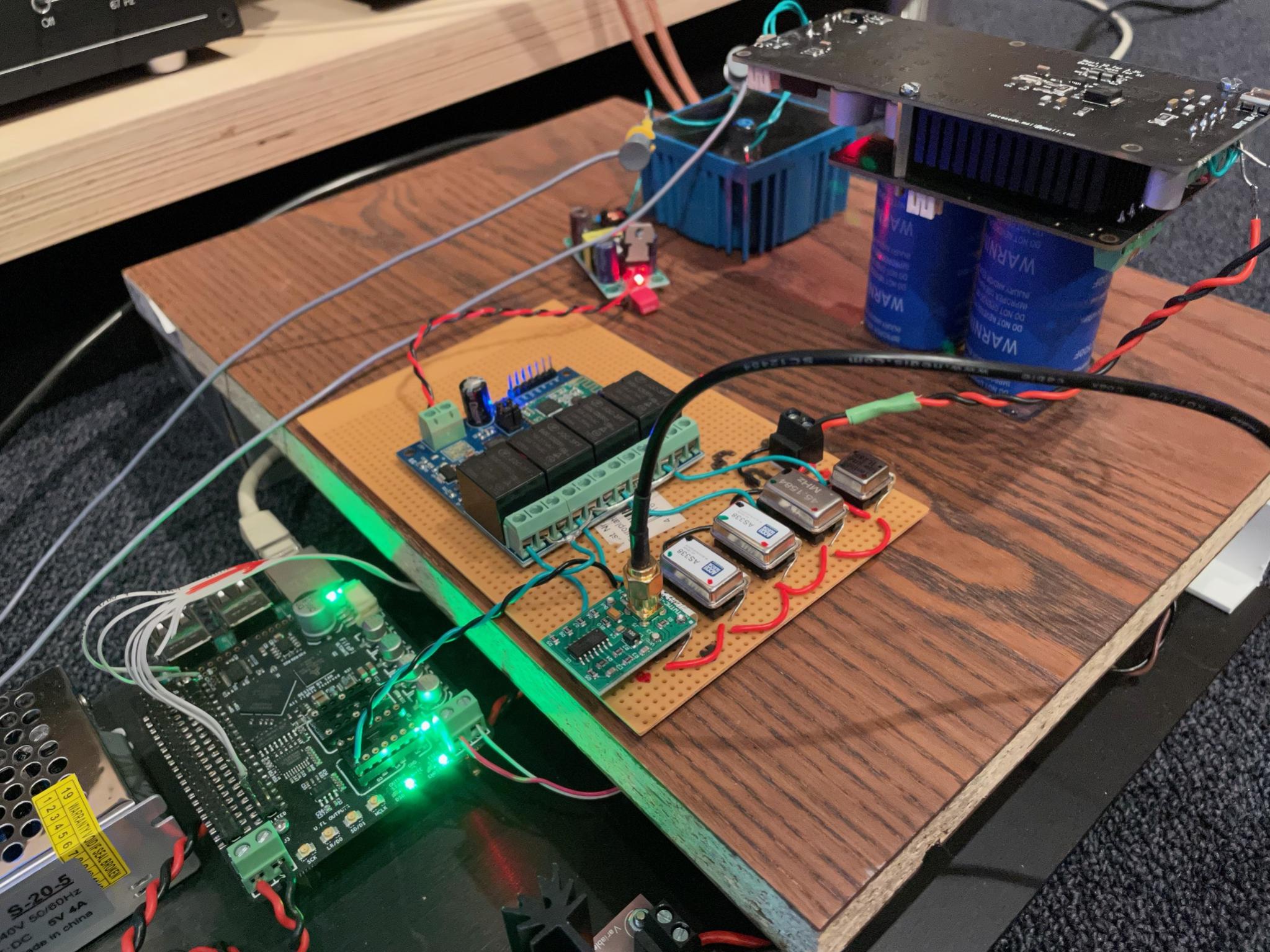

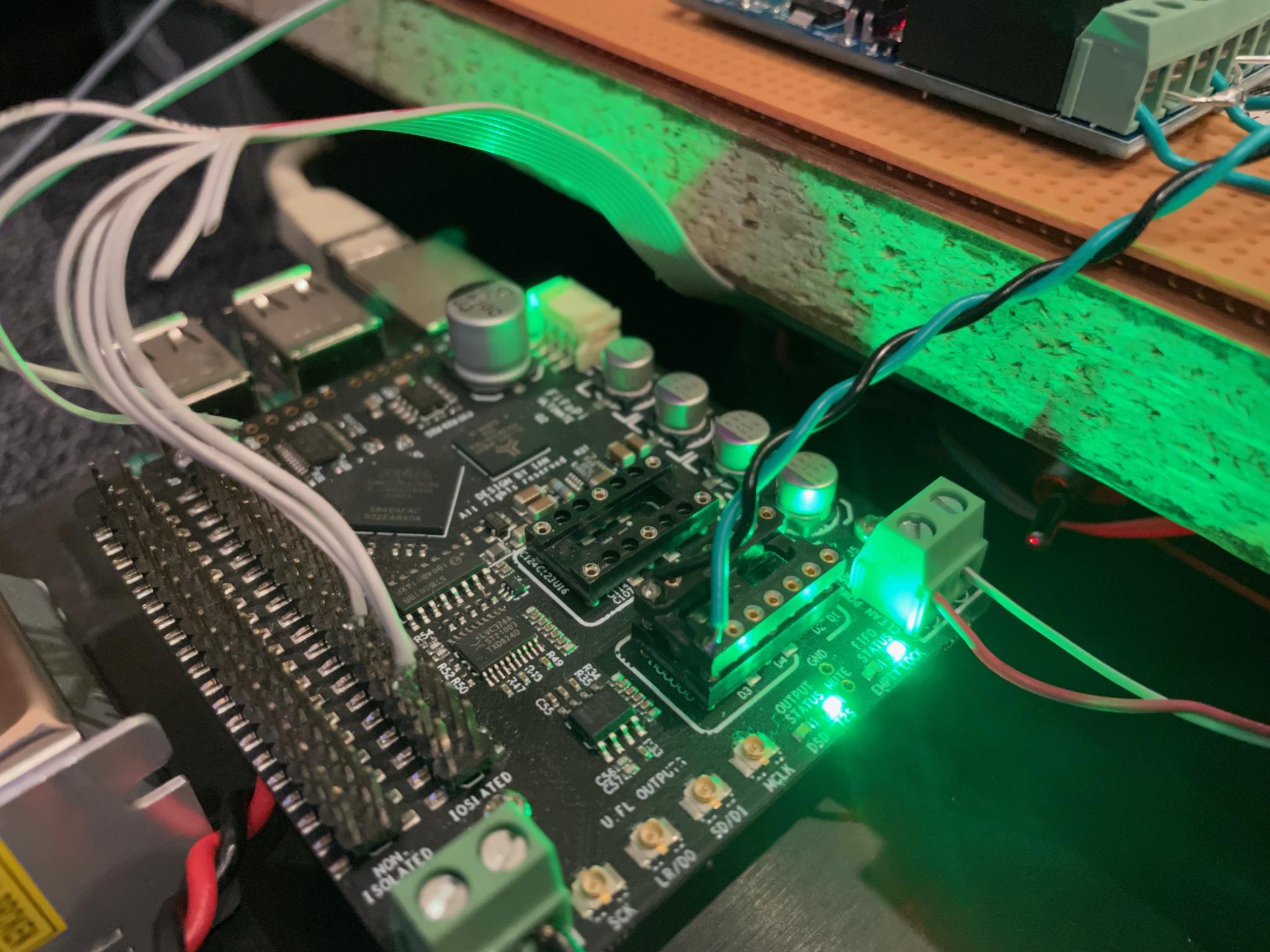

I have finally got around to building my ultimate (well for now!) integrated DDDAC streamer.
RPI 4 powered by a Salas 5v L-Adapter into Conditionerpi, mounted on a Stationpi with the Fifiopi. DDDAC powered by a Salas L-Adapter through a 12v Sjostrom Super Regulator. Fifopi fed with a Neutron Star clock and a 3.3v UcConditioner.
Everything is supplied properly, all voltages are correct at every point (even checked all voltages from the DAC chips on the top deck) with 2.8v on left and right channels and <0.1v DC offset.
HOWEVER, after using my DDDAC in my previous setup for a number of years I now appear to have significant distortion in both channels. I have tried everything to troublshoot. I have replaced the RPI with the Waveio to see if that works. Changed amplifiers. Measured every measurement I can think of (including the correct resistance at the I/V stage). Could literally moving the DDDAC from one box to another have broken something so badly that I now have extremely loud distortion? It basically sounds like blown speakers in both channels with the actual music very faint in the distance?
Hi Alex,
also great job ! Sad you have this issue....
there is a sequence I always follow. some you probably have done already.
just an idea what to do:
Best thing is always to check all DC and AC specs:
1. Supply voltage 3,3 and 8 Volt at the chips
2. BIAS voltage over Rload (must be like 2,8V)
3. BIAS current pin 20 test point of the DAC (assuming you have the new version) the 40mV test point
4. Are signals arriving at the DAC? (BCK data & FS) use a scope
5. AC signal output at POS and on NEG output versus common (play a 0dBFS 400Hz tone and measure with a DMM AC – must be ~ 1,2V ac)
something of this list must be wrong...
Let me know please !
