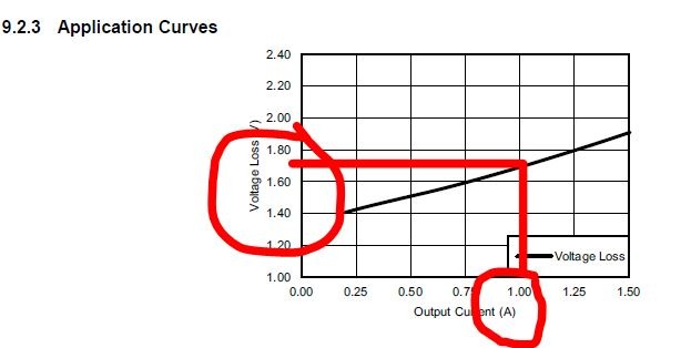

No, the problem is that after warming up for about 1 hour or more when trying to set 13VDC there is a problem to set because the voltage changes up and down. With 2x DDDAC boards the current is 530mA and everything works without problems and after heating it is possible to set stable 13VDC
well in standard stock the 12 Volt power supply does not have very large headroom. See my blog on this topic. Also mains voltage can reduce this. But anyway, I have two questions. 1: does it work fine with 12,5 Volt? Which is my recommended voltage setting. 2: if you say" changes up and down" what in terms of measurement is this? what is DC, AC ? Frequency of up down? Drift ? could you be more precise what you are observing?
I think the blue Talema transformer in your 12VDC source can no longer handle a 930 mA load and therefore the output voltage changes up and down from 12.8 to 13.3 VDC.
I tried the Salas L-Adapter and everything works beautifully with a stable 13VDC output (L-adapter and 75VA transformer with one 15VAC winding).
1.I did not try 12.5 VDC because UA7810 needs at least 12.5VDC and there is still a 4R7 resistor which will make a voltage drop of about 0.5VDC
2. Uup and down in VDC. It kept changing uncontrollably.
Maybe if I put a more powerful transformer in your power supply, everything will work as it should.
I have another 150VA transformer with two secondary windings - 2x15 VAC. But it will probably be necessary to cool the transistor better.
