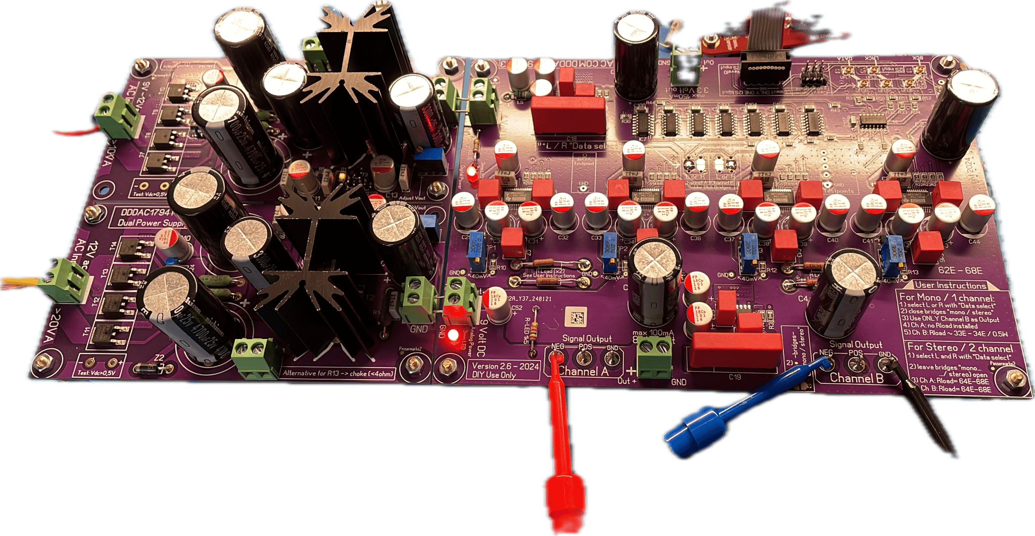

DAC and PSU Boards with SMD Parts are in. I received all parts for the DIY kits. I built two test versions. All is working fine, AP tests are great and very satisfying. I am having the boards a couple of days on burn in right now. Listening tests will be in the coming week. If all is 100%, the boards/kits will be sent to Audio Creative, who will be “taking care of business”
Here is a photo of the test bench…

Hello, i upgraded my old DDDAC 1794 with 4 decks of the last version. All was working well.
today i replaced the on/off switch and placed it on the front. Nothing else.
Now i don’t get music out. I use SPDiF. 2 Audio Creative transformers.
Power supply is giving 12 volts. All leds on the boards are on (2x2). All boards are on 0,40 mV and on the top deck both the chips get 8,2 V.
What can it be, what can i check?

Bello Bart,
when all voltages measure 100% and there is no music, most of the time, the switch connection is not ok. Just try to short directly at the pins on the Mainboard between GND and spdif. if that does not work, follow the signal… simple scope will do. Start at the input and end at the top<board, does all I2S signal arrive ?

Hi Bart,I don’t have a scope.
i would say, next to a digital multimeter, a (simple) scope is mandatory for every DIY ;-) you get simple ones for USB use for the price of a good output capacitor.
but did you already tried the other, less costly (zero) tip?
You could have mine for free (just pay for the shipping from Switzerland).I don’t have a scope.
