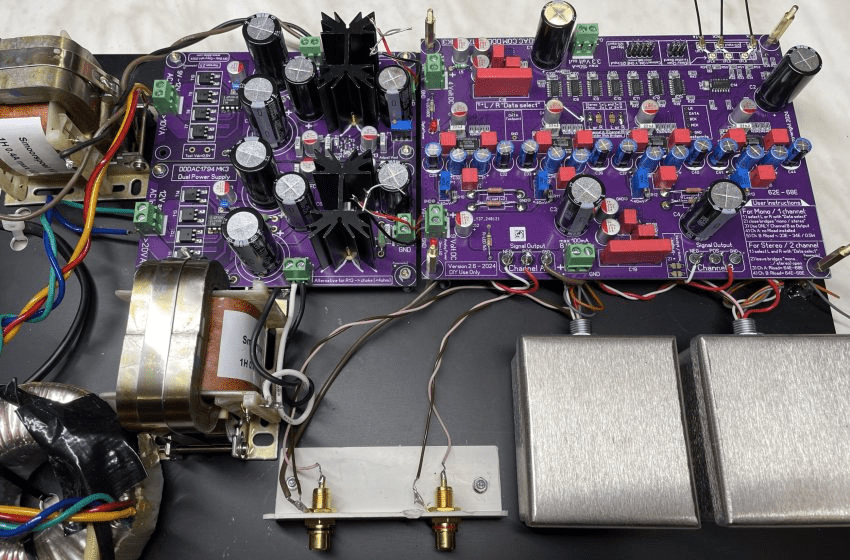

So I got out the test DAC out of storage to swap in the 3045s and found that the left channel is down. I dont remember killing the DAC chip as when I do I mark the casing with a scalpel, and 8v/3.3v both go to the right places. I did power it up before finding a dry joint on the CCS mod and fixing that didnt help. Could the CCS get killed by having the DAC side leg disconnected? Woukd a dead CCS even stop sound anyway? If not how can I test the 1794 chip?
Of the ccs works, you will have DC bias at the output of the DAC. So what DC voltage do you measure at both POS and NEG versus Common ?
also there is a check point to trim/adjust to 40mV, what do you read here ?
or are you using the old DAC boards with the DIY modification? Still the DC bias thing applies
Yes old dac boards with the mod. I get 2.69v bias on both sides. Can hear the same noise floor on both sides with nothing playing, the faulty side is not completely silent and there is continuity on all the data lines from baseboard to the three resistors near the DAC chip.
so bias is fine. what do you mean with not completely silent? Noise or music coming through? Are you able to see what signals arrive at the chip side of the resistors? Data. LR and BCK. Do they have the right level and timing, compared to the working side? You need an oscilloscope for this. Like earlier in this thread, I pointed out this is as important for DIY to have as to have as a screwdriver.
Scope seems to show no data coming from the red mainboard on the left side which points to an issue with the installation of the L/R timing mod which is easier to fix than replacing the DAC chip. Unfortunately that all looks ok as it worked before and all the connections are good.
