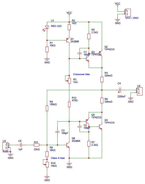

1. All transistors need a bipolar drive to the base, i.e. a pull-off resistor is not optional. Without any reverse base current, the transistor will take a long time to discharge, turn off, resulting in shoot through AB current spikes and slew distortion.
2. The only problem with transistor packages might be that TO-18, TO-39 are probably older devices with poorer performance. Perhaps transistor linearity could be called "sonic quality", but use of such language really means zero technical understanding.
3. The Wilson current mirror is not a good choice. You should use a constant current source, independent of supply voltage and more efficient use of parts, or perhaps a bootstrap.
4. TIP41, TIP42 are ft~=3MHz; too slow for use as drivers. This aggravates stability, feedback compensation problems.
5. R6, R7 in the collectors are useless unless the driver emitters are connected to them, as in lineup's circuit. The point is to buck the EB voltage to thermal stabilize the bias.
6. To make a successful amplifier, you need to understand feedback phase margin. Throwing capacitors into your circuit is shooting in the dark.

Thanks to everyone who gave his/hers contribution to this project. The final modification is now ready, with elements borrowed from Lineup's design.
Having had the amplifier up and running for some days, I am very satisfied with the overall result. The amp seems to be stable and the sound quality is, for lack of a better word, flawless.
The schematic:

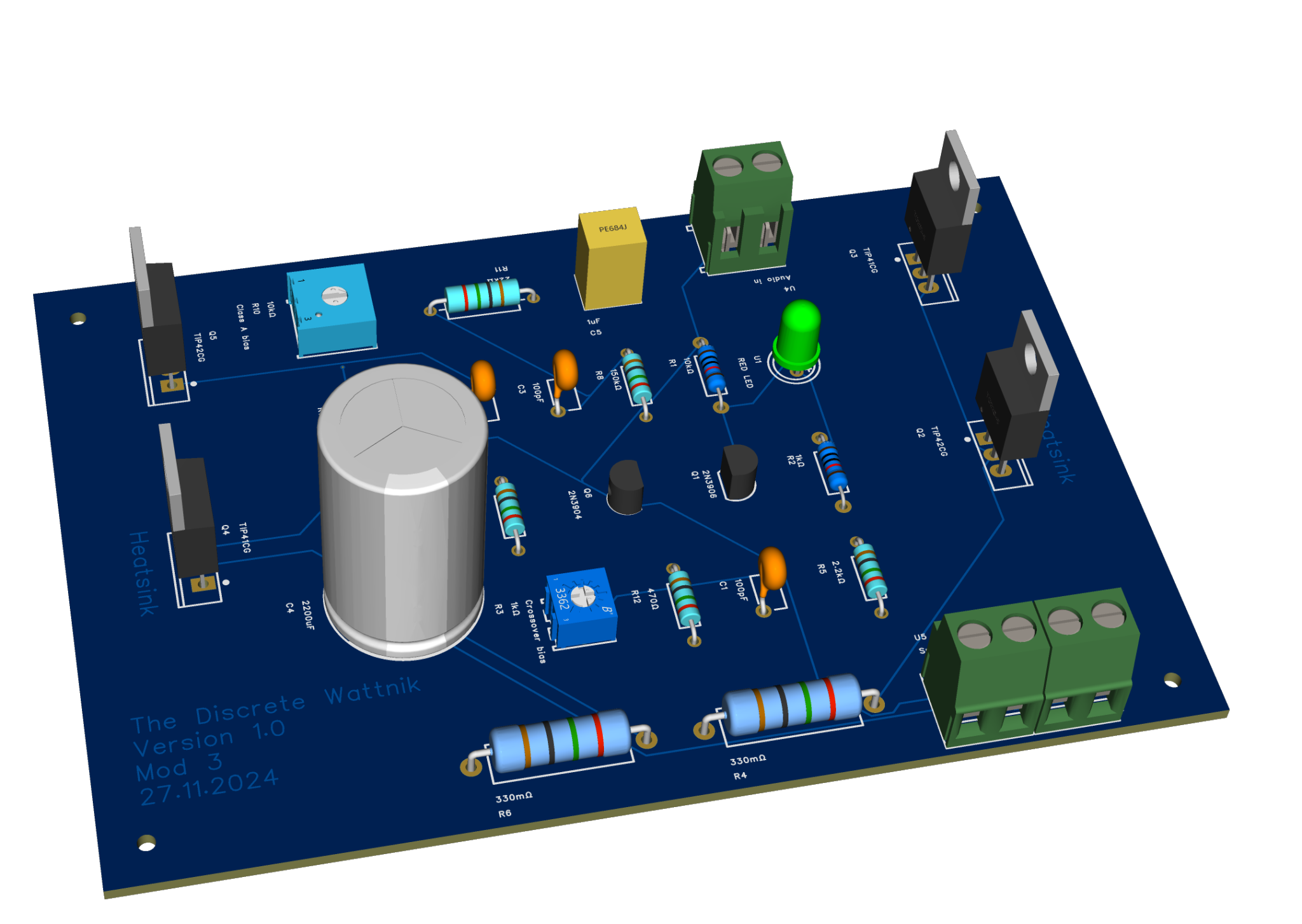

Although the breadboard version works well, I would like to have a more permanent solution, so here goes my first attempt in PCB designing. I found EasyEDA surprisingly simple to use for a total newbie, this is a result of three hours of work.
The PCB:

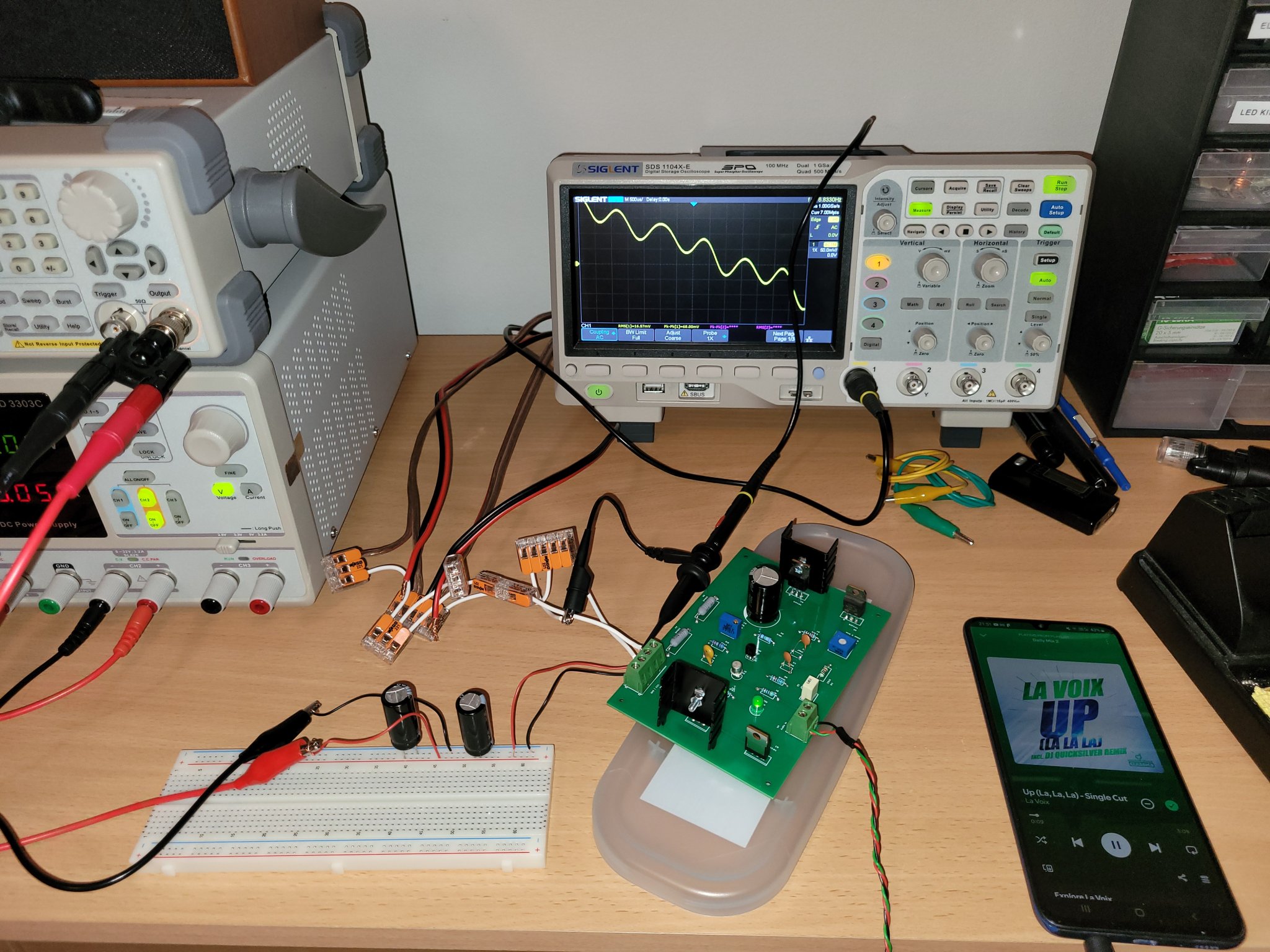

The PCBs have arrived and having soldered one channel ready, here are my findings:
There is an issue with oscillations:
Could it be something with my bench supply?
The sound is very good, even better in comparison to the protoboard version...
- when using 8 ohm 5 watts resistor as a dummy load, everything works fine.
- when I connect an 8 ohm speaker as a load, the circuit oscillates on low push pull quiescent current settings (less than 50 mA). Mostly on higher output volume and on bass notes.
- however, when I add a capacitor with reasonable uF (such as 1000 uF or larger) between + and - rails, as shown in the picture below, the oscillations go away and everything works again perfectly, with even more "oomph" to bass.
Precisely, this was the issue here, I will order new PCBs with some additional minor updates (proper ground plane, a bit wider tracks, correct footprints for TO-92 packages - a bit wider pad spacing, etc).It looks like you forgot to include power supply bypass capacitors on the board. The caps connect the power rails to ground to provide local power filtering. Usually they are 100uf.
